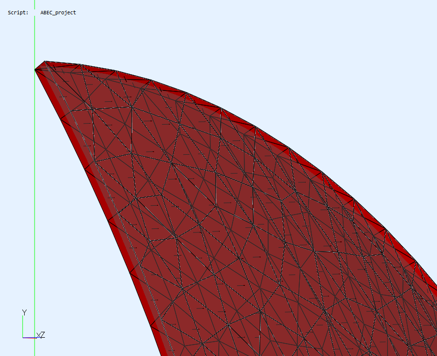

There's one detail I omitted in the previous simulations of the isolated suspension - the edge of the compression cavity also should have an excursion as the filler would be changing its shape a bit. It doesn't make much difference though, and if then for the better.
As it seems, for this uniformly driven cavity even a one-slot phase plug could perhaps suffice? (Still, completely ignoring the modes of the diaphragm itself.)
