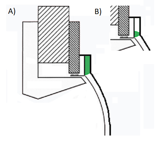

Then there's an option of keeping the existing suspension and using a soft silicone just as a filler to isolate the suspension from the compression cavity. It would add some moving mass I suppose. Not so sure about any other effects it might have, being much softer than the suspension. Or some foam ring.

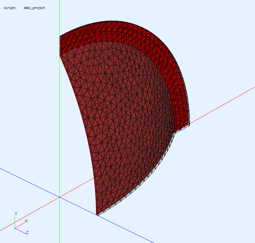

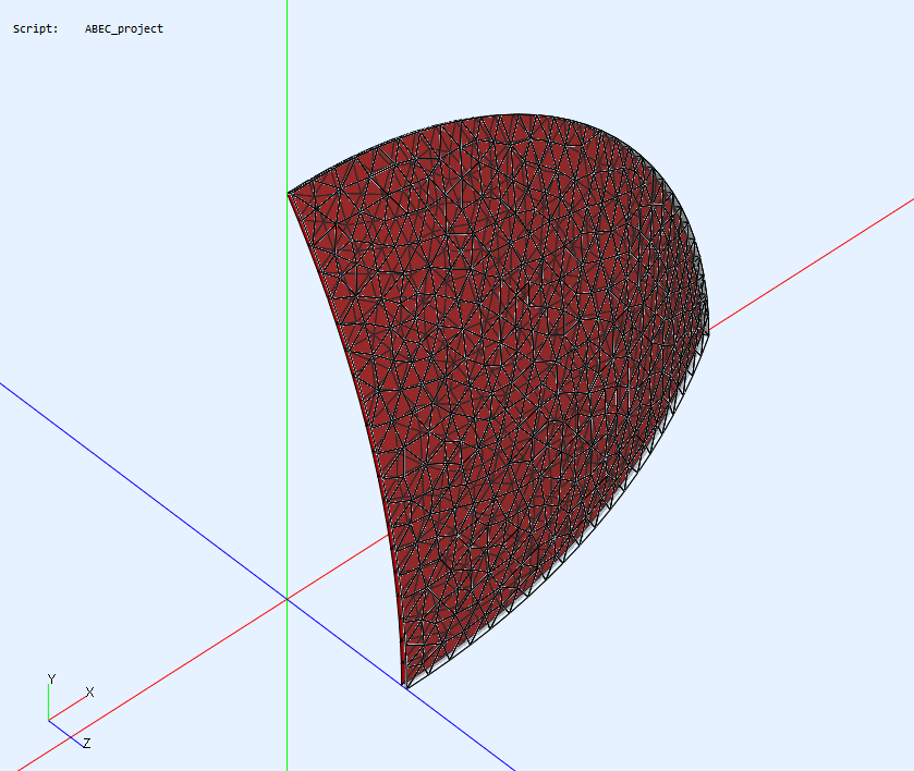

mabat: Thanks for all support. I´m getting familiar with everything, and while it is a lot, it is very nice and I mostly understand. Now, I would like to make my own waveguides weirdly shaped. Not going to ask for details for this, I will find out.
I miss one thing though - when I load your mesh file alone, it is just one quarter of the waveguide. I do not see anywhere in the files, where it is assembled into four segments in the ABEC SW. Could you give a hint?
Thank you.
Thank you.
That's on purpose, of course. The symmetry is defined in "Control_Solver" (solving.txt) as "Sym=xy". You can also hide the "redundant" parts by the "Views - Symmetries" checkbox in the GUI.I miss one thing though - when I load your mesh file alone, it is just one quarter of the waveguide. I do not see anywhere in the files, where it is assembled into four segments in the ABEC SW. Could you give a hint?
Thank you.
That's also the limitation for now. This symmetry is enforced for any shape you create, i.e. only the first quadrant is taken and mirrored this way. This might change in a next version of the tool.
If the gap at the rim is an issue for you, and I am not sure that it is such a big problem, then what you suggest here is the way to go. But it may add more problems than it corrects.

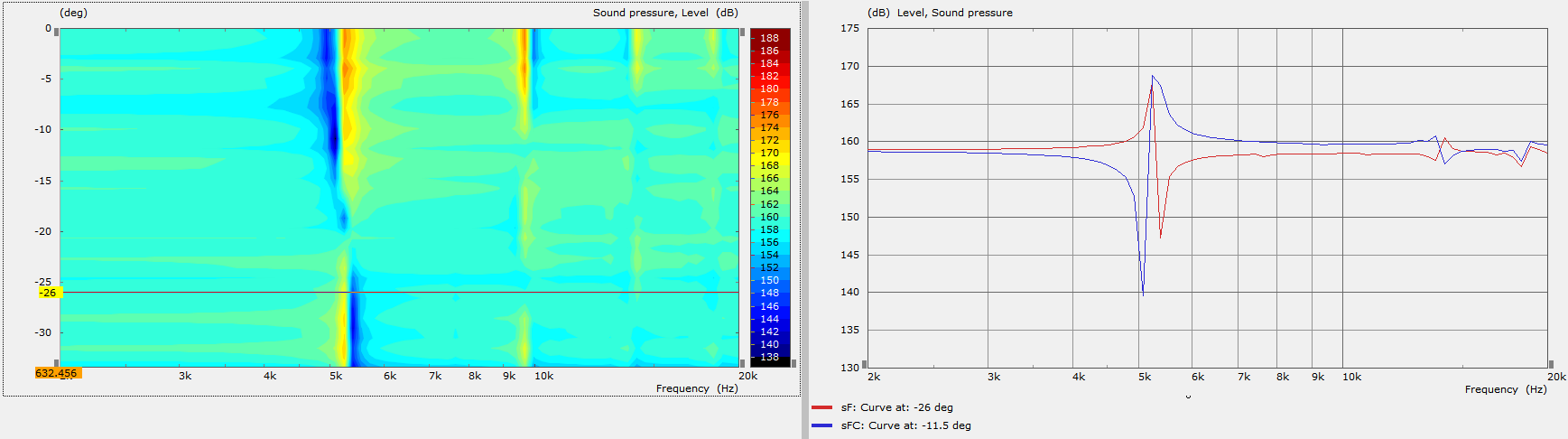

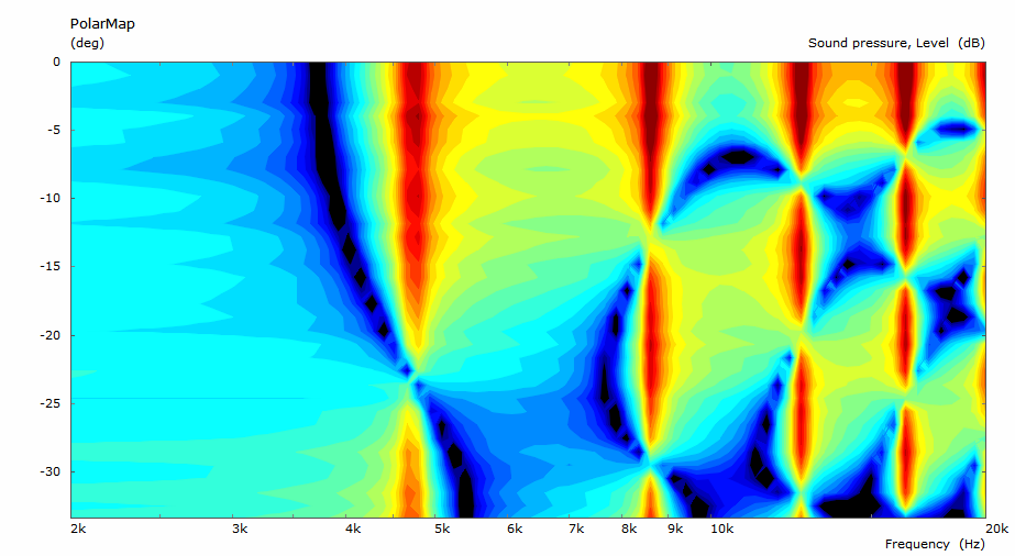

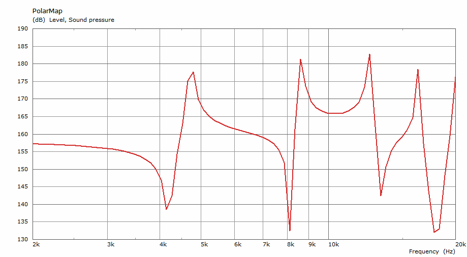

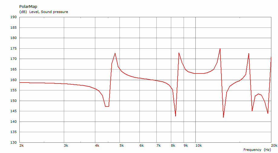

Here is the issue. I made simulations of the compression cavity for different suspension contributions.
Geometry parameters:
Voice coil diamter: 75 mm
Suspension length: 5 mm
Diaphragm height (draw): 11.25 mm
Cavity gap: 0.5 mm
1) Cavity including the suspension
From the worst to the best:
1-1) No suspension contribution
1-2) "Close-to-real" scenario: Suspension divided into two rings of the equal widths; excursion weights: 0.75 and 0.25
1-3) Whole suspension driven to full excursion (i.e. uniform axial motion across the cavity)
2) Cavity with the suspension isolated

The nulls are suspiciously deep (& look resolution limited). Makes me ask: does the model include damping?
I expect thermo-acoustic damping to be significant in a gap of 0.5mm.
It might be good if someone with the right experience would comment if the equivalent resonances are seen in practice. I don't recall seeing corresponding features in the few CDs I've measured.

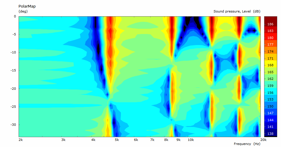

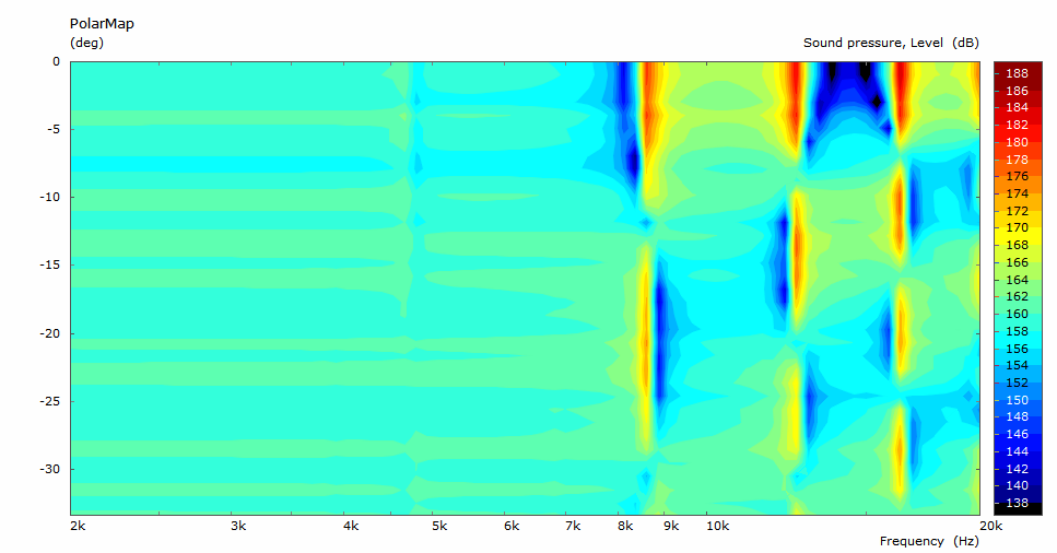

There's no damping, I didn't try, but that's not the point at the moment I think.
The reason why you don't see these peaks and nulls in practice may be because that in a properly designed phase plug these tend to cancel out - see the picture below (and yes, it is resolution limited but overall it can be clearly seen from that).
The less disruption, the better - the easier the phase plug design.

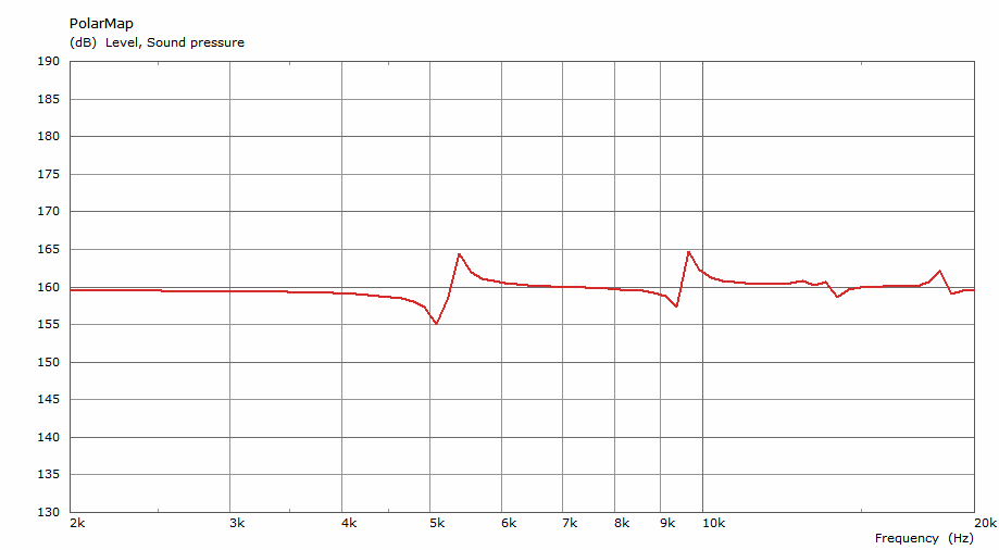

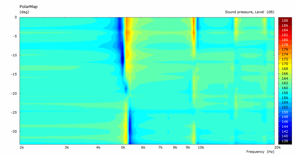

Maybe what is interesting is that if the whole suspension vibrated axially (i.e. was in fact not a suspension but a continuation of the diaphragm), the excitation of the lowest mode would be almost nil -
Cavity without the suspension:
Cavity including the uniformly driven "suspension":
