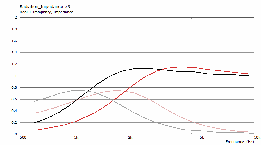

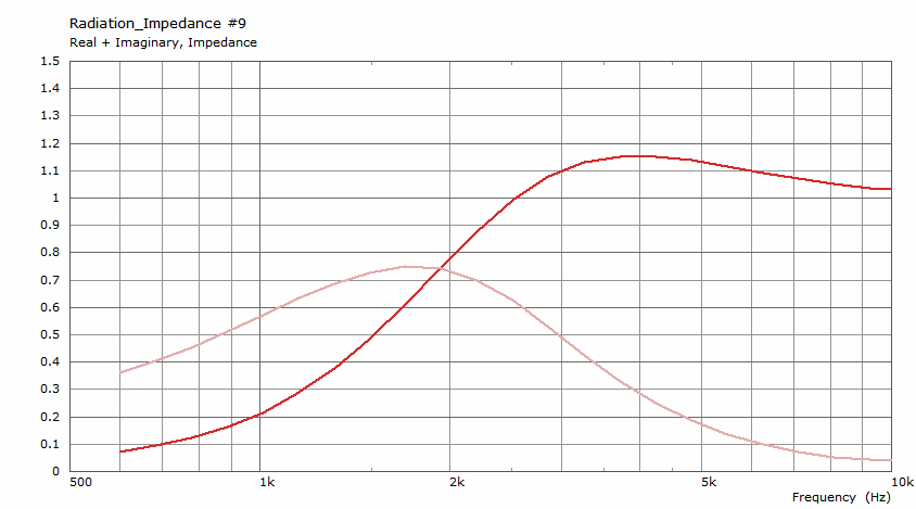

OK, here is the "throat radiation impedance" of the waveguide at hand. Please show me what is the usable frequency limit and why. No need to speculate, we have it calculated. I understand you are saying that there's somethig like a usable limit, I just don't get the "why" part... What consequences will it have using it lower? I just can't imagine you could point a finger at a point in the chart and say "here"... Why?

Between roughly 680 and 850Hz.
It's an (not entirely) uneducated guess, based on throat impedance plots and associated cutoff frequencies of other horn types.
If you search for the (approximate) lower knee, you'll arrive at those frequencies.
:D You didn't expect a solid scientific rationale, did you?
Ultimately, you could use a compression driver without horn. I've seen people, mostly Asians, do that.
At home, the mouth size is more important. I've tried the B&C ME60 (20cm depth, undersized mouth) at 600Hz... horrible!
From about the specified 800Hz it get's better.

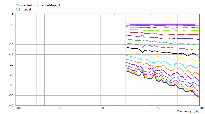

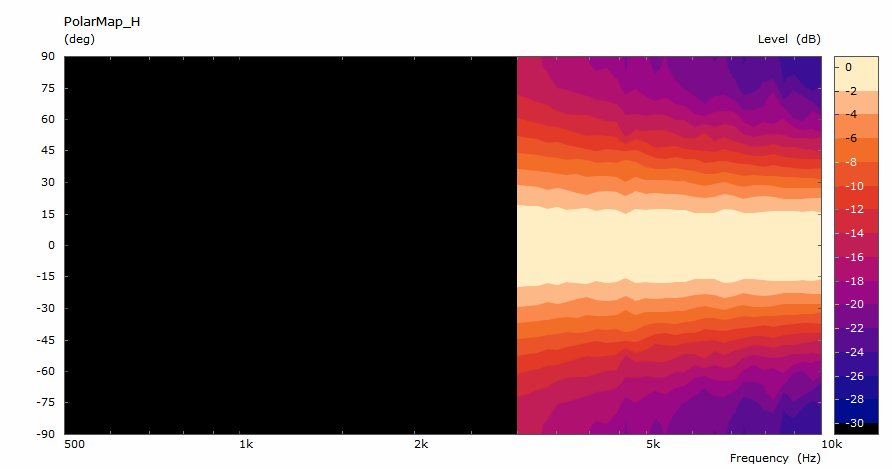

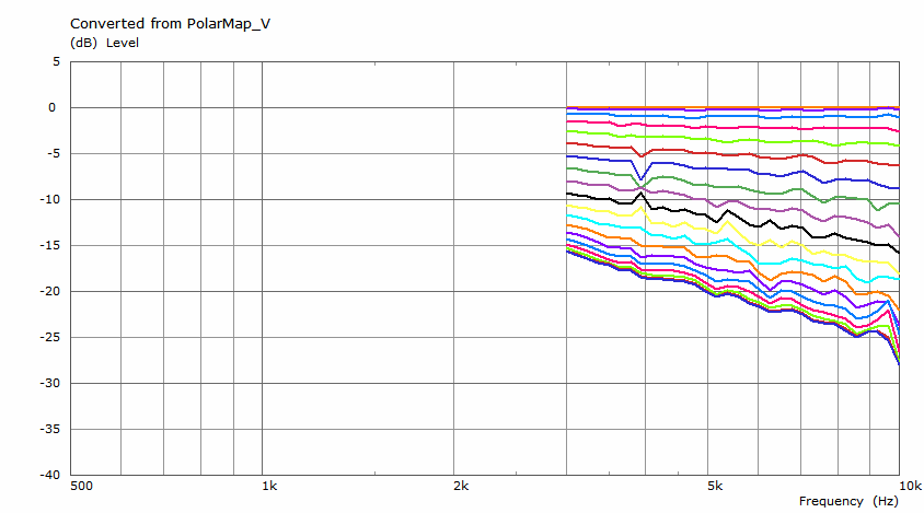

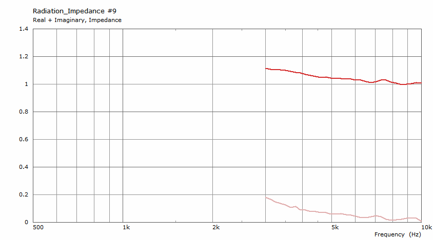

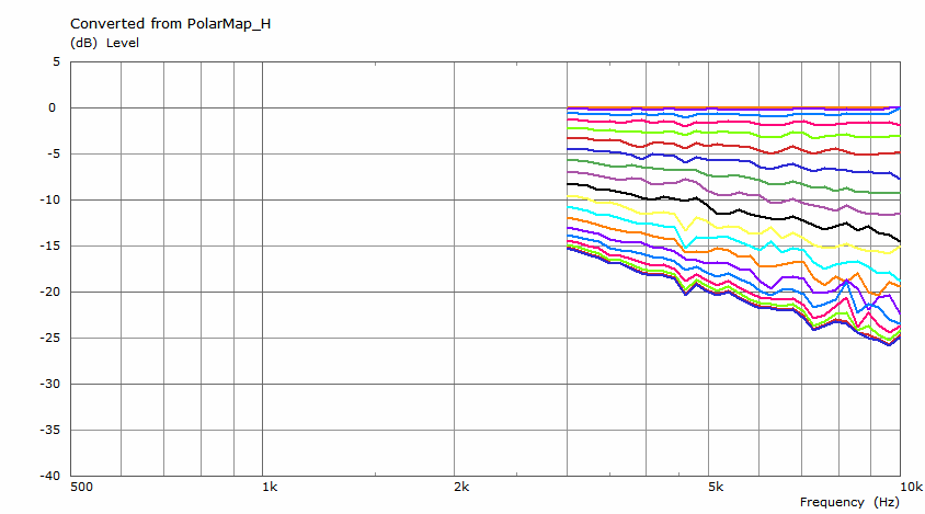

This is a slight ripple, I suppose?
That's hard to tell, I suspect the mesh is still too coarse to judge. I tried once more with just a higher number of frequency points in the incriminated range - there may be some slight resonance(s) around 7 kHz and maybe 9.6 kHz, the rest seems more like a noise to me. A denser mesh would be helpful but it would take too much time at the moment.
But it would make sense if a deeper horn was more susceptible to resonances (for about the same mouth size).

Yes, if the circumference of the mouth is identical, the deeper horn is more prone to ripple.
To me, that's not quite true. If there is ripple from reflections at the mouth they will tend lower and more dense, but not really more "prone to ripple" - the level of mouth reflection will be the same in both cases. But perhaps it's the english that is a problem here.
