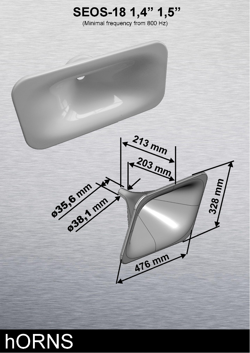

What mouth width and deepness and shape would have your preference for a 7.5 cm throat to load a 3" cone driver from a 800 hz electrical XO, so not a muscled compression driver, please.
I hesitate on the mouth and OS shape to marry to a 15" driver at 800 hz...

Well, I once put this Peerless 2" driver into a 10" Dayton waveguide (cut-off). It was not quite what I hoped for but this was just a single random experiment, based on which I can't make any conclusions. A waveguide in general would help to unify the directivity pattern, i.e. to increase the DI at lower frequencies. That alone would be beneficial. I suppose you could use Ath calculator for this, just use 3" throat and a piston source, I'd opt for a shallow smooth waveguide and probably not OS - more like conical with a larger initial angle (just guessing). For lower frequecies this should be pretty close. The rest will be given by the details of the particular real-world diaphragm which are completely different animal to simulate and Ath can't do this. You would have to wait and measure what you get...

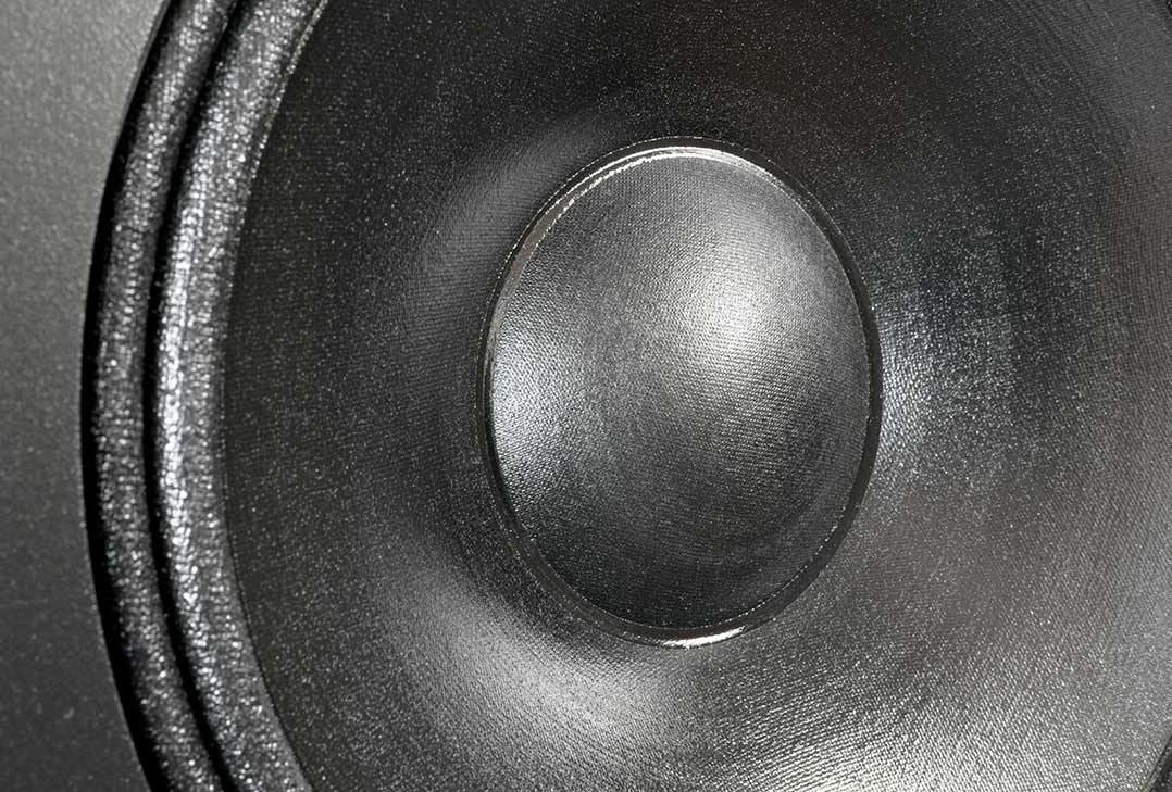

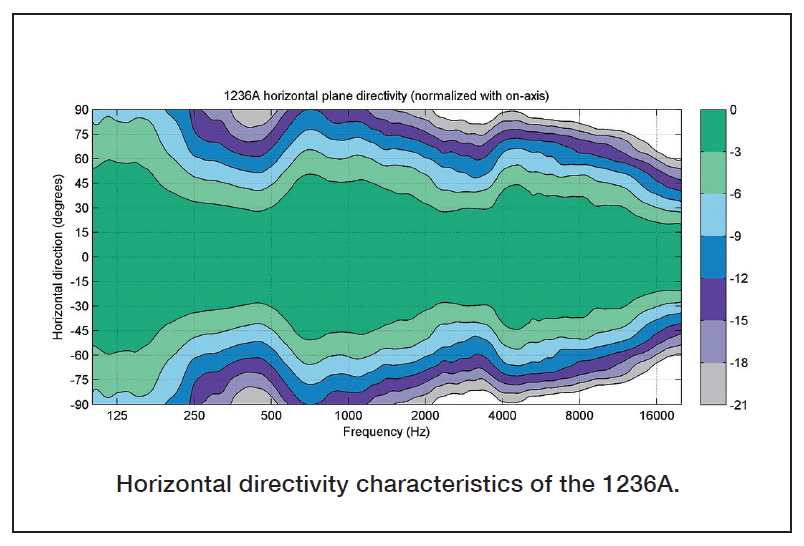

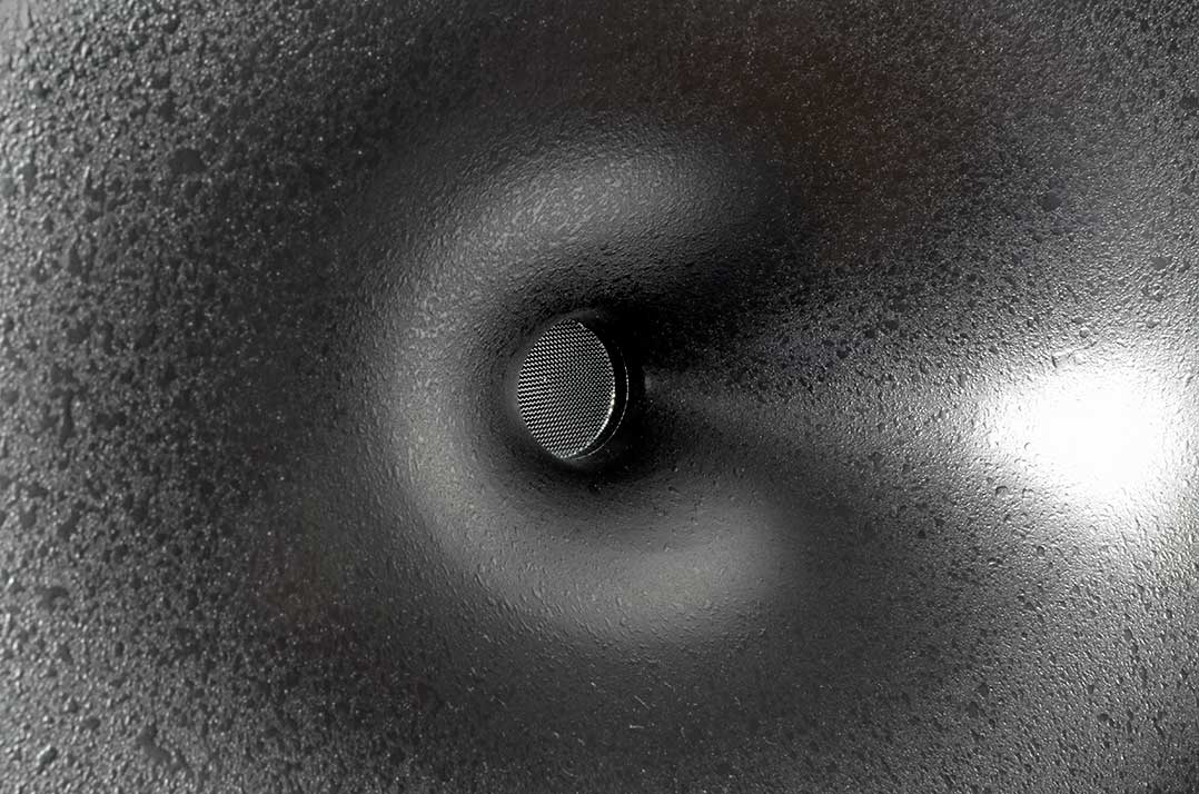

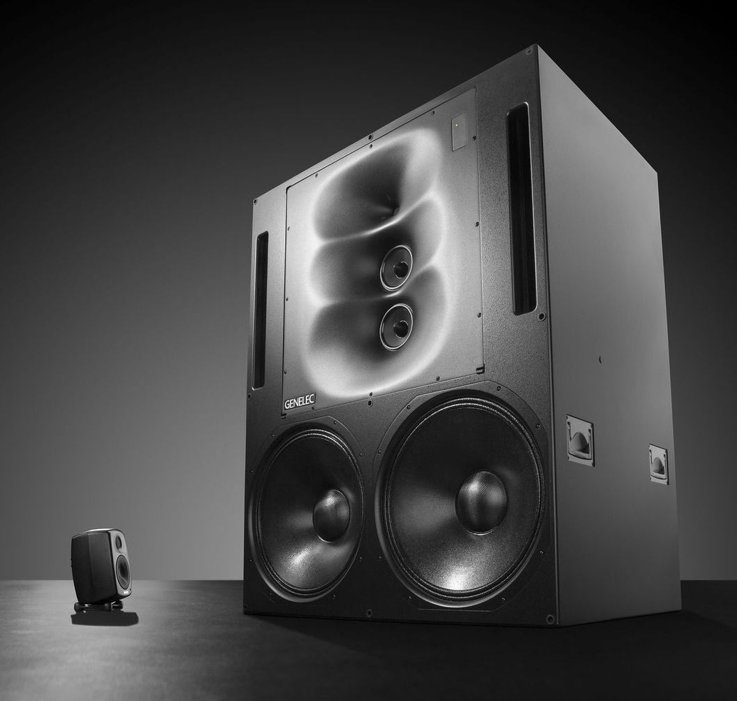

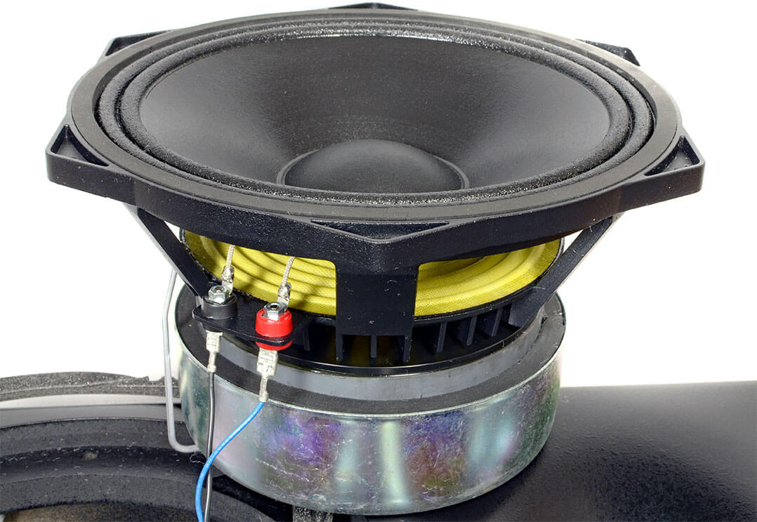

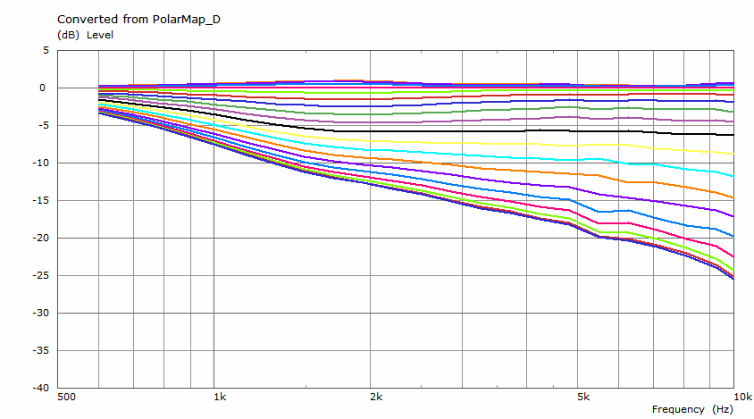

Example of waveguide-loaded midwoofers; Genelec 1236A
Brief technical specifiations:
Sound pressure level: 130 dB
Free field system frequency response: 17 Hz – 26 kHz (-6 dB)
Accuracy of frequency response: +/- 2 dB (21 Hz – 20 kHz)
Crossovers: 400 Hz and 3.2 kHz
Drivers: 2x woofers 18 in (458 mm), 2x midrange 5 in (125 mm), tweeter 2 in (50 mm) compression driver + DCW.

DCW™ stands for Directivity Control Waveguide Technology.

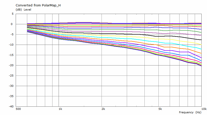

Obviously, a single large ATH4 would easily beat the polars of the 1236A, especially in the vertical plane.
Moral of the story: it's not easy to hornload vertically stacked woofers and get decent results, even more so if these are bigger than about 2".

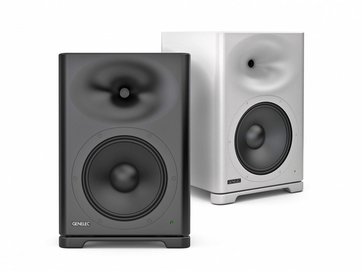

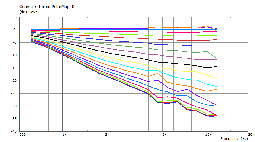

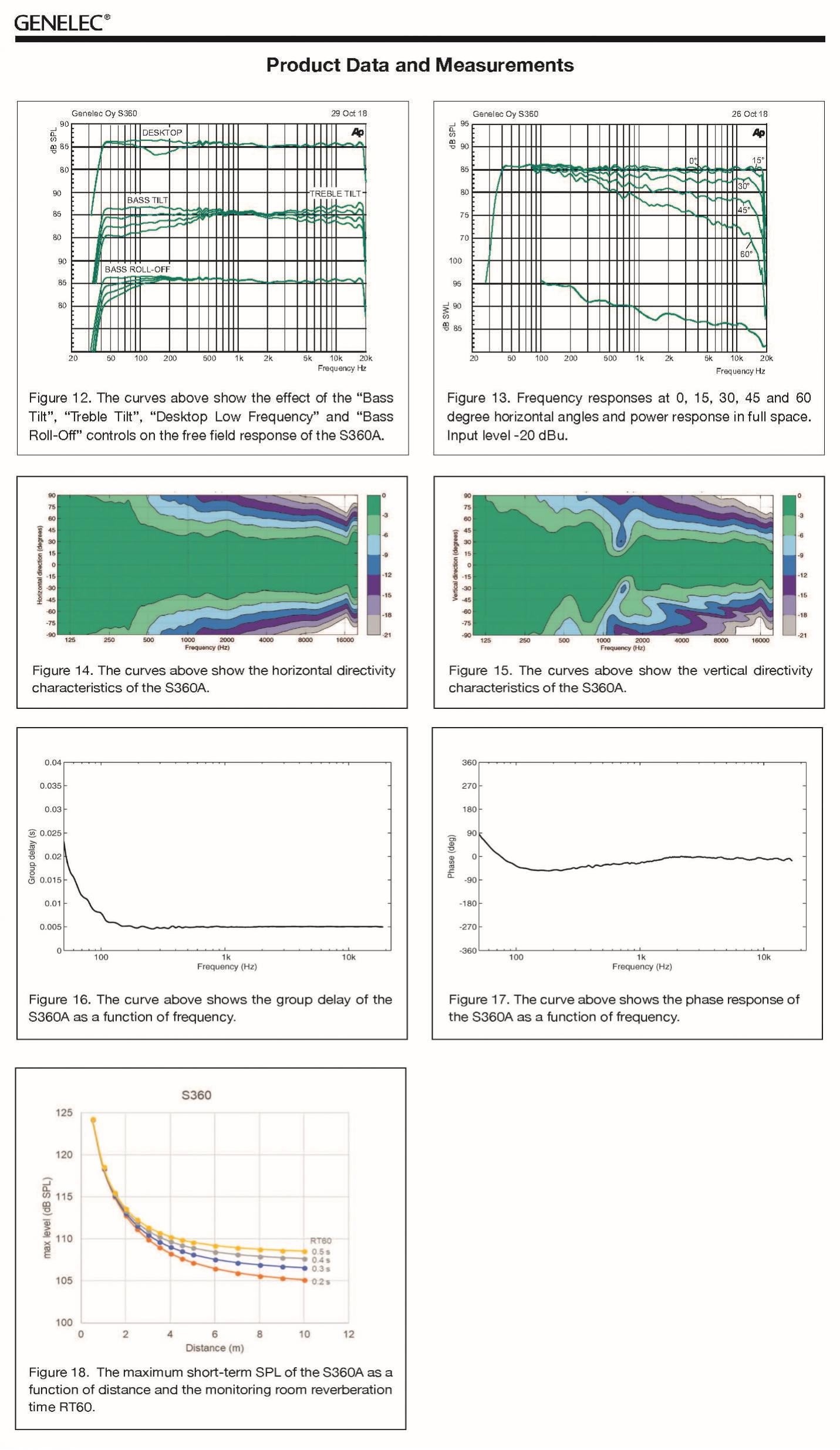

WOW that genelec looks so much worse than I ever would have imagined. not even very constant in the horizontal plane. looks like the S360 is a huge step up from this kind of thing.
The S360's polars are better, true.
Price/performance ratio, while not necessarily bad, could easily be bettered by DIY.

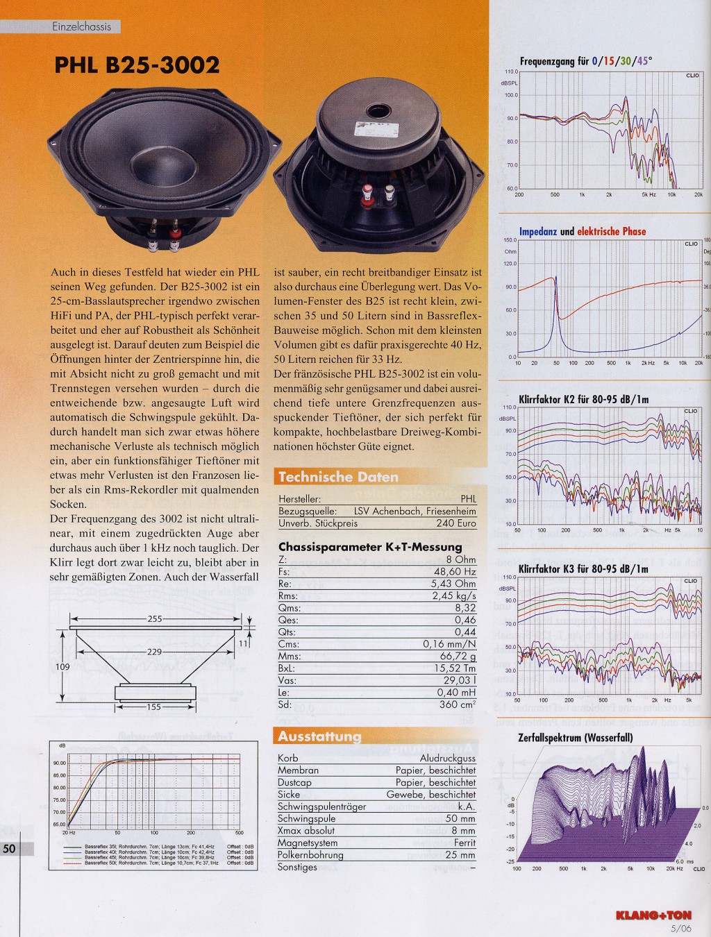

The woofer in the S360 is an OEM version of the PHL Audio 3002.
Here's a German review of the S360, including measurement data.

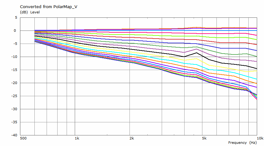

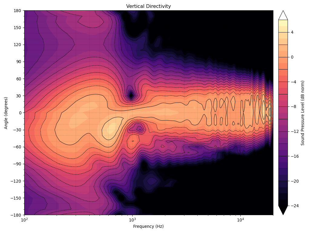

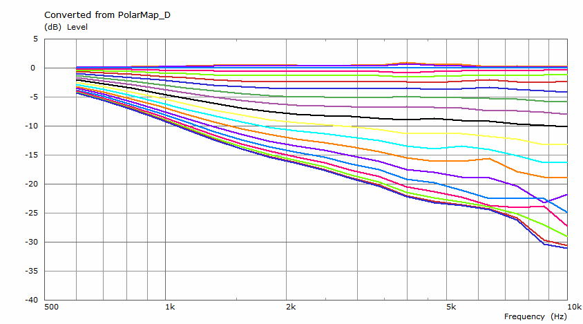

It's quite remarkable to observe that bmc0's big axisymmetrical waveguide + 12" woofer, don't yield (much) worse nulls around the crossover point, compared to the tiny elliptical wg + 10" woofer of the S360.

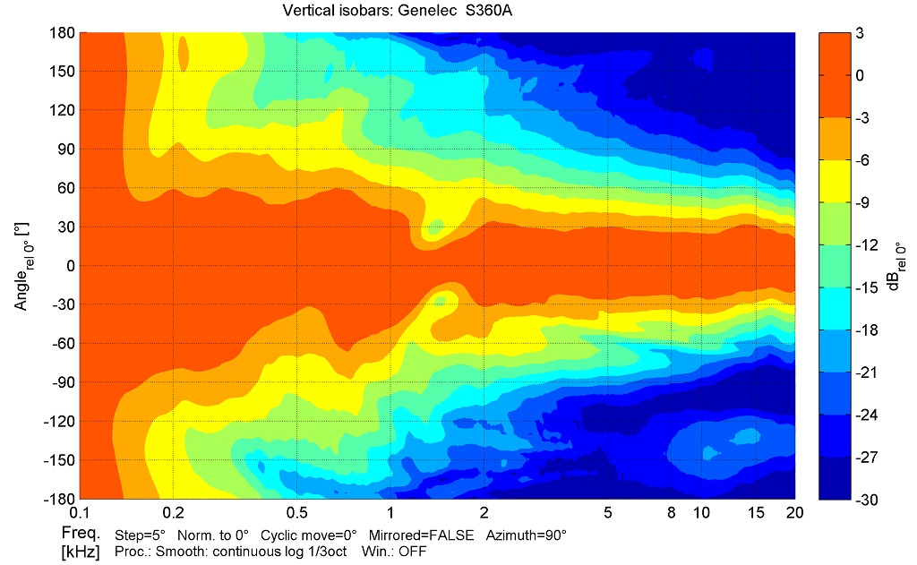

Vertical directivity of the S360, as measured by Sound and Recording:

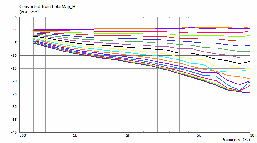

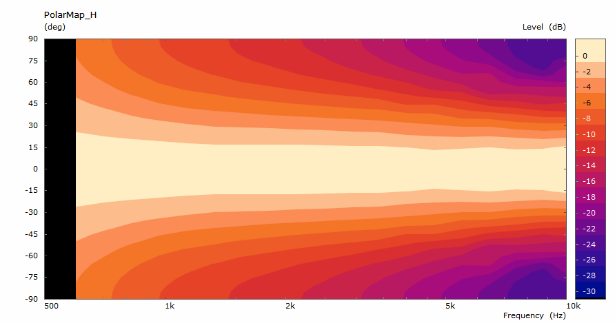

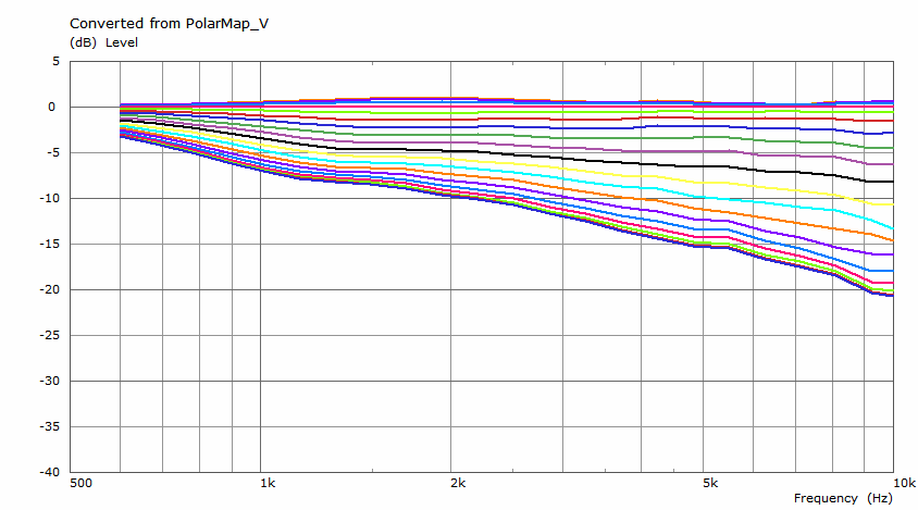

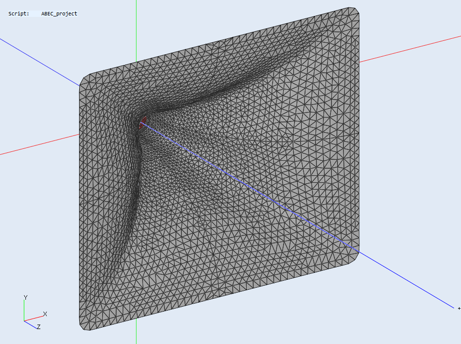

I have been experimenting with rectangular shapes for the last few weeks, incorporating some new features, and this is the result -
Horizontal, vertical and diagonal simulations (infinite baffle) attached, 0 - 90° per 5°. I'd say this is about as good as it gets. This particular one is 422 x 364 x 135 mm, intended to be used with 18sound ND3T from about 700 Hz.

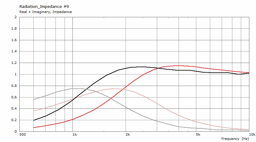

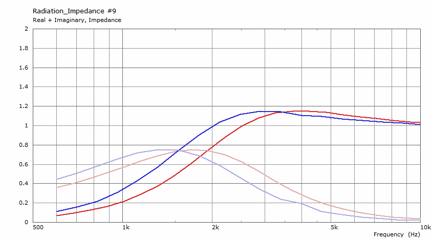

The same geometry, mainly deeper, now 468 x 396 x 180 mm. Comparison of radiation impedances on the 4th picture.
(Again, the black line in the middle is 45° off-axis).
I like the horns. Wondering if MTM would be an improvement....
How would an MTM arrangement impact the vertical directivity? Would the pinching at 1Khz be less pronounced?

Still a deeper one, 488 x 406 x 220 mm.
(Only a coarse mesh, solved in 30 minutes.)
