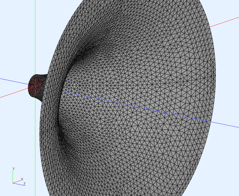

To illustrate, this si what I would consider a fine enough mesh in general for 10 kHz upper frequency limit (the waveguide is 19" in diameter). You can see all the things just mentioned: The sizes of mesh elements increase from throat to mouth and if you look carefully you can also see the joints between the individual slices - these are the full circles (ellipses in this case) around the surface.
Mesh.ThroatResolution = 5.0 ; [mm]
Mesh.InterfaceResolution = 10.0 ; [mm]
ABEC reports 3329 elements.

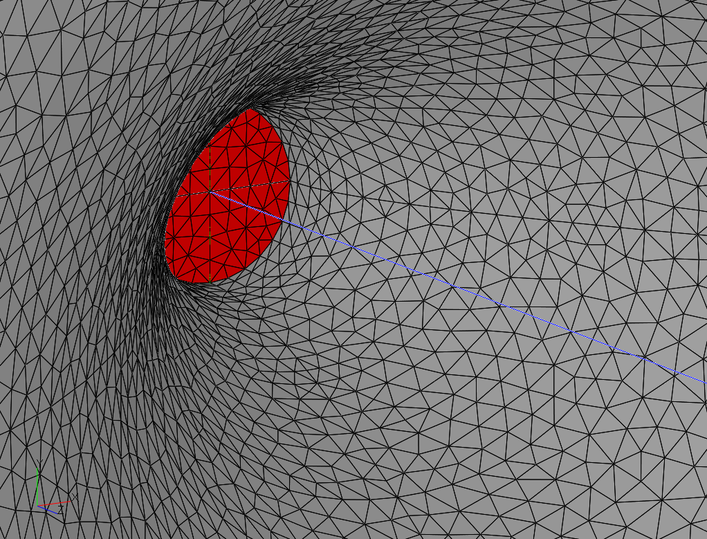

Right at the throat the finite elements get even smaller because of the (generally) closer spacing of the slices. This is handled automatically.
Here the red "driving" surface is meshed at specified throat resolution (5 mm) but the nearby wall resolution is finer than that. This is not a problem as the number of elements around the throat never gets large. It is the mouth area where this number can rise rapidly if you set the elements too small.
