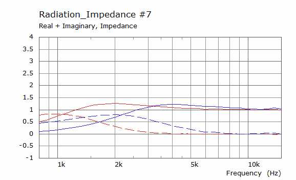

Now I wonder what the radiation impedance of the same waveguide with a bigger mouth would look like, but I don't want to burden mabat with yet another time consuming sim.

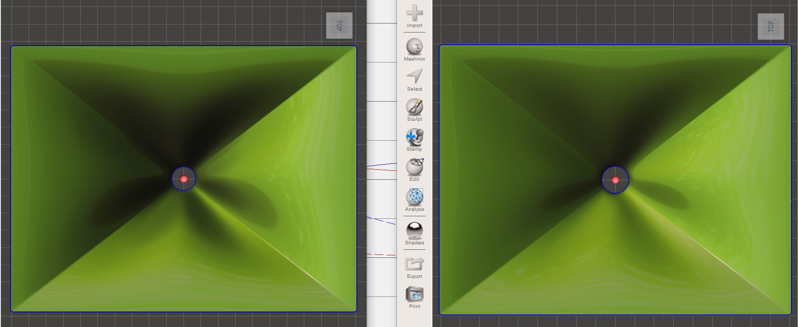

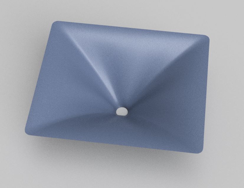

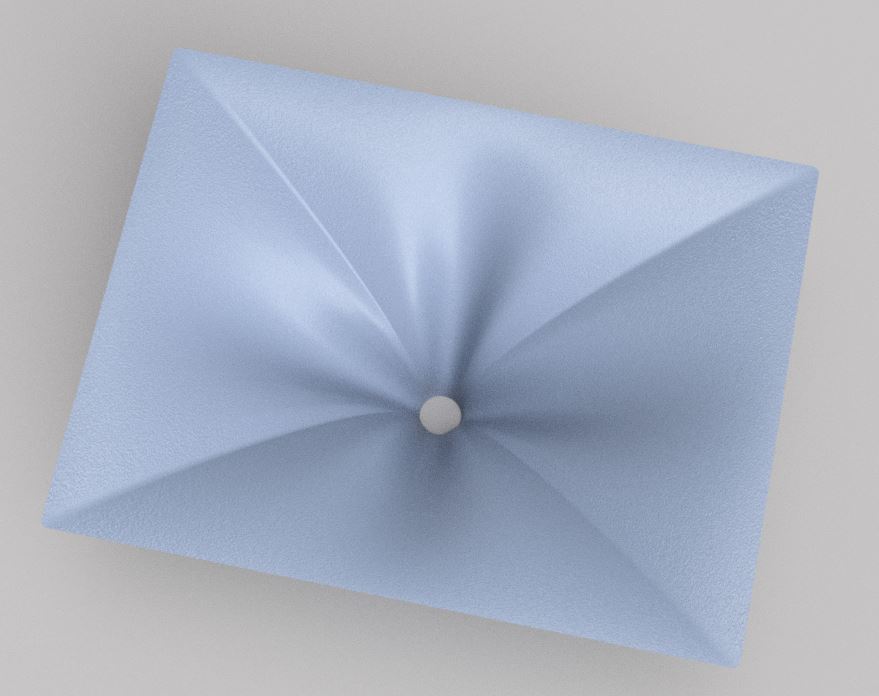

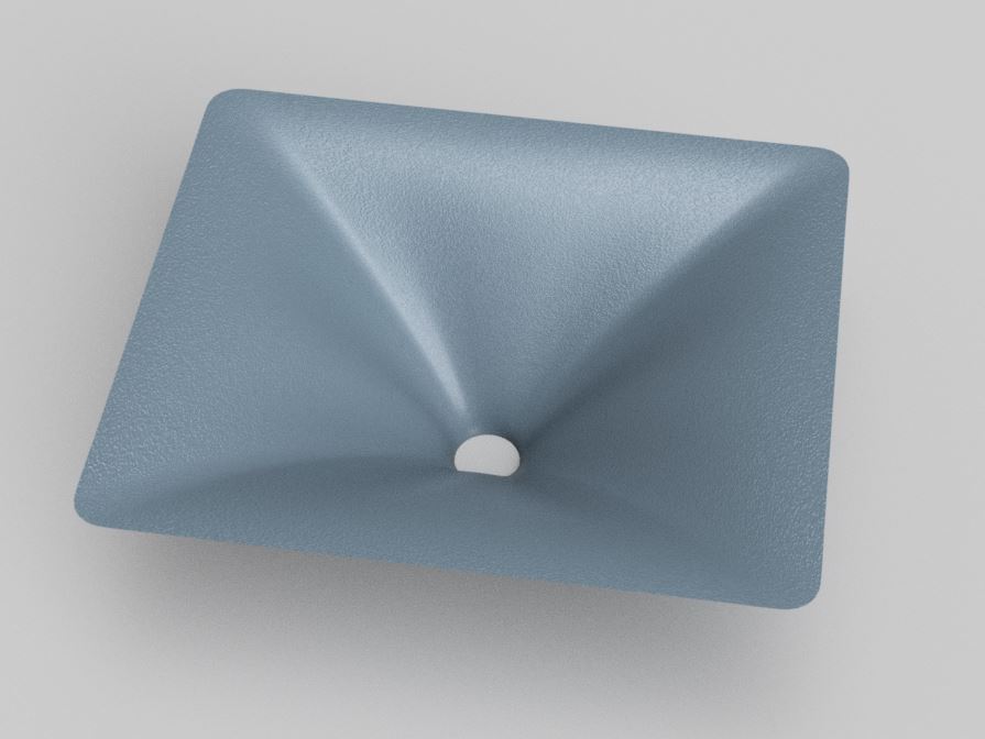

I have made a comparison of a deep and shallow version of my current best attempt at a rectangular guide trying to keep the outer dimensions as close as possible (400mm x 308mm). So not quite what you asked for but as the ABEC sims are already done maybe it is useful.
Image below side by side Deeper one (200mm) on the left shallower one (110mm) on the right.
And the radiation impedance. Red Deep blue shallow.

mabat, don't rush yourself.
Having said that, evidently I'm also looking forward to sims of freestanding ATH4s.
fluid, thanks for posting these sims!
As for the ripple, it seems that there is very little difference between the horns.
The short horn seems to exhibit even marginally more pronounced ripple.
Anyway, as far as I'm concerned, there's no sensible explanation.

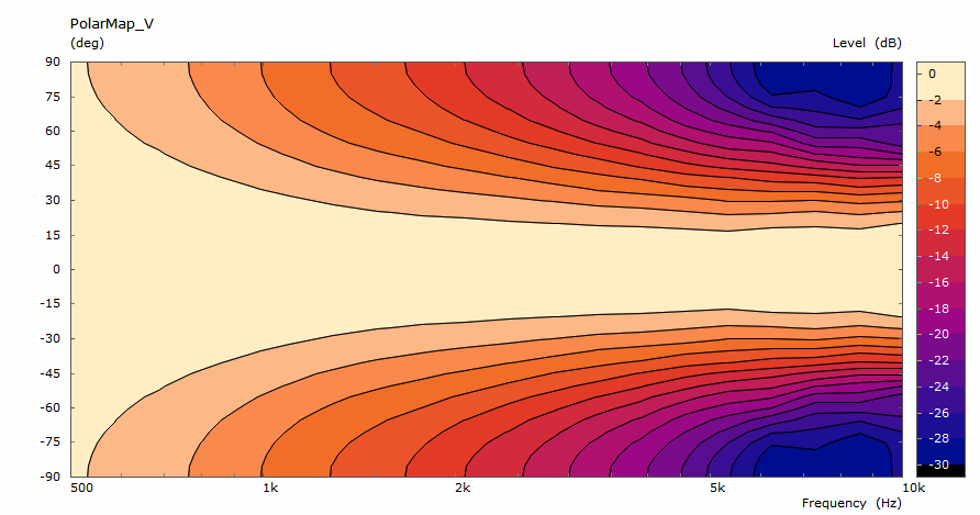

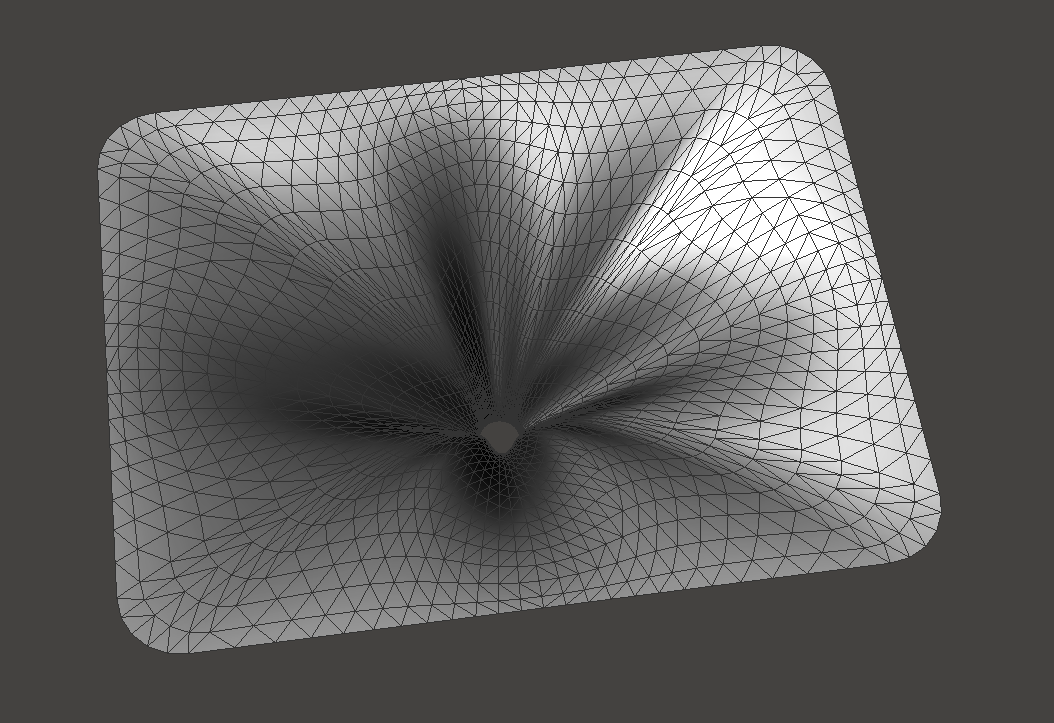

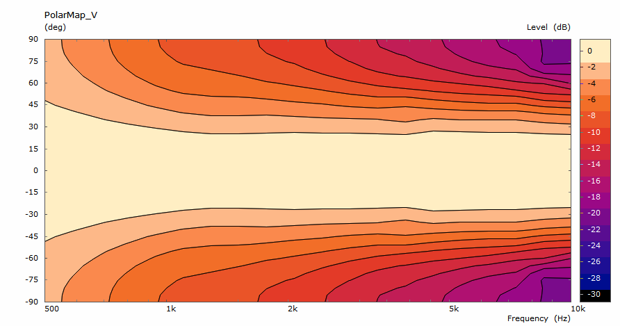

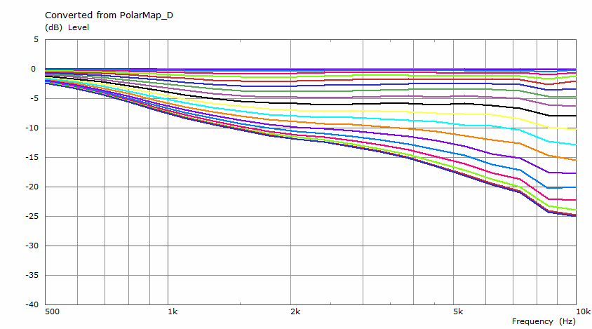

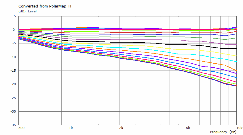

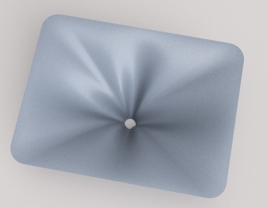

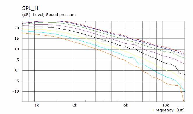

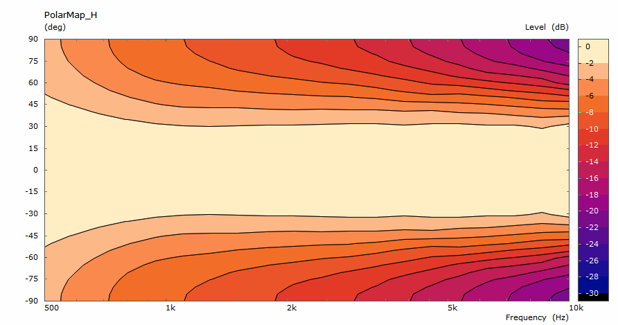

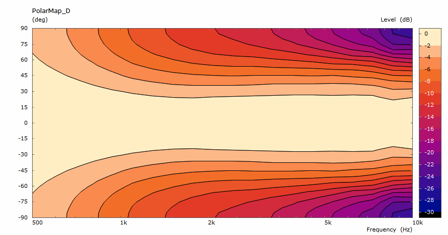

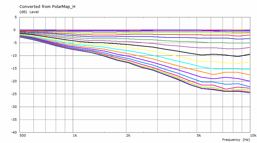

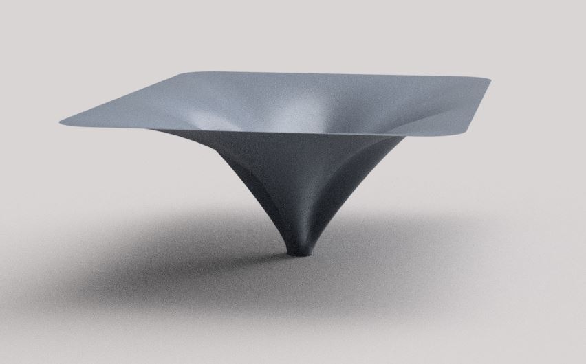

There was a request for a bigger version of one of my better designs. Here it is, 484 x 418 x 155 mm.
(It begins to be boring I guess... :) )
To satisfy Ro808's urge for classification, I would call this type of shape T-Horn (as Tritonia is the name of the speakers for which this waveguide was originally designed). I call it horn although it is a pretty good waveguide as well...

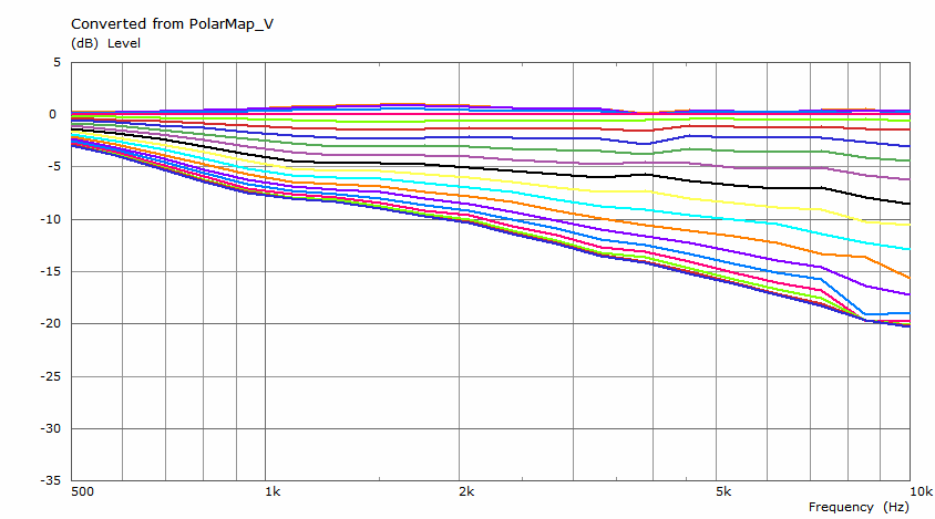

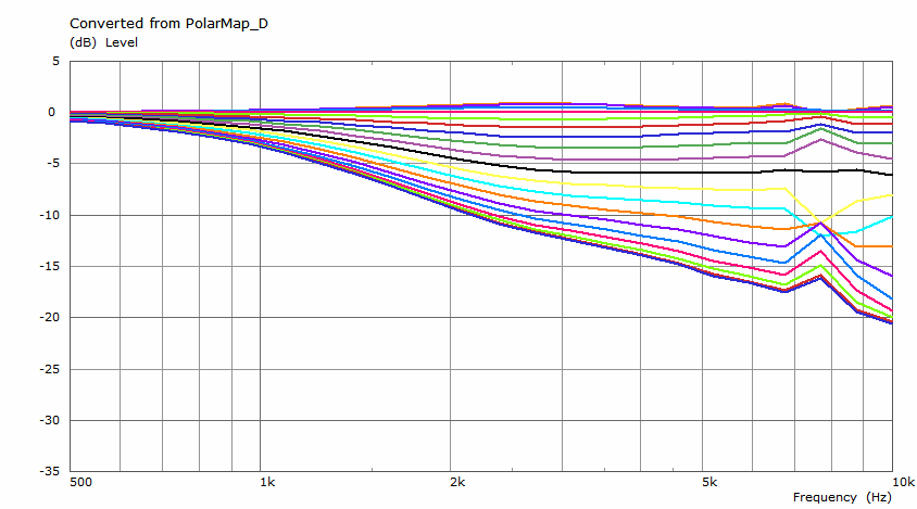

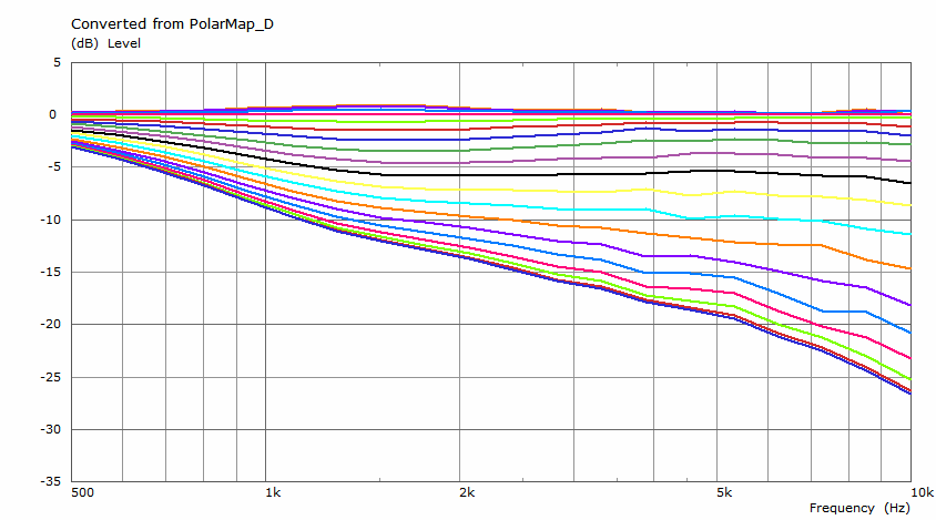

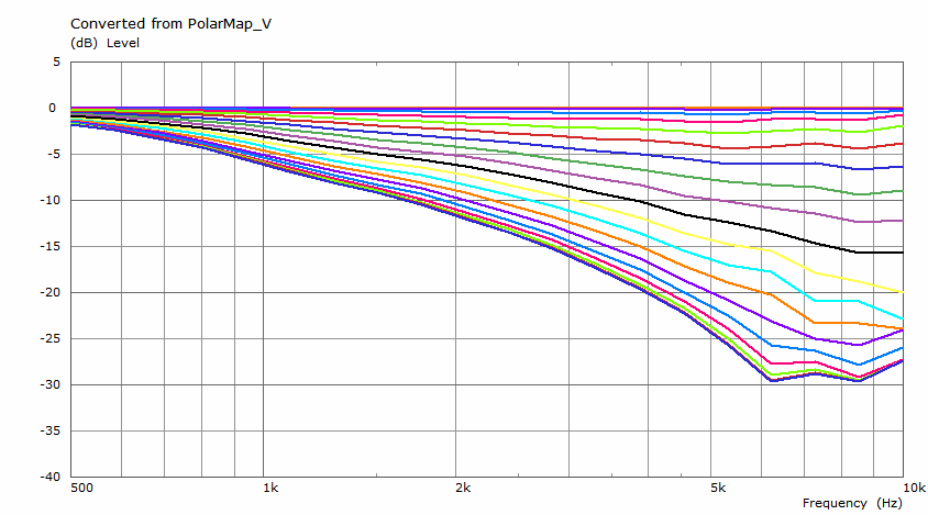

You're welcome :)

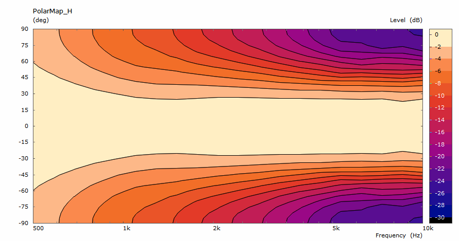

Any ripple or changes in shape shown in the Radiation Impedance can be traced back to the polar curves.
For example in the red graph there are a couple of bumps between 4.5 and 6.5 K, these can be seen in the polar curves.

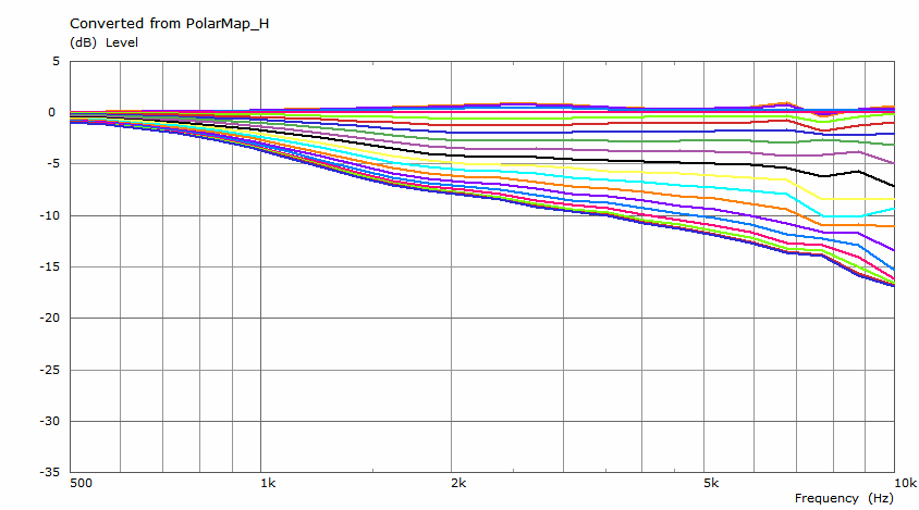

attachment.php
The Blue curve has a rise at the top, the shorter version has a rise in output across all curves so the cause for that appearing is clear.
The smoother the polar curves the smoother the Radiation Impedance is. So in that sense the reason for the ripples in the graph is clear. Whether they will appear in reality is another question. I am not so sure that they are just sim artefacts that can be completely ignored if you are aiming to make the best waveguide possible through simulation. Having said that finding a way to get rid of them without making everything else worse is very difficult and as mabat said totally unintuitive. Most of my good results came more by accident that intention :rolleyes: But working with these simulations is giving me a better idea of what is working and what is not. I haven't got to why though.
I have tried a finer mesh and more frequencies on one simulation to see if that helped. It only made things look worse, not better.
What seems more important to me is how smooth these are in general, in the paragraph you linked before, finite exponential and conical horns showed quite considerable ripple. The ones from Ath look much more like the infinite exponential shown which I think is a real positive.
