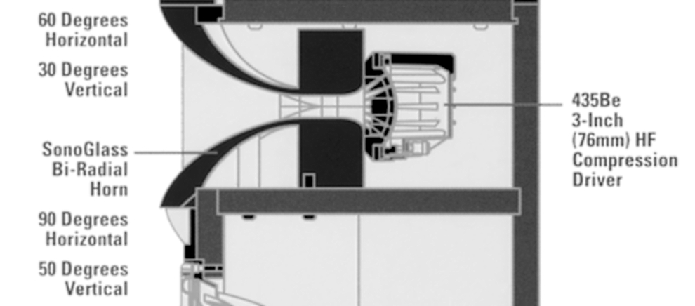

The throats as showed can be easily simulated with Ath (as OS with negative throat angle). They extend pattern control to higher frequencies but also have their drawbacks, they resonate easily. It could be compensated, at least in principle, but I don't think this is a good idea.
What interests me is the fact that the JBL 2435 appears to work best with traditional horns.
There is a negative angle in the phase plug, but the driver also has a relatively large back chamber.

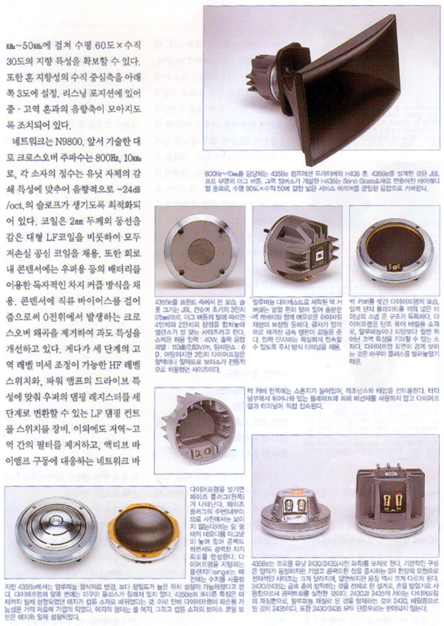

The 4" JBL 245. drivers - with a smaller back chamber and more advanced phase plugs - seem to be specifically designed for waveguides.

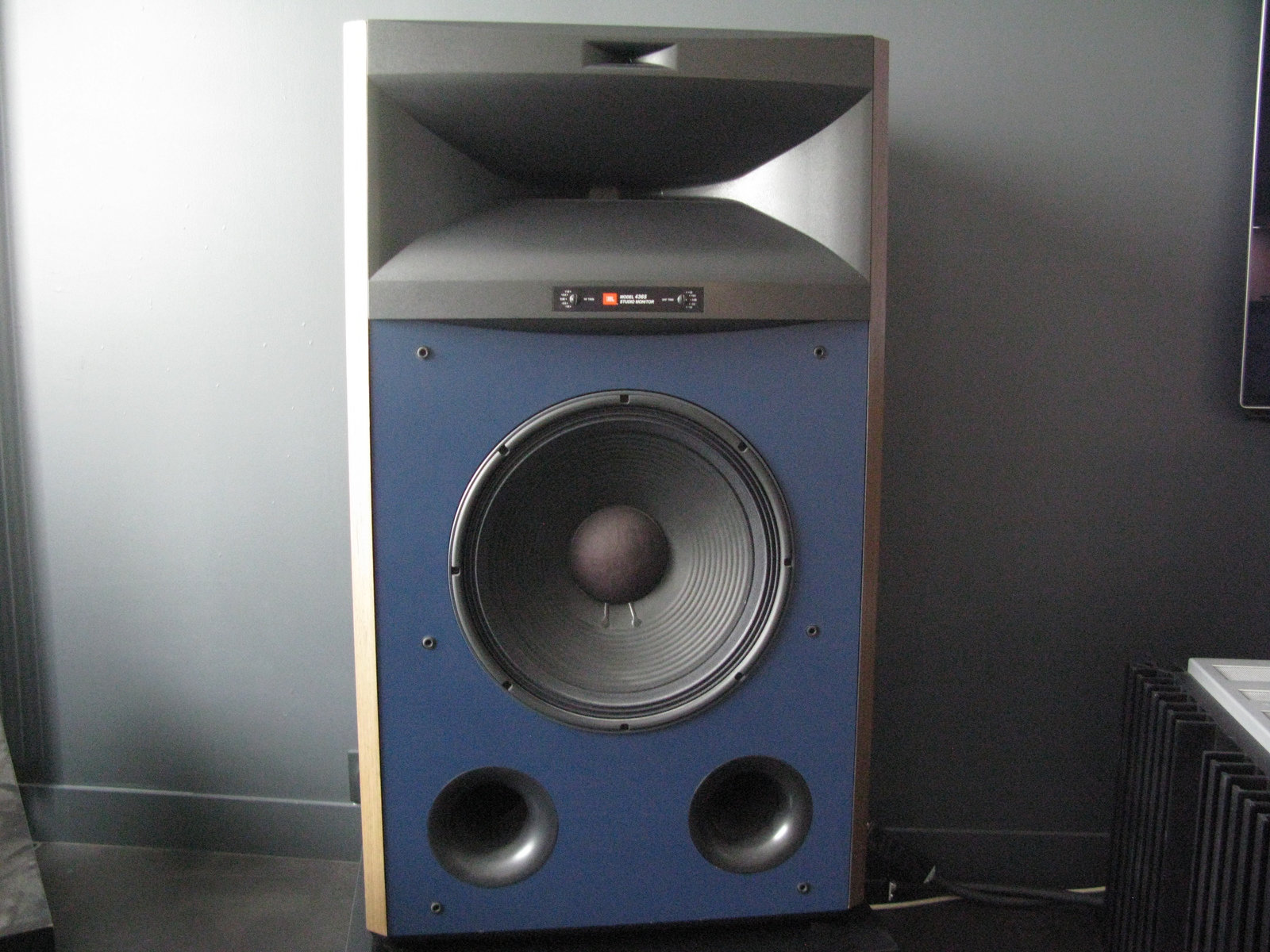

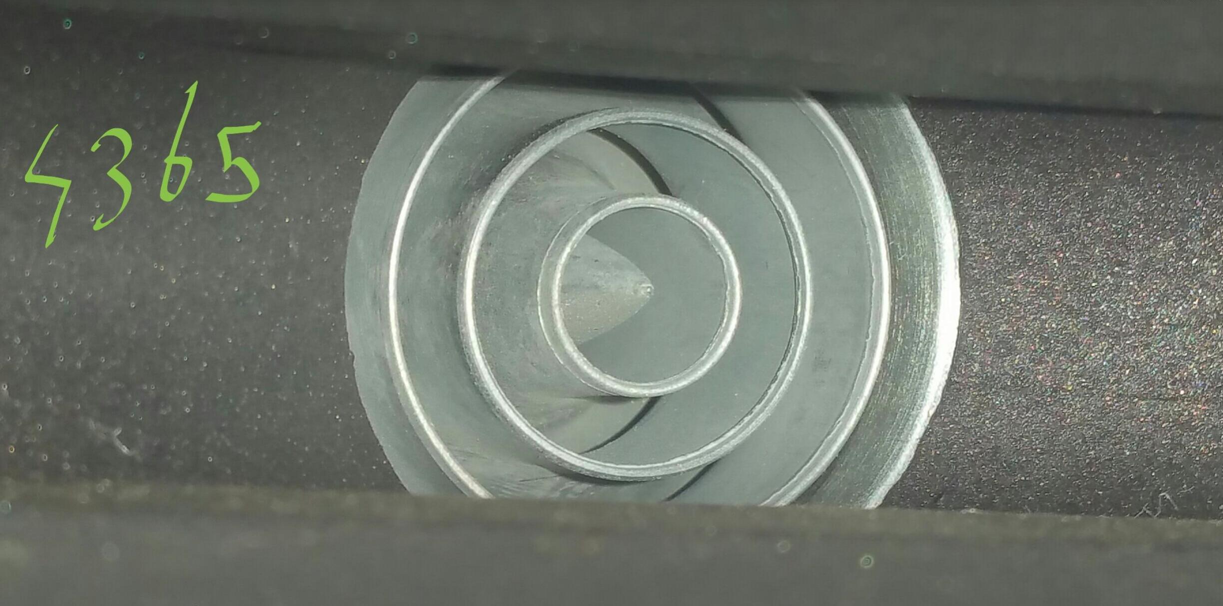

Another classic horn in JBL's 4367 predecessor, the 4365.

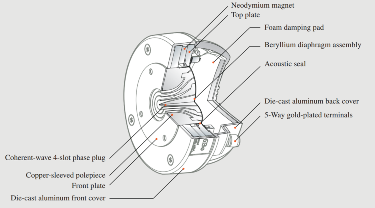

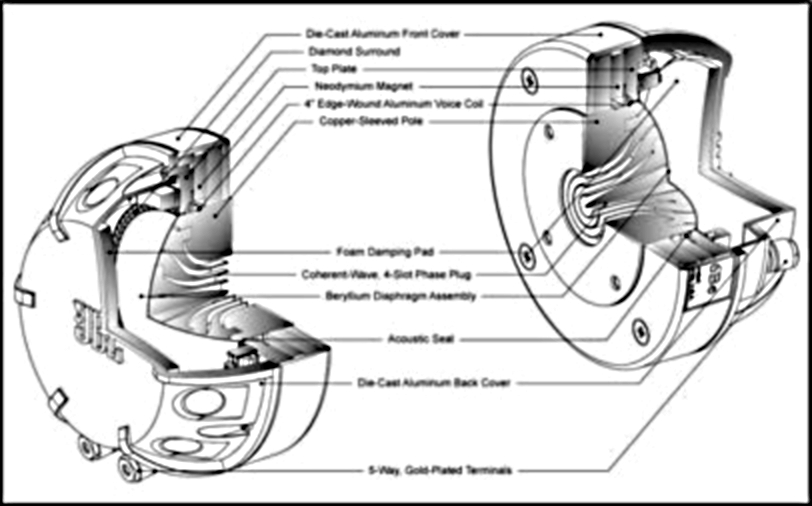

The compression driver attached to the mid/high horn is the 476Mg, with Magnesium Alloy diaphragm, instead of Beryllium (476Be).

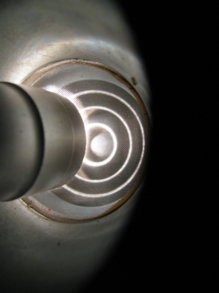

A close up reveals the rapid-flare, coherent-wave, four-slot phase plug.

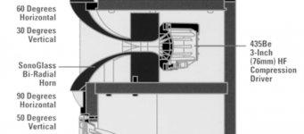

How do you know it is coherent-wave? What do you mean by that?...A close up reveals the rapid-flare, coherent-wave, four-slot phase plug.
That's what JBL wrote in the docs apparently, you can decipher it's written this on the cut drawing (fourth picture)

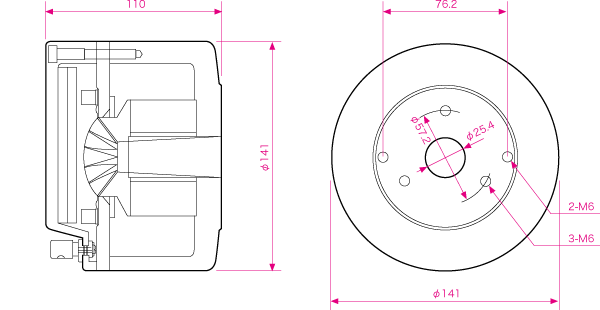

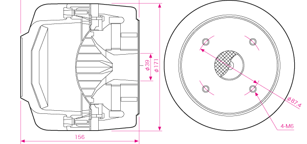

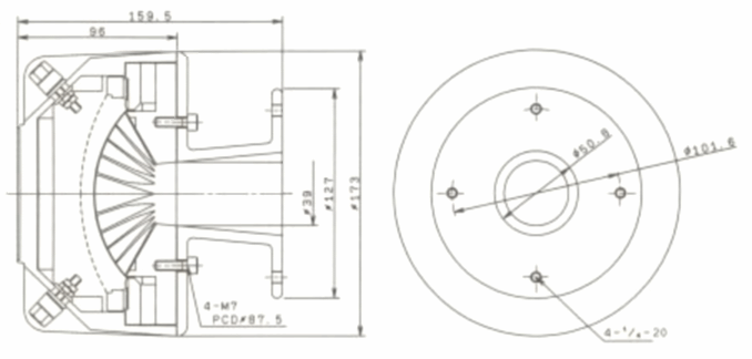

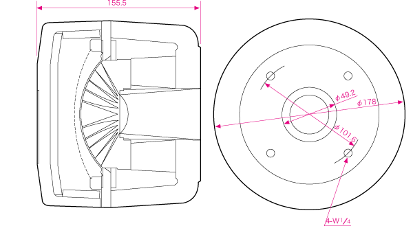

Anyway, here are the TADs, from left to right: TD-2001, TD-4001, TD-4002, TD-4003.
There's one particular driver I have a bead on. It's supposed to be superior to nearly all highly regarded large format drivers (including the Radian 950 Be PB) and should even outperform some of the best 1" drivers in the top octave. There's one potential caveat; the phase plug doesn't end at the exit. IOW, it's got a conical exit section
![yikes :yikes: :yikes:](https://files.diyaudio.com/forums/images/smilies/yikes.gif)

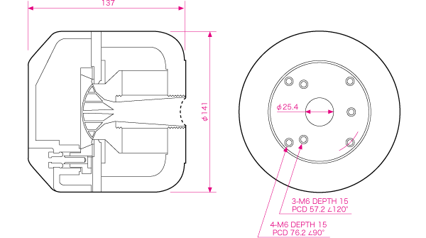

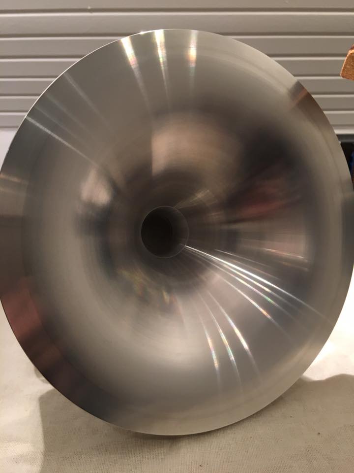

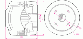

The first drawing is of the TD-2002, attached is the correct drawing of the TD-2001 as well as a TAD TD-2002 with an Aluminium 'Spherical Wave' horn.

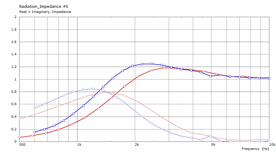

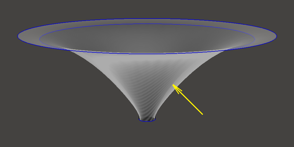

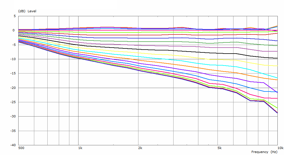

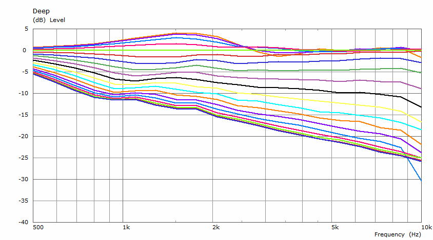

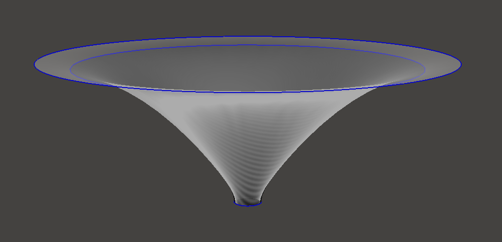

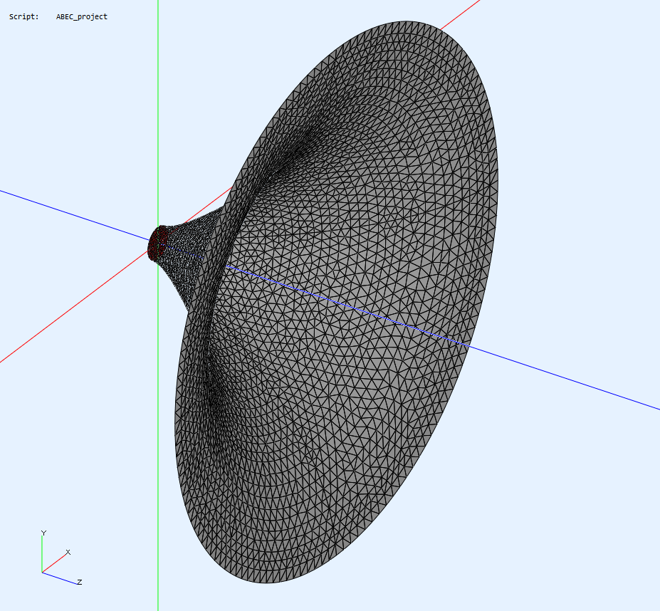

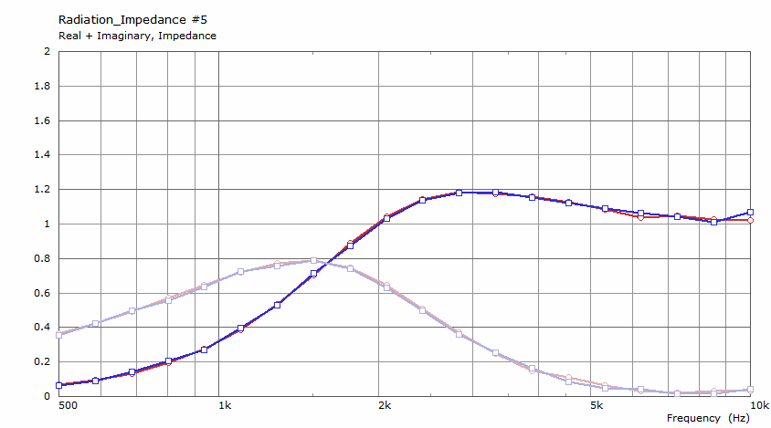

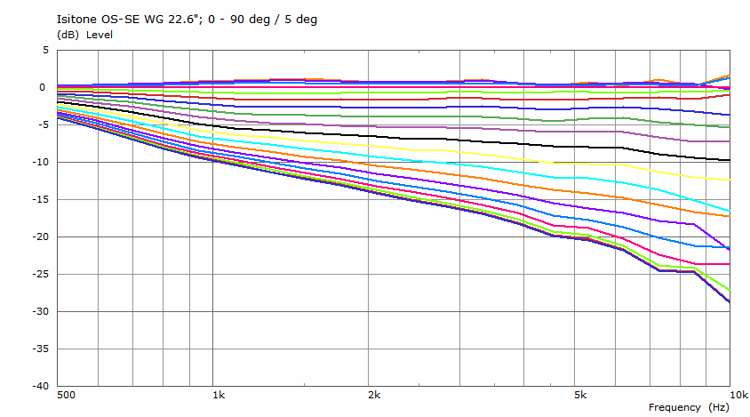

If one is willing to 1) go non-axisymmetric and 2) tolerate the slightly non-axisymmetric radiation pattern, it is possible to increase the throat impedance a bit by making the vertical coverage a little narrower.
This is the comparison of two such waveguides (the bigger is the one from #2333). The smaller one has a slightly narrower nominal vertical coverage. The mouth is circular in both cases.

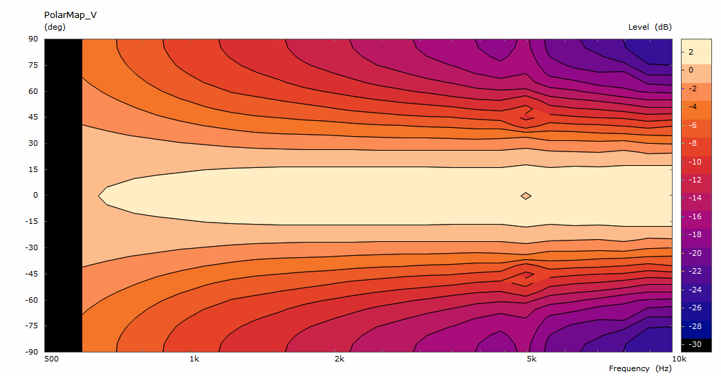

Horizontally (basically the same):
Vertically (the yellow arrow indicates a boundary of the narrower one):
And the impedances (blue = the smaller one, with narrowed vertical):

Out of curiosity I took the OS waveguide from #2333, kept the overal diameter and nominal coverage but decreased the round-over "radius" (so the length had to be increased):
The original one:
The longer one:
The impedances are virtually the same, probably as expected.
The original one:
The longer one:
