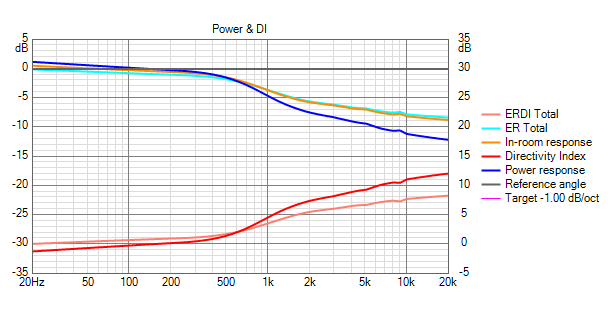

Wow, those distortion levels are pretty unbelievable. What's the reference level?
The conditions were not stated, but the measurements posted (not just this plot) are consistent with Beyma's.

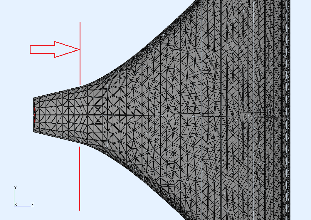

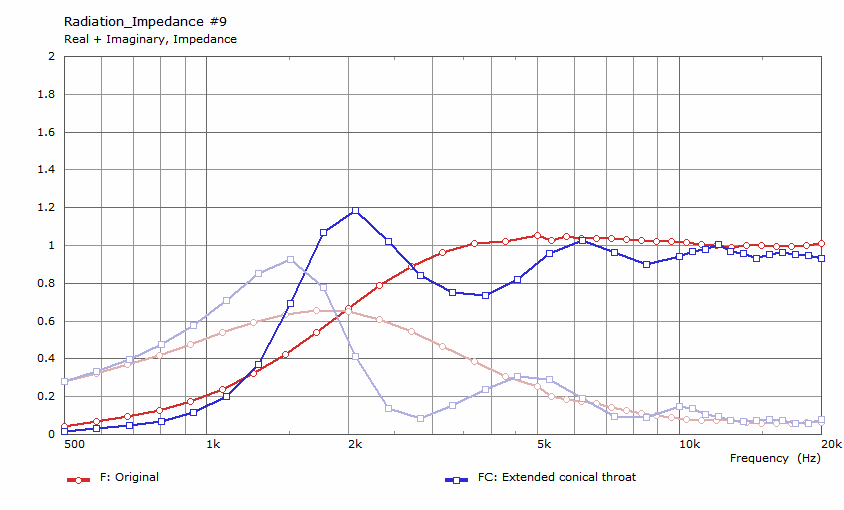

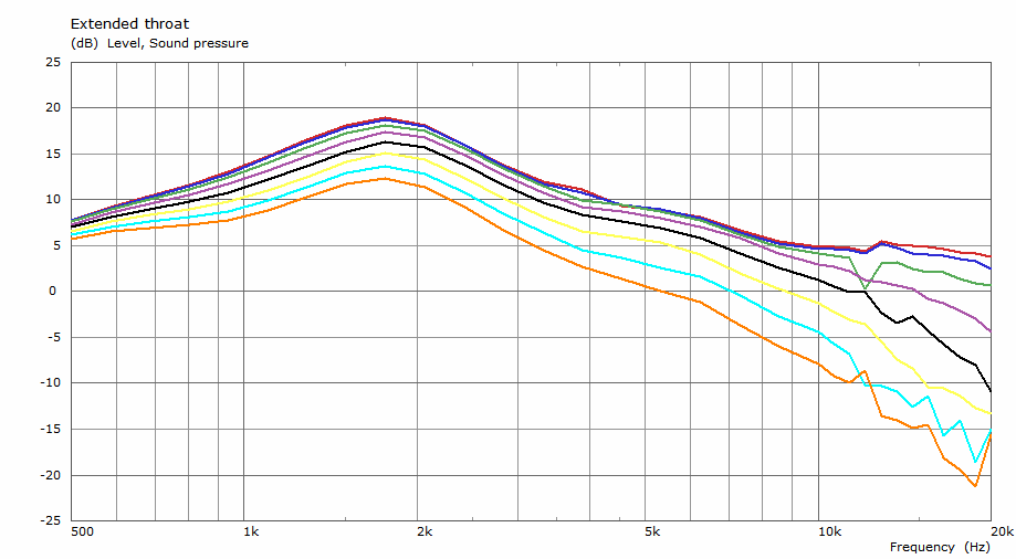

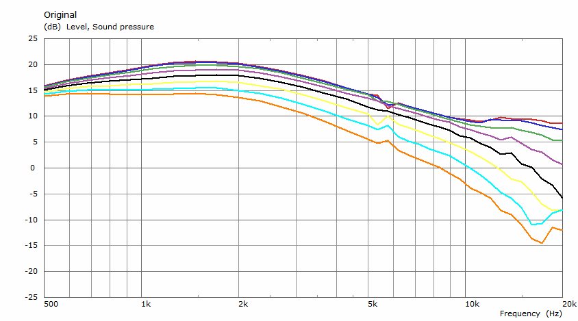

I have nothing much to add regarding nonlinear distortion but I have made an experiment with a conical throat extension, which I suppose is closer to what a majority of compression drivers look like (this in particular was aimed at BMS 4554).
- Original throat / driving diameter: 36 mm / 27° angle
- Extension length: 30 mm / driving diameter: 22 mm
Resulting acoustical impedances for the driving elements:
You sure are a master of your tools. I wish that I had that kind of capability back when.
Bravo!
I had always expected a reflection at a aperture where, even though the wall slopes are the same, the actual wavefronts are not - the coordinate systems are not the same at short distances, i.e. the throat. Hence, a reflection and wavy impedances.
This is why I switched from the DE250 to the DE500 - shorter throat extension.

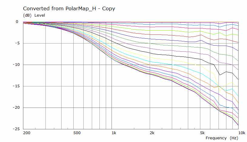

mabat can you explain what you did to get VACS to display the normalised polar data as SPL curves like this?
I have tried to work it out myself but got nowhere
I want to be able to export the data into Vituix to look at the DI of different guides. I can get the text export of the separated curves to work but the normalized polar data should work better for half space DI comparison.

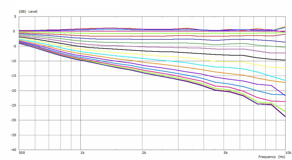

For a polar map go to menu Graph - convert curves <-> countour, i.e. these polars are converted from polar map data. Polar maps can be normalized to any angle you want by Processing - Normalizing... prior to that (and this also works for any SPL chart if you normalize "to original curve"). Beware that by default these maps are already normalized to 20° (a safe bet for the most part) - this can't be changed in the older versions of the tool but you can change that manually in VACS as just described.
I wondered why is that and this is actually a very intuitive explanation.I had always expected a reflection at a aperture where, even though the wall slopes are the same, the actual wavefronts are not [...] Hence, a reflection and wavy impedances.
Frankly I don't remember but probably yes.When you made the DI curve in Vituix did you just manually rename the ABEC text files to represent the correct angles?
And BTW, for a DI curve alone you don't have to normalize the data, it makes no difference.
