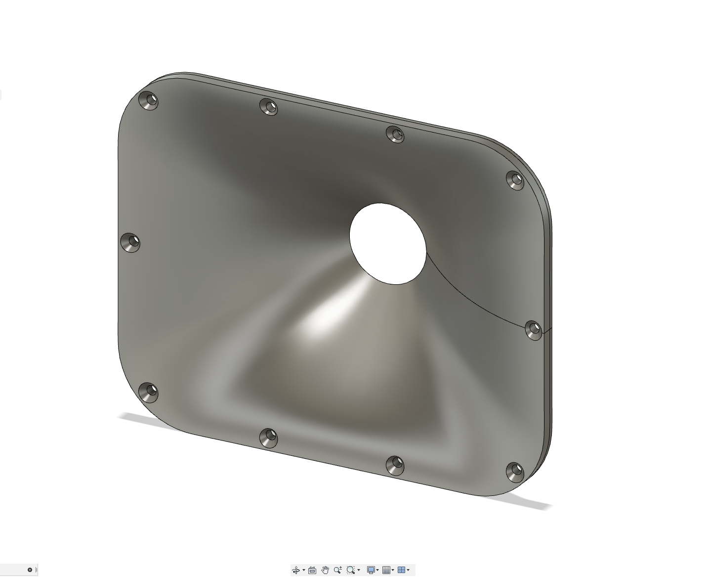

here the two .stl's if anyone wants to compare. In F360 with the two overlaid, they are basically the same at the vertical and horizontal axis (as expected) but diverge a bit in between. Specifically the actual F360 design stays a bit smaller radius as you move away from the vertical axis to the horizontal. In Desmo the only way to do this is go below u=2. Now if I move the ATH produced mesh vertically until it is completely above the original F360 design requires a distance of .035 mm, which is pretty small, but maybe big enough to suggest some difference other than the rounding, etc., I noted above?
It may help to increase the STL resolution in ATH (i.e. increase the number of segments). As it is now they differ quite a lot.here the two .stl's if anyone wants to compare. ...
For this it's better to turn off the output of an ABEC project, keep just the STL output. It will run faster.
You could subtract a bit from the radius diagonally - centered at whatever angle. That would only require another sine term(s) - nothing limits you to just one. You can "shape" the radius value around the circle as you wish - kind of like a Fourier series....Specifically the actual F360 design stays a bit smaller radius as you move away from the vertical axis to the horizontal. In Desmo the only way to do this is go below u=2.

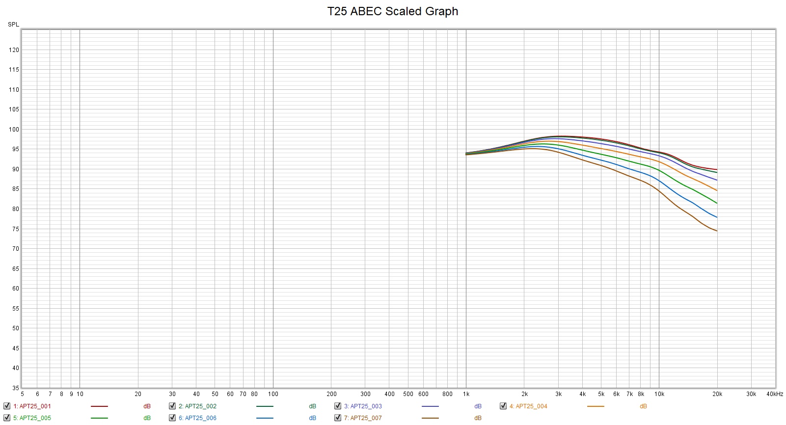

.cfg here if anyone wants to see how the sausage was made. Could use some feedback on the ABEC settings, everything look optimized? The mesh segments aren't exactly the same as I used in F360 Loft function, mostly because I'm not sure they are doing exactly the same thing, but I may set both to 28, which is what I did when Lofting. Then I'm going to tweak the element weights a bit. Later on today I'll also put up results for the SB26ADC on my 5"x.75" deep vH waveguide. If that comes as close as this T25B sim has, this will considerably speed up waveguide development!

Played with source weights, and ended up leaving it at 1, .75, and .25. Higher values on the two surround sources was definitely not correct, .66 and .22 actually might even be better than .75 and .25, but the difference was small so I just went back to mabat's default values.
Also played with the delays at .00001 plus or minus an order of magnitude. Nothing really caused the sim result to suddenly look closer to actual measurements, so I went back to 0 on those values too. I'll return to this value again at some point.

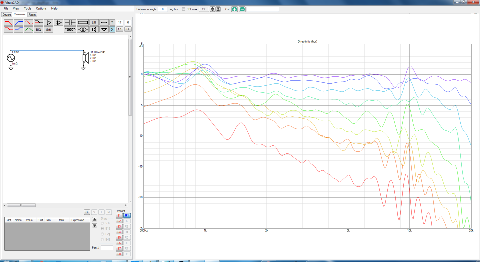

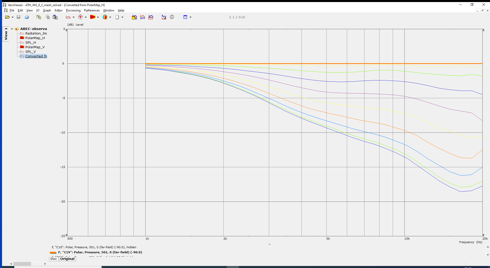

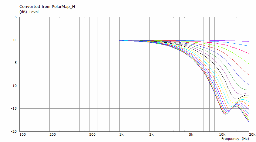

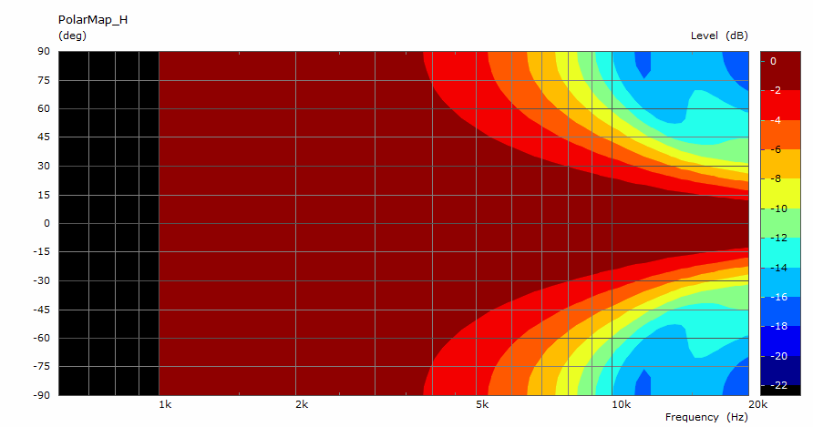

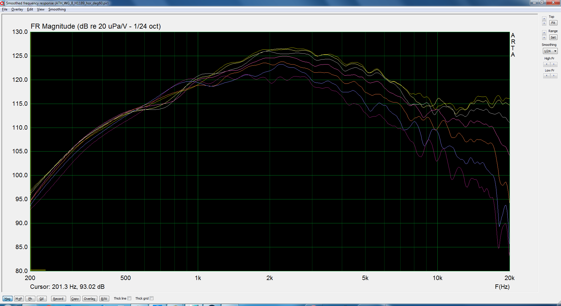

I took the bidland's tweeter model and simulated it alone in an infinite baffle. Then I also changed the weights of the surround contribution as jcarothers suggested - these are the black curves (0, 30, 60 deg):

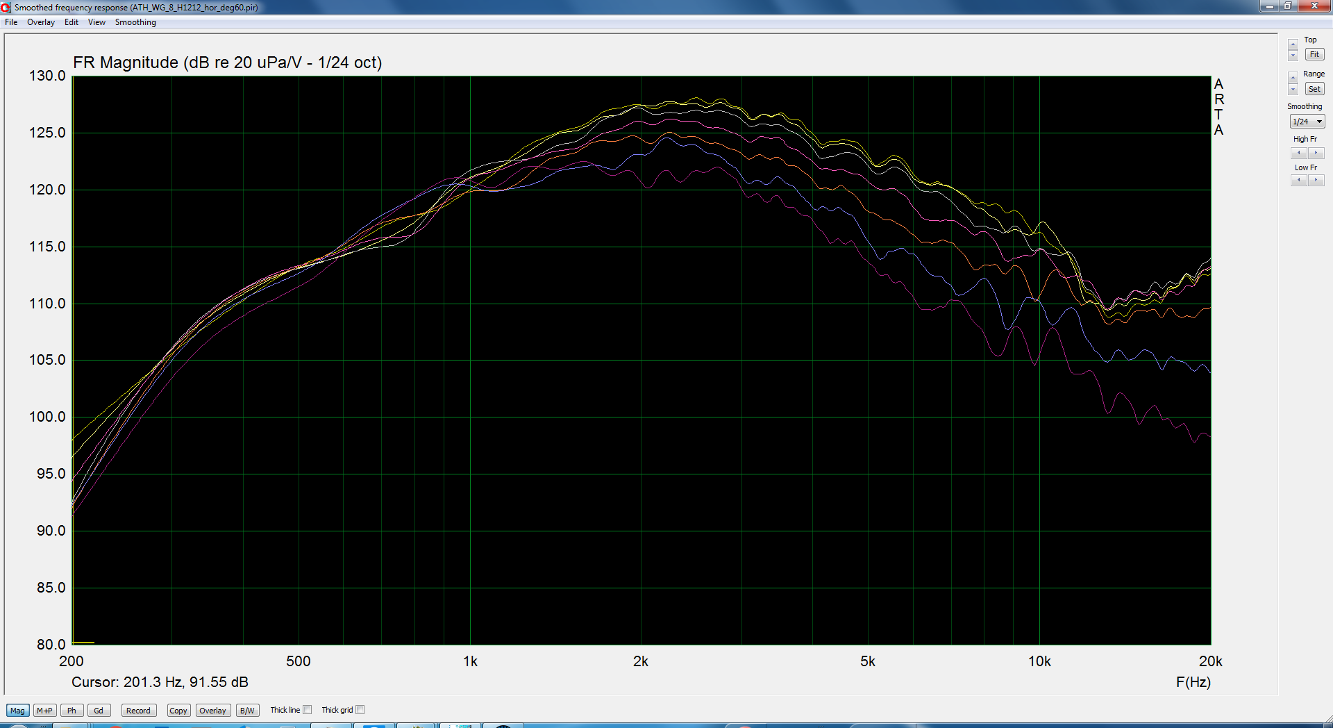

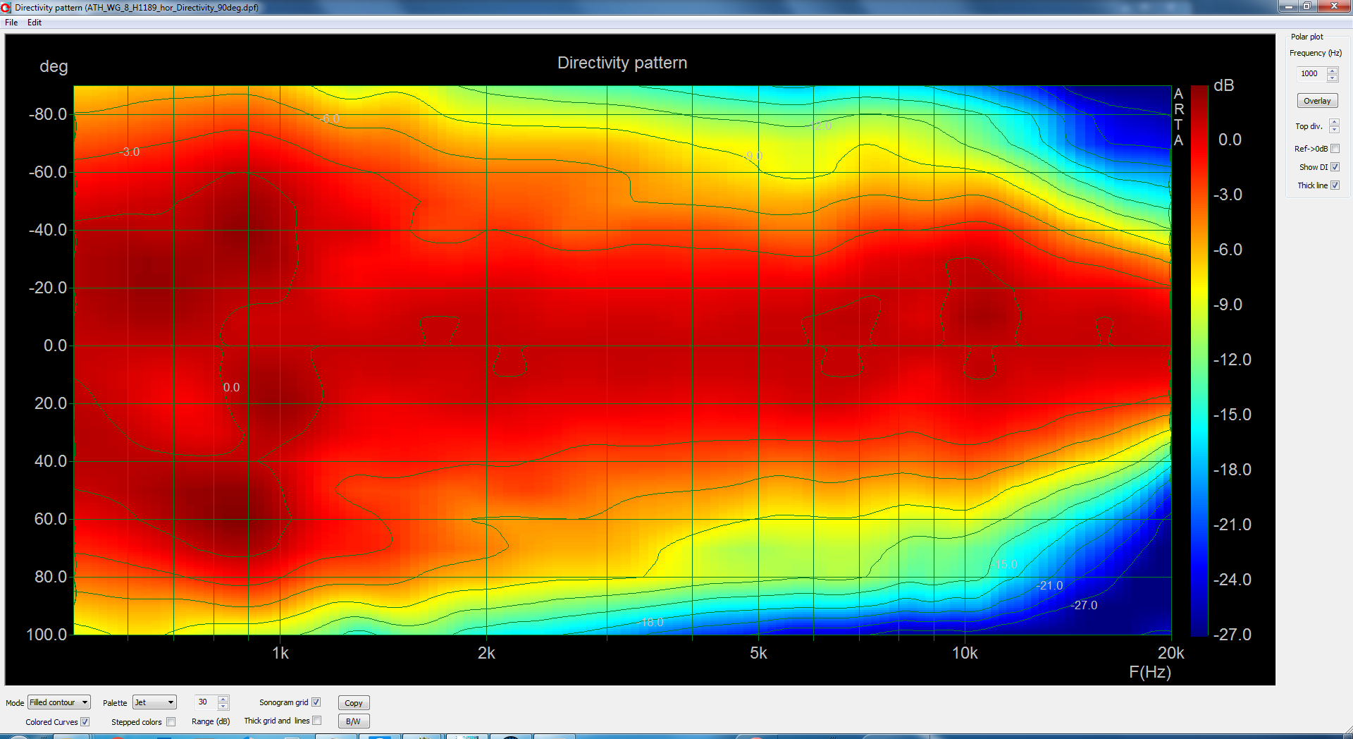

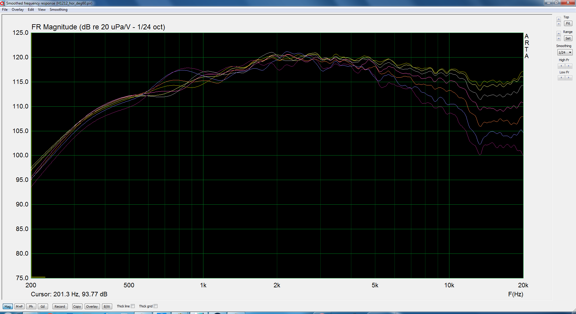

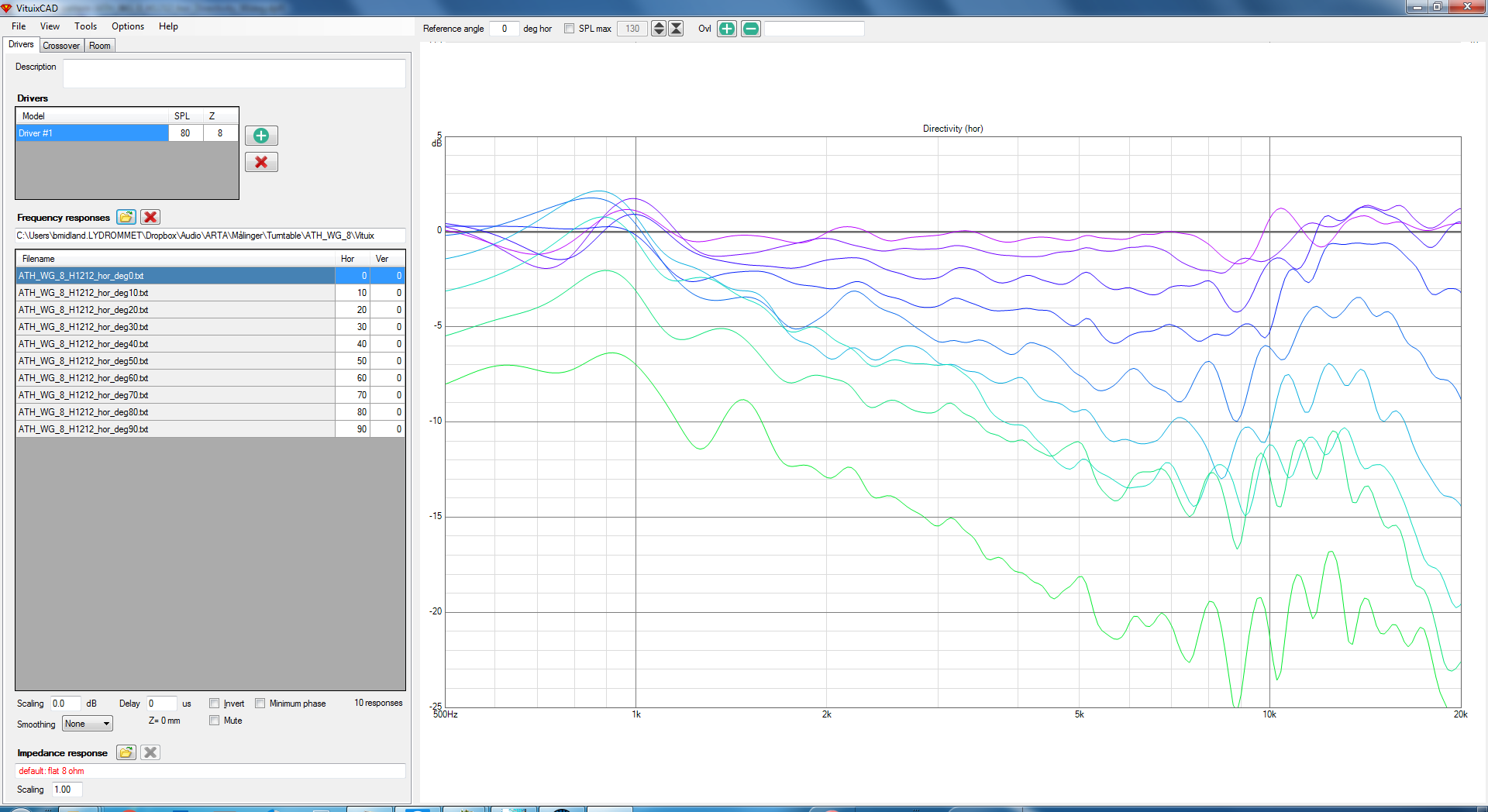

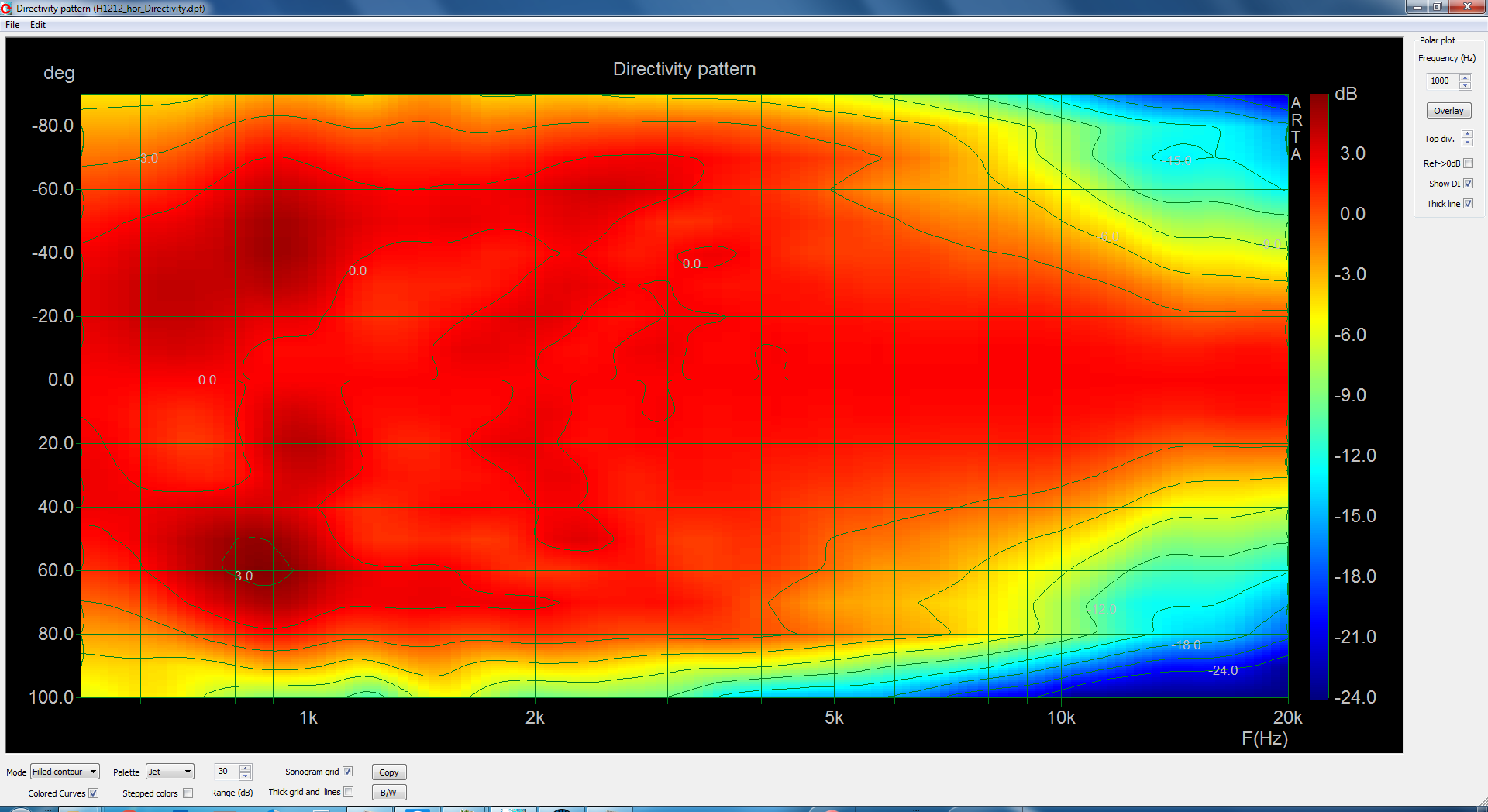

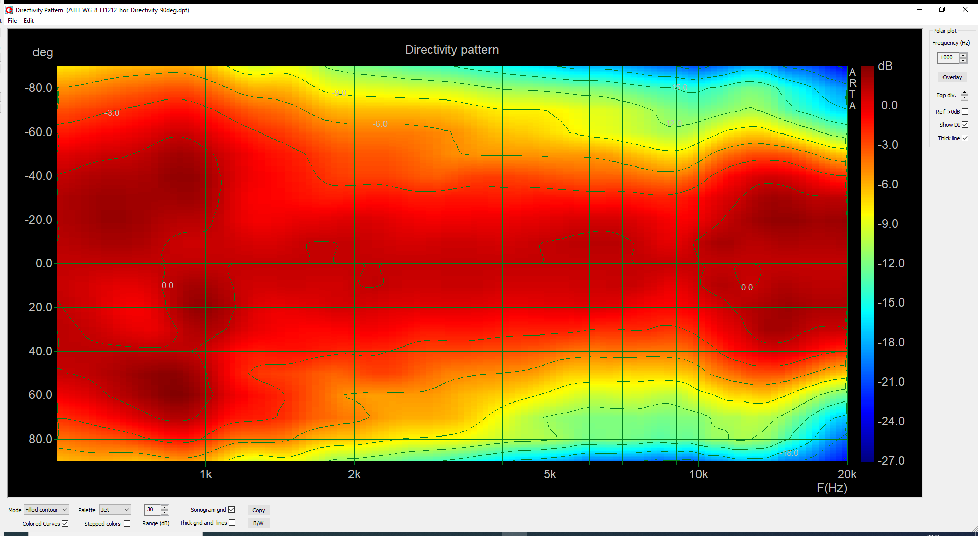

Here are measured responses compared with your simulation.
Baffle is 600 x 800mm, so there are some diffraction effects but driver is placed off-center to minimize this.
This is the Seas H1212 with grille removed, no waveguide.
Same H1212 tweeter, now in the 8th 3D-printed version, ABEC model compared with the measured prototype.
Some difference above 10 kHz, but overall I think the response is pretty good.
I ran your file to see if there would be an easy way to set the scales in ABEC to match your Soundeasy graph. It's easy to set the scales but the response doesn't scale with it. If the model is using an LE Script an input voltage and dB output make it work but not with a constant acceleration source.
Anyway I did it the hard way exporting and importing the traces into REW. Graph attached for reference.
Thanks, bidland! Pretty good indeed.
In case of the H1212 waveguide, there's obviously something happening above 10 kHz that is not covered in the model. I wonder what that could be and whether we are able to include it. That would be interesting to find out. So is it something about the hard vs. soft dome?
In any case, these are already very good results, at least IMO.
