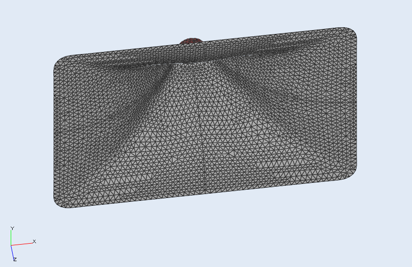

It would be really cool to be able to set that up in ATH directly, but in the meantime I'm trying to modify demo1 manually for CircSym.
I updated Dim=CircSym and MeshFrequency=50000 in the solving.txt, and it appears to solve the BEM very quickly. When I try to solve the spectra, however, I get the following errors:
What am I missing?

I've never tried to use the same mesh file for CircSym as for 3D but I think it won't work that way, based on what's in the documentation. I think that for a CircSym you really need a different boundary representation, i.e. a list of 2D points (axial, radial coordinates) and line segments between them as the boundary elements, i.e a completely different project.
As I work on it, it will be possible to define a profile index for which a CircSym project will be generated.

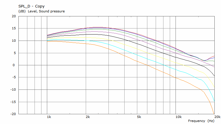

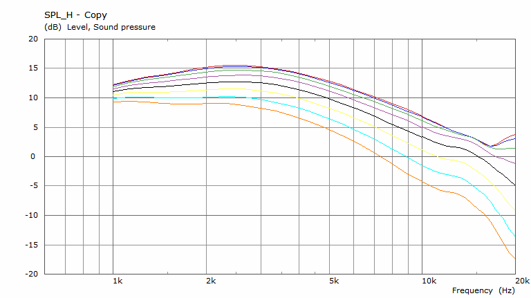

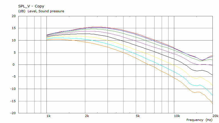

Some results from this morning - rectangular waveguide 280 x 200 x 90 mm (quite small), 1" throat:
(0 - 52.5 / 7.5 deg; infinite baffle)

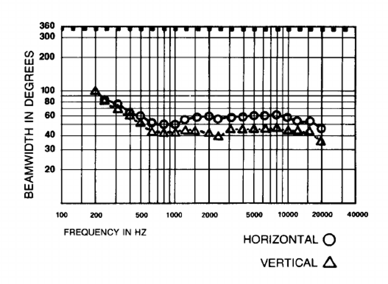

Mark, for synergy horns, an asymmetrical mouth with respect to opening angles would work wonders in combatting pattern flip,
as C-C spacing is irrelevant.
An example of a 60 x 40° horn, with mouth dimensions: 28 x 32" (W X H).

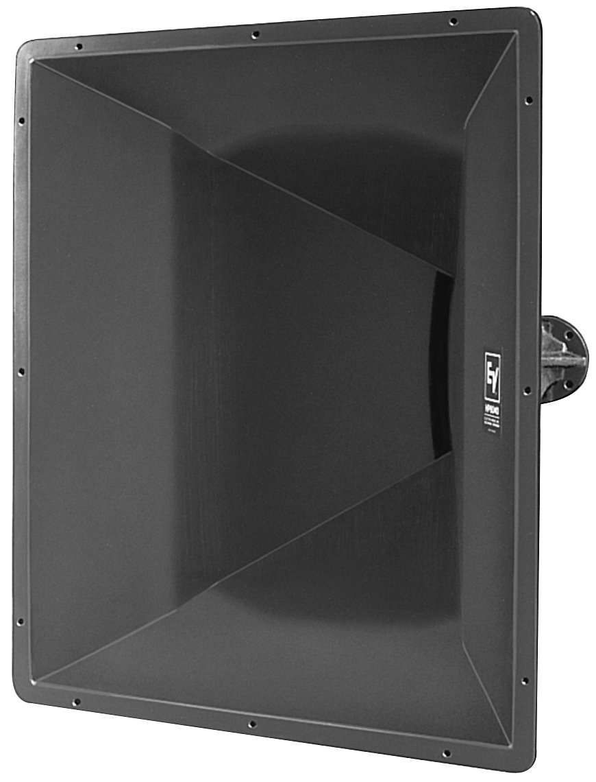

Hi Ro808,
Do you know if that horn had a secondary flare?
I've built synergies (WxH) 90x60 (49x28") , 60x40 (48x28"), and 60x60 (30x30") .
All were helped by secondary flares, in theory with Keele's classic paper and in practice with BWaslo's synergy spreadsheet calcs.
Yes, although more pronounced in the horizontal plane.
