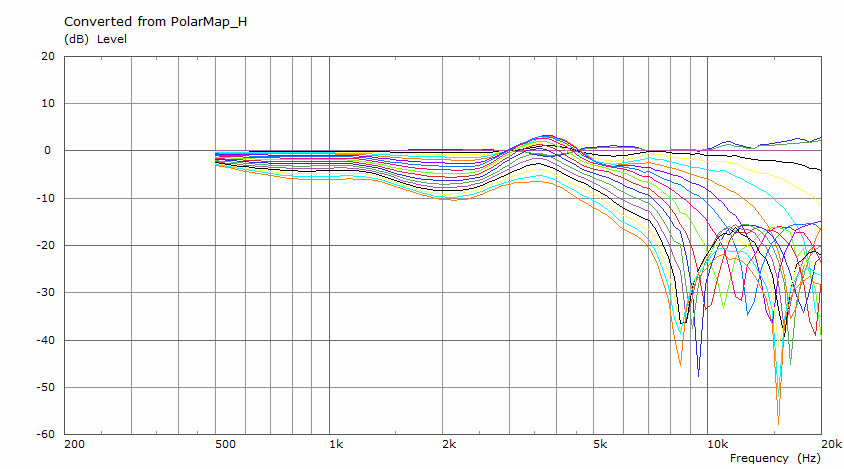

So some (?mild) decrease in beaming with OS, but high frequency drop-off v the beaming horn.
Patrick Bateman frequently says that at high frequencies the soundwave doesn't "see" the walls of the WG and beams. Mr. Geddes has said that the beamwidth of an OS horn at high frequencies can be wider than the throat size would suggest. I think your sims have shown this, too. Maybe 2" is simply too much.

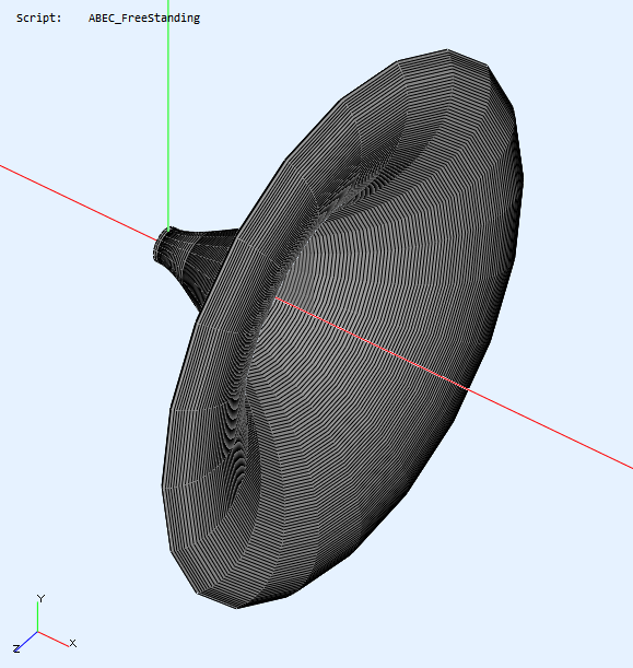

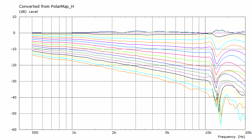

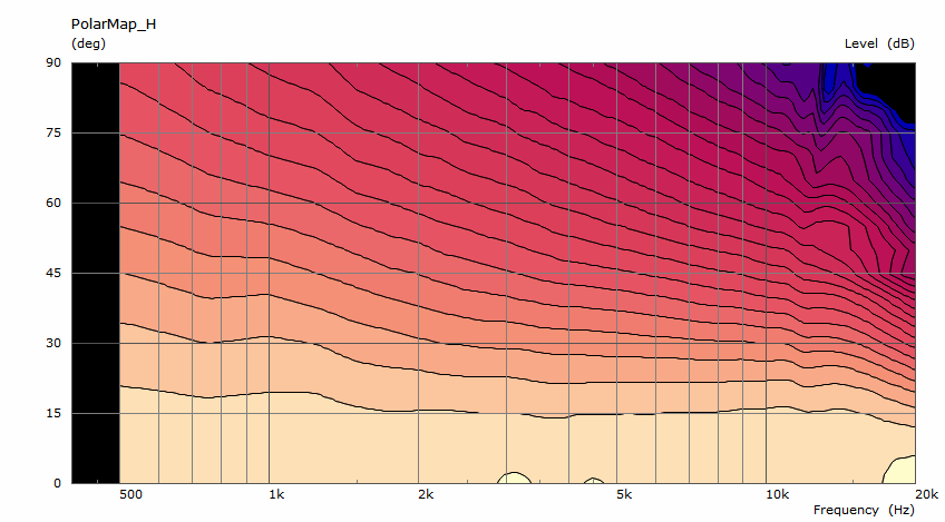

Well this is about the kind of beaming you would have to accept if you used a 2" driver like the big Celestion, at least without employing any diffraction techniques. This is about the best I can get out of it - maybe someone else could do better. Honestly, I don't know if this is exactly what to go for. Maybe.
(⌀800 x 376 mm).
OS waveguide of a similar size - pick your poison.
At this size, I'd take the first one. Why?

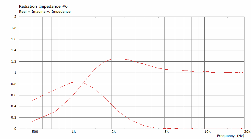

The OS-throat doesn't yield significantly better directivity, whereas the first horn provides better loading > 0.8 at 450Hz versus 870Hz.
Dr. Geddes has stated several times that loading isn't as important today as it was in the past.
I tend to agree to some extent. Once you'd like to use a driver down to 600Hz, or even lower, you're gonna need a horn that 'helps the driver'.

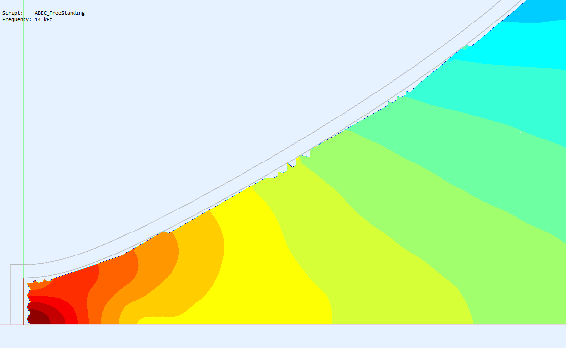

A 2" exit driver may support wide coverage, even in the top octave, but this depends on the construction of the driver, more specifically: the phase plug and the exit (section).
With 1" exit drivers, the small waves in the top octave are more or less pulled out of the OS-throat and 'forced to stick to the horn walls'.
This is the magic of OS-waveguides.
The "pulling-out" works the same in a case of 2" driver, only not as high as for a 1" - not for as wide coverage angles. Anyway, it's a rather mild effect.

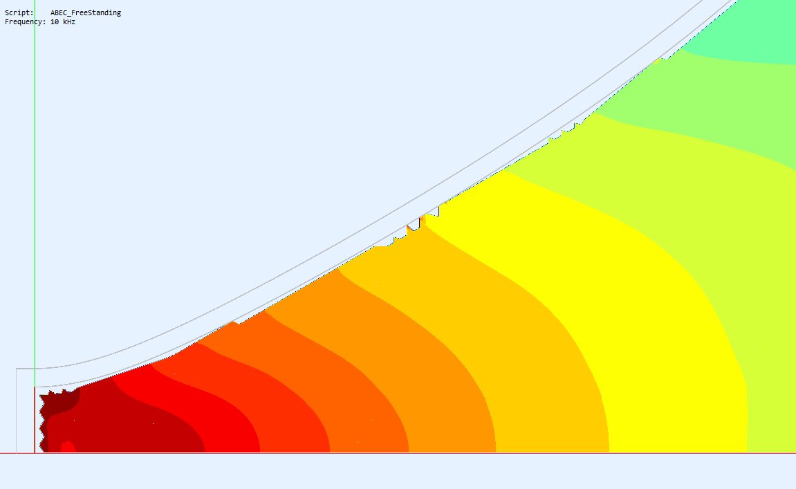

Attached is a simulation of a bare 2" driver in free field.
Do you know such 2" drivers?2" exit driver may support wide coverage, even in the top octave, but this depends on the construction of the driver, more specifically: the phase plug and the exit (section).

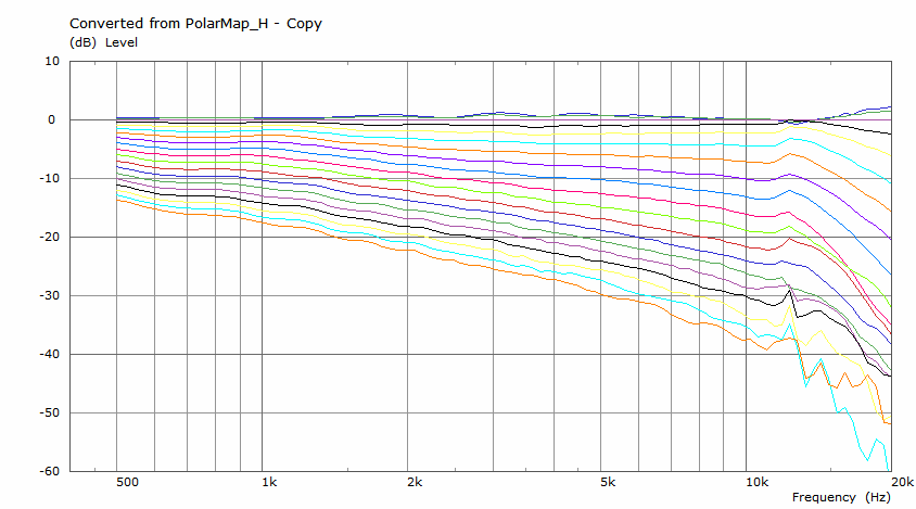

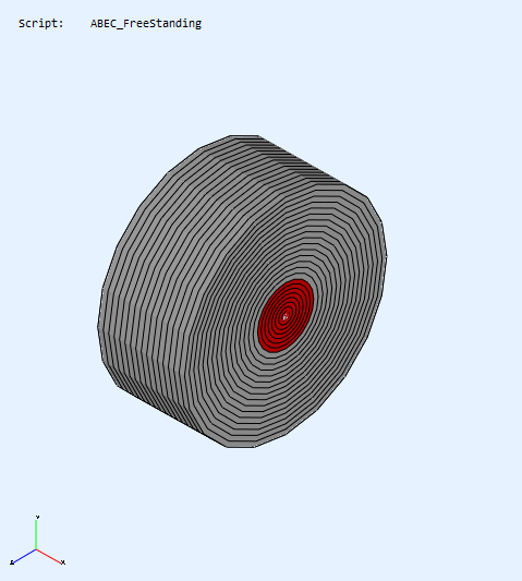

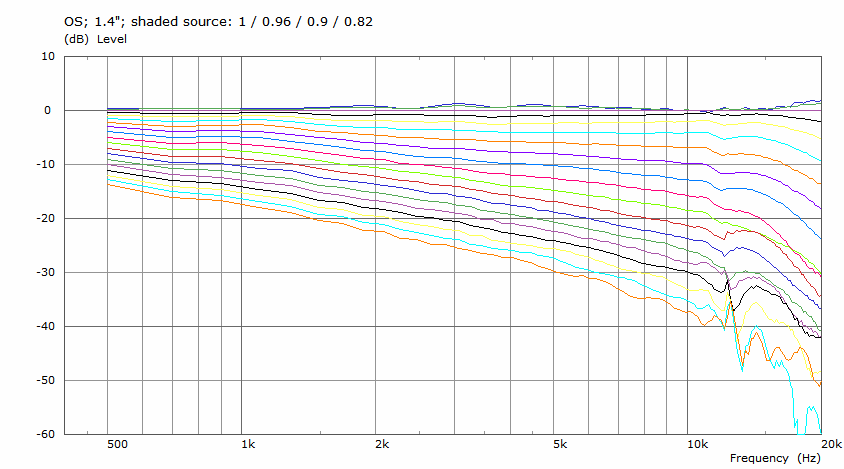

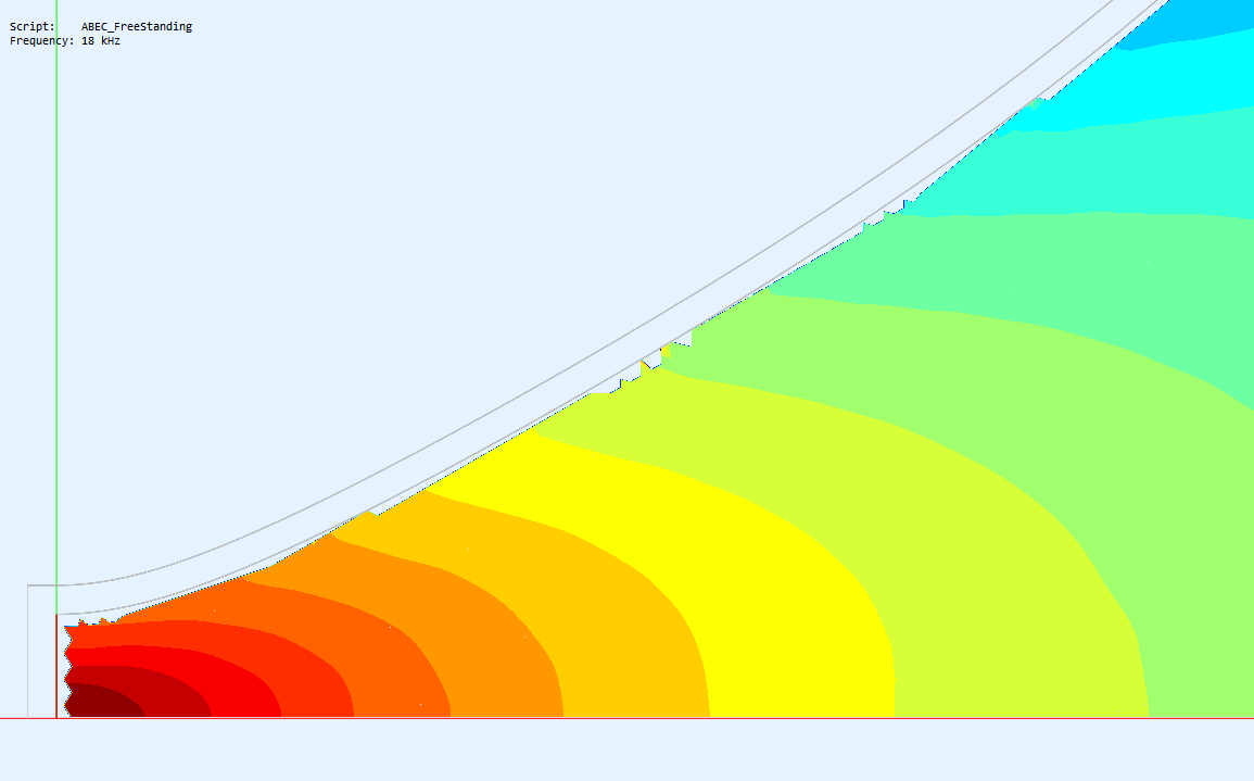

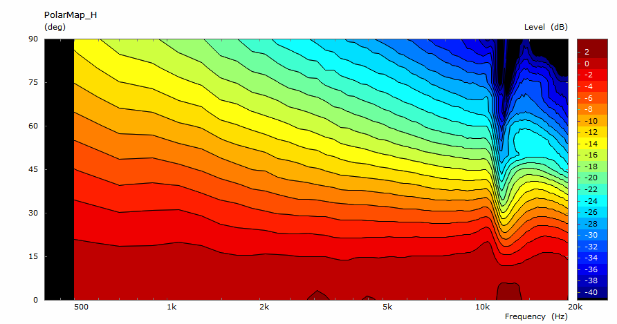

Now that I have the quick sim working, I returned back to the source amplitude shading, supposed to improve on the OSWG. So far only some quick tries without much success however.
The source is divided into four concentric rings of the same widths (isn't that too coarse?).
Flat wave (amplitude = 1.0):
Shaded (amplitudes = 1.0; 0.9; 0.75; 0.5):
Seems like the beamwidth widens quite nicely overall but there's also some resonance going on.

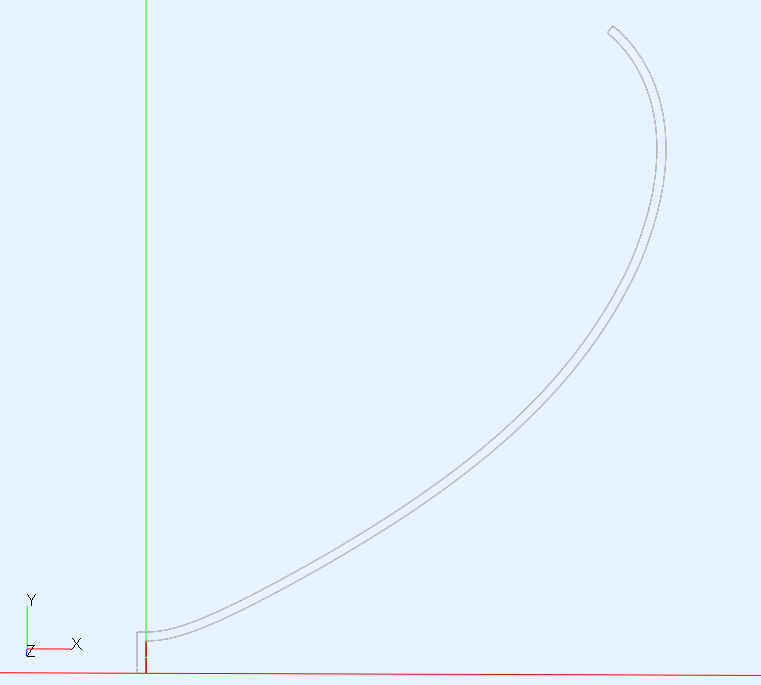

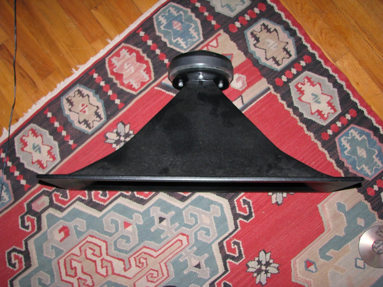

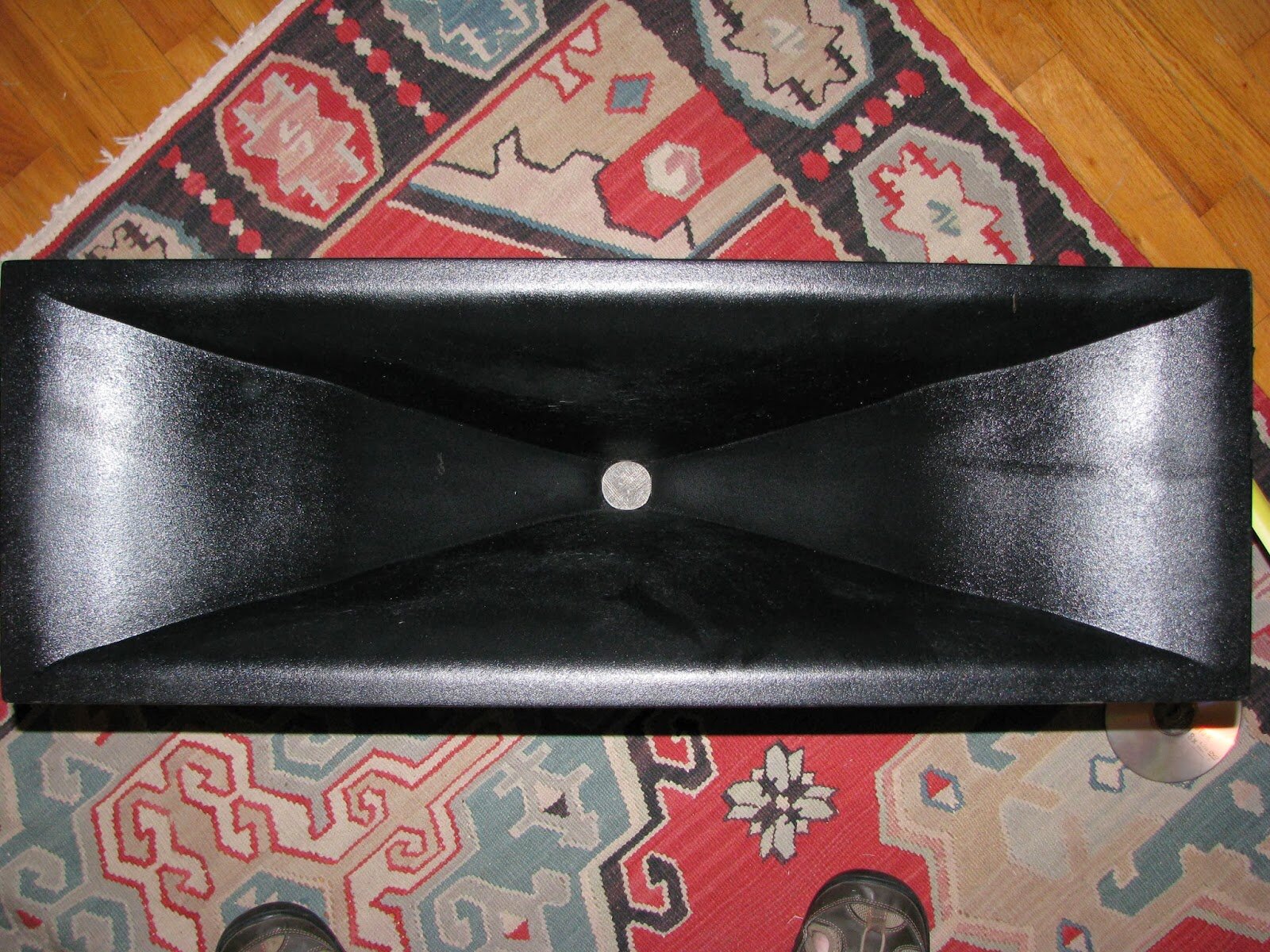

This is it. Still a rather big one - ⌀723 x 286 mm. Probably it could be made a little smaller (or in an enclosure, even smaller).

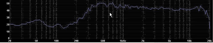

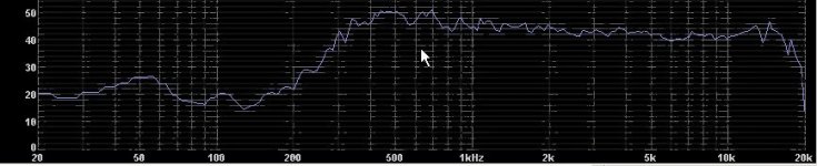

This is still a very respectable raw on-axis response (fortuitously also with DE85), considering the dimensions of the (prototype K403) horn:
W x H x D = 28 x 15 x 11 Inches.

I see what you mean, unfortunately this angle itself doesn't mean it's good or better than being flat. It still depends on how well is this conical section driven - if it's still driven by a flat phase plug output, it won't work much better. Then it depends also on the diameter of the area that drives the conical exit - the smaller the better.My own B&C DE75 is an example with an exit angle of 34.7°. ...

What's so respectable about that? It's still only a single curve, measured strangely. The horn can still behave quite badly - you just don't know from this picture.This is still a very respectable raw on-axis response (fortuitously also with DE85), considering the dimensions of the (prototype K403) horn:
It's a traditional annular slit plug, supposedly emitting a (semi-)spherical wavefront?
