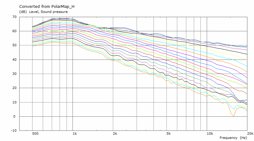

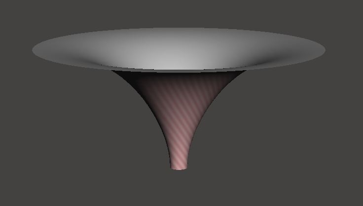

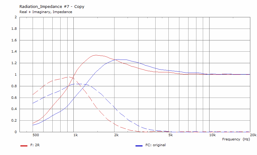

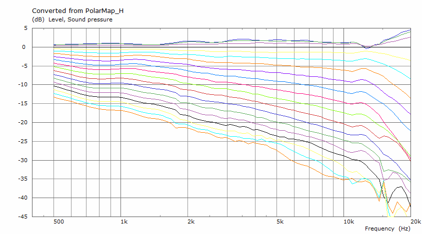

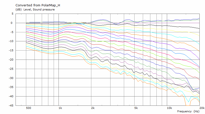

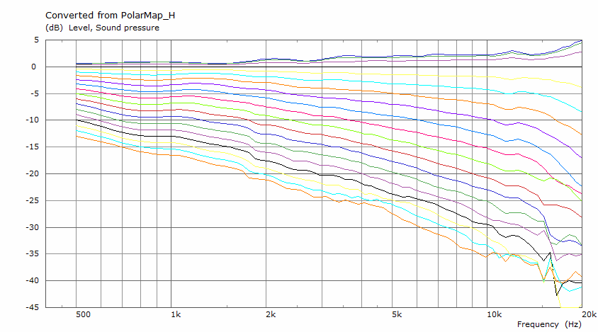

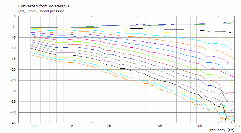

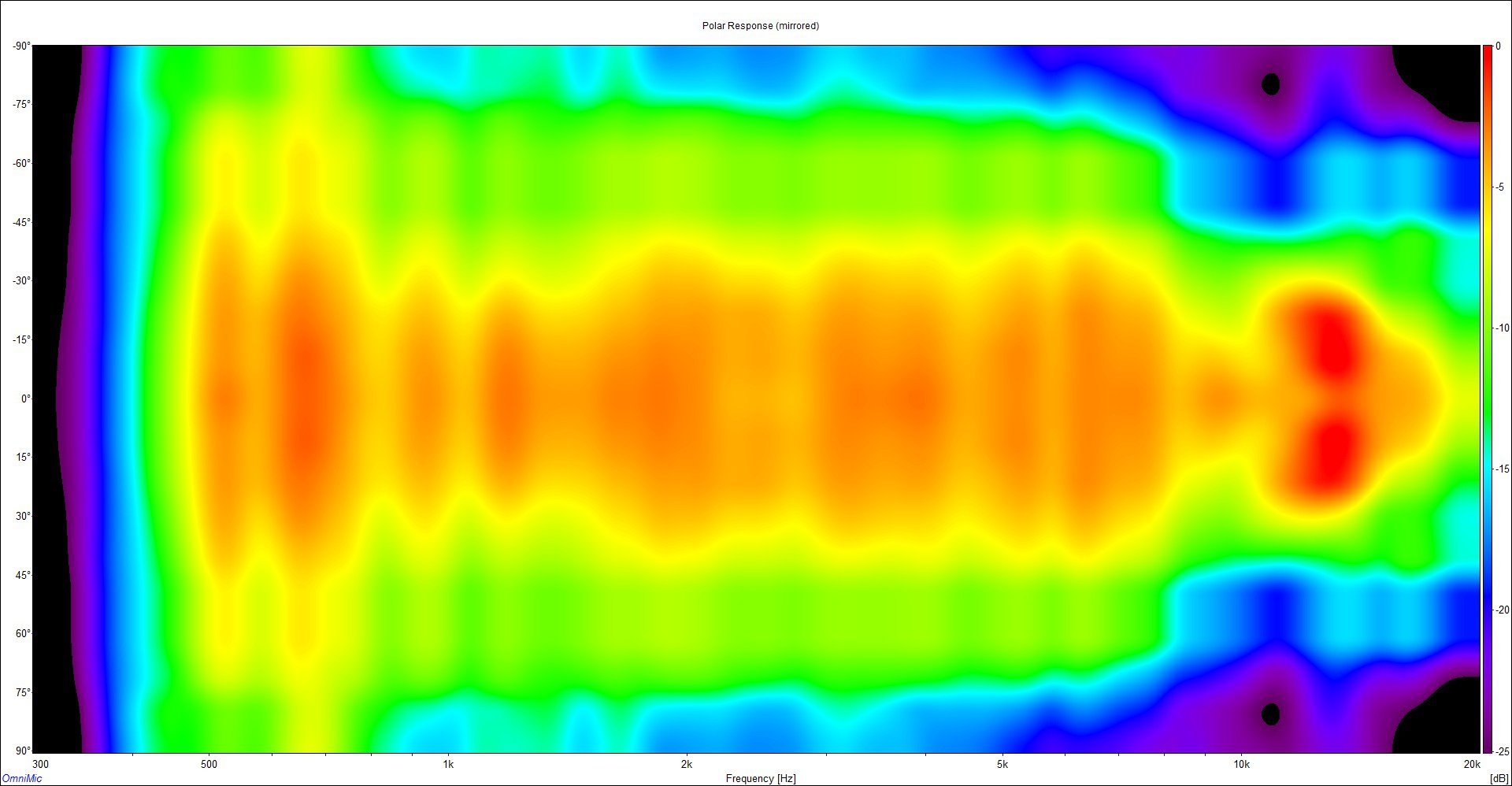

I have another minor upgrade - this time without the need to touch the driver, 1.4" again:
Original OS waveguide:

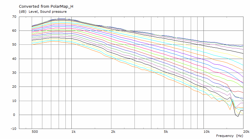

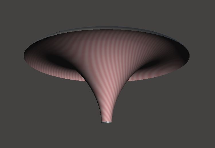

Modified profile:
Attached are also normalized data.
Want to know what the magic is? Simply use a profile for a greater nominal throat radius (2*r in this case)

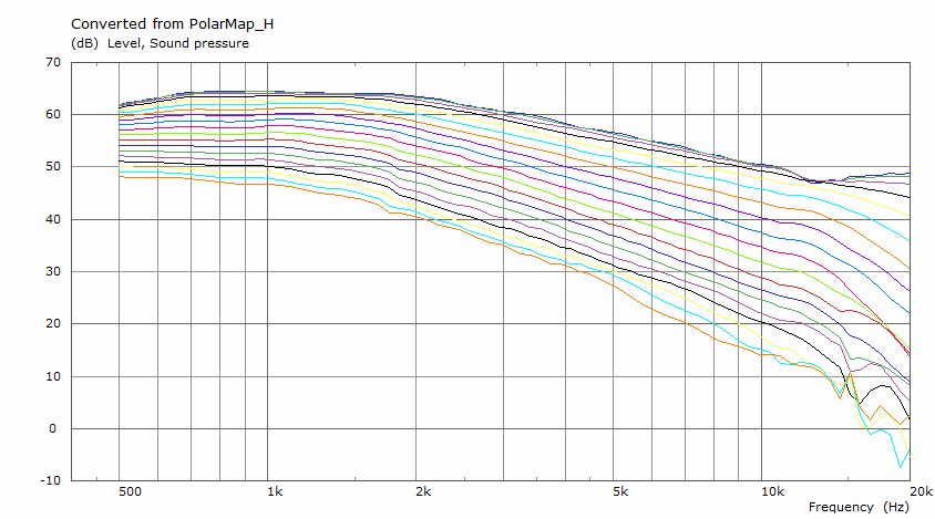

Modified profile:
This is how it works (try changing the k value): Graphing Calculator
For larger k you may want to correct for the coverage angle: Graphing Calculator

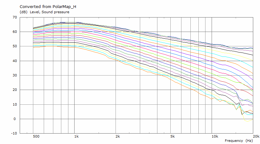

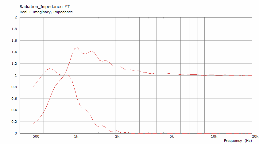

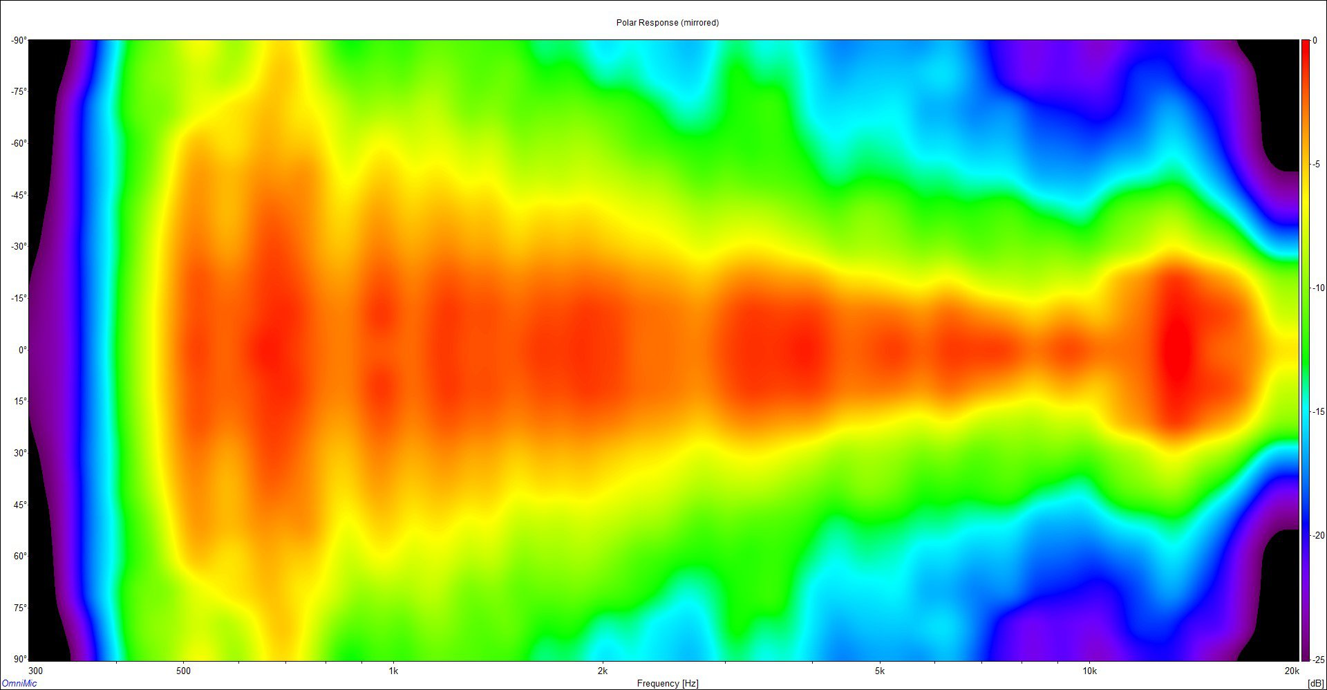

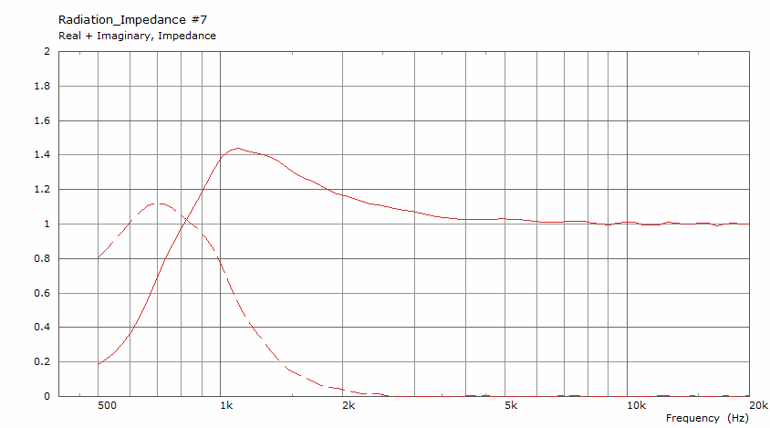

4R (waveguide ⌀557 x 240 mm, 1.4" throat)
That is astonishingly good.
Nice!
What does it look like?
One (or a few) cm additional depth should push the impedance a little lower and thus provide some additional loading.
