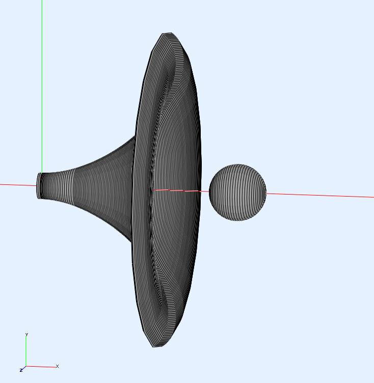

A problem that has always intrigued me is to put a sphere, on axis, at some distance out. I think that there might be a possibility of tuning the axial and off-axis responses separately with variations in the sphere's radius as well as the distance. Spheres have the least and smoothest diffraction of any shape.
Really? Well that's a piece of cake in the CircSym mode in ABEC- if you have the possibility to run ABEC or AKABAK, attached is a complete project with a sphere placed on axis.

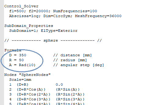

The distance and radius are parametrized in the script (solving.txt):

BTW, as for the sphere on axis - thinking about that, one can add such a sphere even now in Ath by using the source definition script (Chapter 7.5 of the User Guide). This way it's possible to define virtually any additional axisymmetric structrure to any Ath project, including all different kinds of phase plugs.

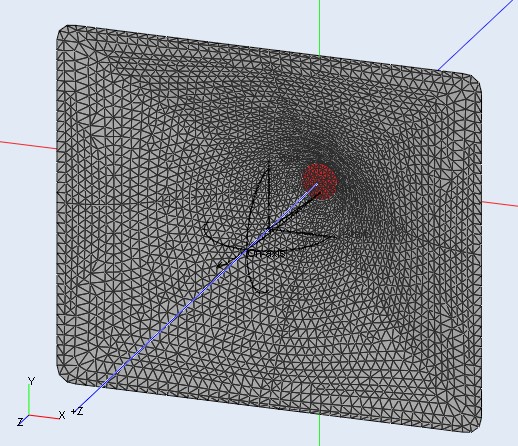

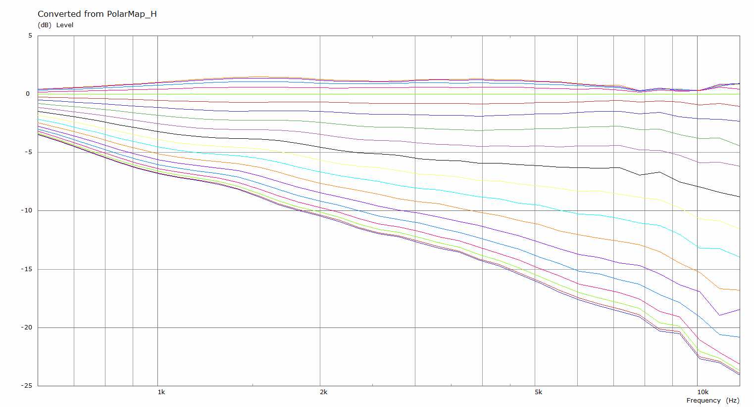

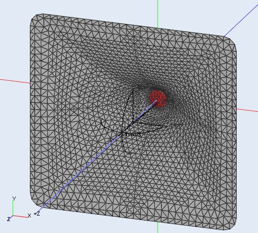

When I saw the two contours side by side it reminded me of the Yuichi / TAD horns where the Horizontal is conical or almost, and then the vertical has more flaring. I wanted to see what effect that had on the DI as the horizontal and vertical curves are very smooth.
This was designed to match with the Faital HF108 and be about the same size as a 12" driver.

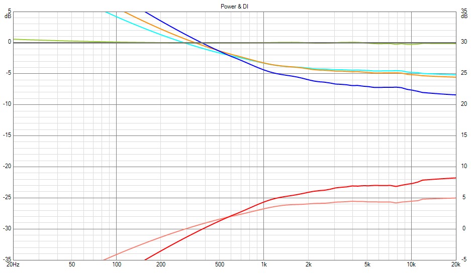

DI

Mesh
attachment.php
I think the contrast between the ERDI and the overall half space DI is interesting. Within the listening window everything is very flat and quite well controlled but the further off axis you go the steeper the curves fall off but still very smoothly.

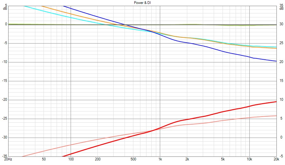

I made another bigger one to see if I could get the same sort of DI as I did on my best effort with a super shape. By making the vertical contour more similar to the horizontal the DI got flatter over a bigger range. There is a bit of an 8K wiggle in this one which makes the curves look not quite so nice but still promising. This one is a 15" size.

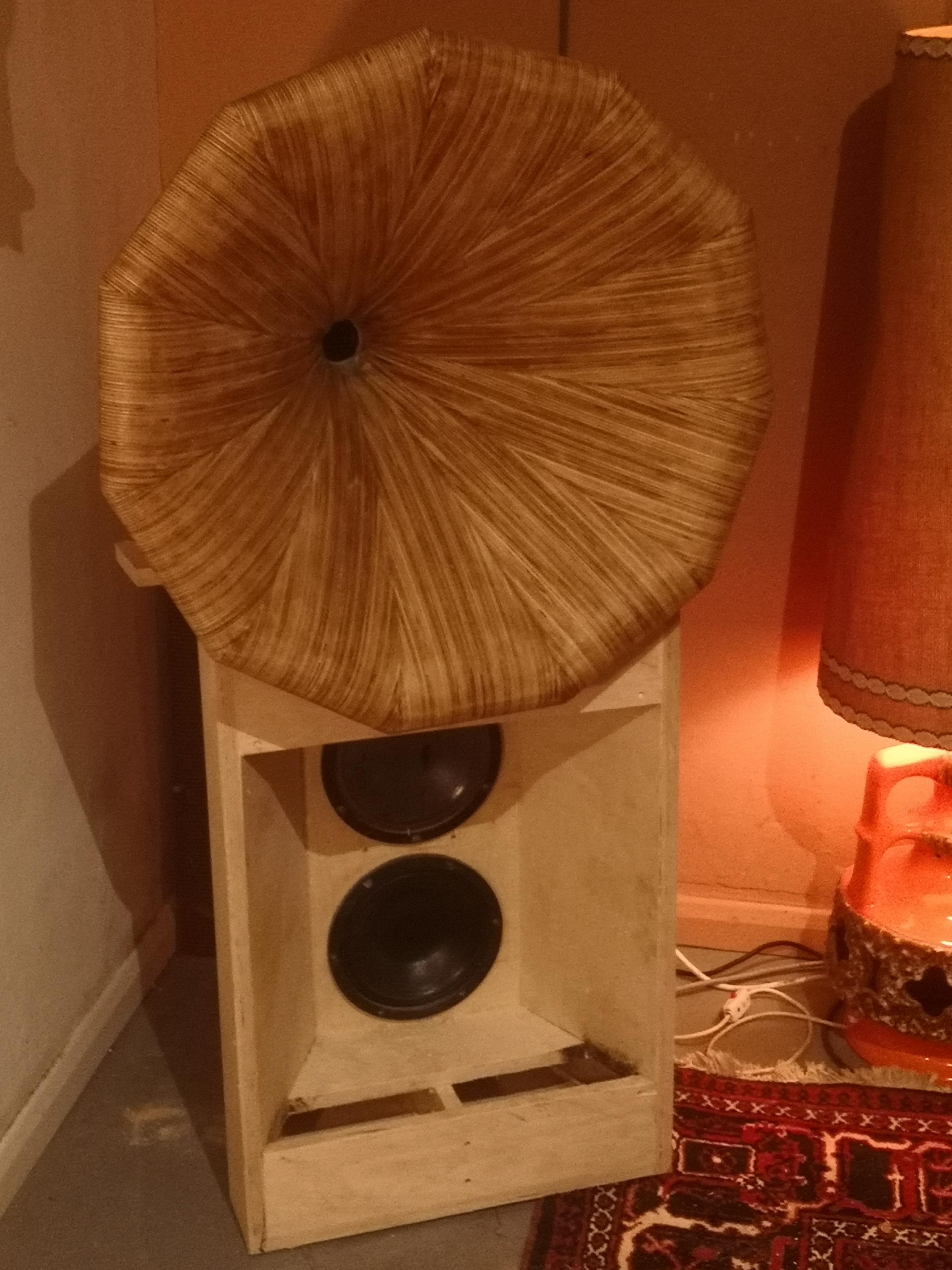

Well this is about the kind of beaming you would have to accept if you used a 2" driver like the big Celestion, at least without employing any diffraction techniques. This is about the best I can get out of it - maybe someone else could do better. Honestly, I don't know if this is exactly what to go for. Maybe.
(⌀800 x 376 mm).
My CNC is ready to make these for real (for my Axi2050s) - I've made similar before but with a profile I just guessed. Would you be happy to share the curve? I'm planning to make the first 100mm in one throat-piece and morph to solid wood petals for the rest. I'll share measurements.

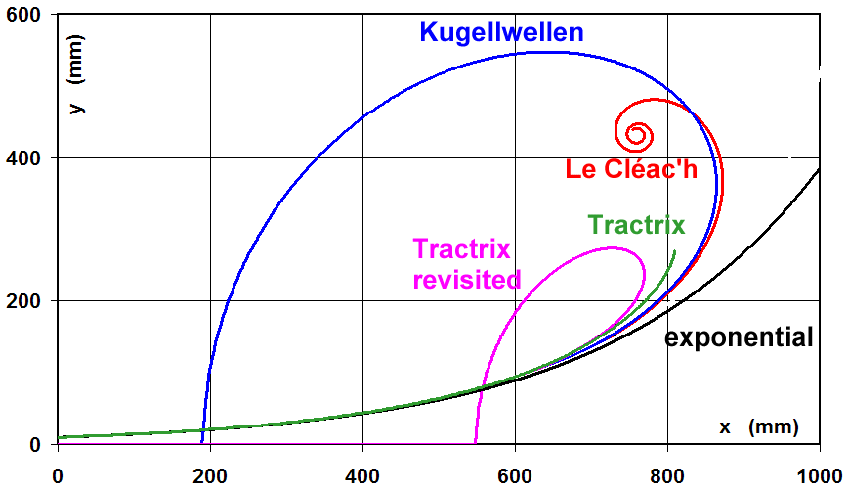

Some interesting quotes by le maître:
The nearest conventional (= old) profile to the Le Cléac'h profile is the Kugelwellen horn (here compared among with other profiles to the Tractrix and T = 1 Le Cléac'h horn).
Notice that the Kugelwellen follows the same logic as the Tractrix ("constant speed" translation of spherical cap wavefronts of a constant radius along the axis. The radius used for the Kugelwellen being 2 times the radius used for the Tractrix).
A main difference between the Tractrix and the Kugelwellen is that the Kugelwellen expansion is exponential all along but the expansion of the Tractrix (as I calculated it) departs from an exponential law near the mouth. If we recalculate the tractrix with a pure exponential expansion of spherical cap wavefronts, then we find a horn the mouth of which curves back as for the Kugelwellen. I called this a "revisited Tractrix" horn."
To say that the cut off frequency of a horn is related to the (mean) diameter of its mouth is a common mistake.
In fact whatever the length of a horn having a known expansion, its cut-off is the same , BUT what differs is the ripple in the response curve which is due to the interferences between normal waves emitted by the diaphragm and propagating inside the horn with waves backreflected from the mouth to the throat.
We are still wrongly using a semi-empirical rule originating from Keele who said that the ripple due to those reflections passes through a minimum when the mouth diameter is equal to the wavelength at cut-off. This is based on a model using the false assumption that the wavefronts are plane. Further studies demonstrated that such minimum doesn't exist.
The domain of application of this rule of thumb is only for cut horns (all Salmon horns must be considered as cut horns). If you use a minimum diameter equal to the wavelength at cutoff then you obtain an "acceptable" amount of ripple in the response of the horn (acceptable for whom?).
Doing that, we link that diameter to the cut-off frequency but we cannot reverse that rule so: it is not true that the cut-off frequency is related to the diameter of the mouth.
Now, IMHO, to encouter this rippling, it is highly desirable to use quasi infinite horns like complete (= uncut) Le Cléac'h horn, complete Kugelwellen or complete Tractrix. But only the Le Cléac'h horn doesn't do any assumption on the shape of the wavefronts. In this sense it is a better design than the Kugelwellen and the Tractrix, the design of which is erroneously based on the assumption that wavefronts are spherical caps.
Best regards from Paris,
Jean-Michel Le Cléac'h
