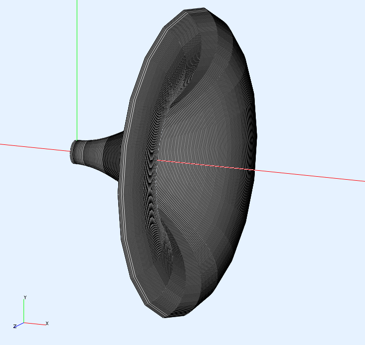

My CNC is ready to make these for real (for my Axi2050s) - I've made similar before but with a profile I just guessed. Would you be happy to share the curve? I'm planning to make the first 100mm in one throat-piece and morph to solid wood petals for the rest. I'll share measurements.

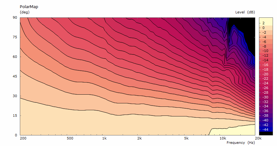

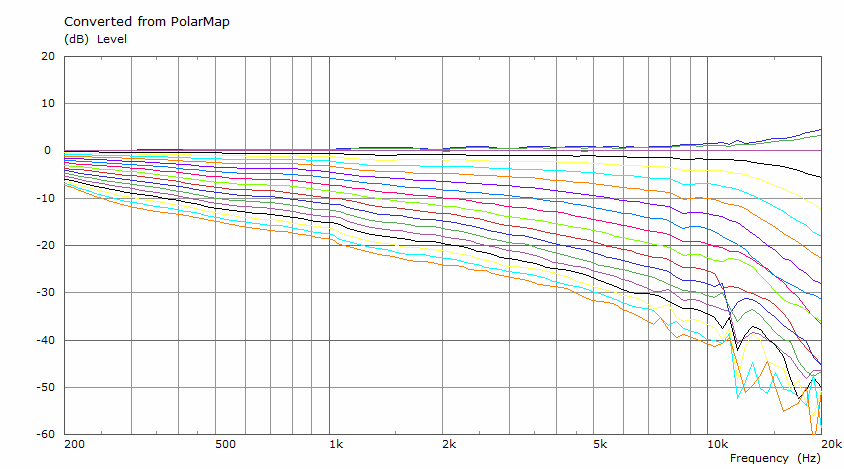

It's equalized quite flat from 600hz up but I don't have polars. That's my next project - polars taken outside with a turntable.

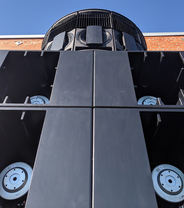

It's hard to see in the picture, but I'm guessing the woofers in the FLH are either FaitalPro or 18Sound.
How do you like the Axi2050's sound?
They're 18sound 8nmb420 in a 'Paraflex'. Fabulous sounding drivers, powerful and nimble.
Not sure about the Axi yet. Need to find them the best horn...
I'm used to Radian 745neo beryllium - which I love the sound of.

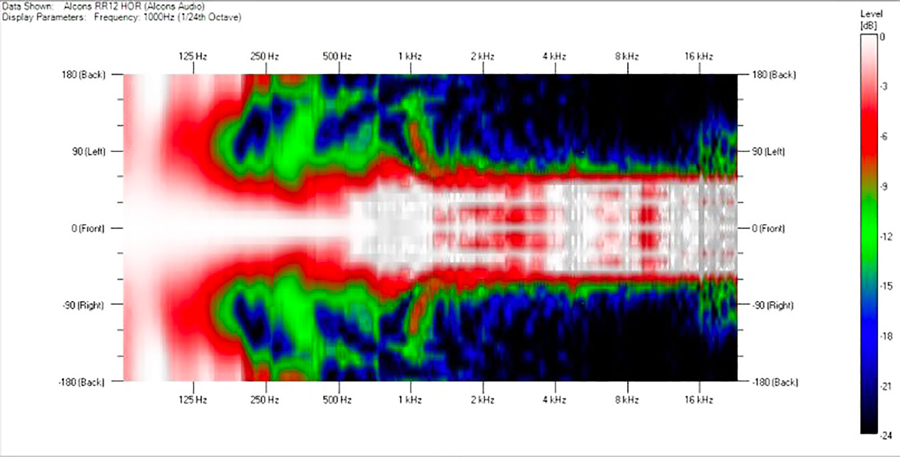

It sure shows how nearby diffraction can mess up the polar response.

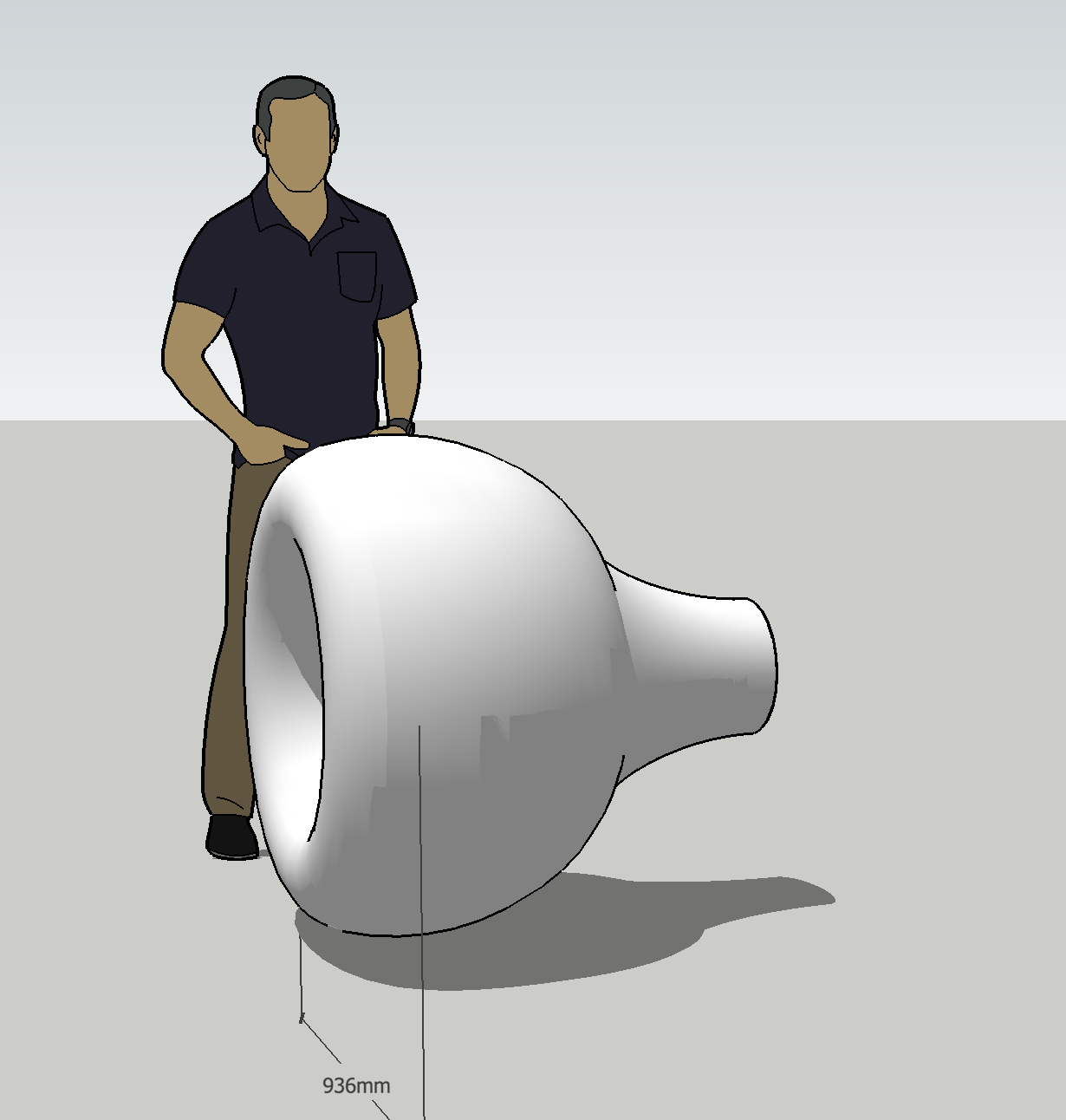

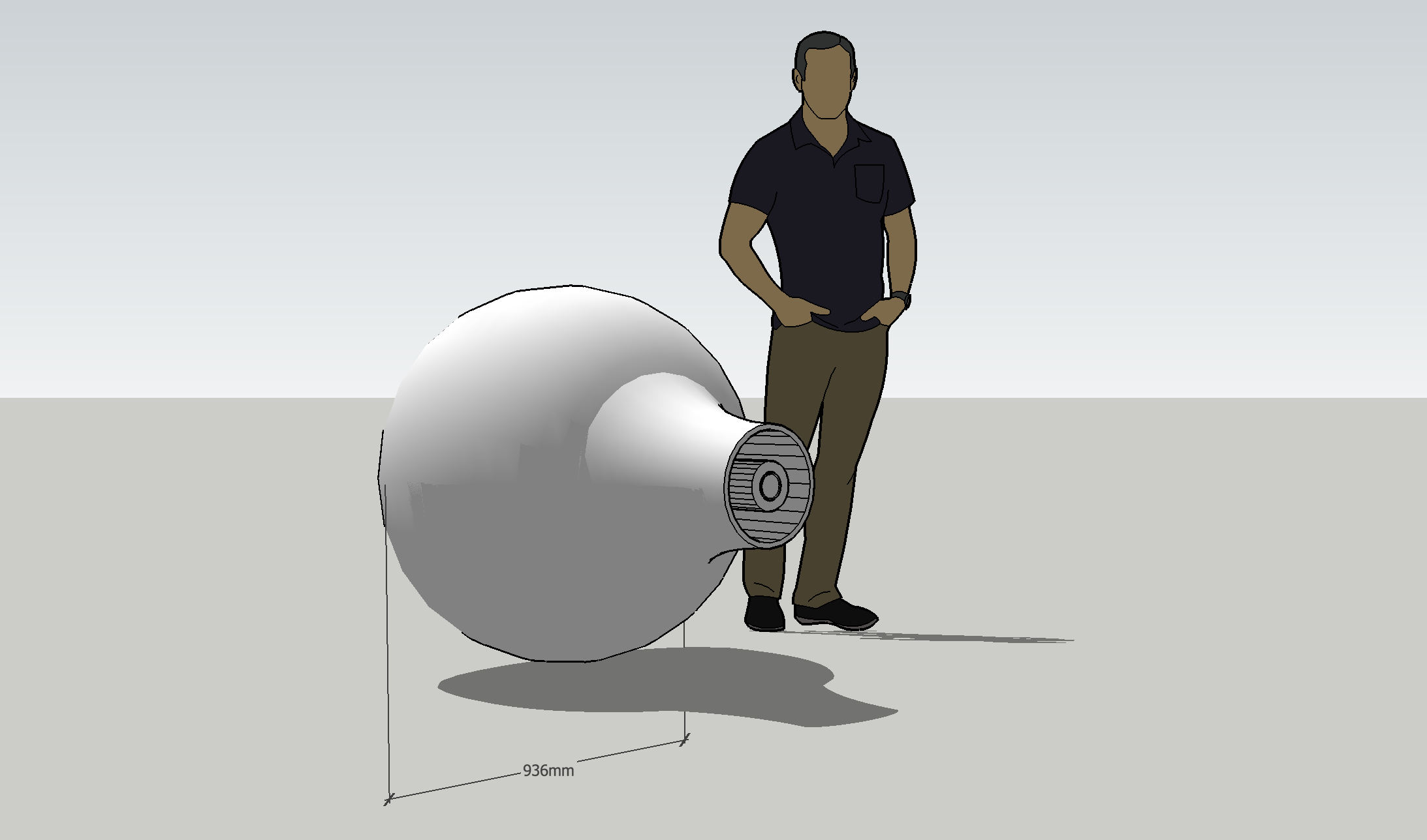

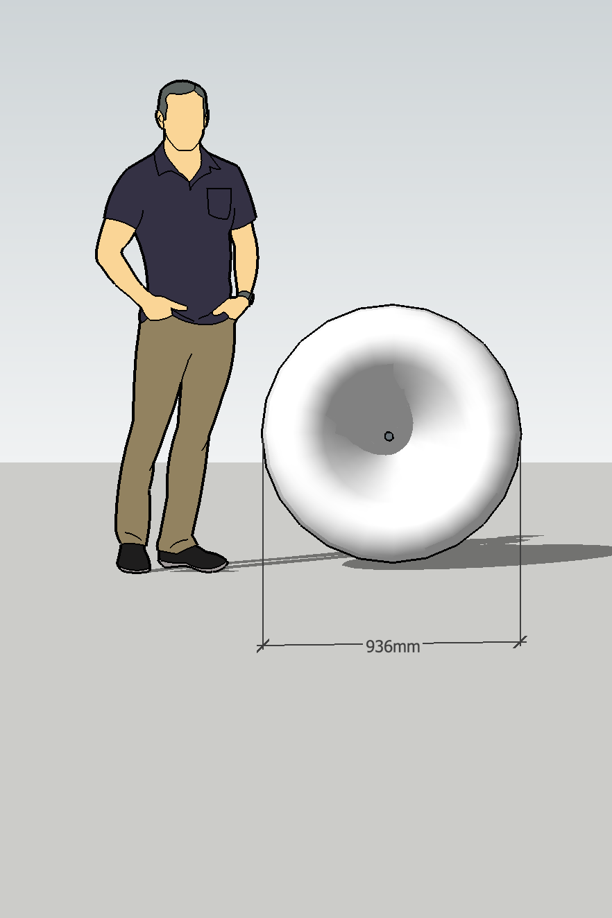

I have something better in the meantime. I'd be happy to send you the profile if you promised you would consider donating to the project. I simply can't (and don't want to) do it completely for free.My CNC is ready to make these for real (for my Axi2050s) - I've made similar before but with a profile I just guessed. Would you be happy to share the curve? I'm planning to make the first 100mm in one throat-piece and morph to solid wood petals for the rest. I'll share measurements.
⌀792 x 346 mm
⌀792 x 346 mm

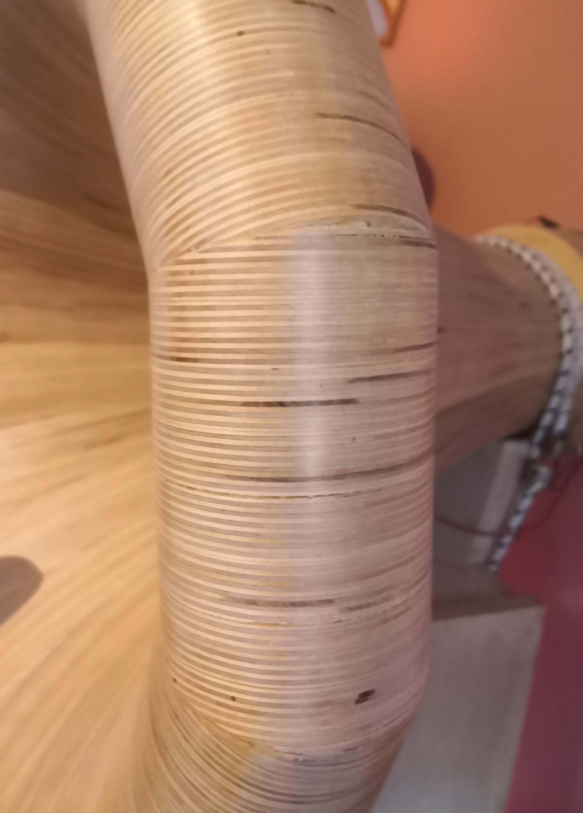

That's fabulous. Yes, I'd be very happy to donate, I appreciate that this witchcraft is priceless. (I'll PM you about that). As you're at it, could you perhaps include the whole mouth roll back? Maybe the radius could tighten as it rolls round so as to save wood and weight. I can fix that myself in fusion but it would be nice to know what effect it had. Here's a close up of the mouth of another one I made.

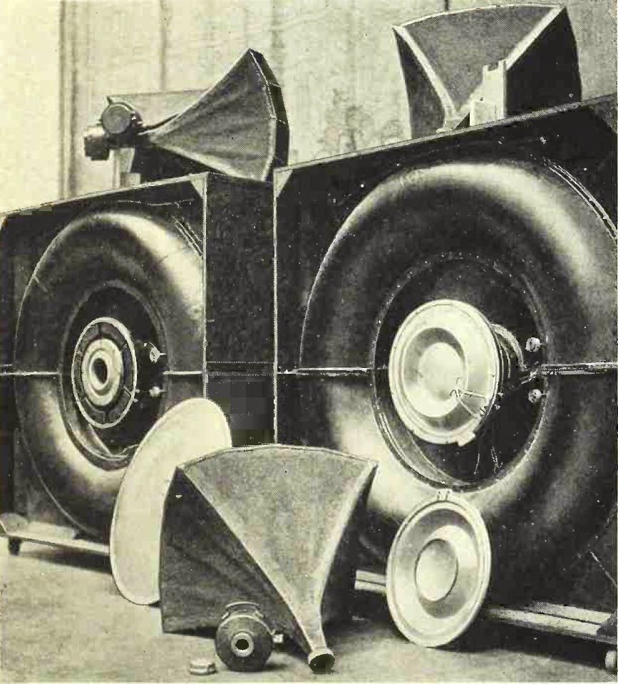

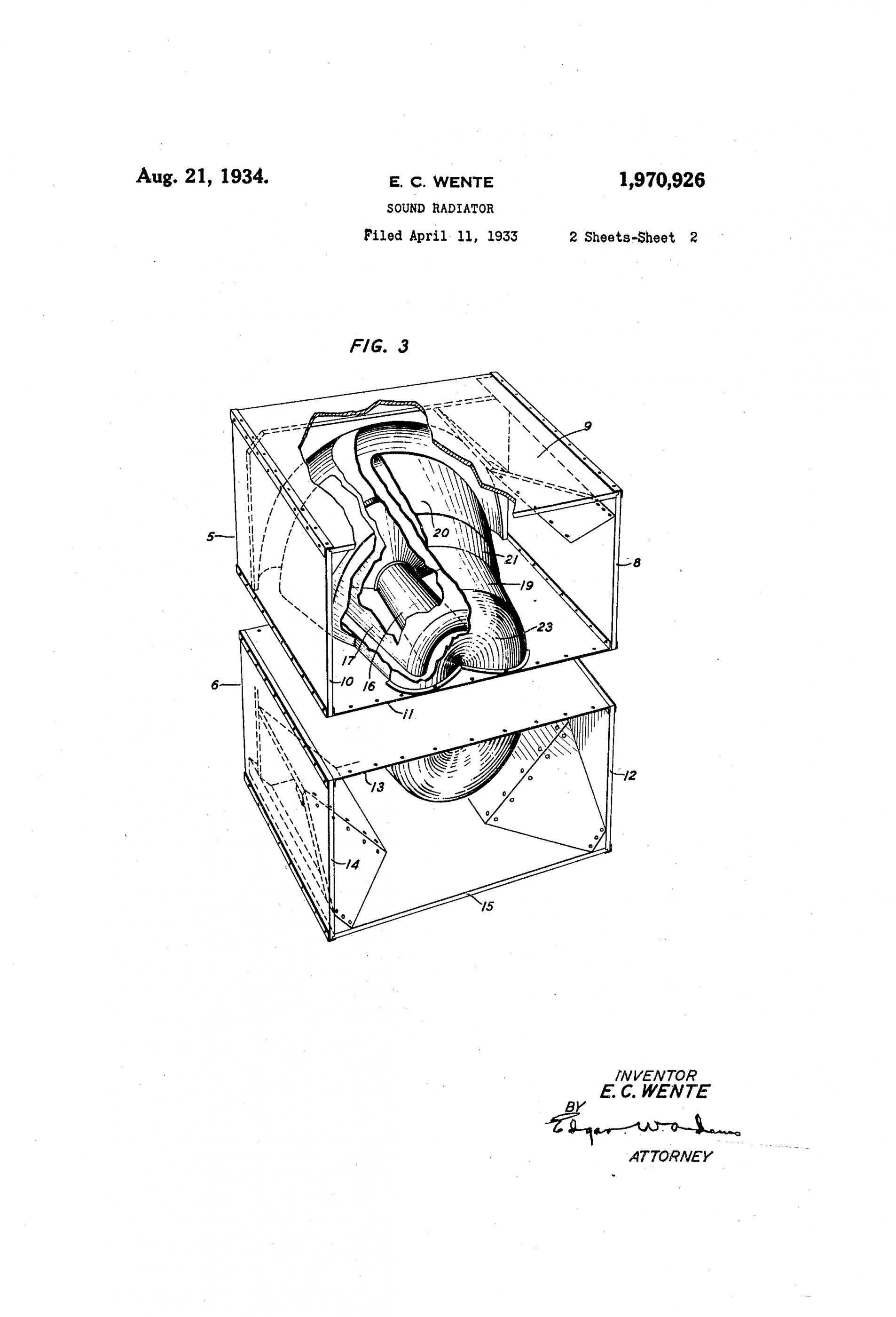

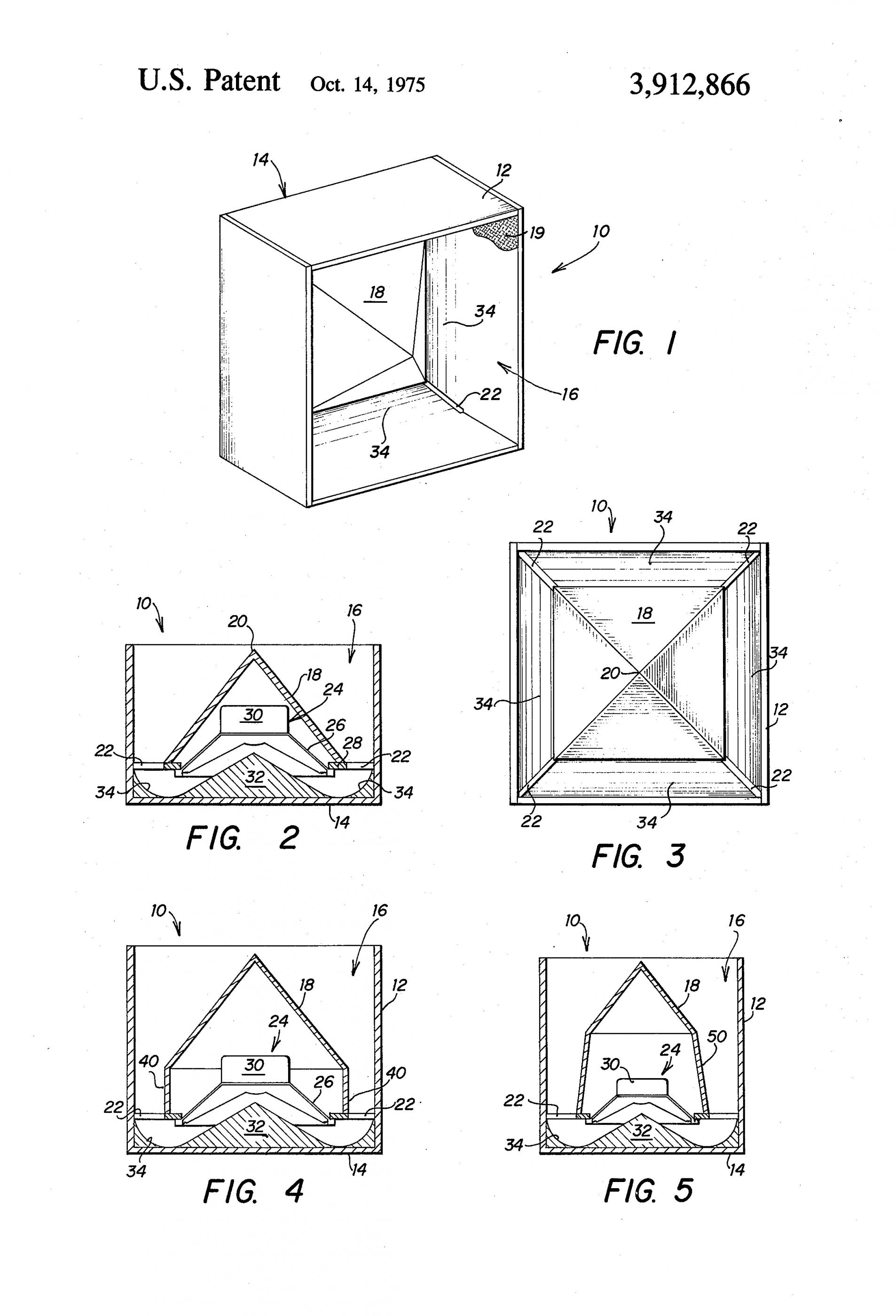

The Paraflex became popular during the 1970s and was patented in 1974 by a company called Show Sound (ShowCo. Inc.).

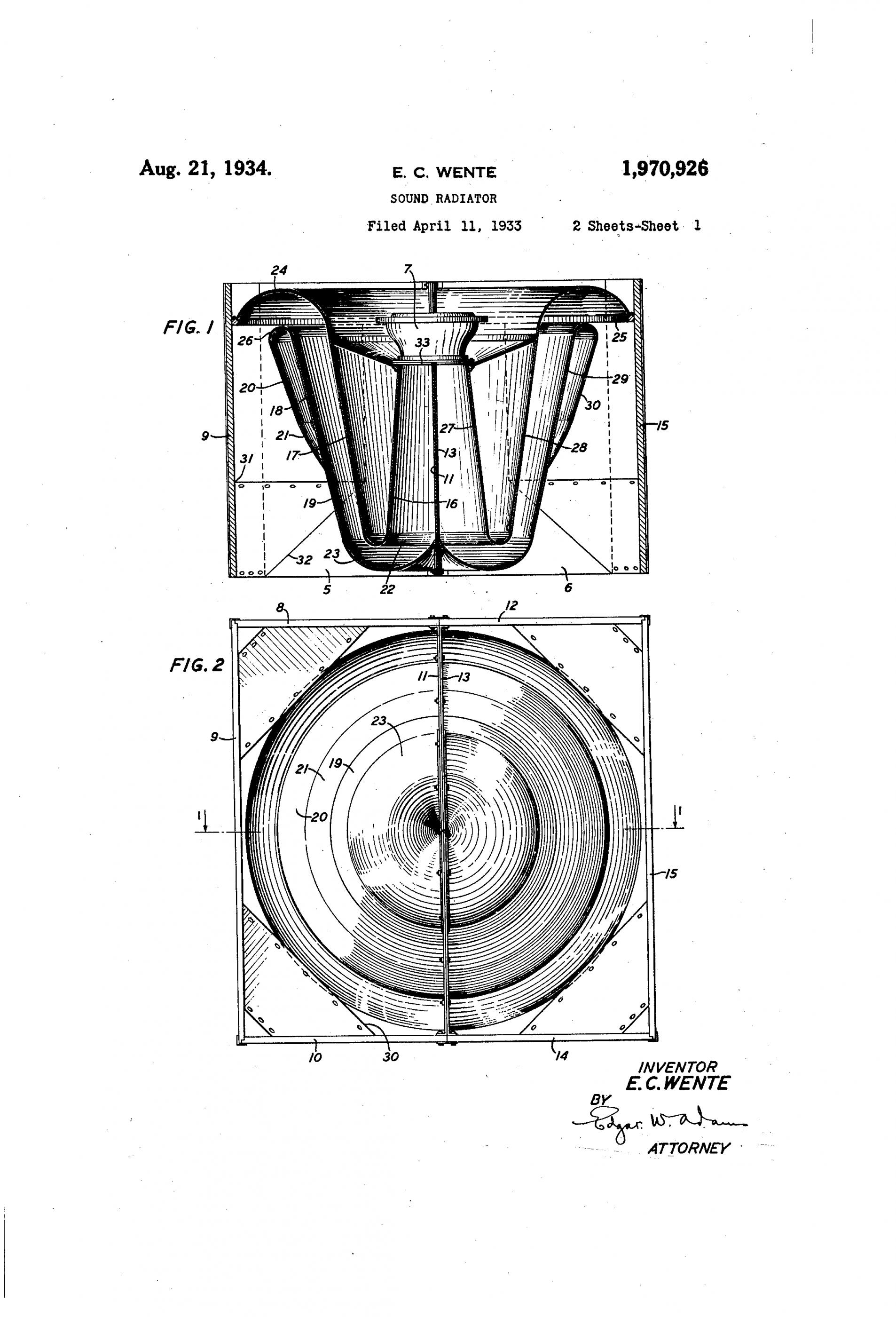

However, the concept is based on the Fletcher bass horn, which was developed in the early 1930's by Edward C. Wente (of WE/Bell Labs), who else?
The mighty 20" Aluminium bass compression driver sprung from the brilliant mind of his buddy A.L. Thuras.
Around 2005, Void Acoustics reintroduced the Paraflex.
Alcons Audio also manufactures 15-inch Faital Pro horn loaded mid-bass Paraflex subs.
The shown stack's horizontal polar is quite impressive.

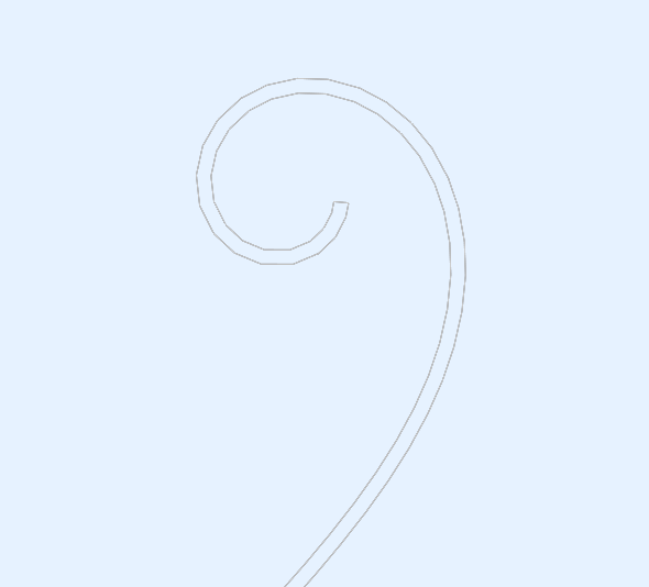

No problem. I'll post the sims later.As you're at it, could you perhaps include the whole mouth roll back? Maybe the radius could tighten as it rolls round so as to save wood and weight. I can fix that myself in fusion but it would be nice to know what effect it had.

Ever wondered what happens inside the rollback? See the PDF.
It might be a good idea to fill it with some foam.

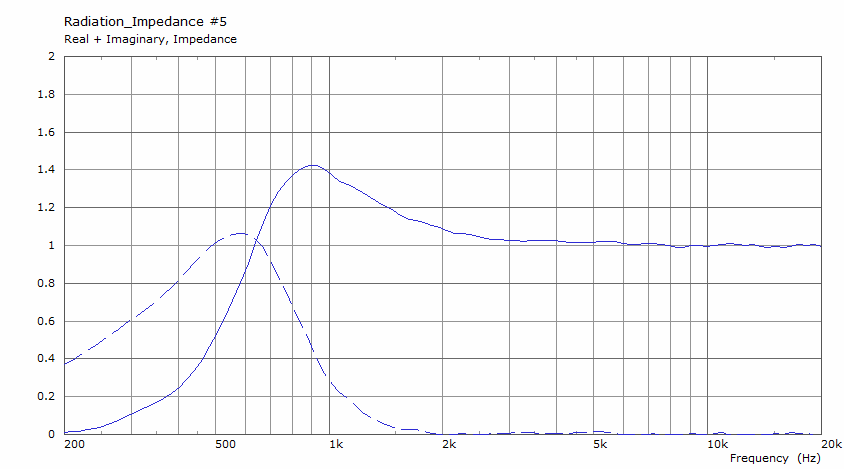

What if the rollback were covered in foam too?Ever wondered what happens inside the rollback? See the PDF.
Really? Well that's a piece of cake in the CircSym mode in ABEC- if you have the possibility to run ABEC or AKABAK, attached is a complete project with a sphere placed on axis.
Unfortunately I don't have that possibility and doubly unfortunate that I am not likely ever to have it. That's just not what I do these days.
