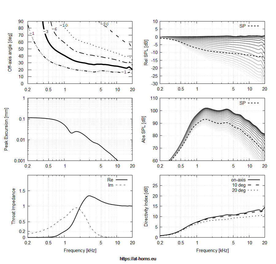

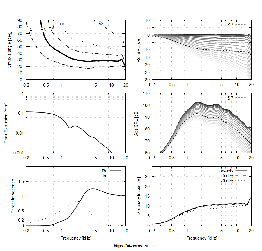

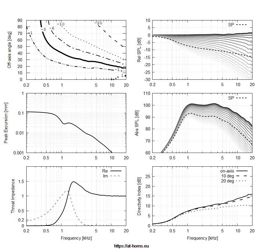

One of the last additions to the OS-SE formula was the 'k' parameter. Basically, by increasing this value above 1.0 it's possible to use an OS profile that would otherwise correspond to a bigger throat (and vice versa).
The attached images show the results for k = 1, 2 and 5.
The overall waveguide diameter was about 10.5", a bigger k also makes the waveguide a little longer.
