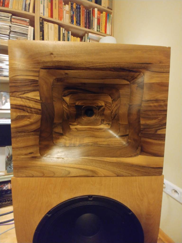

I can put mine in the wall itself with no problems up to 8 inches deep. In the UK, the inner wall is thermalite block. Not sure if you get it in the US, but it's airated ceramic thhat you can cut with a saw or knife.
Driver is the JBL 2452, which is small for a 4 inch diaphragm driver.
I don't have a better photo on hand, but it is as simple as it looks.

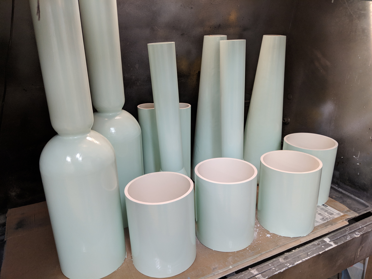

Relatively easily obtainable freestanding waveguide is a 3D printed one - a printer with 300x300 bed with 400 mm usable height could in theory print a waveguide of up to 40 cm (based on scaling the smaller one I tried). That is on the edge of what a hobby 3D printer could do. If height is not available, it could be still printed in two halves. Larger would have to be printed in more parts and that brings some other difficulties.
I think bmc0 has shown another practical use of 3D printing to create even bigger horns 🙂. https://www.diyaudio.com/forums/multi-way/354772-acoustic-horn-design-practical-2.html#post6214298
With a bit of care and thought this method could be used for a free standing horn as well. And with a bit more work, more options become available. Using printing (and possibly similar methods bmc0 used, but in reverse) to create the molds for example. It is doubtful the 3D printed materials are the best option for a waveguide. They do make a good prototype but I wouldn't end it there.
From what I've seen, 3D printing is fine for smaller pieces, parts or prototypes but I have yet to see a bigger print that would satisfy me regarding the print quality. Maybe there are such (professional) printers around - none I would know of. I know of a guy who designed big printer to use anorganic print materials (engineered stone, glass powder, just about anything like that) but I don't know how he's far with that. I asked him recently without an answer.

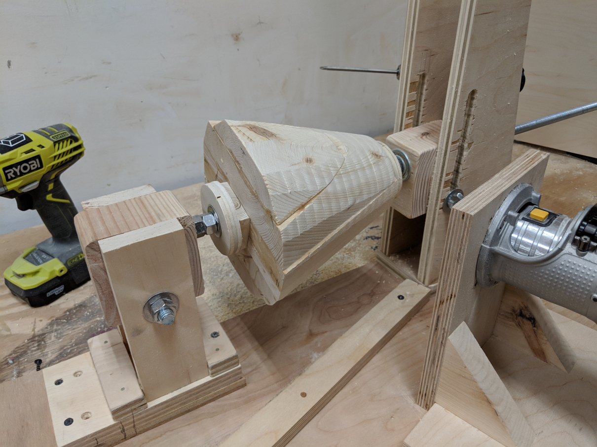

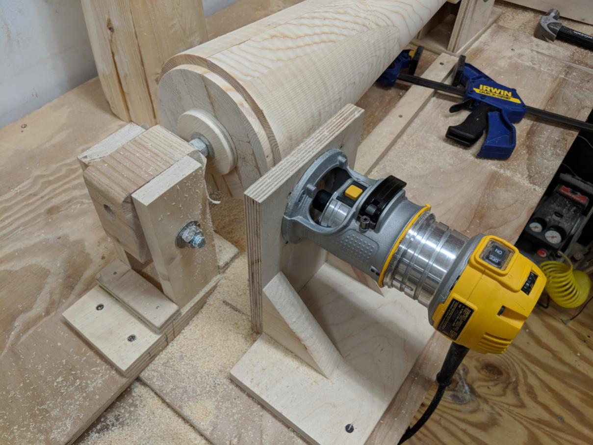

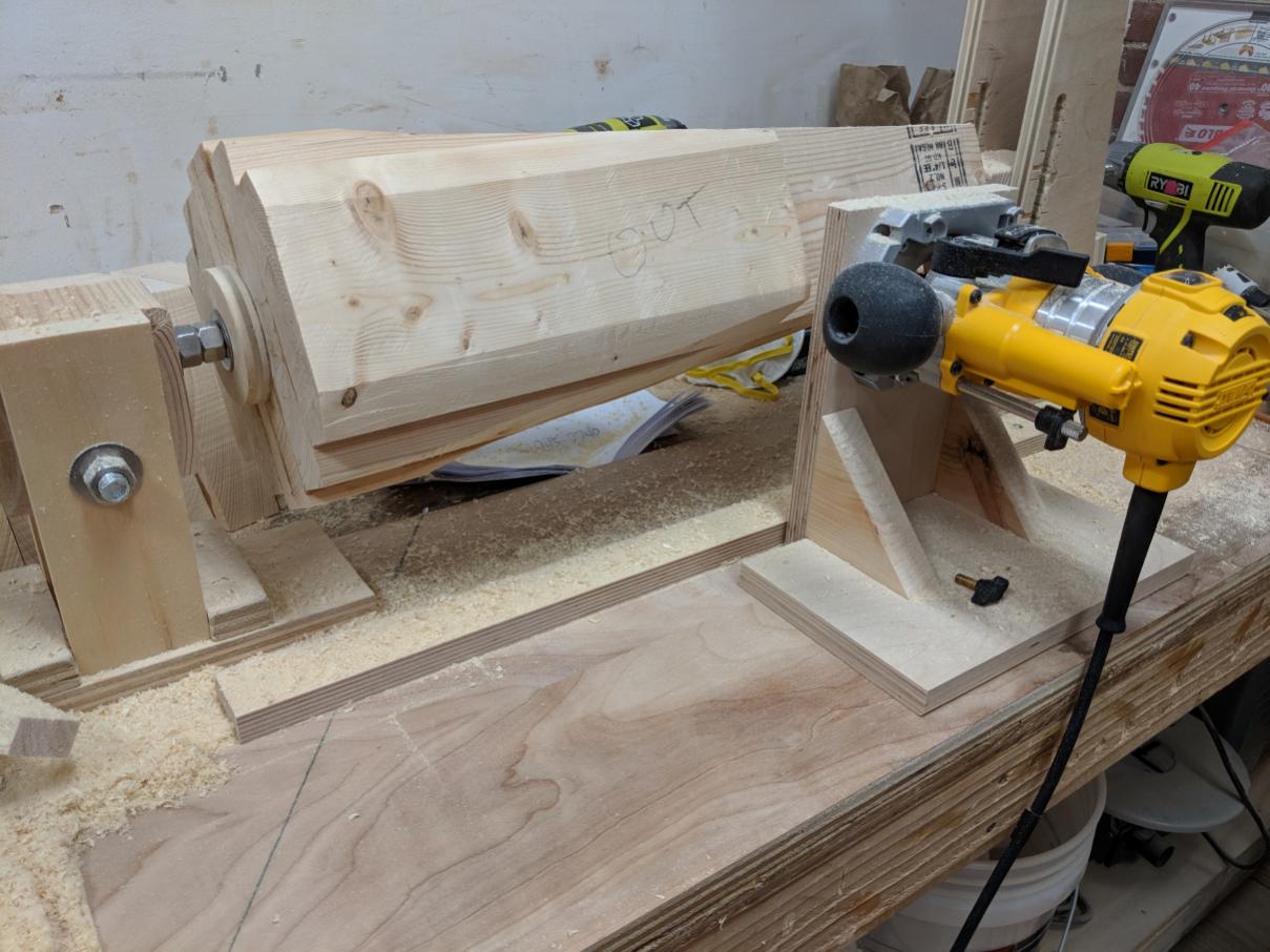

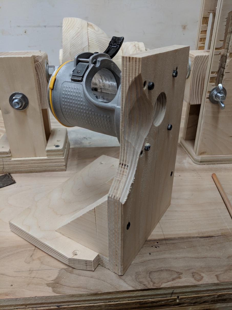

- I started to build a lathe-like machine for mold milling so I'll see how that goes. I still do think the axisymmetric waveguides won't be that hard to make, even big.
It would be lovely if rippin' and gluin' was enough, though 😀 For best speakers in the world making a mold is just few more days (or maybe weeks if no prior experience and tools), well worth it in that case. Anyway, this is so exciting, million thanks to mabat for the millionth time 🙂
Finally something I can help with! I made a machine like this to turn fancy table legs for a furniture commission a few years ago. It only required a few cheap roller bearings, some threaded rod, scrap wood, and a palm router. I have no doubt a similar design could be used to cheaply and easily carve out an axisymmetric waveguide (or a mold of the same).
