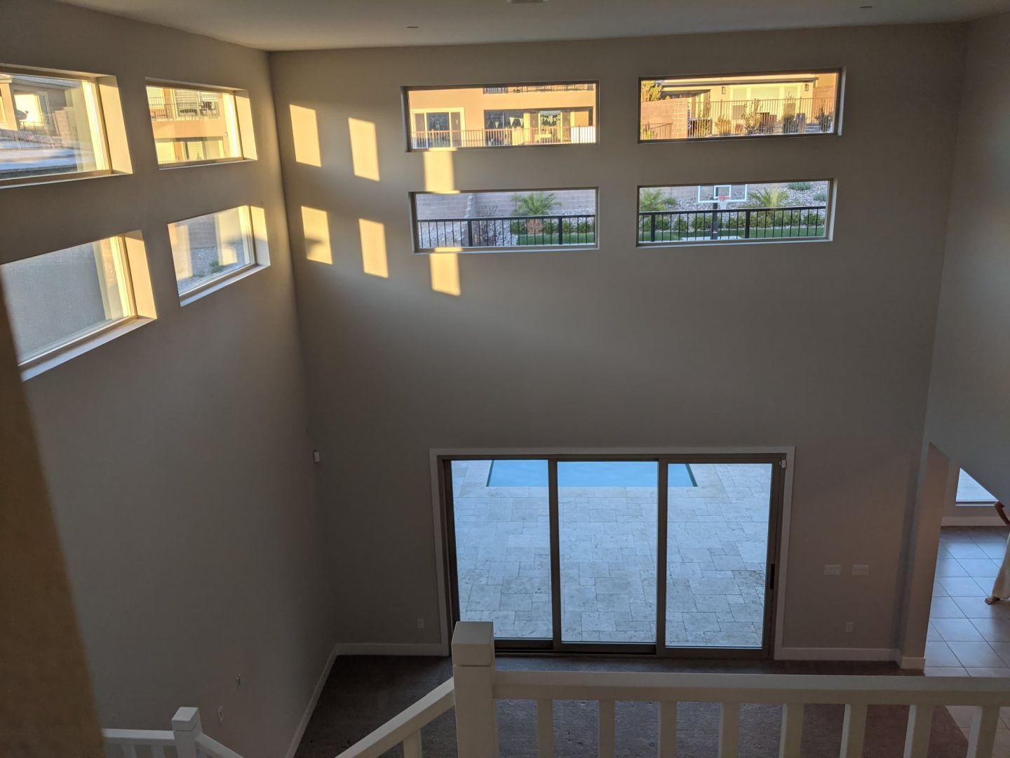

My contractor friends have confirmed my suspicion that 'architectural speakers' are what people want these days. ie. in-wall speakers that you cannot see. I've been trying to think of how to do in-wall with the 45 degree 'cross fired' angle for a while. It would be the way to go.

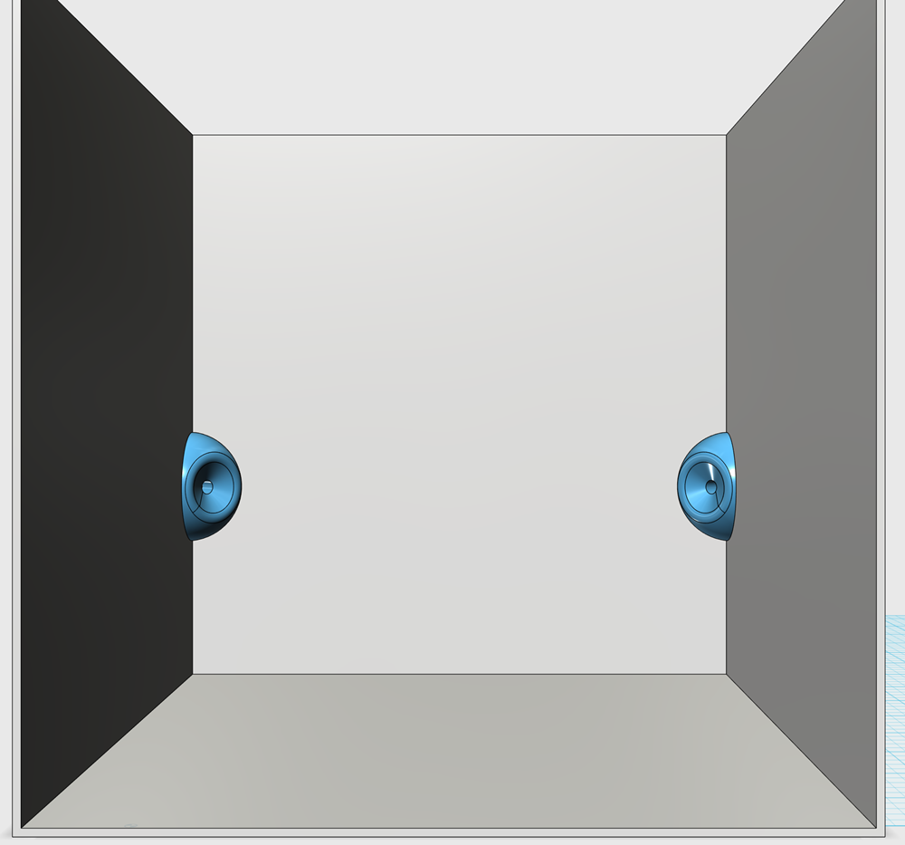

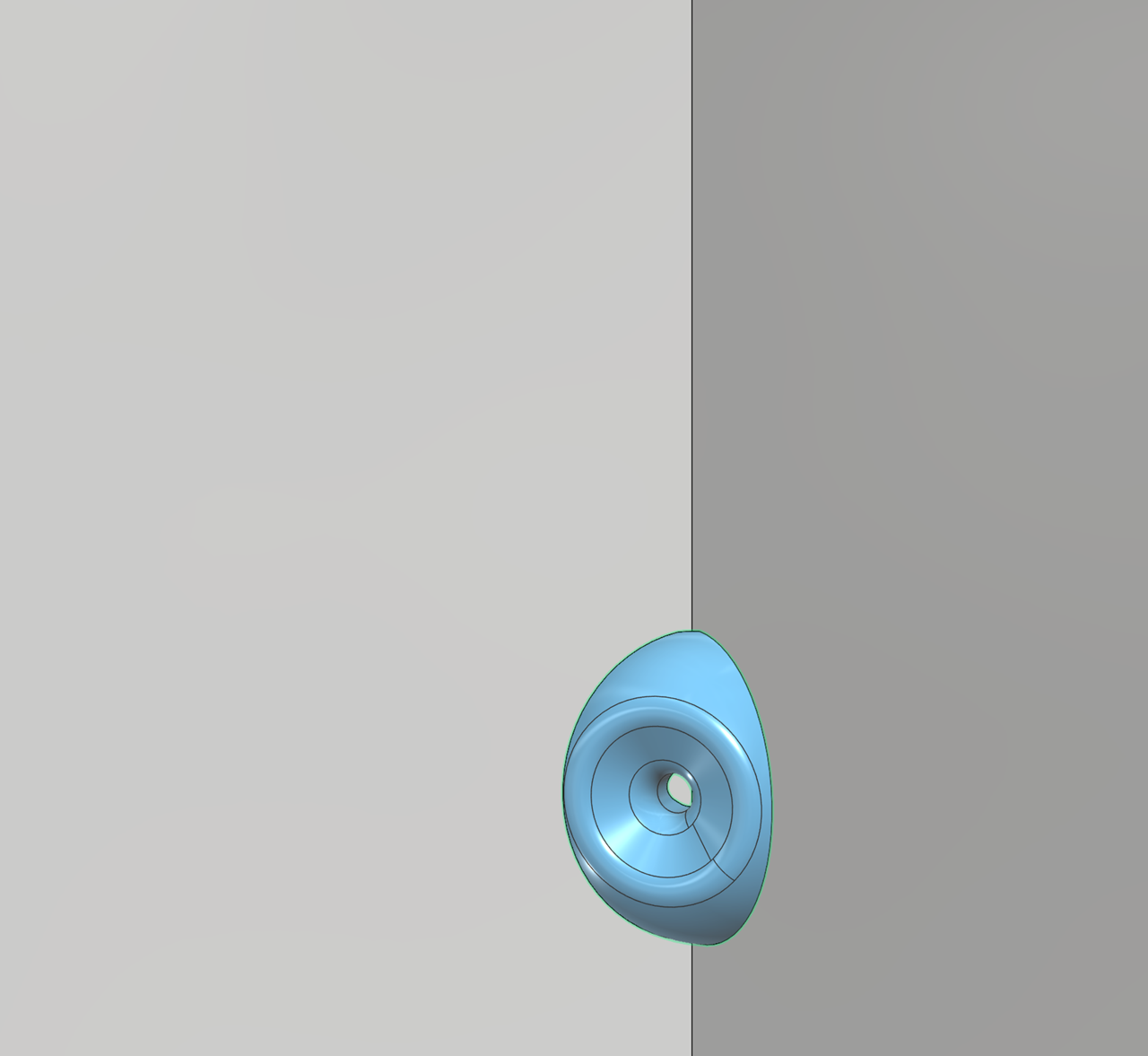

I'm not sure I understand the "3-corner" thing - is it supposed to be this?
(I've just implemented a guiding curve defined as a polygon set by user defined vertices - triangle in this case.)
Think of it this way: as the wave leaves the source does it encounter any changes in slope, i.e. 2nd derivatives. If not then no diffraction. What is shown above does precisely that. The wave never encounters a slope change so this source would be free from any diffraction - until it met with room obstacles, which surely it must. But what is shown is very hard to implement - requires a wall reconstruction. And then there is the woofer. I'd put in three as close to the corner as possible (but there now, these will diffract.) Ideal solutions are nice, but usually have "gotcha"s and impracticalities.

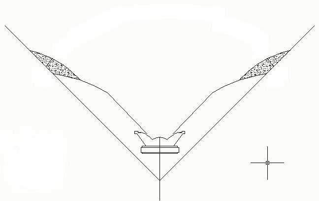

If I'm not mistaken, another solution may be a segment of a spherical cap, loaded with a CBT array.
The first pic here illustrates that.
The second and third illustrate how it might look if there was a waveguide in there instead.
I think the latter solution would probably be preferable, because it's REALLY difficult to get CBTs to behave above 10khz or even 5khz really. You can get them to measure flattish with a lot of EQ, but when you're applying 12dB of EQ to bring the top end up, it really makes your output suffer.

OK, I can see a point in the corner intergration, i.e. 3-walled, no matter how difficult it would be to actually implement (I'm only surprised nobody objects to placing the source on the ceiling - or even the floor?) but I really don't see any point in the two-walled placement. As far as I can see this would be just worse than a free standing waveguide placed at some (even small) distance from the walls. What we want is to let the sound intensity fall around the waveguide, gradually but quickly at the same time. That wouldn't happen when sticked to the walls as the last pictures show. Quite on the contrary, there will be reflections that wouldn't be there with the free standing device. Besides, and that I see as the biggest risk, there's a non-zero chance of confusing it with an urinal.

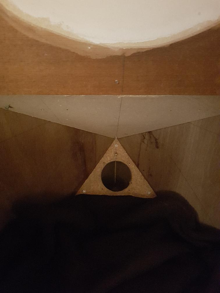

This is a photo of a lower frequency waveguide on the floor in the corner. The driver cutout shown was for an 8" driver. I had calculated it would be marginal but I had it on hand and it was OK with the confined rear space.
It couldn't even cleanly reach 650Hz, which was where it was meant to cross. Getting close to walls makes the way you do it more critical.

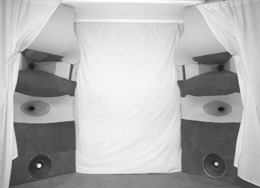

I don't have a better photo on hand, but it is as simple as it looks.Interesting - could you please show the whole corner arrangement Allen?
