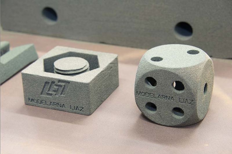

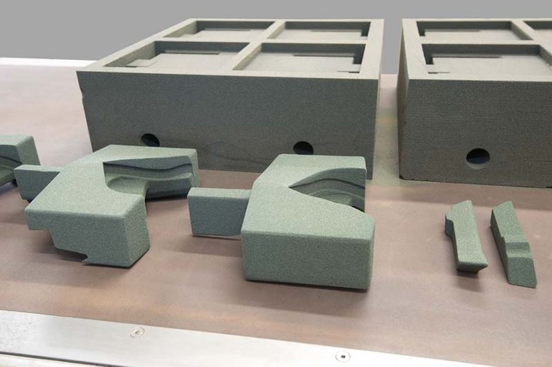

- Does anyone have an experience with rough waveguide surface? There's a company here able to 3D print from (resin-impregnated) sand. They use a hi-tech professional equipment mainly for mold printing. I'm seriously considering trying it out (15" WG for about 200 EUR/piece). Of course they could also cast from aluminum right away (~600 EUR/piece).

Prices seem fair. How about multi price? Thinking group buy here... Shipping costs?
If one paint that and sand it down where the sand starts to show... should give a smooth surface. And yes, surface finish vs. sound? Really, isn't that "imagined"?

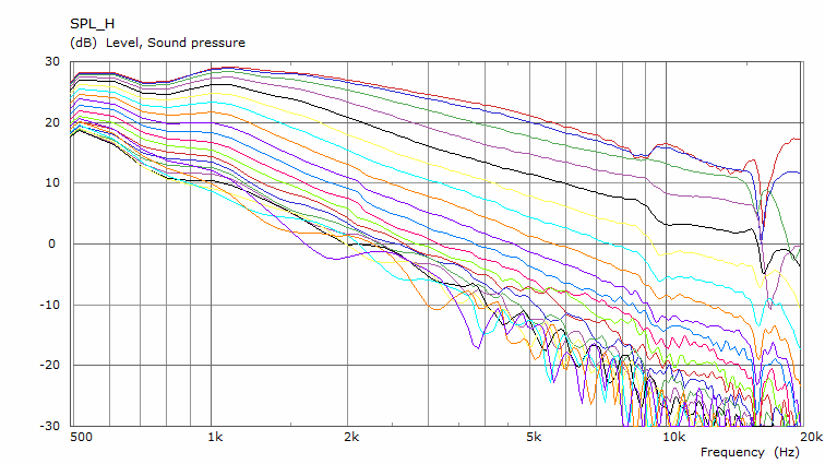

Here is results from my simulation of a 320x198 mm horn I intend to 3D-print for a 2" fullrange driver (Peerless 830970):
900343d1607496002-acoustic-horn-design-easy-ath4-cs27-0-150-polars-png
The lines are spaces with 7.5 degrees. So at 2 kHz -6 dB is at about 34 degrees and at 5 kHz it's at about 28 degrees (both with 15-degree as reference).
Do they give any strength values for that material? Seems like it could be somewhat weak and brittle.
Joined 2004
That's for a raw print alone, i.e. for molds. I guess that the epoxy resin impregnation (not a standard treatment) makes it pretty strong - "as a stone", they say.
Some more photos:
Joined 2007
This looks very promising and price competitive with other construction methods for large waveguides. Whats the actual machine like that makes these? some kind of 3d printer? Can this also be used to directly make a unity horn from a 3d model? maximum dimension of 1800 x 1000 x 700 mm is huge!

Interesting!
Do you have a spectrogram for this? I find it easier to evaluate relative performance on them.
