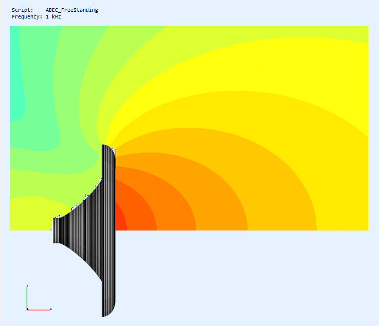

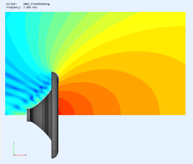

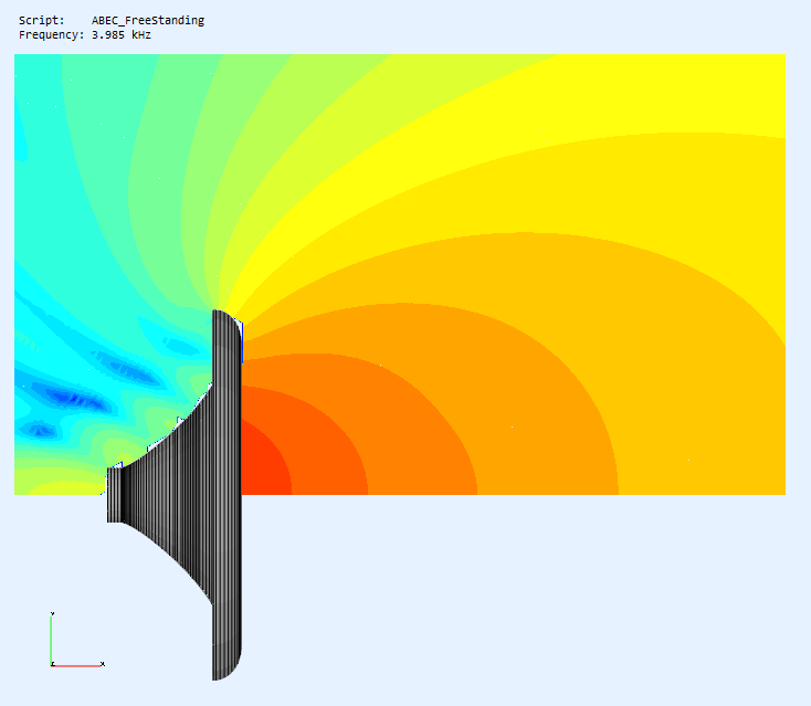

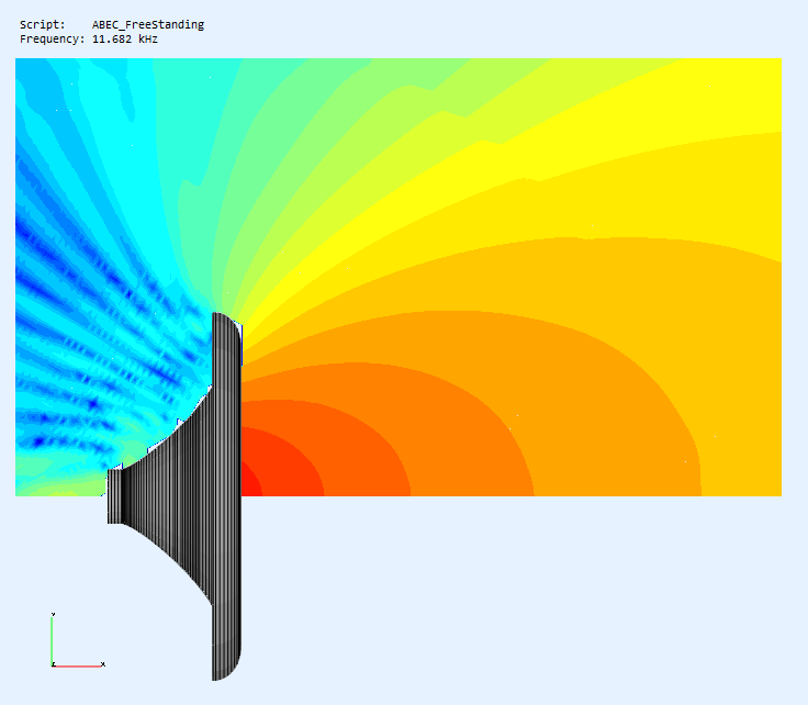

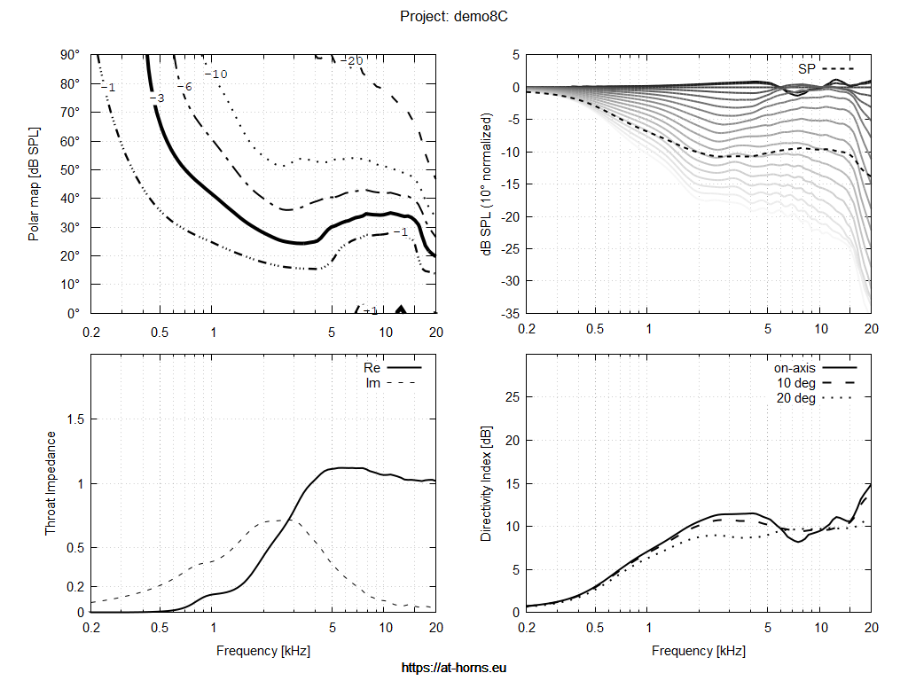

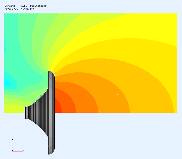

It can be made worse (much worse, of course), no doubt about that. The above was the "sandhorn". This is the demo8C.cfg from the released Ath package.
(3 dB step division)
But all of this shows in the polar maps. That's what we are interested in in the end, isn't it. I simply don't see a "smoothness of the pressure field" as an overlooked mystical quantity. Definitely it's not a privilege of beaming horns, that's clear. And it has obviously nothing to do with loading.
I think what the Le Cleac'h profile provided was a smooth curve and a good termination, in optimising the loading etc. the polar performance was compromised.
Mabat's latest examples show that the smoothness doesn't have to be at the cost of polar performance. This is very promising as many anecdotally praise the on axis sound of Le Cleac'h horns so it seems like it could be a could compromise.

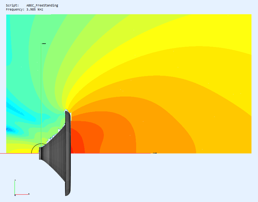

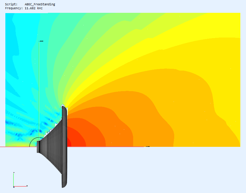

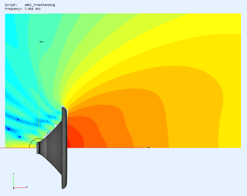

I ran some simulations on the effect on the waveguide output in the presence of a woofer and a woofer cut into the waveguide. I have posted them in my ABEC thread to avoid cluttering mabat's.Any comments on my proposal to nest the woofer into the horn and use the C to C interference to maintain pattern control down to frequencies where it is usually lost?
Smoothness of the pressure field and loading are 2 (separate) aspects that JMLC considered important.
His objective was to "design horn profiles that are complete and address the entire impedance transformation problem from enclosed driver diaphragm to the open air."
OK. From your previous post it followed otherwise.
JMLC horns represent smooth termination of an exponential horn into free air. That's fine. Polar smoothness is the positive by-product of the shape resulting in high acoustic impedance, the beaming the negative one.
One can definitely have smooth radiation and controlled directivity. As yet I haven't found a way to have high acoustic impedance at the same time. The best I found so far is simply a middle ground.
