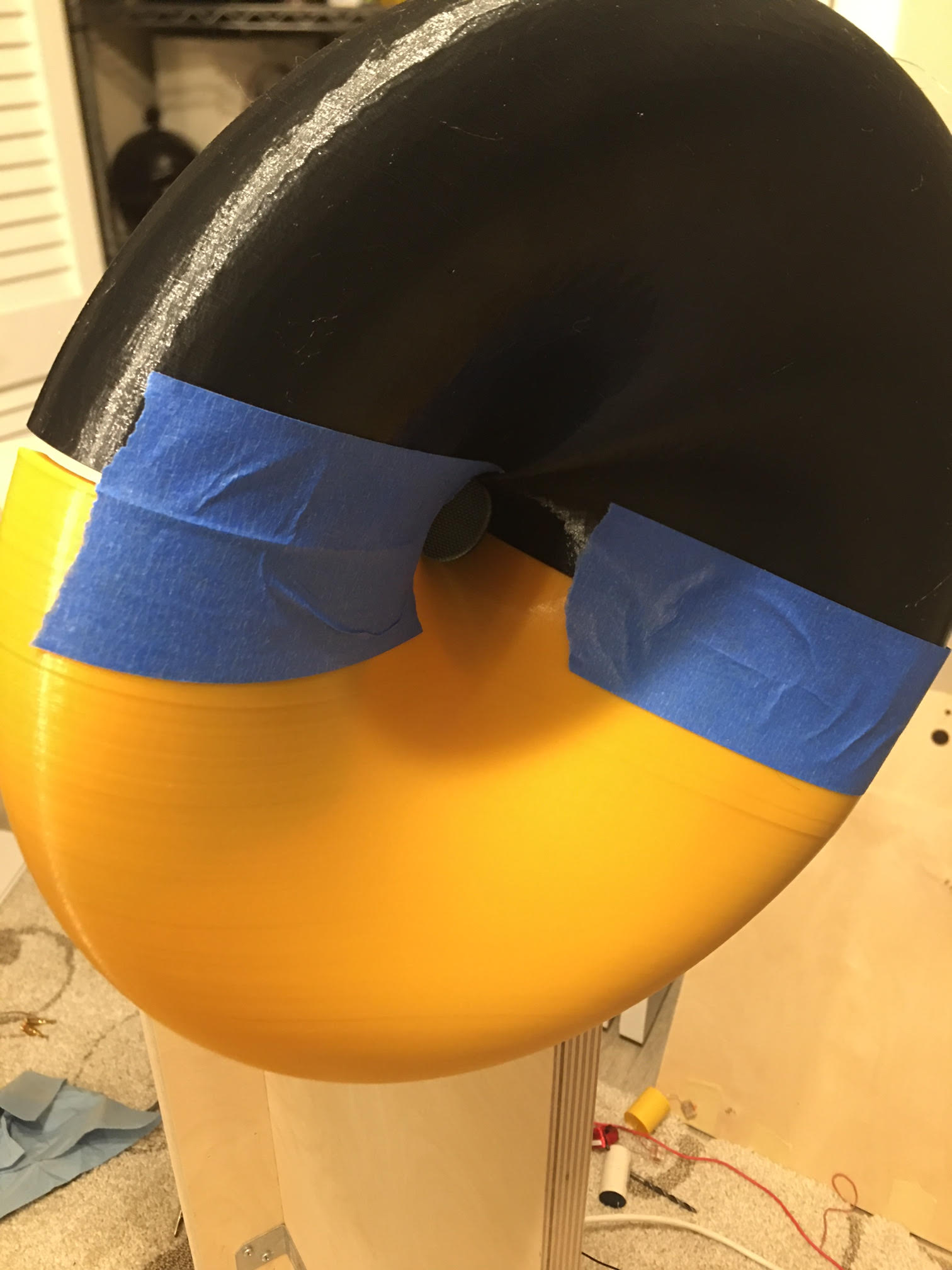

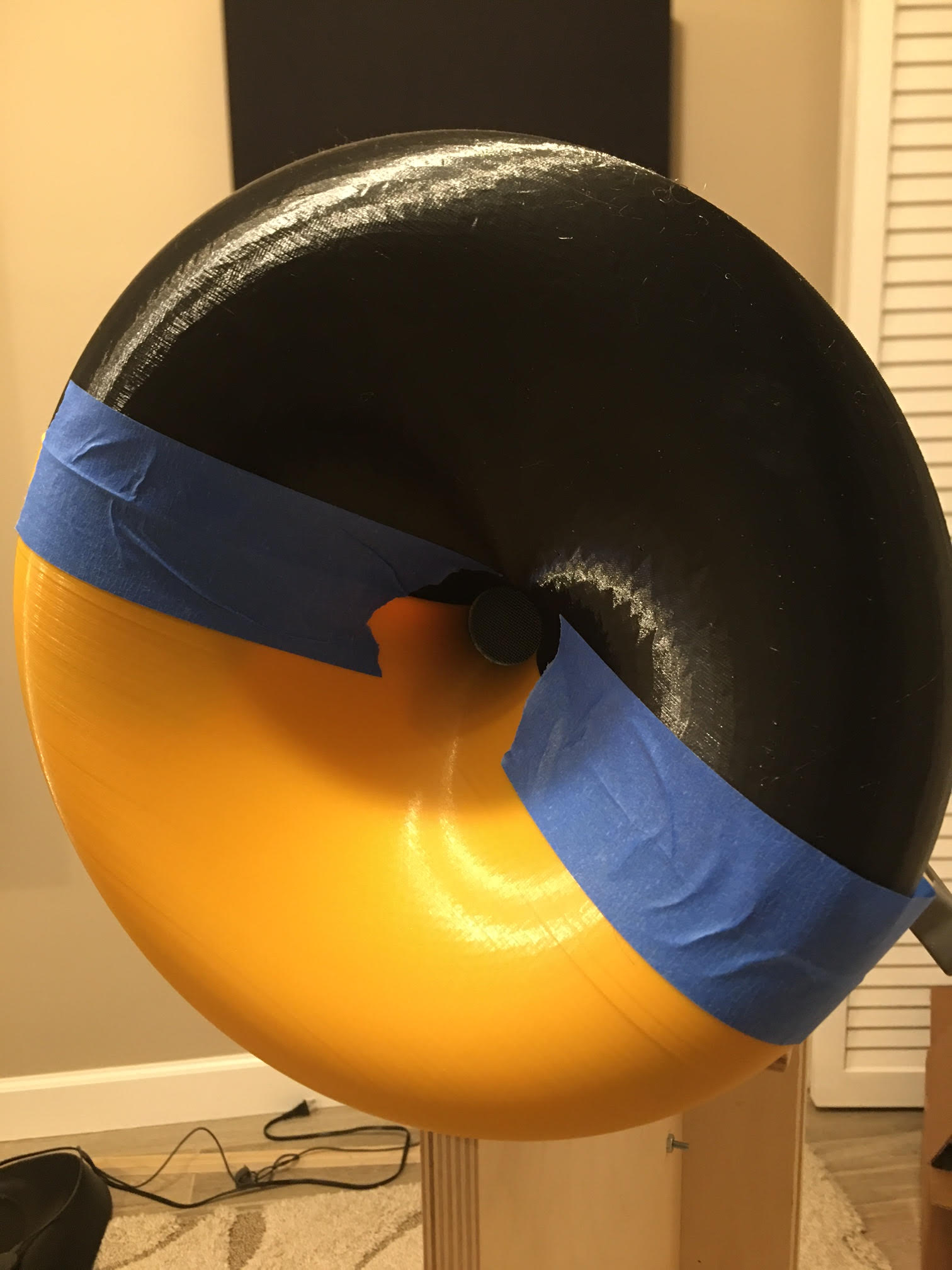

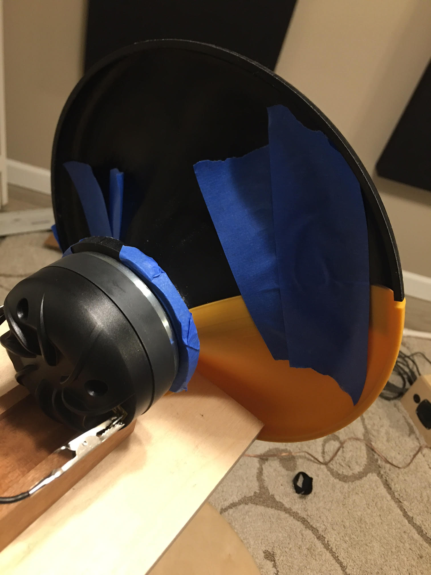

Measurements from a failed print job
I took some measurements of the Peerless DFM-2535R00-08 (the only compression driver I have on hand) on a failed print job of the horn included in post #4948.
Basically, the adhesion failed at the very edges of the horn. In any case, I still was curious about the performance and just blue-taped the two halves (no epoxy, no glue, nothing) - just two sides taped together. So the horn should not be judged by the measurements included below (i.e. too many imperfections in the final assembly), but just wanted to share the results nonetheless. I just took quick 0 - 60 degree measurements (approximately 900cm @ 4ms gate time). I was pretty impressed - seems to reasonably match the results posted in post #4946, despite the imperfect print job.

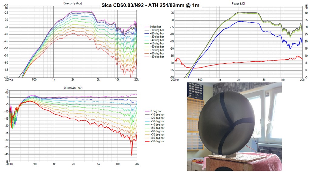

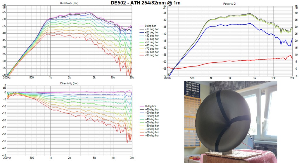

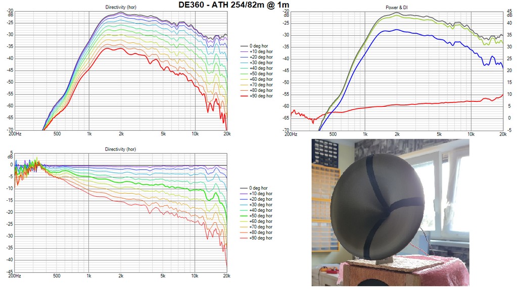

As some start to print and measure the ST260, maybe it's useful to collect (again) the results so far - this is a courtesy of Pet007 who measured virtually the same WG before (maybe there was a tiny difference, I don't really remember), with three different drivers -
Just a note - the DI as shown is calculated from the front polars only (the only measured). The "real" DI will be closer to the simulations, where it is full-space.
I took some measurements of the Peerless DFM-2535R00-08 (the only compression driver I have on hand) on a failed print job of the horn included in post #4948. ...... snip
Nice, if not fantastic 🙂! What was the circumstances around the measurements... did you use EQ? Or probably normalised - can we see the actual raw FR?
I mean this is +/-0,5 dB on axis between 450Hz and 20k - I suppose you have had to - please present the EQ curve. Also, at what spl was this? Can you extract distorsion out of your measurements - if so, please post some figures.
That was normalized, i.e. effectively an EQ used such that the response at selected angle (on-axis in this case) is exactly flat. It clearly describes the WG "alone", without the properties of a particular driver. In the Pet007's data this is the left lower chart. The upper left is the raw data.
