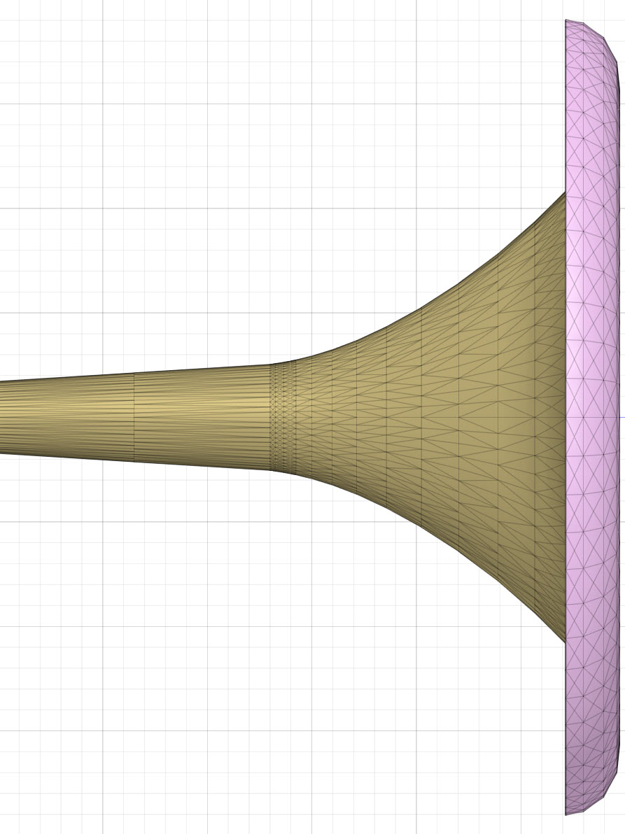

Just tweaking the demo1.cfg and entering your suggestions for the TAD2001.
Throat.Ext.Length = 65 ; [mm]
Throat.Ext.Angle = 3.6 ; [deg]
OS.k = 5
Rollback = 1
Rollback.StartAt = 0.6
Rollback.Angle = 180
Does this look alright?
