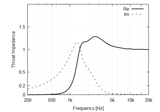

AS you might expect, the coupling of the elements around resonance can get complex and unintuitive. Models are usually required.
But at these L(ish)Fs the waveguides impedance looks like a simple mass. The dual humps in the electrical impedance curve are due to the coupled oscillator defined by the gap compliance and the two masses - waveguide and diaphragm. At the lower impedance you have the two masses in phase and the above peak they are out of phase, i.e. 180 degree phase shift. This coupling makes the whole problem much more complex.

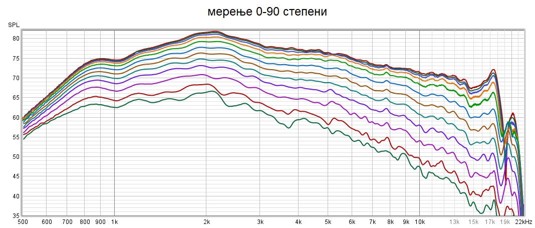

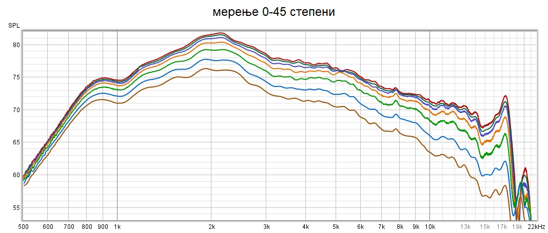

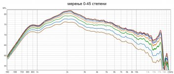

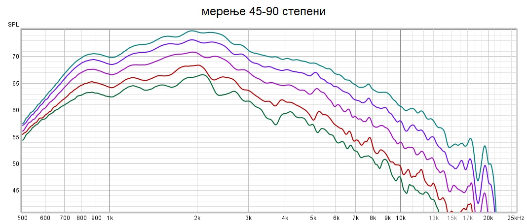

This evening my friend Jokerbre and i measured Peerless DFM2535R00-08 on Mabat's ST260 waveguide.
Measurements are done from 1m distance with calibrated Behringer ECM8000, Steinberg UR12 and gate frequency of 4.4ms so enough to capture trends of this waveguide. What is shown here are measurents 0-90 degrees with ≈7.5 deg increments in between. Since i did not calibrate REW and my mic for loudness, SPL levels shown aren't representative of actual SPL level. Off axis measurements 60 degrees and up are smoothed 1/48 to avoid "hair" at higher frequencies.
0-90 degrees

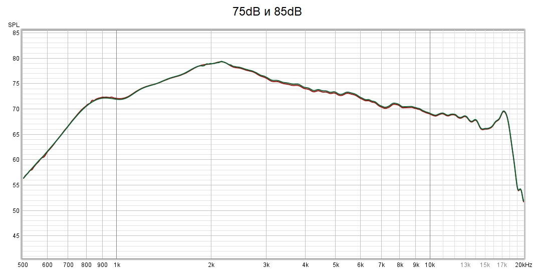

75dB vs 85dB loudness

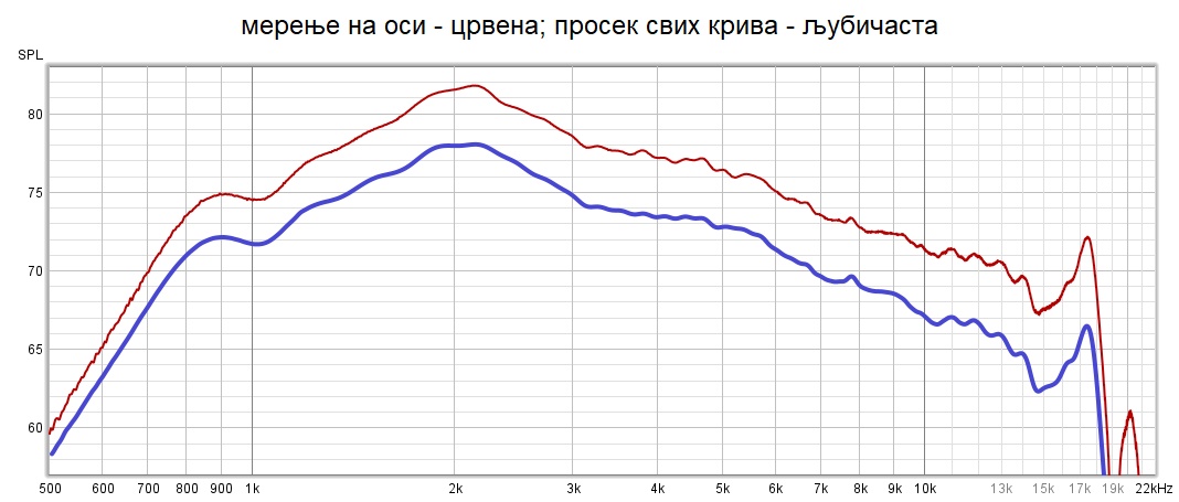

measurement on axis (red) and averaged 0-90 degrees (purple)

I must say that i've never seen better and more extended frequency response from a smaller waveguide and a cheaper compression driver.
0-90 degrees
![0-90 степени.jpg 0-90 степени.jpg](https://www.diyaudio.com/community/data/attachments/880/880968-e71fefe256310c9c60e520673a8a9cd5.jpg)
0-45 degress
![0-45 степени.jpg 0-45 степени.jpg](https://www.diyaudio.com/community/data/attachments/880/880973-0e40e3bc9da79f4c357e22651f61e13a.jpg)
45-90 degrees
![45-90 степени.jpg 45-90 степени.jpg](https://www.diyaudio.com/community/data/attachments/880/880980-2f6c5384424cb33d3aab914d70d59b57.jpg)
![75 85.jpg 75 85.jpg](https://www.diyaudio.com/community/data/attachments/880/880985-6bf3934c4d285e582244828681e0786a.jpg)
![мерење на оси и п&.jpg мерење на оси и п&.jpg](https://www.diyaudio.com/community/data/attachments/880/880997-789ba5345211ed3eb1462da6ba7e21dd.jpg)

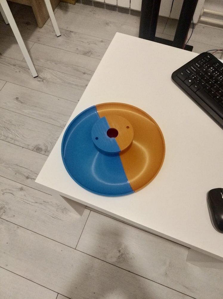

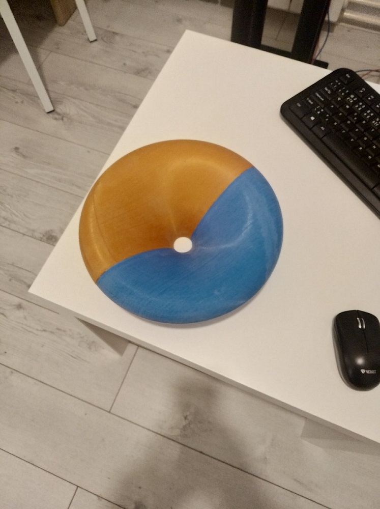

printed waveguide
![звуковод напре
.jpg звуковод напре
.jpg](https://www.diyaudio.com/community/data/attachments/880/880993-447d58ed45ac885ff95a46237e6aee50.jpg)
![звуковод назад.jpg звуковод назад.jpg](https://www.diyaudio.com/community/data/attachments/880/880989-0966e33946eab6088cb8b82ed2e91ba4.jpg)
Very nice indeed. Nice looking print quality as well.
Same quality of directivity results I measured with a different driver, BMS 4552nd. ST260 is a killer little waveguide.

0.2mm nozzle with 20% infill.

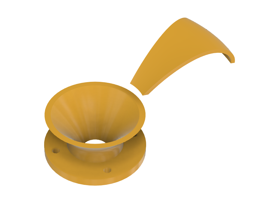

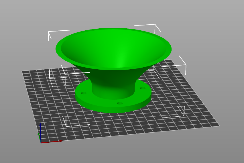

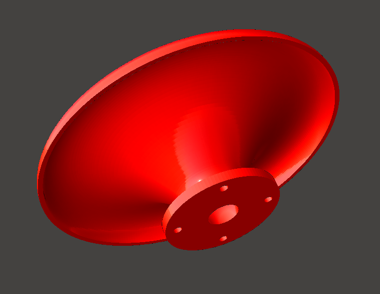

I've added a 4-hole mounting flange STL: ATH - ST260 Sample Waveguide

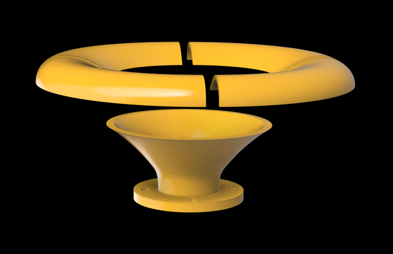

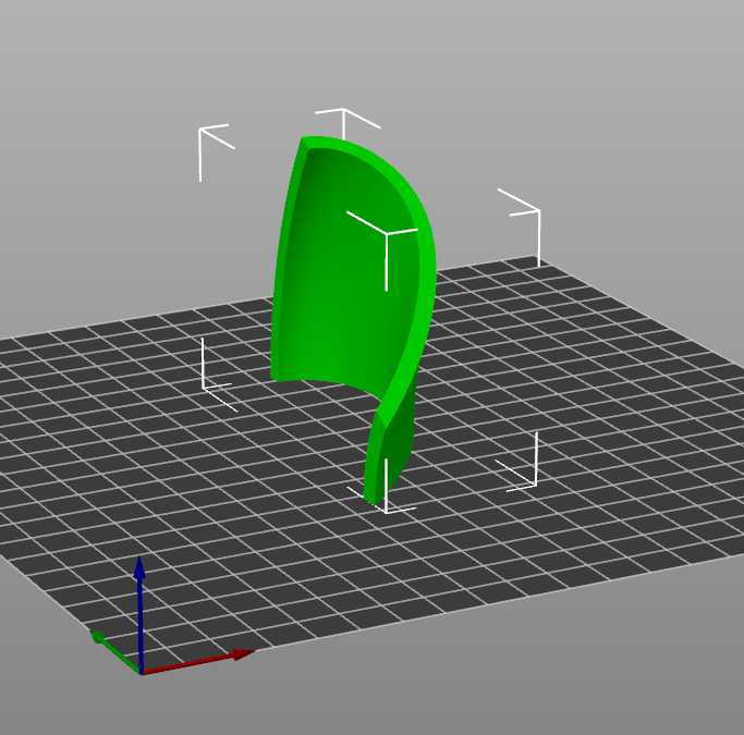

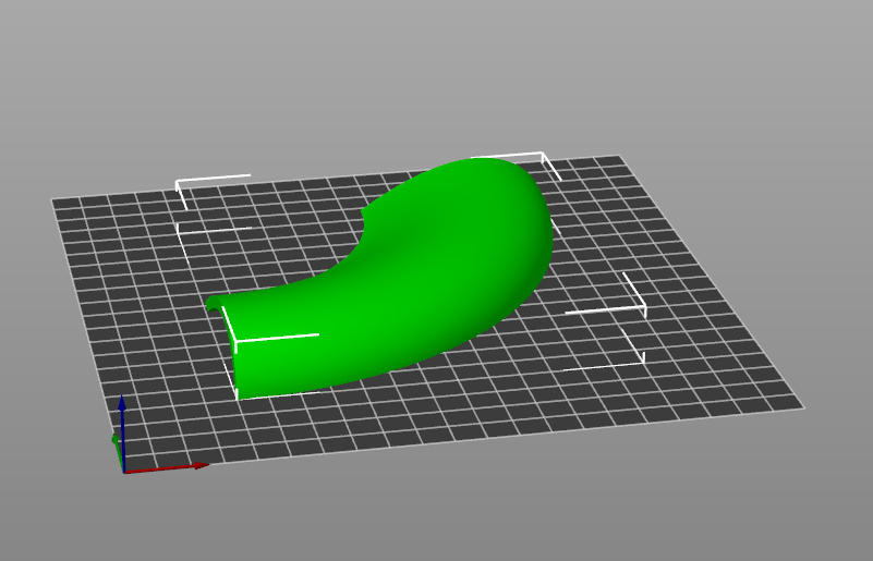

Maybe this could be a way of printing it with minimal warping.
For even larger horns it could the the throat section + "petal" pieces of the rest, printed one by one diagonally across the print bed. Could be tedious to put it all together, that's the drawback.
As even the smaller printers can do 250 - 270 mm diagonally across the bed, I guess it could be pretty big, actually, like 15" at least.What is the maximum dimensions this way? My printer is tiny . . .
A good thing about this approach would be that a one failed print doesn't mean doing it all again.
An actual object optimized for this approach could be made a lot more sturdy/massive, of course, especially around the main joint. But it wouldn't be particularly cheap either if made in a print shop, I'm afraid. Someone would have to try.
