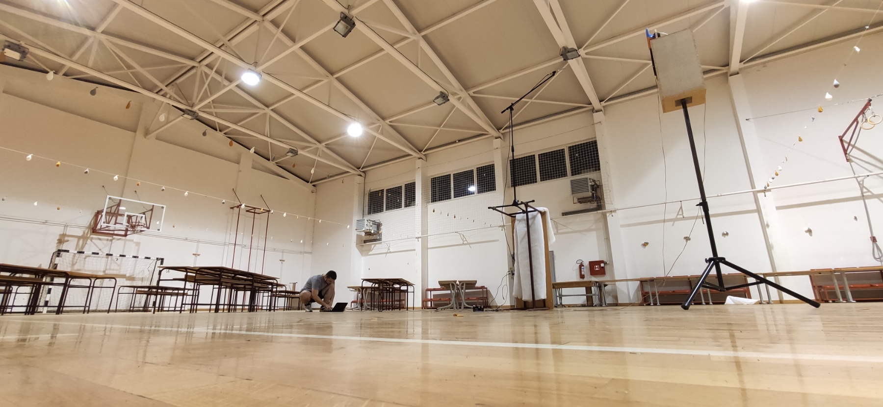

Anyhow, my friend and i measured st260 and Peerless, this time with 13ms gate mounted on top of a cabinet to see if it influences frequency response in any meaningful way.
It still holds like nothing is beneath it.

Pic from few nights ago:
3m mic height and deriving sim files.

What can I say - Bravo!Pic from few nights ago: ...
