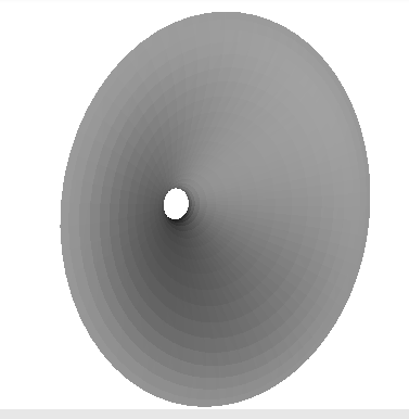

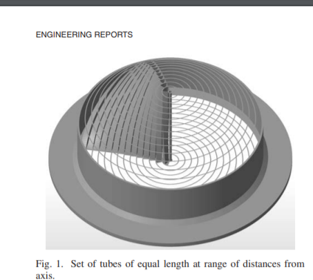

Berstis lens was mentioned earlier in the thread. Just in case I'll post it again to further stimulate brain activity 😀
https://www.aes.org/tmpFiles/elib/20211012/19881.pdf
Berstis method doing it enables "channels" without bends. Not sure how one would make the Berstis style channels expanding though so a short pipe section done like this could do?
Patric Bateman mentioned earlier in this thread that the sound of such lens wasn't reported particularly good though...
Regarding the Berstis lens, it's all about implementation, and I think it's not that easy. Due to the non-zero thickness of the walls, which occupy quite a lot of the cross section area, there will be a step change in the cross section, i.e. a reflections both at the input and the output. As illustrated, the walls are not parallel to the wave propagation for the outer channels, which I assume is also not a good thing. As it is, it just can't work very well, IMO.
It's all about the details.
I had that feeling about the channels getting narrower too.

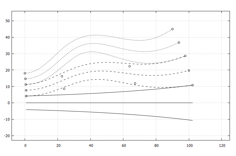

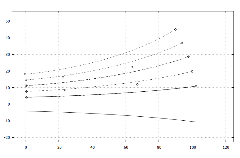

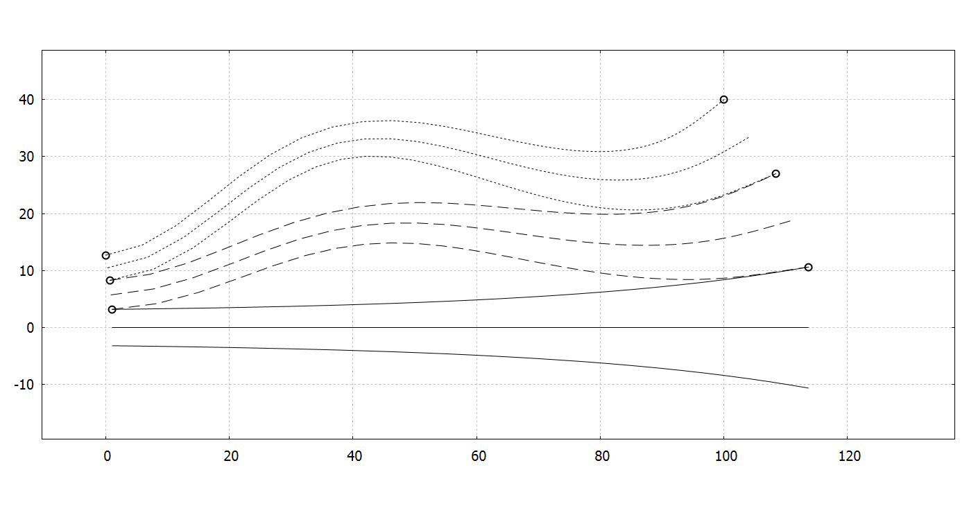

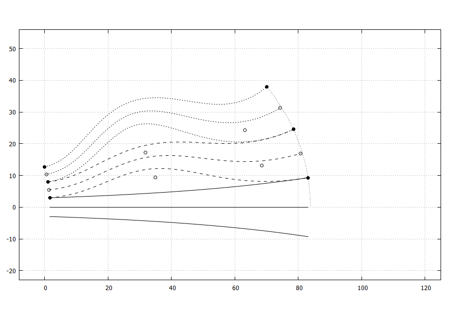

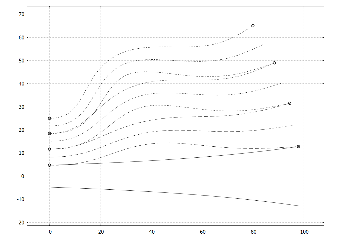

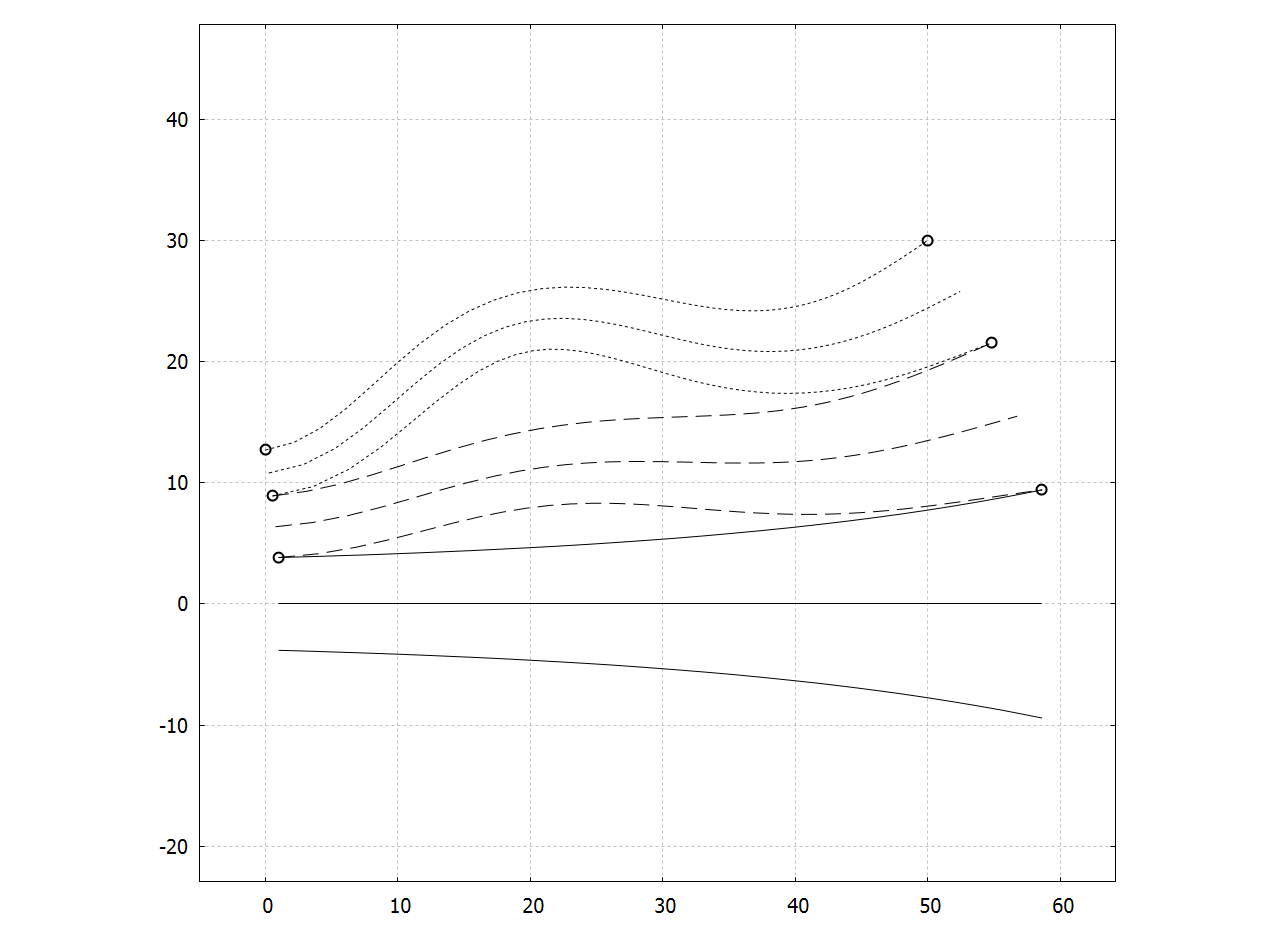

1.4" throat - initial / meandered channels.

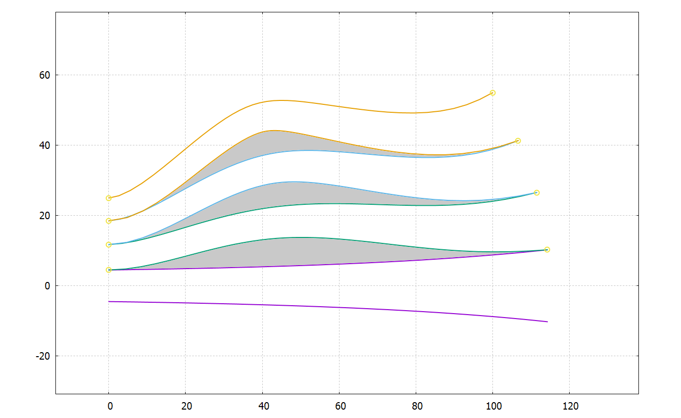

The center lines of the initial channels are simply Bezier cubics. The meandering is then a little bit more complicated.

Not yet but I'm working on that. Probably each channel will need its own interior subdomain. For simulation and optimization I think the easiest for the start is to place it in a sphere, i.e. with the reference being a pulsating cap on a sphere - it should be clear how it should perform (can be simulated easily).
I plan the first real testing without a waveguide, just the vanes in a large baffle.

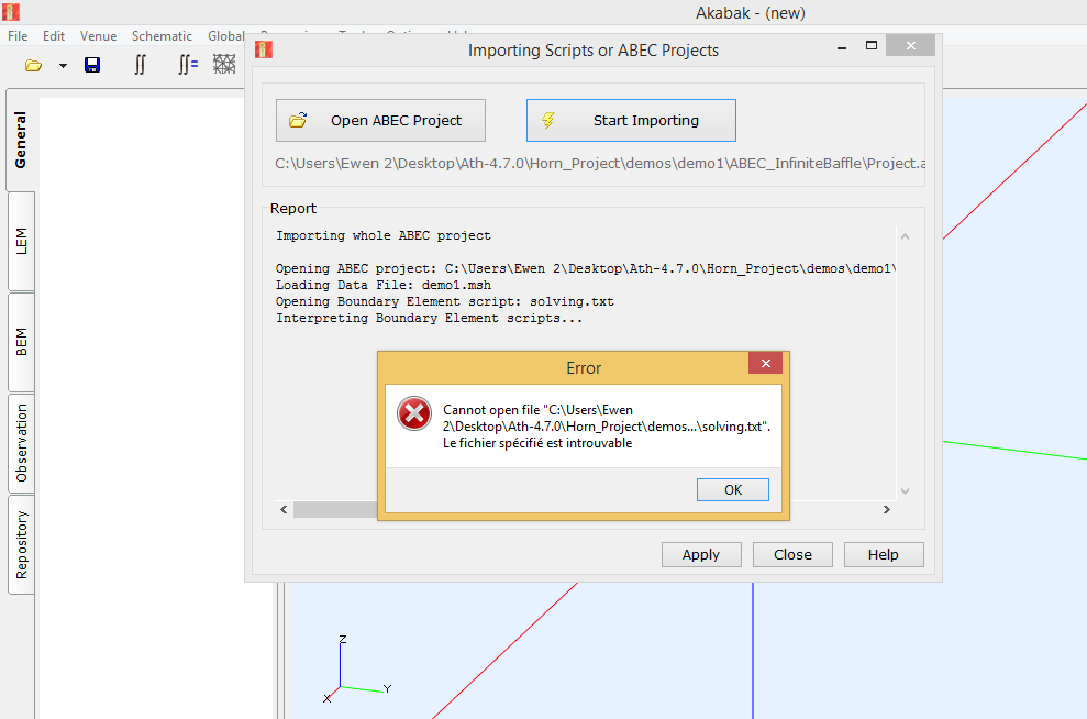

First I want to thank you, Mabat, for the amazing job you did for this software !
I tried to run it and open the ABEC project with Akabak but I've got this issue: when I click on "Start importing", it says a file finishing by "solving.txt" is not found (see attached picture).
At least the meshing part is good I think:
Does anybody know what it could come from ?
