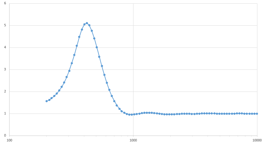

At 507 Hz the normalized throat impedances are:
0.008 + 0.260i (smaller WG)
0.032 + 0.264i (larger WG)
So the real part is 4x higher, actually. It that a plausible result? I don't know. It doesn't mean much anyway, none of those two waveguides would be ever used that low, but it's interesting.
It seems that with the larger waveguide there's still an obstacle to the wave propagation that is already almost gone with the smaller one. That's also why the DI is still considerably higher.

Yep interesting, looks roughly 6dB increase in power there around 500Hz as well. Make the real impedance 0.128 and get power above 90db at 500Hz?! Instead of reaching for sharper impedance cut off with the peak (high Q, the exponential horn), one could make the impedance knee low Q and extend the "tail" lower in frequency? Well, having fun reasoning, I don't have a clue how it all plays out
If you look the GIF impedance plot carefully there is difference in many parts, both the peak and the turn around ~1.5kHz are "smoother" with the bigger device. The highs have roles reversed though, smoother with the smaller device.
I speculate from the impedance plots that you are approximating the "best" profile with these two devices from both sides of it, if the smoothness of the plot is some sort of measure of goodness. The small peak there is in the impedance dictates there be ripple higher up, or vice versa, no peak no ripple, like sharp/shallow filters in frequency domain. Reasoning from this speculation the smoothest impedance plot is when there is no peak at the knee, no need for ripple, smoothest response but no loading what so ever, right? I guess the loading and performance would happen if you could shift the whole throat impedance graph in frequency, or push the platoe higher past 1. I have no idea what this would mean in reality or is there any connection with reality

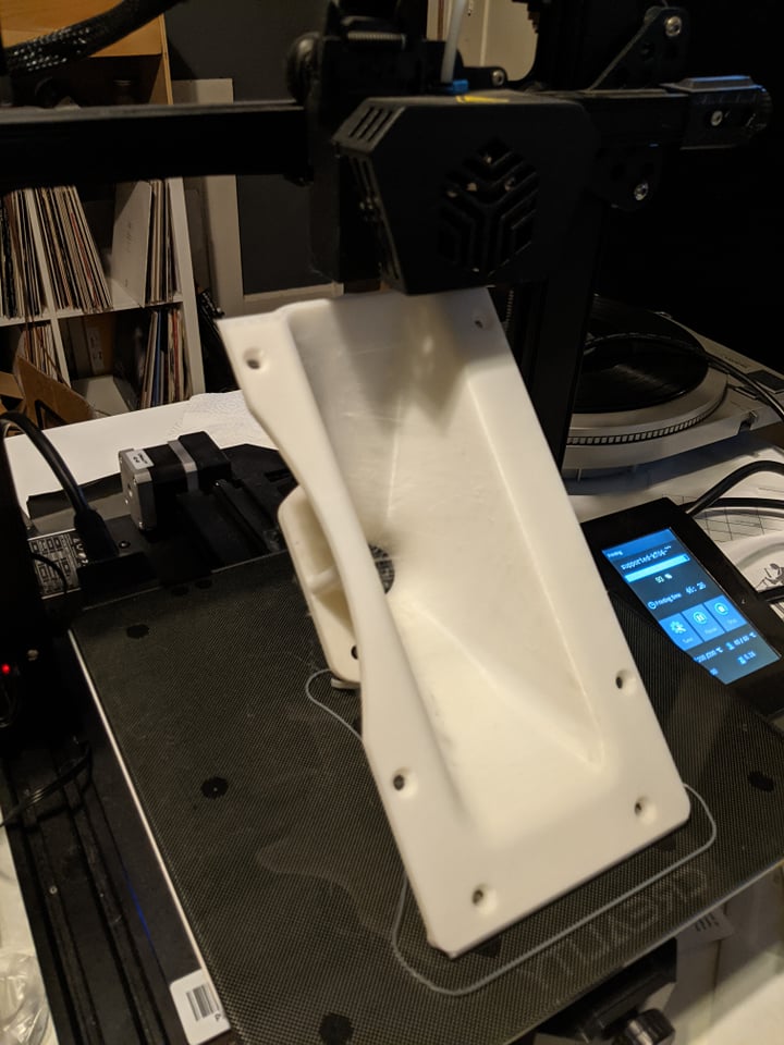

To maximize the horn size within a single print, it turns out it is possible to print with the horn tipped up at an angle, fitting the mouth inside the print volume diagonally. I am working with a CR6-SE printer with a build size of 235 x 235 x 250 mm, and not only can I print a horn with the external dimensions of the PH-2510, adding the klipsch woofer notch allows me to print two mirror-image horns at once, which seems slightly faster than printing two horns serially. Coming up with a shape worth printing even one of is a different matter entirely, of course.
Next I would like to experiment with printing in wood-PLA composite instead of normal PLA, and using the 'gyroid' infill available in the slicer software as external ribbing instead of the ribs which I have modeled explicitly in CAD - I think the gyroid shape is open cell, so perhaps there'd be an advantage there in terms of displacing less cabinet volume. With a coarse enough gyroid pattern, I wonder if it would be possible to pour resin into the open gaps.
The profile of the horn shown is more or less what I showed in my demo of the surface loft command, only instead of an 8mm long cylindrical throat which is easy to see in screenshots, I shortened the cylinder section to 0.1mm. Ultimately this will be replaced with an ath4-generated surface, for now I am just assessing manufacturability and verifying external mounting dimensions.

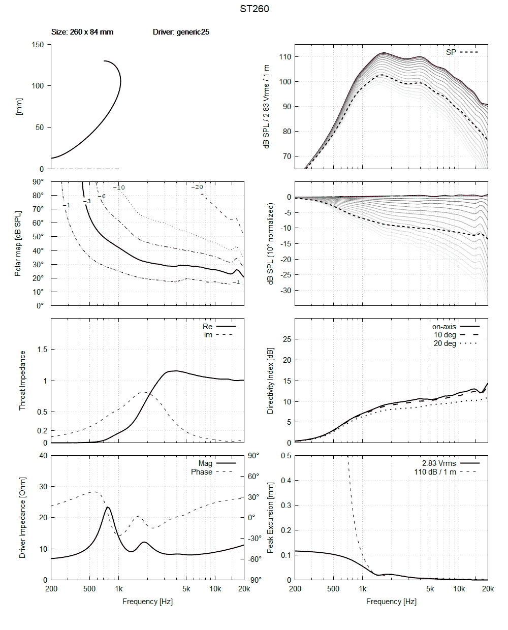

The biggest change is the added lumped element support. Now we can simulate waveguides driven by "actual" transducers (not only compression drivers but any other as well). All we have to do is to prepare the LE models...

Here's a sample script -
Code:
; ST270 - Ath 4.7.2
Throat.Diameter = 25.4
Throat.Profile = 1
Throat.Angle=4
Coverage.Angle = 30
OS.k = 2
Rot=3
Length = 120
Term.s = 1.0
Term.n = 4.0
Term.q = 0.996
Rollback=1
Rollback.StartAt=0.6
Rollback.Angle = 180
Rollback.Exp = 1.5
;Throat.Ext.Length = 12
;Throat.Ext.Angle = 8.5
Source.Shape = 1
LE = generic25
; ABEC
Mesh.AngularSegments = 8
Mesh.LengthSegments = 60
Mesh.SubdomainSlices=
Mesh.WallThickness = 4
ABEC.SimType = 2
ABEC.SimProfile = 0
ABEC.f1 = 200 ; [Hz]
ABEC.f2 = 20000 ; [Hz]
ABEC.NumFrequencies = 100
ABEC.MeshFrequency = 32000 ; [Hz]
ABEC.Polars:SPL = {
MapAngleRange = 0,180,37
Report = {
Title = "ST270"
NormAngle = 10
DrvImp_Range = 40
MaxRadius = 150
Output.STL = 0
Output.ABECProject = 1
