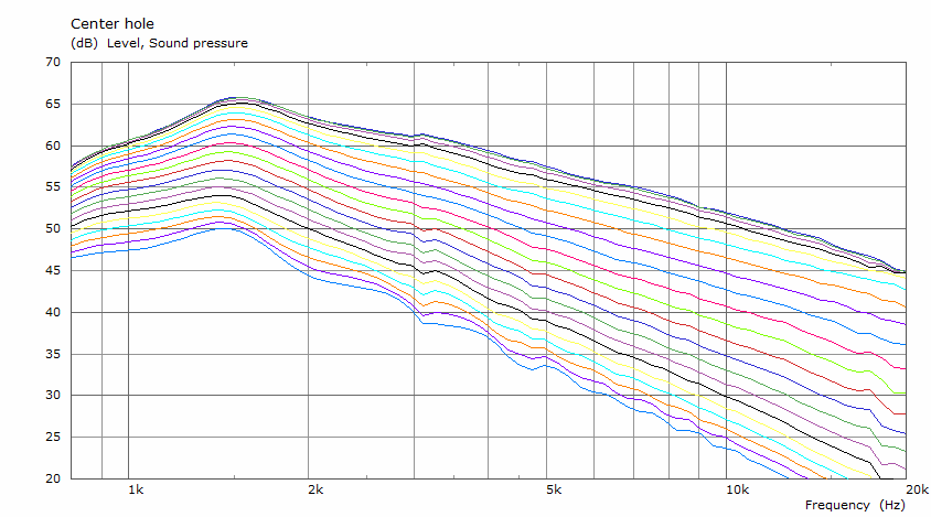

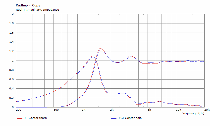

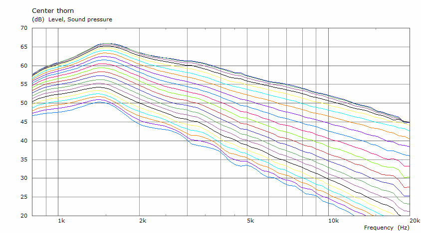

- BTW, this is a comparison of the vanes with and without a center thorn. Almost no difference in the simulation.

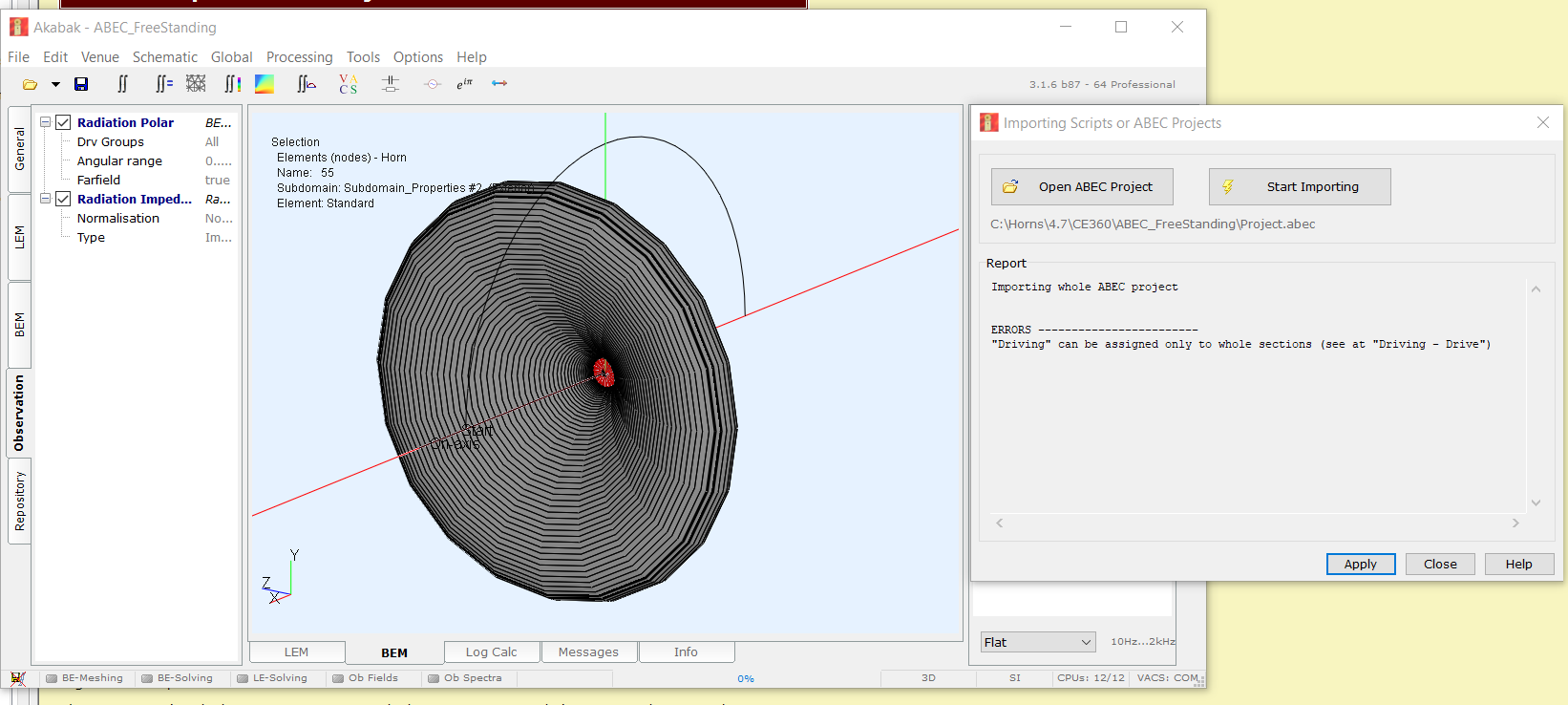

ABEC script compatibility is much better now too, most will import much better with only a complaint about the driving values as there is a difference there.
Compatibility
Most projects should come out as before and should also render the same results. Here and there, there might be hick-ups:
Observation and multiple scripts. At import multiple scripts are compiled to one single script. This may have implications on specifications of ABECs sections such as Driving_Values, Control_Field, Control_Spectra. These will be imported and applied. However only the first occurrence, all further sections will be ignored.
Compatibility

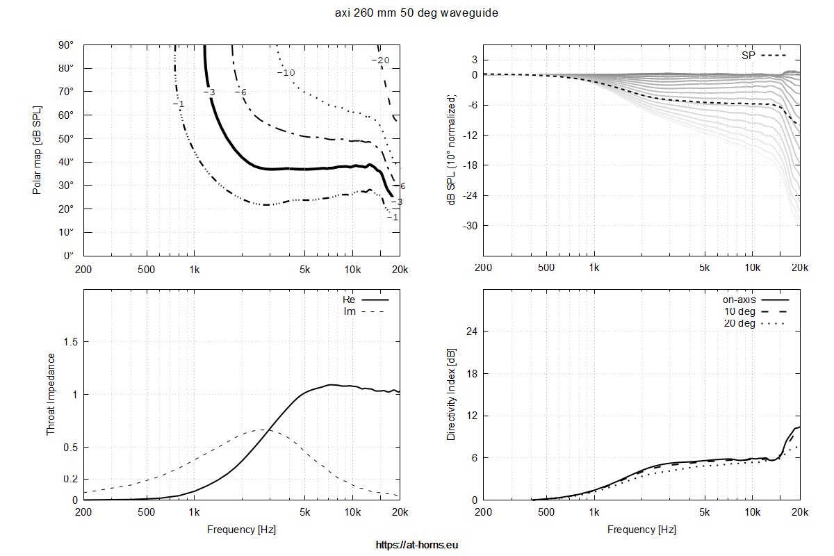

Know you're all on another thing now, but here comes an oldschool question: Waveguide pattern is defined at -6 dB, usually. I was working on a 10-inch waveguide, 50 degrees pattern and thinking: shouldn't I better tilt the -3 dB index a bit, to have a straight pattern - 6dB? (already taken into account that I will have to attenuate direct sound for this to not sound bright)
260 diameter, 66 mm length

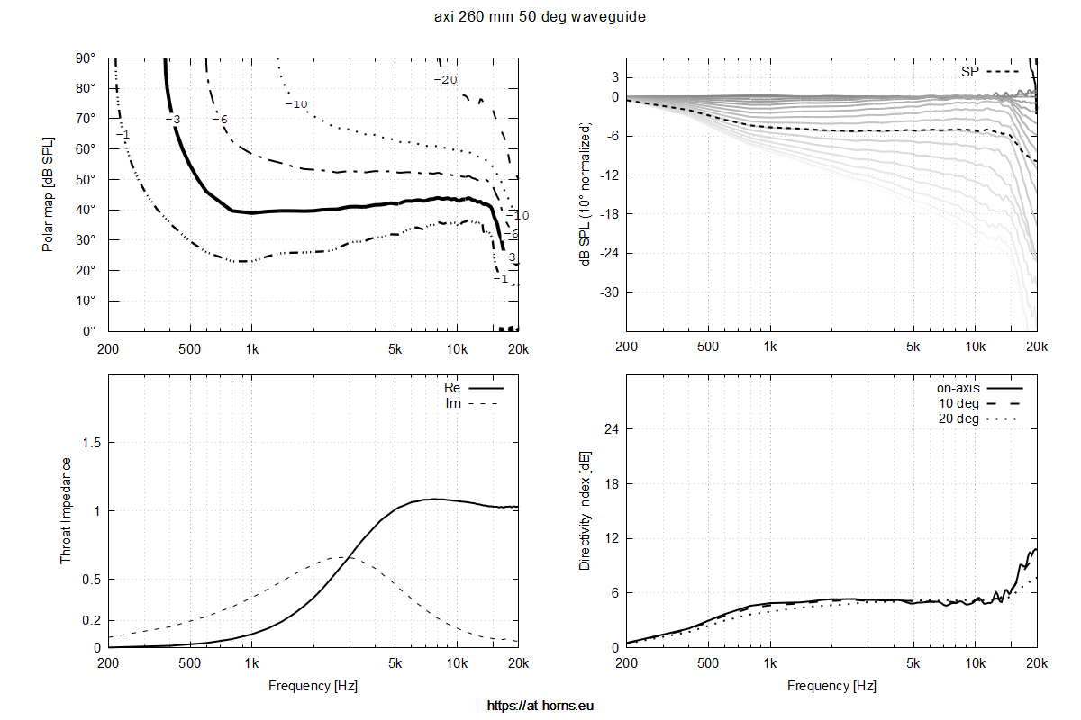

Just to check the pattern tendency in lower frequencies, I blew the waveguide up to counter the virtual widening due to the infinite baffle in Ath/Abec (settings same, but 200 mm length)
This question already arose several times, with no definitive answer. I don't know, try it. With the on-axis/direct sound flat, perhaps I would let the power response tilted down a bit (by a similar amount you would have to tilt it now).... shouldn't I better tilt the -3 dB index a bit, to have a straight pattern - 6dB? (already taken into account that I will have to attenuate direct sound for this to not sound bright)

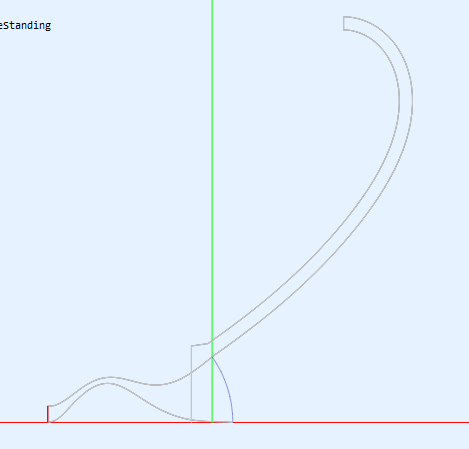

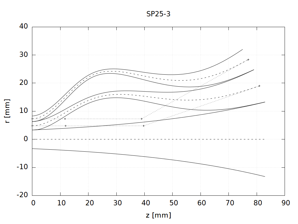

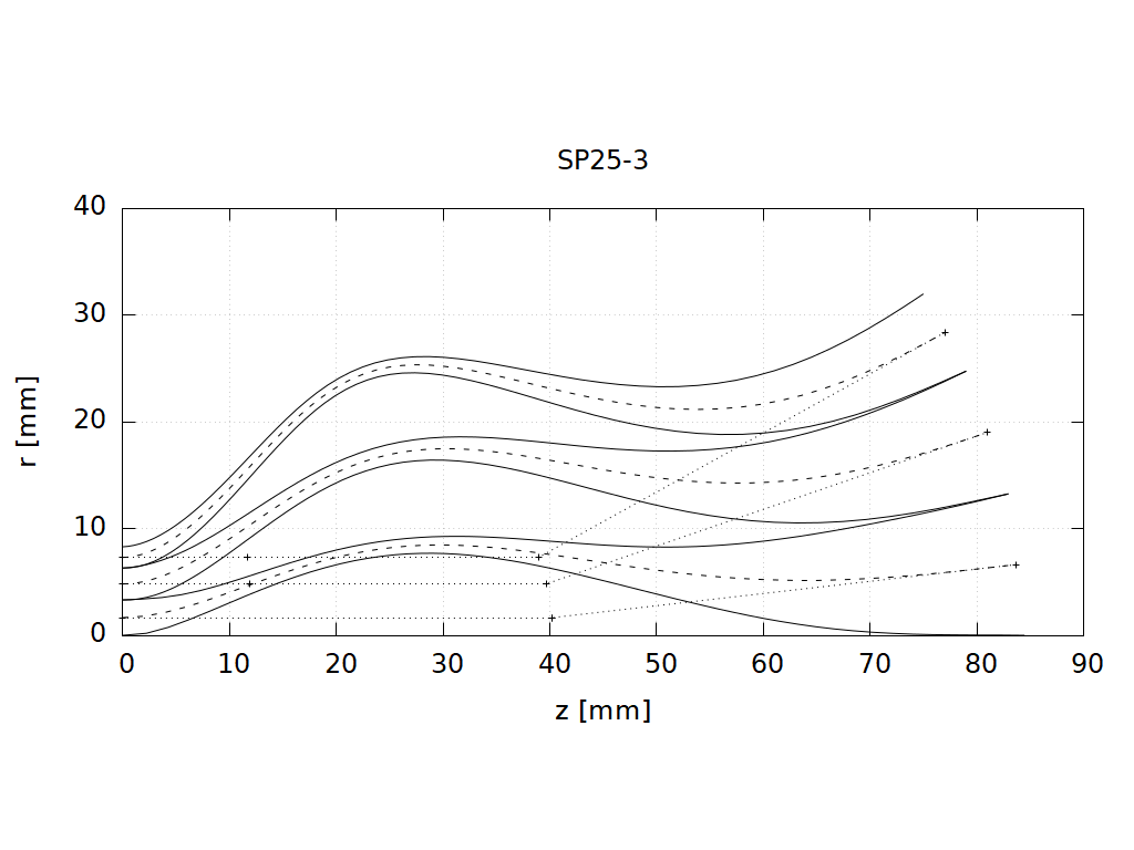

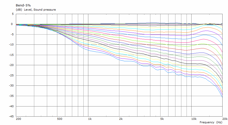

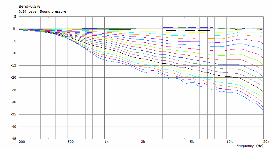

A small analysis of the channel bending effect -
Plug throat diameter: 10 mm
Plug length: 50 mm
Plug exit diameter: 40 mm
In all the following cases, input and output areas are the same, as it the nominal expansion rate.

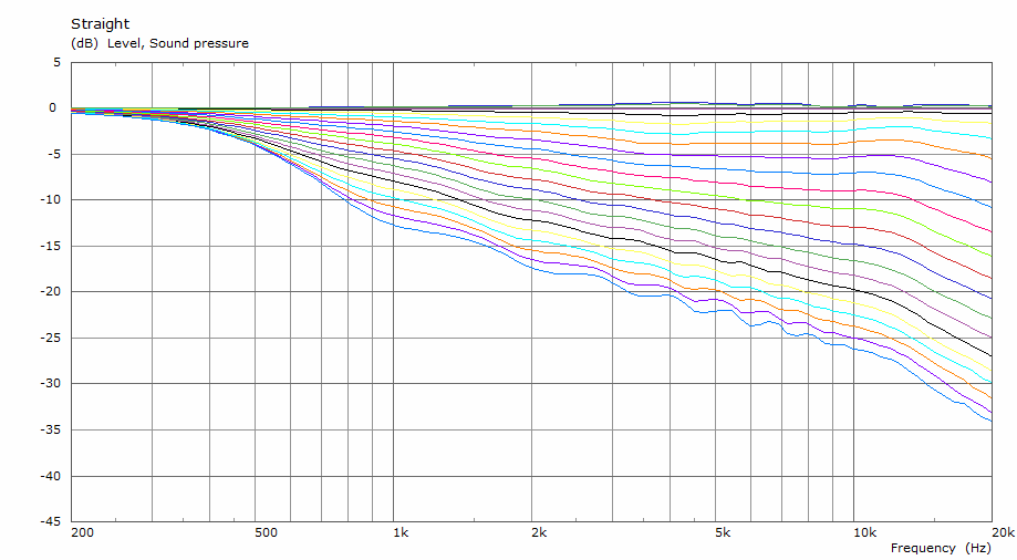

Polars normalized to 10 deg.
1) A "straight" channel (the blue arc is the interface between the plug and the WG):

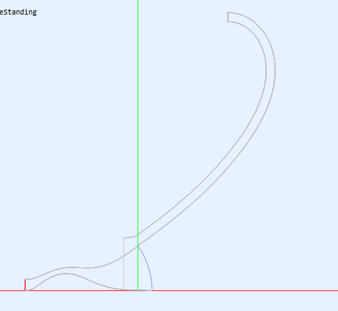

2) Bended less (0.5% of the straight length added):

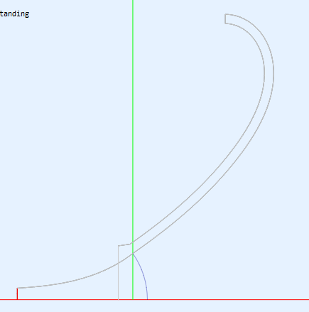

3) Bended more (5% of the straight length added):

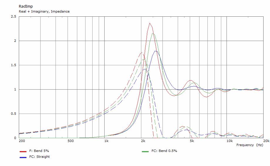

Throat impedances:
Plug length: 50 mm
Throat impedances:
