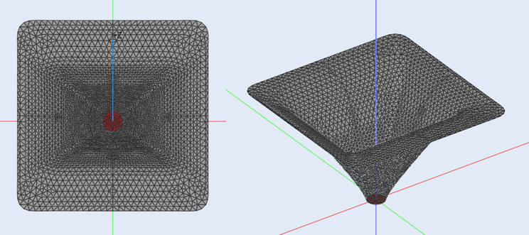

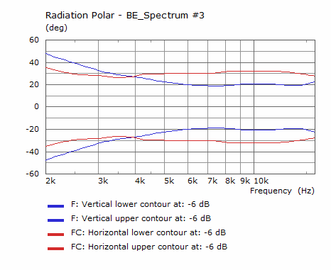

Hello Mabat, I first thank you for the update, I can indeed combine the GCurve and Morph features now.
The specifications of my project are to obtain a horn with a square mouth of dimensions 250x250mm maximum. I want a constant directivity of 60x40° (Horizontal x Vertical planes) between 2 kHz and 16 kHz.
Thanks to the GCurve and Morph features I can almost obtain what I want (first picture), but in the vertical plane I'm losing directivity control way too early, i.e from about 5-6 kHz. I would like the vertical directivity pattern to be always below the horizontal one, but on the picture you can see between 2 and 4 kHz it is the opposite.
I tried a lot of different parameters settings (mainly s, q, n variations) but it can barely lower the frequency where I lose directivity control.

So as I want a coverage angle of 40° in the vertical plane, I understand that I have to maximize my vertical mouth dimension to lose directivity control as low as possible, but I can't increase the vertical dimension, I am already at the maximum, and I can't change the coverage angle either.
Do you think there is another way to lower this low frequency loss of directivity control ?
(I attach my script and screenshots of my horn for information)

wenz56,
the apparent loss of directivity might be a result of the virtual mounting of the waveguide device on an infinite baffle in ABEC. This has been discussed earlier. One solution to test what directivity could be achieved is connected to a lot of effort and knowledge in ABEC: create a virtual enclosure. fluid did this, he told us it was a tedious task.You can disable the infinite baffle, but this will create strong diffraction effects.
I would also love to study the effect confidently, but we would need virtual enclosures for this. I currently use a waveguide which is 29 cm wide and it does control the pattern easily down to your crossover frequency, but, and here comes my doubts, this waveguide has no termination or put another way, uses most of its wall length for pattern control. Ath uses a good part for termination and I think this will also reduce pattern control, albeit for a much smoother response.
Your waveguide, then again, does seem to utilize not too much of wall length for termination, I think you should be good.
... Ath uses a good part for termination and I think this will also reduce pattern control, albeit for a much smoother response.
That's solely up to the user, it's possible to create abrupt terminations as well (not that it brings any advantage).
- It's simply not possible to create a small waveguide that controls narrow beam down to very low frequency. Or at least I don't know of a way how to do it.
