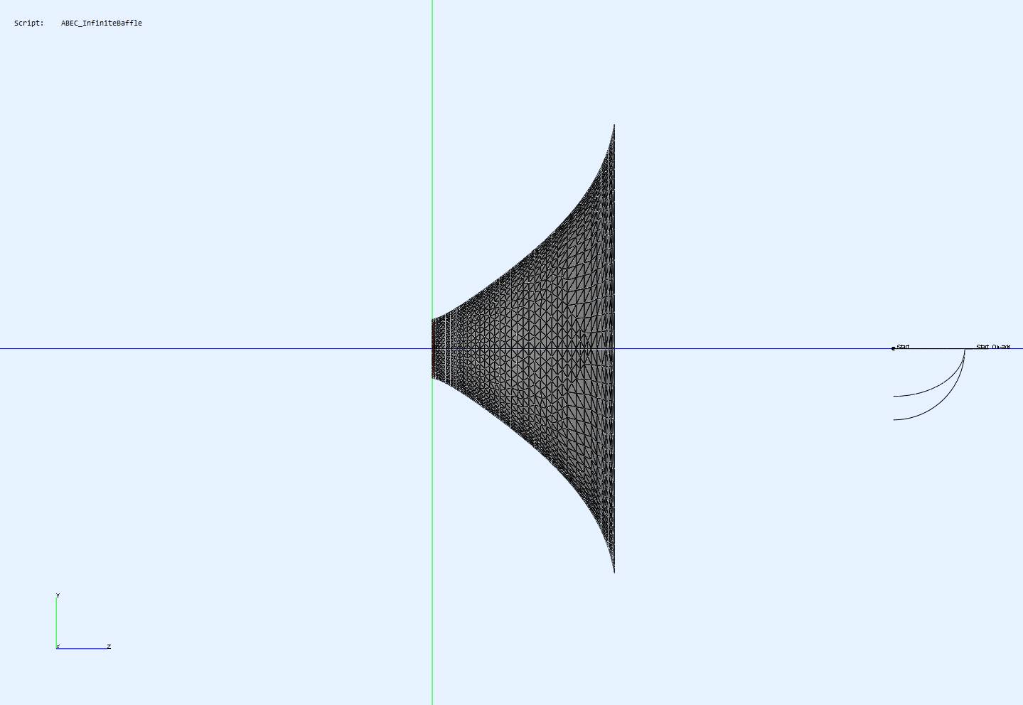

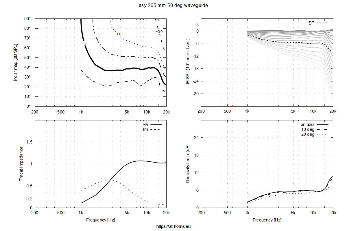

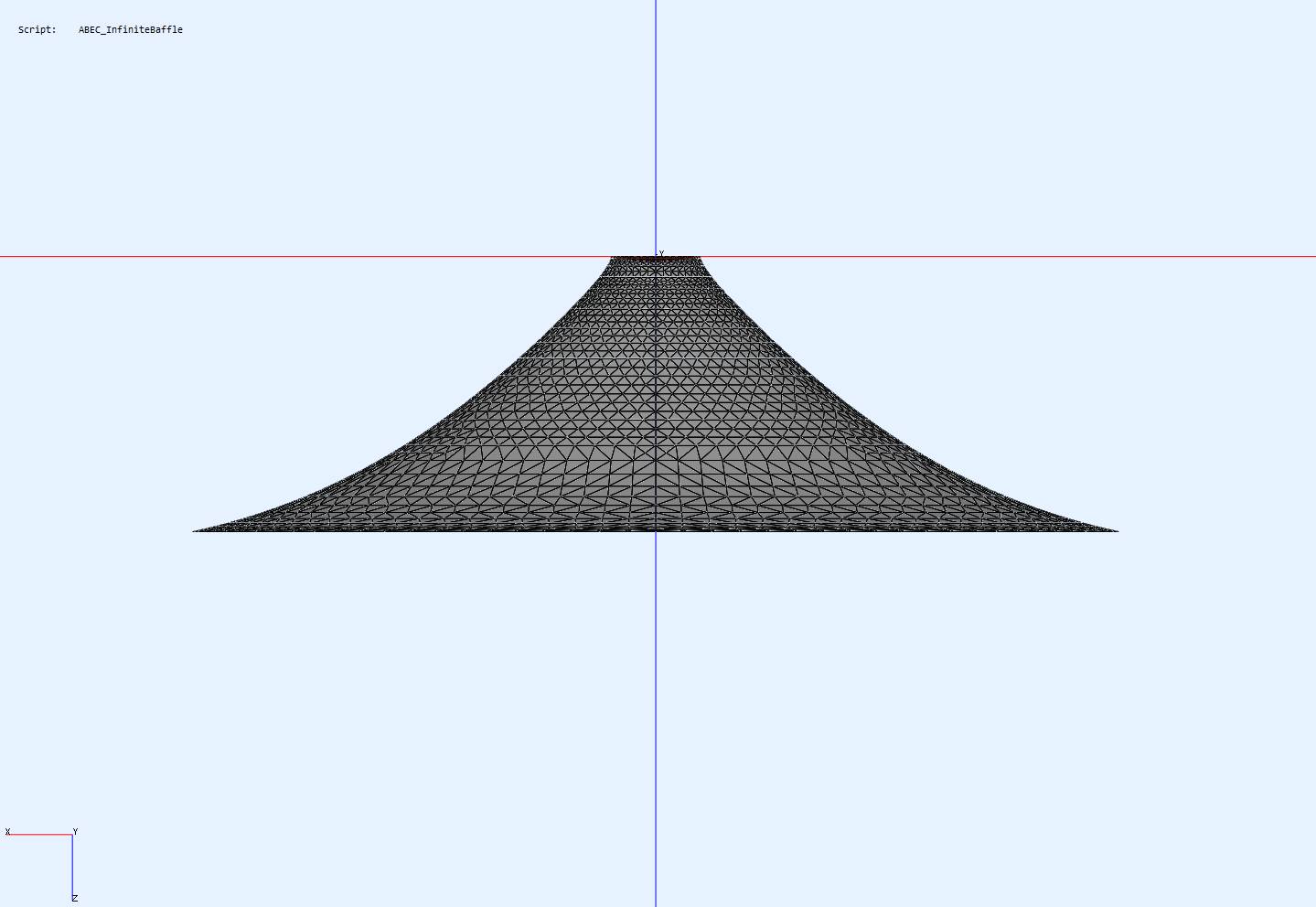

Documenting an asymmetric device which is 265 mm by 201, radiating 100 degree horizontal and 80 vertical.
I had another go, further cutting back termination and reducing the parameter q for horizontal axis. Termination-wise, it's getting more close to something like an 18sound XT1086 now.
Dimensions: Final width x height = 265.7 x 194.5 mm (10.461 x 7.658") Final length = 79.0 mm (3.110")

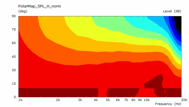

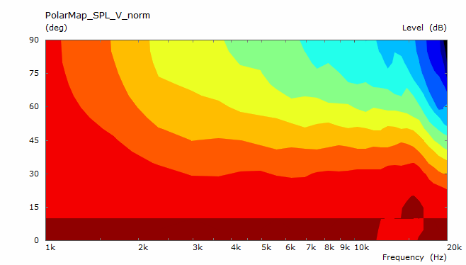

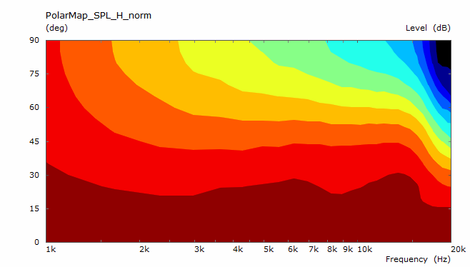

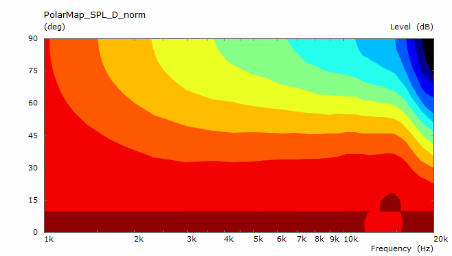

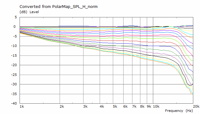

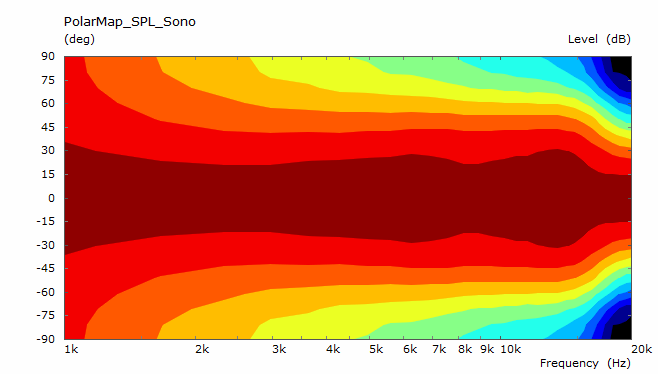

I was successful in avoiding too strong waist-banding effects. If the diagonal graph can be taken as an indication for sum of vertical and horizontal performance, this is not bad. Horizontal and vertical ripples kind of blend there:
![h.png h.png](https://www.diyaudio.com/community/data/attachments/917/917383-b7ba756ef604e94ae9fc252393e3696d.jpg)
![v.png v.png](https://www.diyaudio.com/community/data/attachments/917/917387-ca0cfa34c200b01b8c09a0ae7d78edc8.jpg)
![d.png d.png](https://www.diyaudio.com/community/data/attachments/917/917388-09320414c197a284e26e0d1df9d17df0.jpg)
![sono.png sono.png](https://www.diyaudio.com/community/data/attachments/917/917396-2f65b814492a524090512022532583e2.jpg)

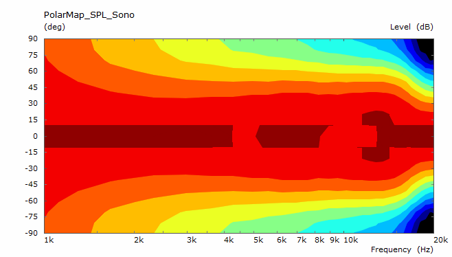

But there is trouble on-axis. It is on-axis that suffered most from cutting back on termination. This directivity is +-50 deg horizontal, +-40 vertical and quite extended. Shifting the scale a bit shows what is going on between 1-2 dB from normalized, not too pretty:
![h_axis.png h_axis.png](https://www.diyaudio.com/community/data/attachments/917/917389-9845a93709ce5605a63881133fabc8fe.jpg)
![sono_axis.png sono_axis.png](https://www.diyaudio.com/community/data/attachments/917/917390-5b15b74c8d59f2d52cdc71d4db325d02.jpg)

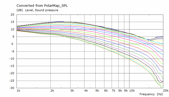

Visible also in the SPL plots, normalized and not normalized, that close axial behaviour is suffering most:
![spl h.png spl h.png](https://www.diyaudio.com/community/data/attachments/917/917391-e3f13e2dd3d90590c0a495a1edbb2826.jpg)
![spl v.png spl v.png](https://www.diyaudio.com/community/data/attachments/917/917392-1f2632f882037450a60925bb68034161.jpg)
![spl d.png spl d.png](https://www.diyaudio.com/community/data/attachments/917/917393-3a3b56a22cf3d0365b5697a68a9eabb3.jpg)
![spl.png spl.png](https://www.diyaudio.com/community/data/attachments/917/917394-dbbdfe7e17bfac20d2df9065a30471cc.jpg)
![waveguide.png waveguide.png](https://www.diyaudio.com/community/data/attachments/917/917395-c8ca443ab789b048d8e492a4cd558664.jpg)
Code:
Throat.Angle = 10.08
Throat.Diameter = 25.4
Throat.Profile = 1
Coverage.Angle = 45 -9*sin(p)^2
Length = 79
Term.s = 1.3 -0.55*sin(p)^2
Term.n = 3.2 +0.55*sin(p)^2
OS.k = 0.42 +0.02*sin(p)^2
Term.q = 0.94 +0.042*sin(p)^2
1 dB of ripple on axis after equalizing to the normalization axis is hardly "trouble".But there is trouble on-axis. It is on-axis that suffered most from cutting back on termination.
Why do you think not?nope

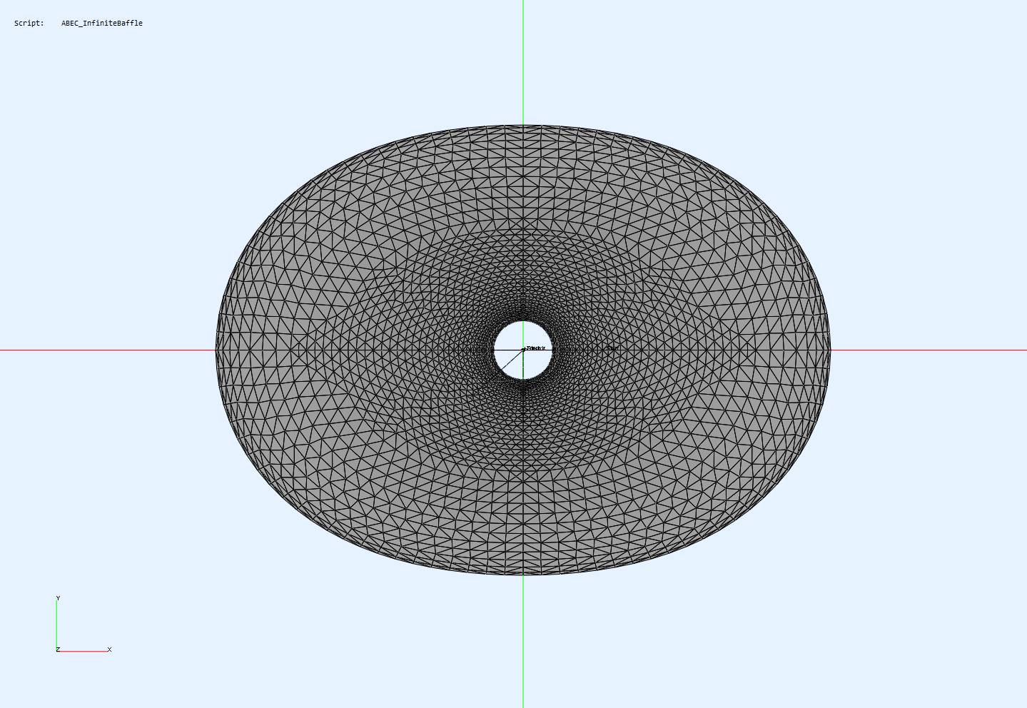

Ath itself cannot generate a waveguide directly with a rectangular source in it's current form. That is what he is referring to.Why do you think not?
Certainly a waveguide for a ribbon or planar driver can be designed with the aid of ABEC/AKABAK as you describe.

Ah ok. Can it only do circular throats, or are ellipses possible for asymmetric devices? I suppose you could just use a larger ellipsoid throat diameter to ‘start’ the waveguide further along the profile, and add an adapter section to transition to the rectangular throat?Ath itself cannot generate a waveguide directly with a rectangular source in it's current form. That is what he is referring to.

Circular only. The profile of an axisymmetric guide can be exported with the grid options and that can be used as a guide rail between two rectangles to form a loft or any other way of doing it in CAD, but it is then more effort to generate a good mesh and interface etc. and that requires more knowledge of what goes on under the hood, instead of Ath outputting a project ready baked from the ovenAh ok. Can it only do circular throats, or are ellipses possible for asymmetric devices?

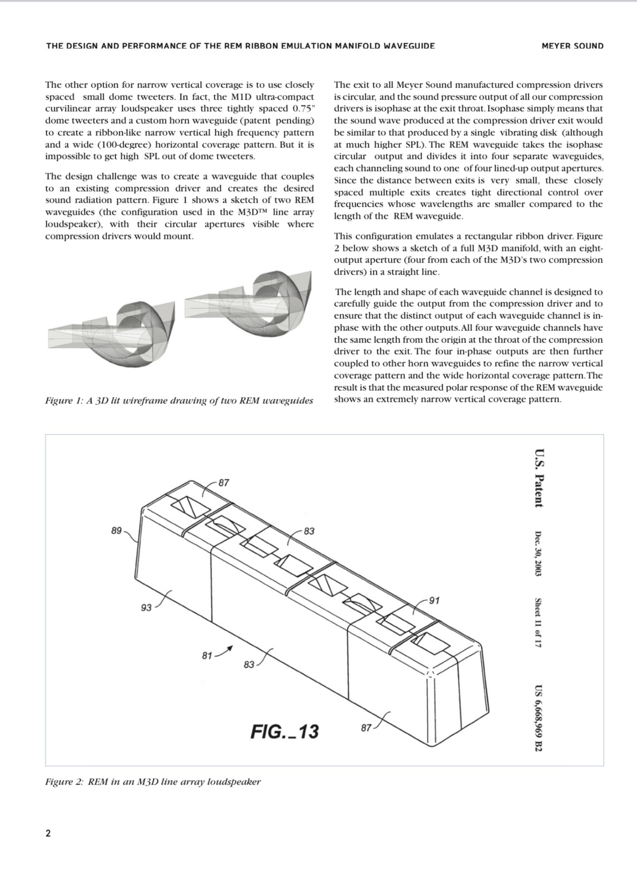

Meyer Sound came up with a “ribbon emulation manifold” to convert a circular source into a rectangular one (see attached). I can’t see why one couldn’t do something similar in reverse, perhaps even combining it with Marcel’s ESP device which would ultimately convert a rectangular source into a spherical one.
You also have a patent for an electrostatic speaker wave guiding device for a cylindrical output by Beveridge from 1969, which the Alcons patent cited as prior art. This one might look a little familiar

The Alcons variant is much more simple (not an axisymmetric device):
Patent is here, goodies in the PDF https://patents.google.com/patent/WO2019043210A1/en

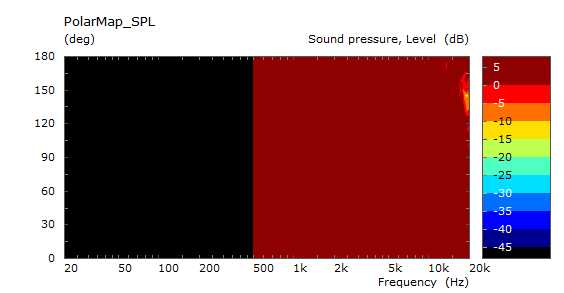

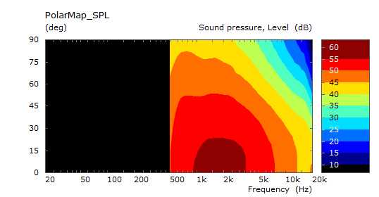

Accordingly, I added a data drive and moved the ath-4.8.0 folder to the root of the drive, which resolved the problem with inability to open the script file.
Regretfully, this did not solve the problem with the SPL spectra, which is the same as the figure in post # 9,053. furthermore, the your report:
is different from the one produced by running your script on on my Ath installation:
In desperation, I re-read the manual, and found the following text: "When setting polar maps, always remember to set the offset properly, especially for infinite baffles." So I re-run the script with added:
- not present in your script - since the length of the wave-guide is reported as 92 mm, which does result in a different SPL map:
I am infinitely baffled.
Again, any help would be appreciated.
Kindest regards,
M

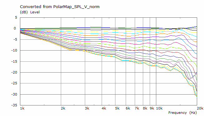

M,
if you managed to have the above graph in VCAS presented to you by changing the offset, compared to the indifferent pressure map before, then this was your problem. The offset value ought to be larger than the length of the waveguide. This is a perfectly fine output of a non-normalized pressure map, usually this is the entry:
By clicking on 'Graph' in the top menu and selecting the entry "Convert curves <-> contour", you can get a representation of what the waveguide is actually doing driven by an ideal source. For a normalized output, add with another subset:
For example:
If your device is not axisymmetric, you may need to add two more for vertical and diagonal performance:
Best,
M

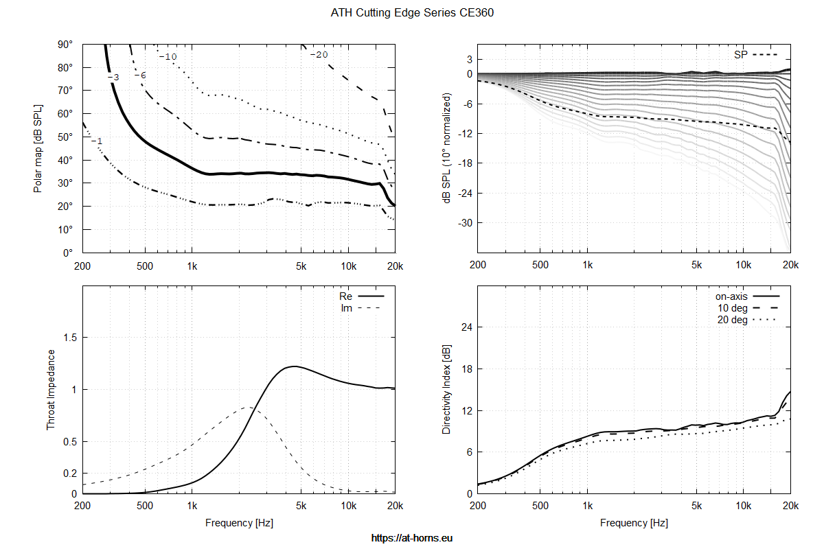

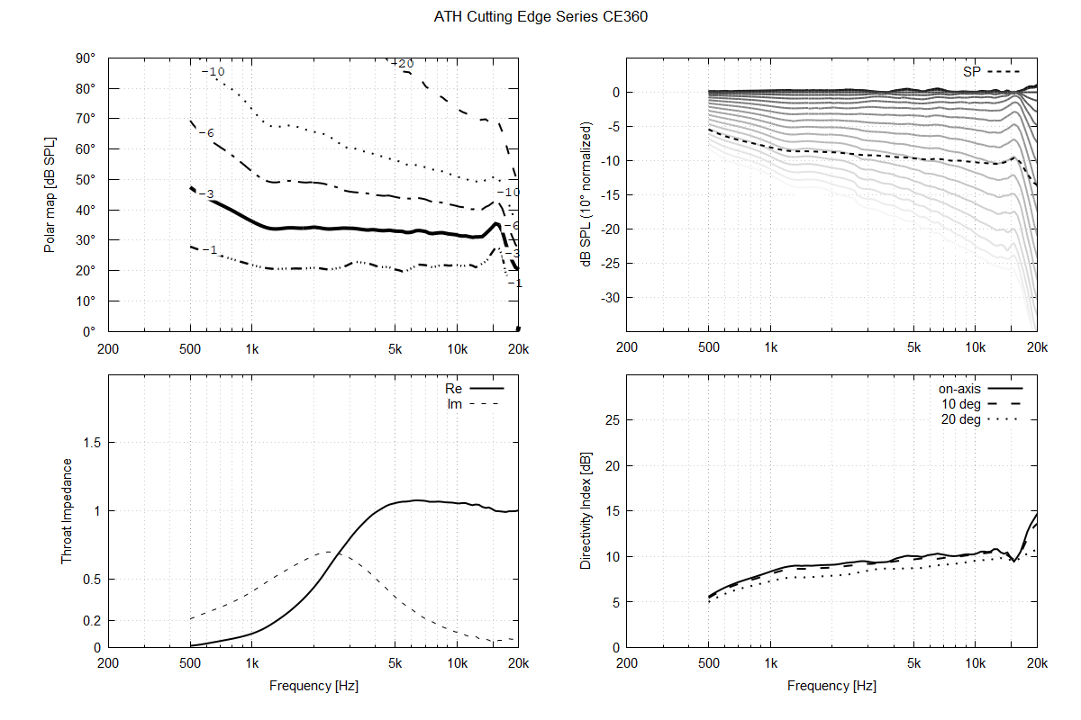

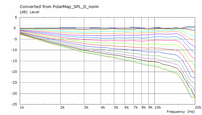

Hi sheeple,
I was able to resolve the ABEC SPL plot issue; thank you again for your help.
However, I still cannot match Marcel's published results. The two significant differences are (i) the bigger change in DI about 14-16 kHz and (ii) the throat impedance.
I wonder whether Marcel further changed the configuration vis-a-vis the published one, or whether there is regression in the code between Ath-4.7.1 referenced by Marcel's script and Ath-4.8.0. Regardless, I am rather satisfied with my progress.
