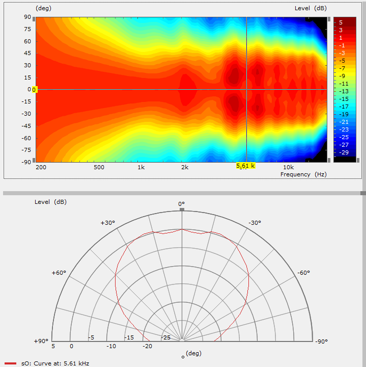

[...] My interest is more of a curiosity. I have been trying to understand how does Dr. Geddes obtain such a nice response of his Summa. Thus, I started with modelling the OS profile without the end correction (just to familiarize myself with your program), and the OS profile by itself looks rather bad. So I wondered how I could add a circle tangential to the OS that I understand Dr. Geddes uses/ed for the end correction.

It depends on a point of view. As you argued, not for you. But, I am curious how the simple tangential circle improves the non-terminated OS profile which in my simulation shows ripples and waist-banding, to the nice measurement of Summa shown by Dr. Geddes.
Furthermore, I would like to assure myself, that I am using Ath correctly, given my inability to replicate posted solutions, see my reply to bmc0.
Hi bmc0,
I have seen your post, but, I do not seem to be able to replicate it. Please see the attached figure, in which I tried to set the graphs to the ranges shown in your simulation. Could you please look at the attached configuration file; perhaps I am missing some settings?

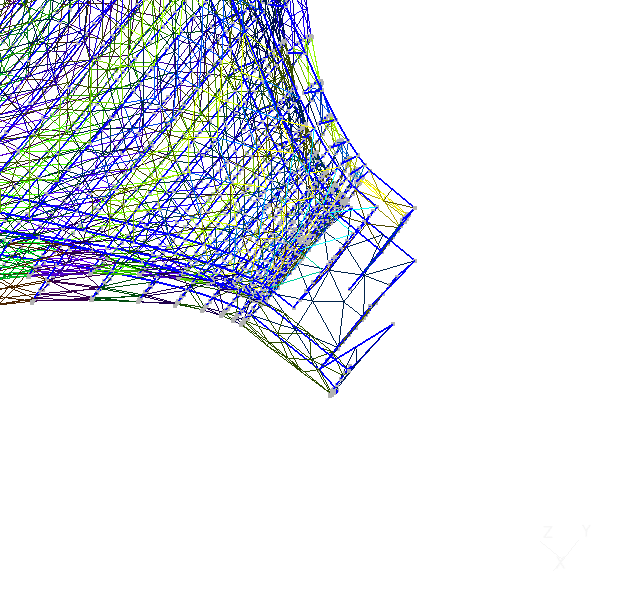

I'm very new to speakers, but I try to read & learn everything the forum members (yes I'm talking about you @fluid 🙂 ) point me to. On that journey I found ath. I've downloaded it (4.8.0) and am working my way through the examples. Very nice and simple way to start fiddling, only that one missing ';' for akabak toke some time.
But now I found something strange. In a first test to use a free standing horn, the outer layer does not connect nicely at the back of the horn.
What am I doing wrong?
Edit: I tried to attach both the .cfg and .geo file, but somehow they got lost...

Here we go:
Code:
Throat.Profile = 1 ; 1 = OS-SE waveguide
Throat.Diameter = 25.4 ; [mm]
Throat.Angle = 7 ; half the included angle [deg]
Coverage.Angle = 45-10*sin(p)^2 ; demo2.cfg
Length = 94 ; [mm]
Term.s = 0.5
Term.n = 4.0
Term.q = 0.996
Morph.TargetShape = 1 ; rounded rectangle
Morph.FixedPart = 0.0 ; start at throat
Morph.Rate = 3
Morph.CornerRadius = 12 ; [mm]
Mesh.CornerSegments = 4 ; number of profiles reserved for cornersMesh.AngularSegments = 64
Mesh.LengthSegments = 20
Mesh.ThroatResolution = 4.0 ; [mm]
Mesh.InterfaceResolution = 8.0 ; [mm]
Mesh.InterfaceOffset = 5.0 ; [mm]
Mesh.Quadrants = 1234 ; al 5 quadrants
Output.STL = 1
Output.ABECProject = 1
ABEC.SimType = 2 ; 1 = infinite baffle
Mesh.RearShape = 1 ; fully modeled
Mesh.RearResolution = 10.0 ; [mm]
Mesh.WallThickness = 5.0 ; [mm]
ABEC.f1 = 1000 ; [Hz]
ABEC.f2 = 10000 ; [Hz]
ABEC.NumFrequencies = 20
ABEC.MeshFrequency = 1000 ; [Hz]
ABEC.Polars:SPL = {
   MapAngleRange = -90,90,19 ; first angle, last angle, number of points
   NormAngle = 20 ; normalization angle [deg]
   Distance = 3 ; [m]
   Offset = 95 ; [mm]
