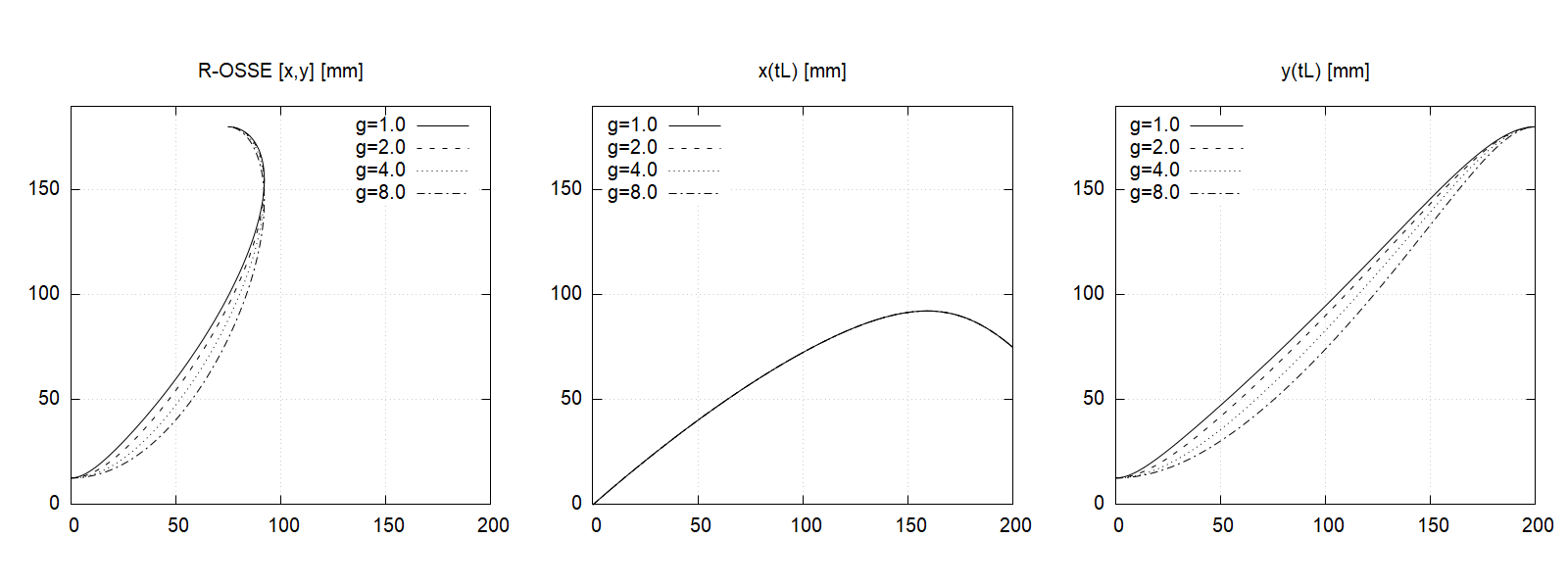

Oops, I forgot to re-normalize the parameters - here it's correct + the core of a gnuplot code.
Code:
k1 = r0*r0
k2 = 2*r0*tan(a0)
k3 = (R*R - k1 - k2*L)/(L*L)
x0 = sqrt(r*r + (s*m*L)**2)
y1(l) = R + u - sqrt(u*u + k3*(l-L)**2)
y2(l) = sqrt(k1 + k2*l + k3*l*l)
w(t) = t**q
x(t) = x0 - sqrt(r*r + (s*L*(t-m))**2) - b*(t*L)**2
y(t) = w(t)*y1(t*L) + (1-w(t))*y2(t*L)
set parametric
set trange [0:1]
set samples 100
plot x(t),y(t)

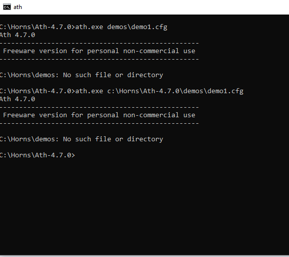

Did you try the User Guide?please guide me.
Ath doesn't have a gui. The documentation (https://at-horns.eu/release/ath-4.8.0.pdf) was enough for me to get started.
tried with the config file as :Did you try the User Guide?
OutputRootDir = "C:\Horns"
MeshCmd = "C:\Horns\gmsh-4.9.3\gmsh-4.9.3-Windows64\gmsh.exe %f -"
GnuplotPath = "C:\Horns\gnuplot\bin\gnuplot"
and even after adding those lines in the config the same problem when I click the ath.exe file also tried to create a shortcut and referenced the ath.exe same problem.
what else to be done?
Start with the help guide and some of the examples. You are missing the Horn Length parameter.
To run it as expected, type e.g.: ath demos\demo1.cfg
Your both commands shown were wrong (passing a wrong file as the parameter).

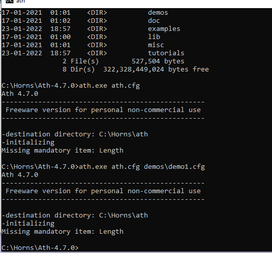

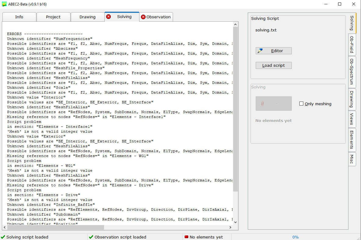

I`m getting this. In cfg file the path is mentioned as above also have tried complete demo1.cfg file path
how do we see list of parameters that has to be entered.Start with the help guide and some of the examples. You are missing the Horn Length parameter.
ABEC2-Beta?? Please use the latest available ABEC3:
http://www.randteam.de/_Software/ABEC3_Pro/Download-ABEC-Pro.html(You can still use the professional version the same way as a demo - it just won't save data without a licence key).
Please don't turn this thread into a personal help desk and try on your own for a while now.
The User Guide should really help you for the start: http://www.at-horns.eu/release/ath-4.8.0.pdf#page=32

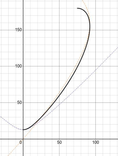

R-OSSE - I've added the expansion factor of the OS-SE formula (it's 'g' here) - https://www.desmos.com/calculator/sy9pwilogj
Integrated version with a single parametric plot of the whole profile:Desmos plots:
x(t) - https://www.desmos.com/calculator/uxifyrlqkx
y(t) - https://www.desmos.com/calculator/pa21fyklga
(x(t),y(t)) - https://www.desmos.com/calculator/prmltiav0g
EDIT: updated version
