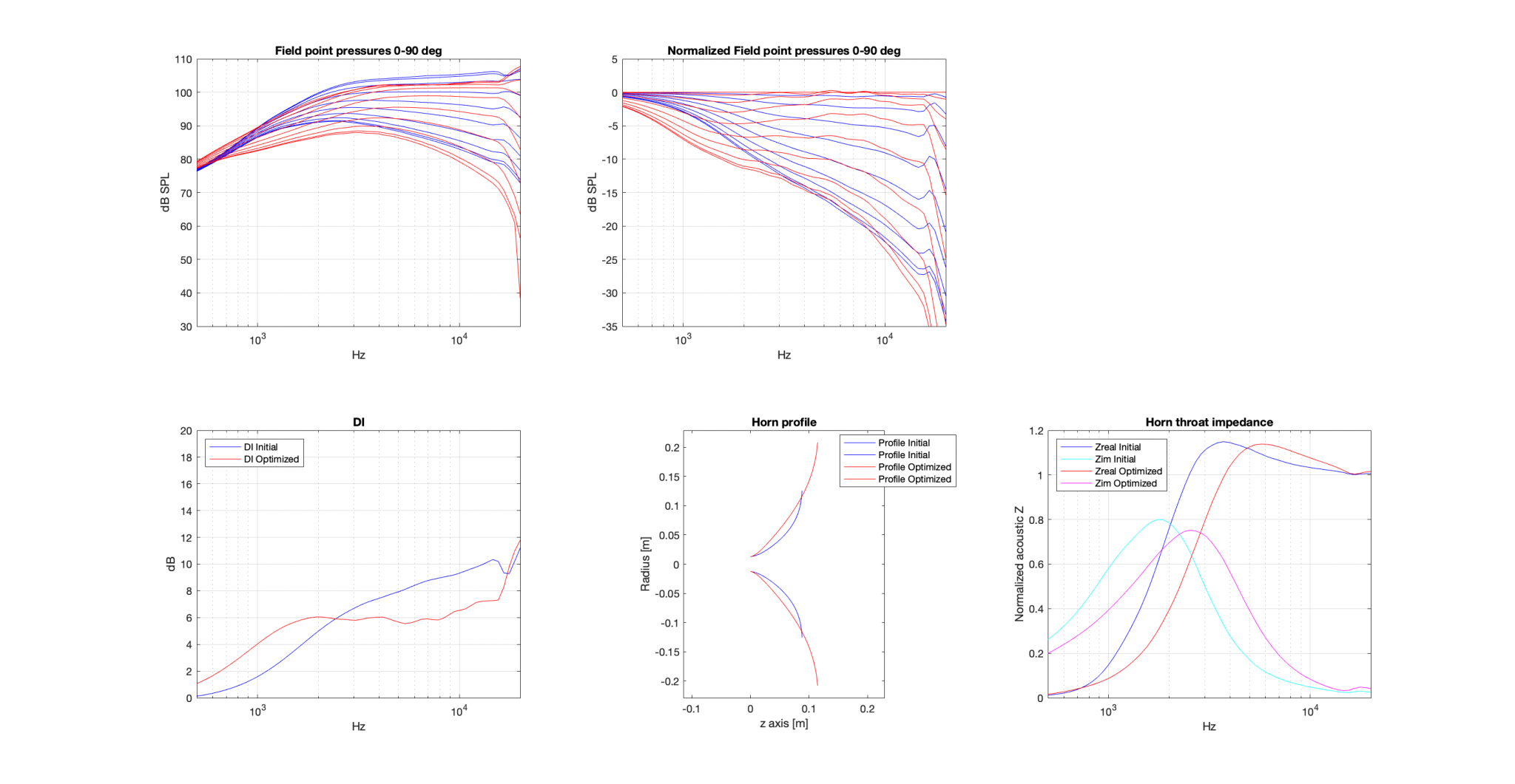

Here is a proof of concept, nothing else just to check if it is working
MMM_toolbox 1.1 with @Tom Kamphuys OSSE function
for reference:
MacBook Pro 2015 i7 4 cores @2.5Ghz
5vars 10angles
16modes generations: 50 population: 30
11.5min
24modes generations: 50 population: 30
19min
32modes generations: 50 population: 30
30min
Literally the first output with simply trying to fit a DI of 6 1500-10000Hz
not a design just to try...

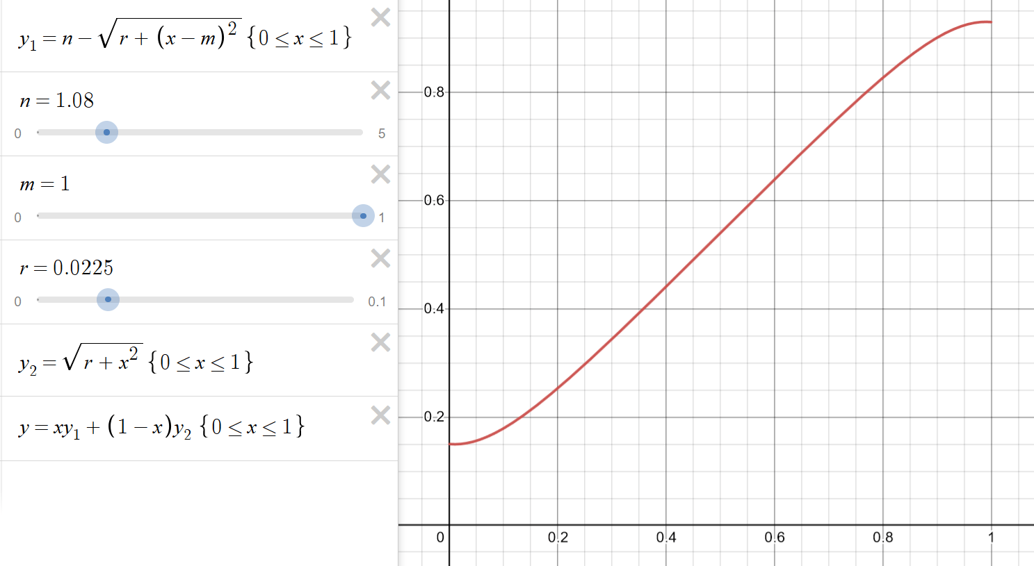

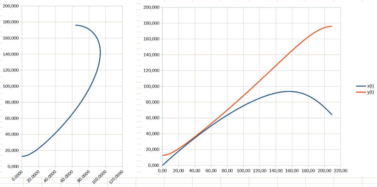

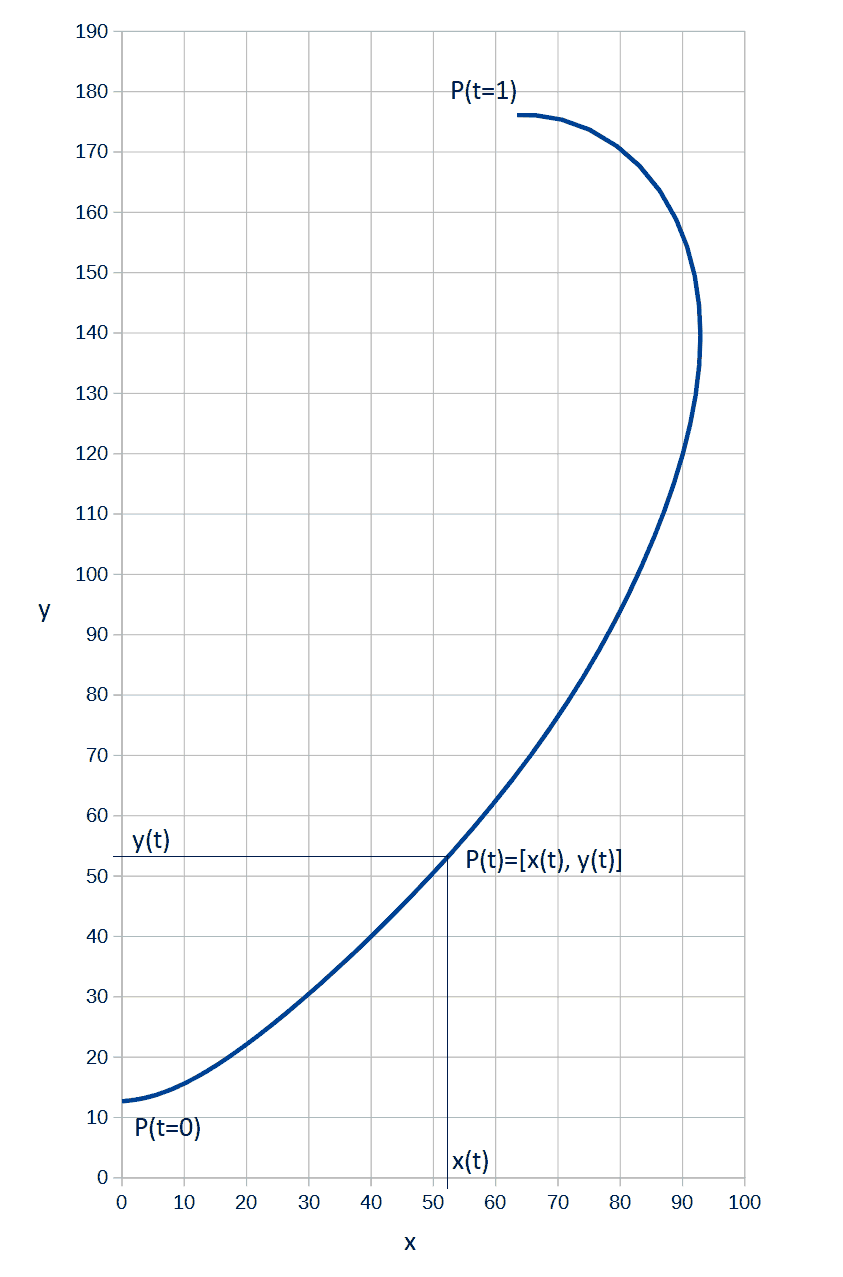

Yeah, this could be the basis for the red one (i.e. y(t)) -Looking at the picture #9,154, the red curve could be a blend (weighted average) between two hyperbolas...
If x(t) and y(t) are both OS, y(x) is not guaranteed to be OS I think. If x(t) and y(t) are the same, y(x) is a straight line. So I think one of the criteria is that e.g. x(t) starts as a line (2nd and higher derivatives zero). This makes y(x) behaviour only depend on y(t) (apart from some scaling/stretching). Maybe force the first derivative of x(t) to be 1 to truly depend on y(t) alone?

We have some more relations between design parameters and the x(t) and y(t) variables:
x(0) = 0
y(0) = radius at throat
y'(0) is determined by throat angle (given that x(t) can be approximated as x(t) = t for small t (see my previous post))
y(1) = radius horn
if you want the last part of the horn to be 'flat', the derivative of y(t) at t = 1 should be 0 and that of x(t) should be negative (or at least that is one way to achieve that).
You can determine the max length of the horn by finding the maximum of x(t) (use x'(t) =0). CurlBackDistance distance could also be a design parameter I guess.
Another approach might be to use y(t) = throatRadius + (mouthRadius - throatRadius)*t, so a simple linear function. The x(t) has to be an inverse-OS near the throat and curl back/down at before t = 1. At least y(t) is very simple, don't know about x(t).

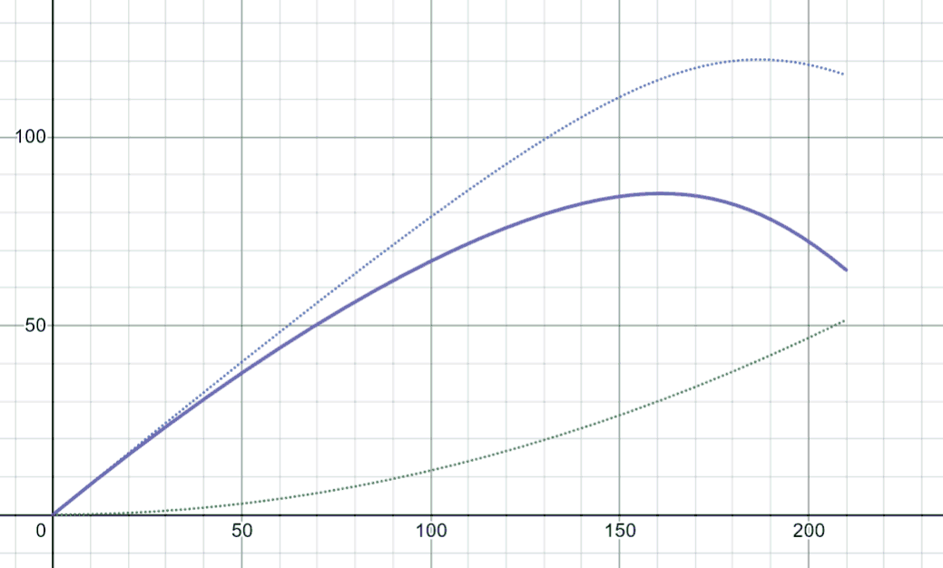

You are of course correct about all the properties - if x(t) approaches a linear function (x(t) ~ t), and it really does near the throat (see #9,168), then the contour is simply given by y(t) ~ y(x), which can be an OS (and it is near the throat, see #9,166). The rest of the overall contour it is just a smooth continuation, "blended" into a smooth roundover, and if anything is to be advantageous it should show in the optimizations, if someone actually takes the effort some day. We are basically preparing the mathematical foundation for that now - a general analytic description of a free-standing waveguide based on OS-SE.

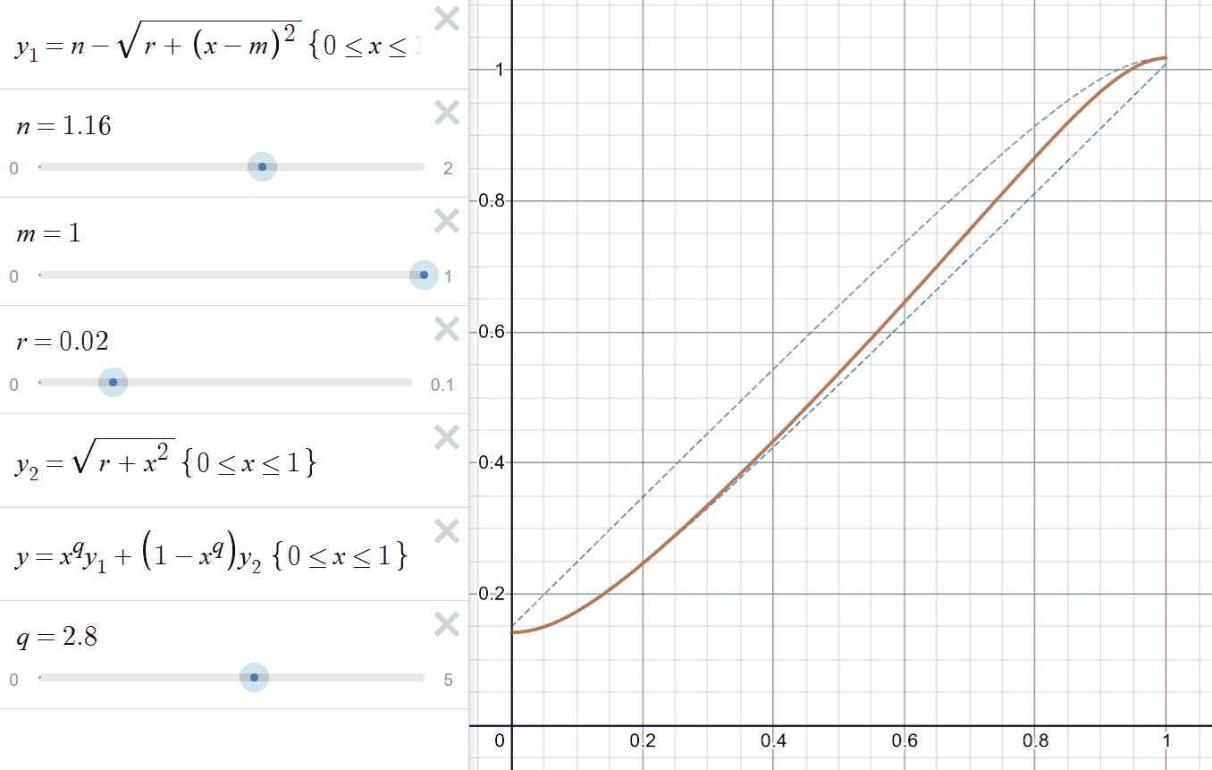

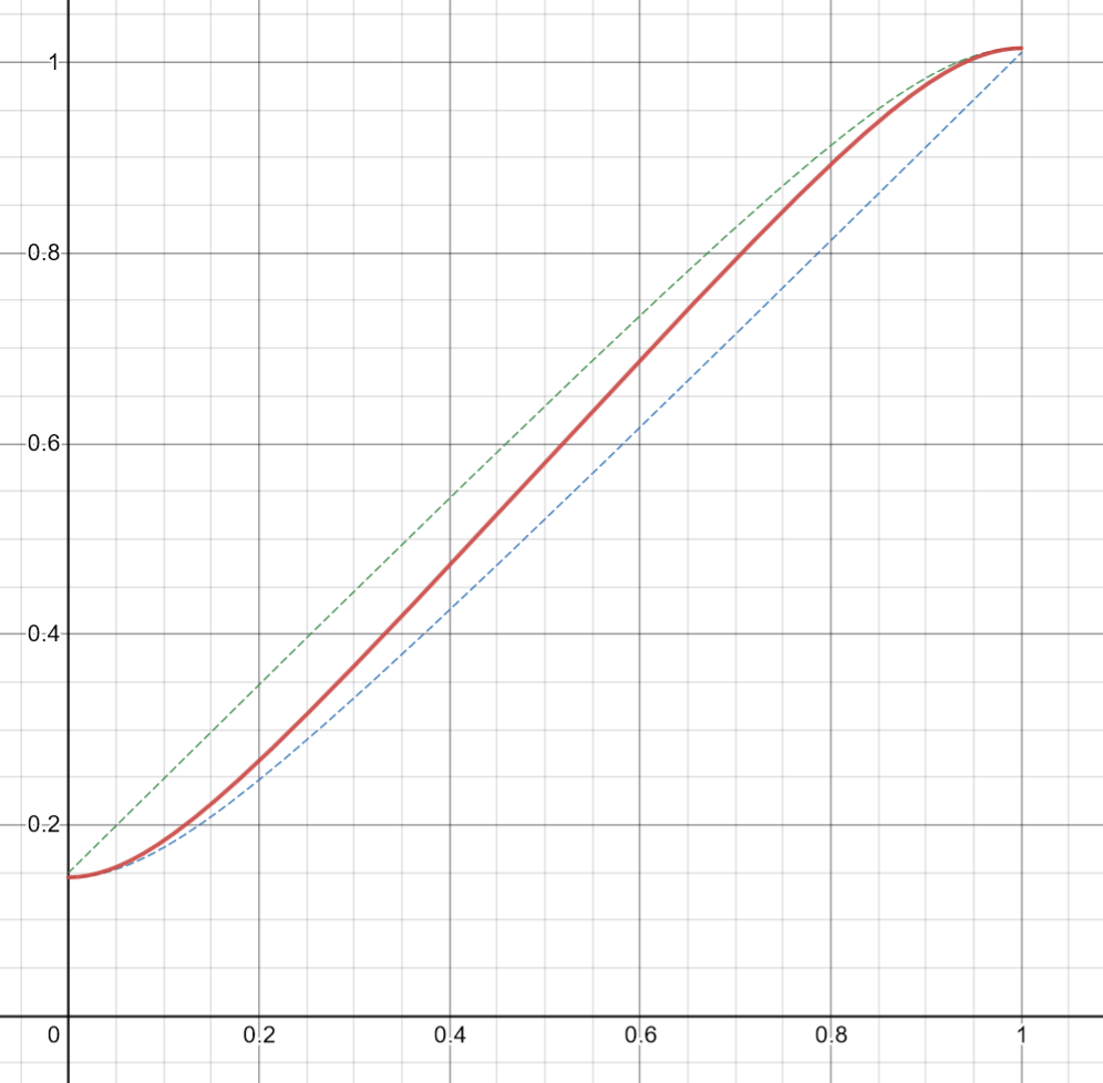

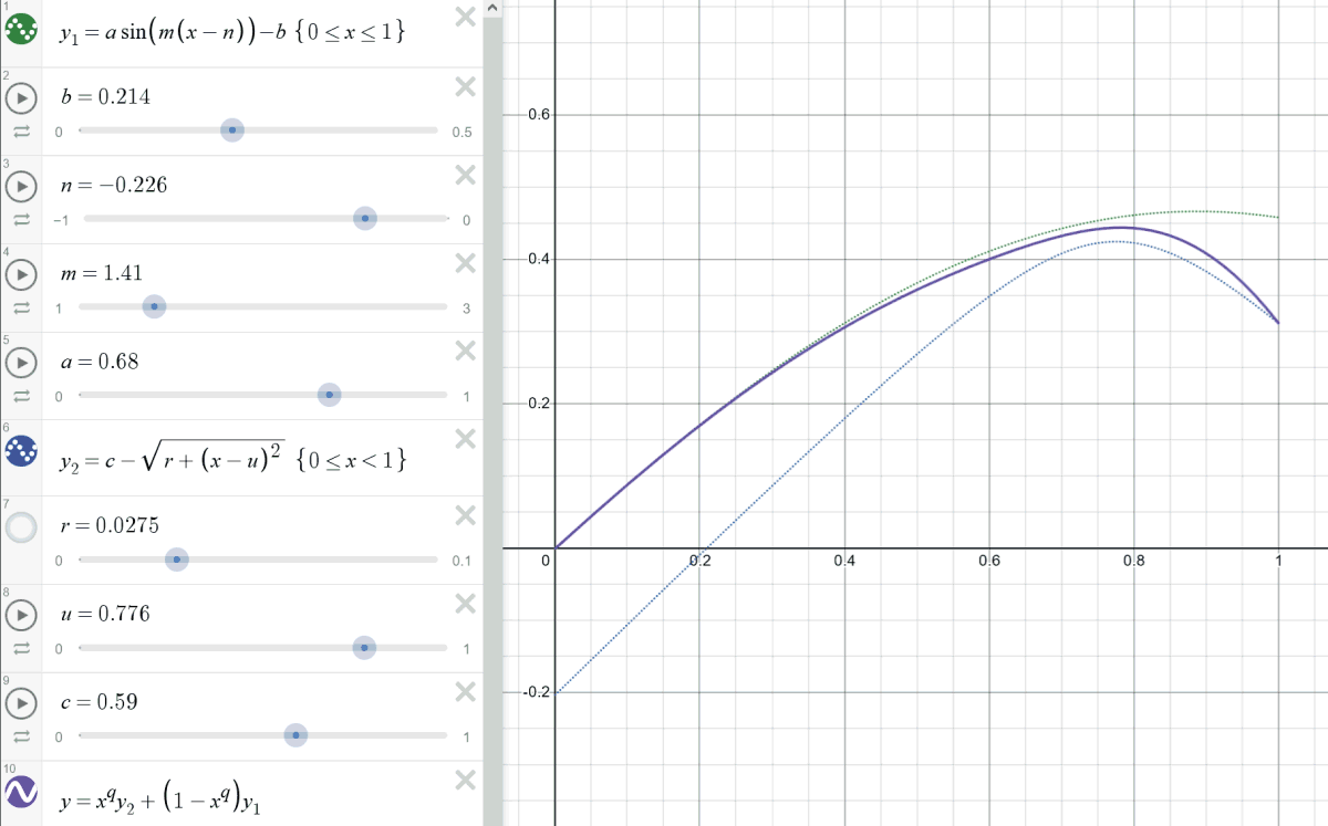

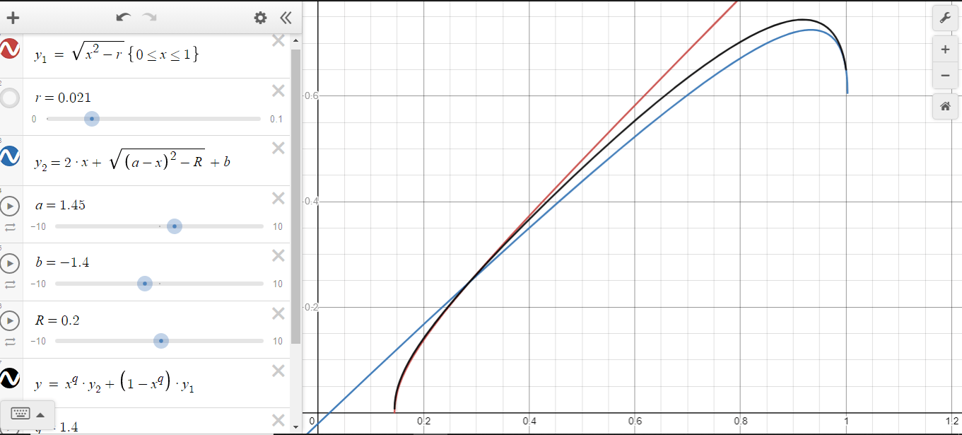

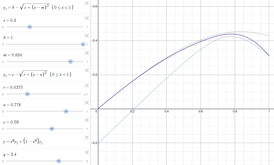

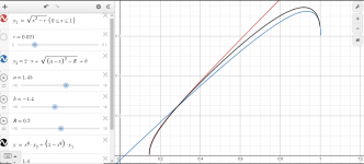

I've been playing with desmos and I like it. y(x) cannot be a function. x( y) can. And if you swap x and y, y(x) can be a function. Here is an example:
It has less parameters to care about or play with, which can be a good thing or a bad thing. Depends on your point of view I guess.
Are we free to pick any functions and we'll just have to simulate them in order to see if the horn perform well? Or are there rules of thumb that will cause a horn to perform well?
That's a very nice and simple approach. You never know how it will perform unless you try, that's all I can say...
What I did was trying to emulate the existing profile of the CE360 (with some additional degrees of freedom), which I know performs really well. This is different, but who knows, maybe it could be optimized much in the same way in the end.
I guess that to try this out at the moment, I'd have to implement this in Ath to test it via ABEC. Or is there anything else that someone can use?
