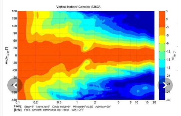

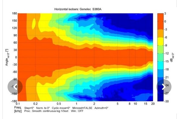

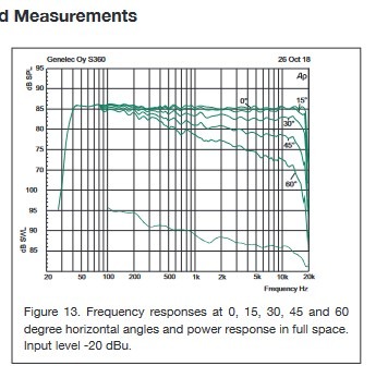

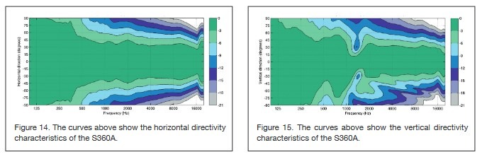

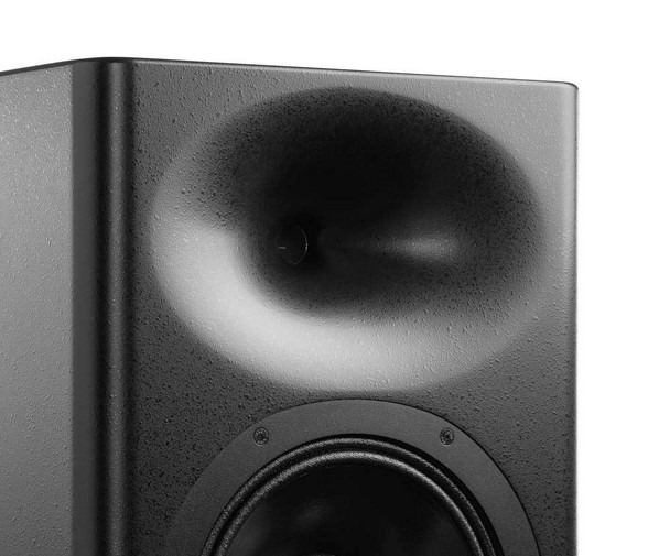

The measurements of Genelec S360A show some traces of directivity issues around crossover frequency (1.4k). Baffle width is 36 cm and possibly helps to control horizontal directivity below crossover. https://assets.ctfassets.net/4zjnzn...f97a850d048f599e9734f49748e676/S360_opman.pdf
Either the official measurements slightly underestimate the uneveness in crossover region, or it is the presentation, as other measurements by Sound & Recording's Anselm Goertz show it a bit more accentuated:
https://www.soundandrecording.de/equipment/genelec-s360a-high-spl-monitor-im-test/
However, the horizontal performance does look very very good in Genelec's data (and the speaker was lauded). Not only there, also S&R's data shows it is a higly capable speaker with a very well controlled pattern. This is a high performance two-way waveguide speaker like the much older M2:
They use an asymmetrical device that is baffle-based. And it is round, a opposed to JBL's rectangular approach:

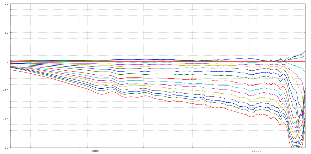

The answer is no at this point because the MMM code is limited to infinite baffle conditions.Recently, fluid was so kind and made the effort to do a limited simulation in a baffle with ABEC. I needed to see how the performance changes on on a baffle. Drastically so. This showed to me that it is rather useless to optimize a baffled waveguide without regard to the diffraction effects generated by the box itself. Its impacts are too severe. Is it possible to do it with your new "API"
What you saw with your waveguide is the reason why I say that is quite a significant practical limitation if the idea is to optimize a final result. I don't say that to be obstructive but just to point out what I found myself and how difficult it was to use an infinite baffle simulation to optimize to a free space condition.
I thought your waveguide was pretty good in a baffle for what it was and if you put some smoothing, change the resolution and add some lines I think it stacks up OK next to the Genelec.

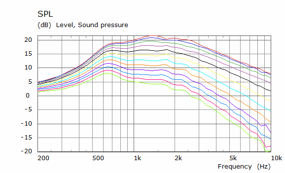

Don't forget that simulating a full 3D mesh never gives as smooth a result as an infinite baffle or circsym does, due to mesh frequency and other boundary differences.
This is a freestanding guide simulated as a 3D mesh, the circsym version has zero ripple
There is a bit of juggling to get the waveguide and enclosure working together and not against each other but it can be done. This is best I came up with and I see no reason why this would not measure very much the same if I built it.
If smoothness of polar response is the parameter being targeted a baffled or freestanding waveguide made with Ath seems to be able to deliver.
The baffle and enclosure can help to control directivity to a lower frequency than the freestanding guide but getting the right dimensions to make them work together may or may not be found on the first try.
The freestanding guide controls directivity really well in a smaller overall size and seems to be more immune from external influence both in simulation and measurement.

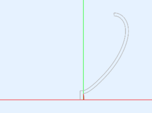

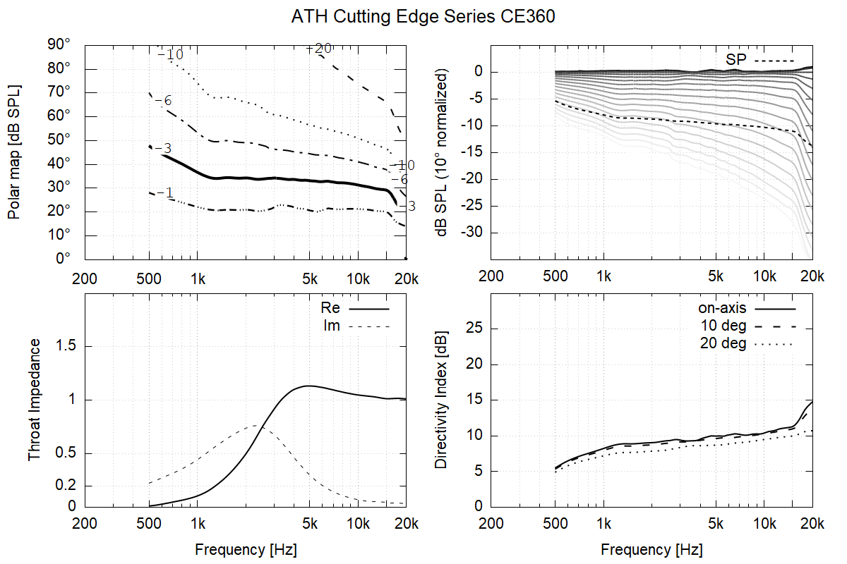

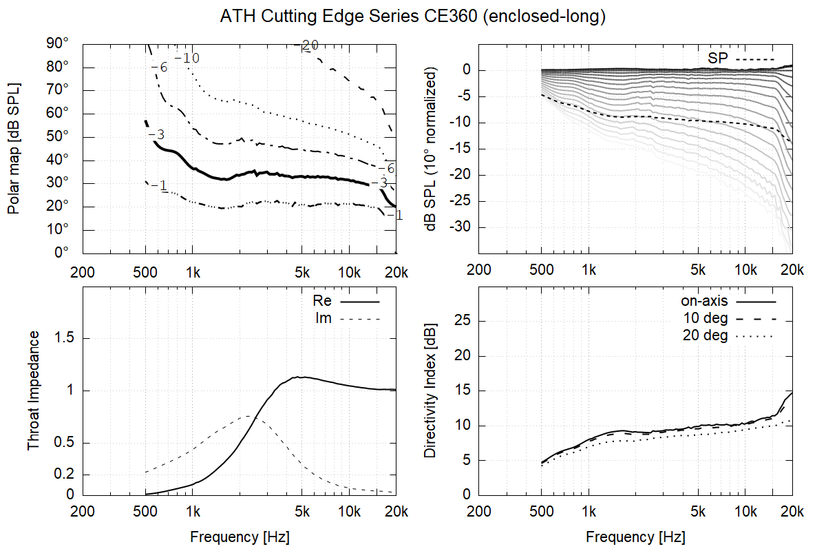

Because I needed that...I don't see why you need Ath in the loop in the first place. For an infinite baffle simulation you can generate the waveguide contour directly in Matlab as the formula is readily available.
It was the first step to control Ath from Matlab in order to replace the Matlab MMM_toolbox solver by ABEC:
Matlab for Genetic algorithm, Ath to generate the profile and ABEC project, ABEC Demo to solve and finally import the results back into Matlab.
No more IB limitations.
Now it's all done, oddly it was not as painful as I had imagined. @Matbat and the R&D team are legends.
I still need to make sure everything is fine and see if I can leverage the Ath report function as a bonus instead of rewriting the whole thing but it's looking good ATM.

Ah, OK, with Ath and ABEC in the loop, I can see what you are doing. With the MMM_toolbox it didn't make sense to me.
Be sure to disable all the unnecessary output in the Ath script. Then depending on the complexity and size of the model, you can get to some tens of seconds per iteration I think (for axial symmetry of course). Not great but already usable. As always, set only as high a number of calculated frequencies and mesh density as absolutely necessary for reliable results.
Now I'm about to implement the new R-OSSE formula. I'm quite curious how it performs compared to what I already have.
If you thought Ath could be further improved for a better external loop usage (including the reporting), let me know, I have no problem with that - I'd love to see that happening.

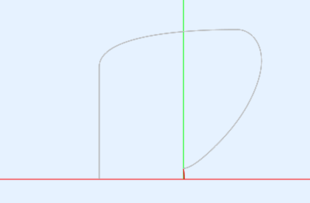

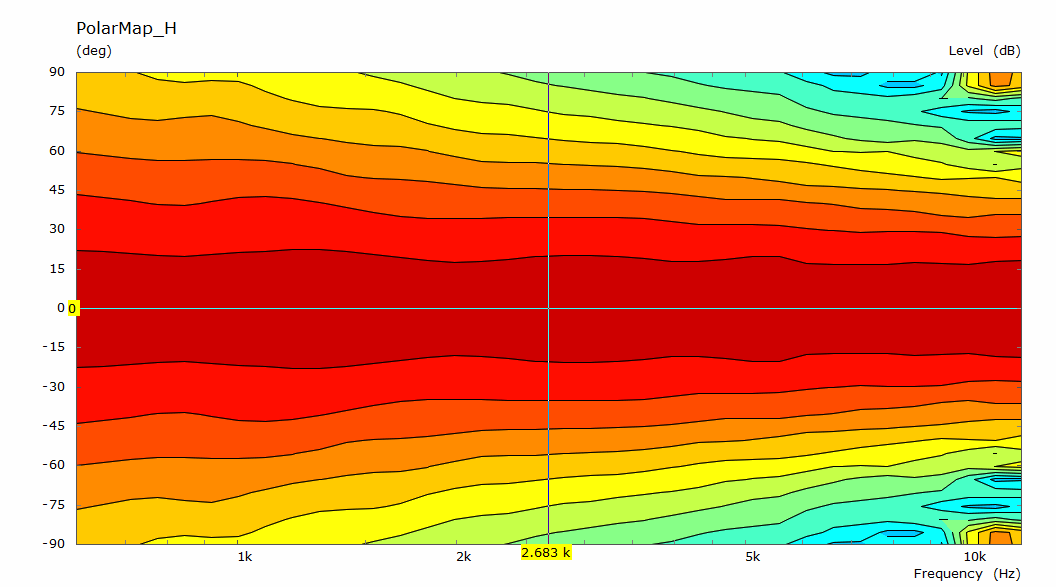

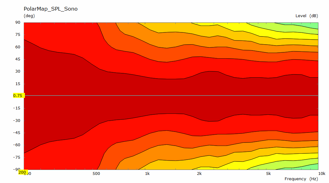

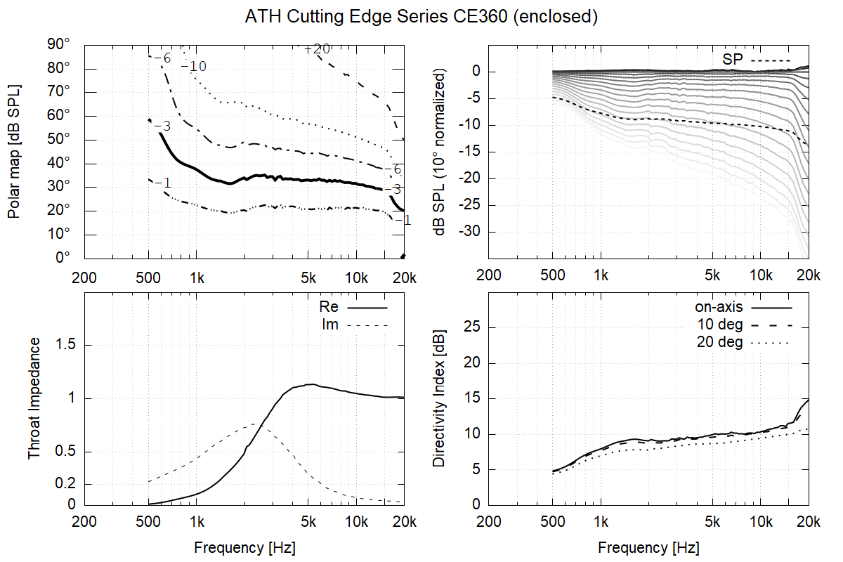

BTW, this is an effect of an enclosure I repeatedly observe in the data - it's not helping the lower-end directivity. All it does is that it's actually a bit less controlled, compared to a "bare" free-standing waveguide (the DI is actually a bit lower below 1k when enclosed). This is without any additional flat baffle around the mouth, just a rear-side "housing" (all axisymmetric).
The corresponding results:

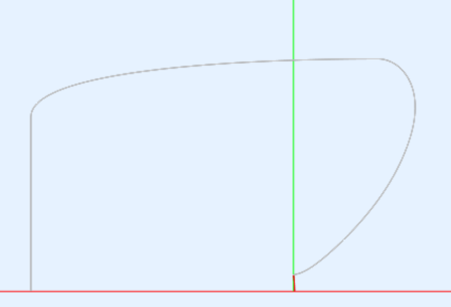

In that example you are right, the effect is seen at about 1.5K and it doesn't really help. The best curve for a baffle doesn't seem the same as one for free standing in my sims, getting the dimensions of the enclosure right to assist the waveguide is an important part of making use of it.BTW, this is an effect of an enclosure I repeatedly observe in the data - it's not helping the lower-end directivity.
I think you could use circsym like you did there to speed up finding the optimal result for a baffle, it certainly is a lot more effort the other way.
That's an interesting topic for sure. Have you already observed any hint of some "rules"?The best curve for a baffle doesn't seem the same as one for free standing in my sims, getting the dimensions of the enclosure right to assist the waveguide is an important part of making use of it.
What do you mean by saying "the best curve for a baffle"? What curve?
I have run enough simulations to see trends but not enough to formulate "rules". I don't think it would be too hard if the circym gave the same sort of result horizontally as a full 3D sim does. I will have to try that on some I have prepared earlier There is an interaction between baffle width and enclosure depth and some ratios do work better than others at different frequency ranges and depending on the directivity that is trying to be matched. For example shallower than width tends to make the directivity more supercardioid.That's an interesting topic for sure. Have you already observed any hint of some "rules"?
Edit: The width and depth combination is more of a consideration for the woofer than the waveguide but they all need to work together to get the best result.
The actual waveguide profile. A profile that works with a freestanding termination doesn't seem to work as optimally when made into a baffle, as one that transitions to the baffle and then away like in a baffle mounted one would. In your example above the freestanding curve became the roundover, this does not seem to work quite as well as it can.What do you mean by saying "the best curve for a baffle"? What curve?

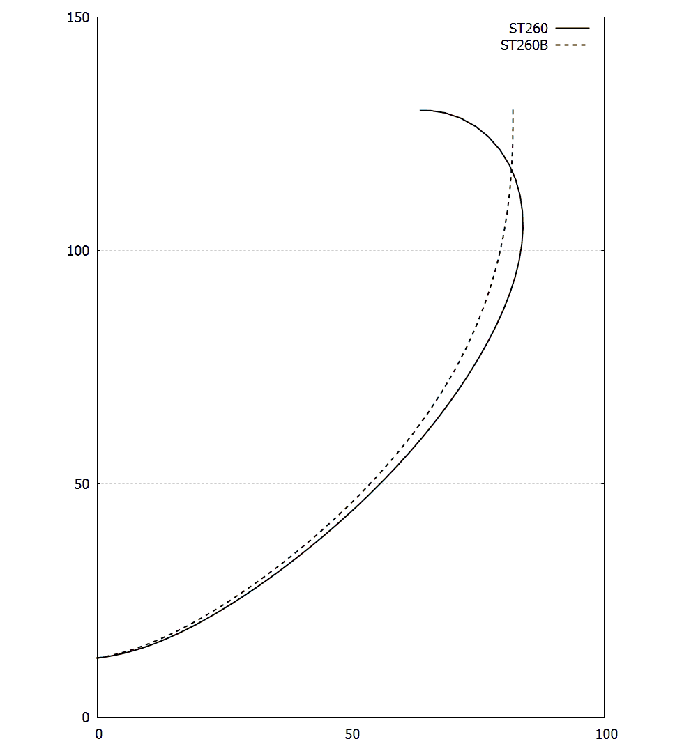

Edit: I think the ST260B was pretty good, from memory it was something like that I reverse engineered before you released it to get the response I showed above in #9246.
If anything, this shows how far easier it is to design a virtually flawless free-standing device, compared to this baffle hassle
ST260B (the baffled version) has a huge roundover for its size (see both profiles below), i.e. it will definitely take a wider baffle to behave as good as the free-standing version. Which is also something you mentioned I think. I'd be interested in a whole box simulation but I just don't have a reason to think it will work nearly as good.
