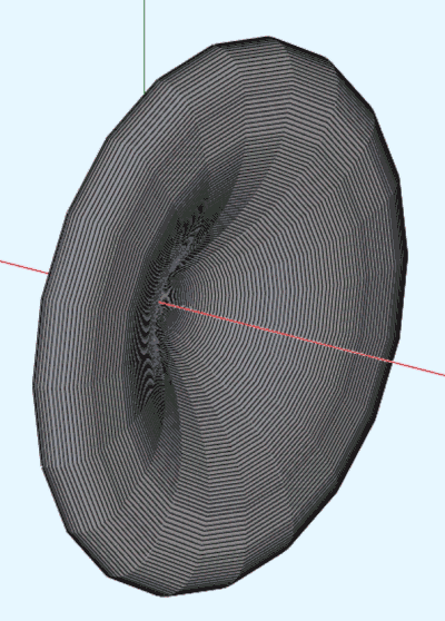

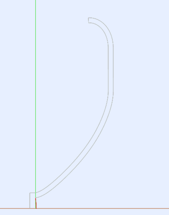

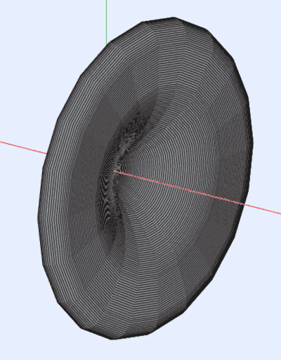

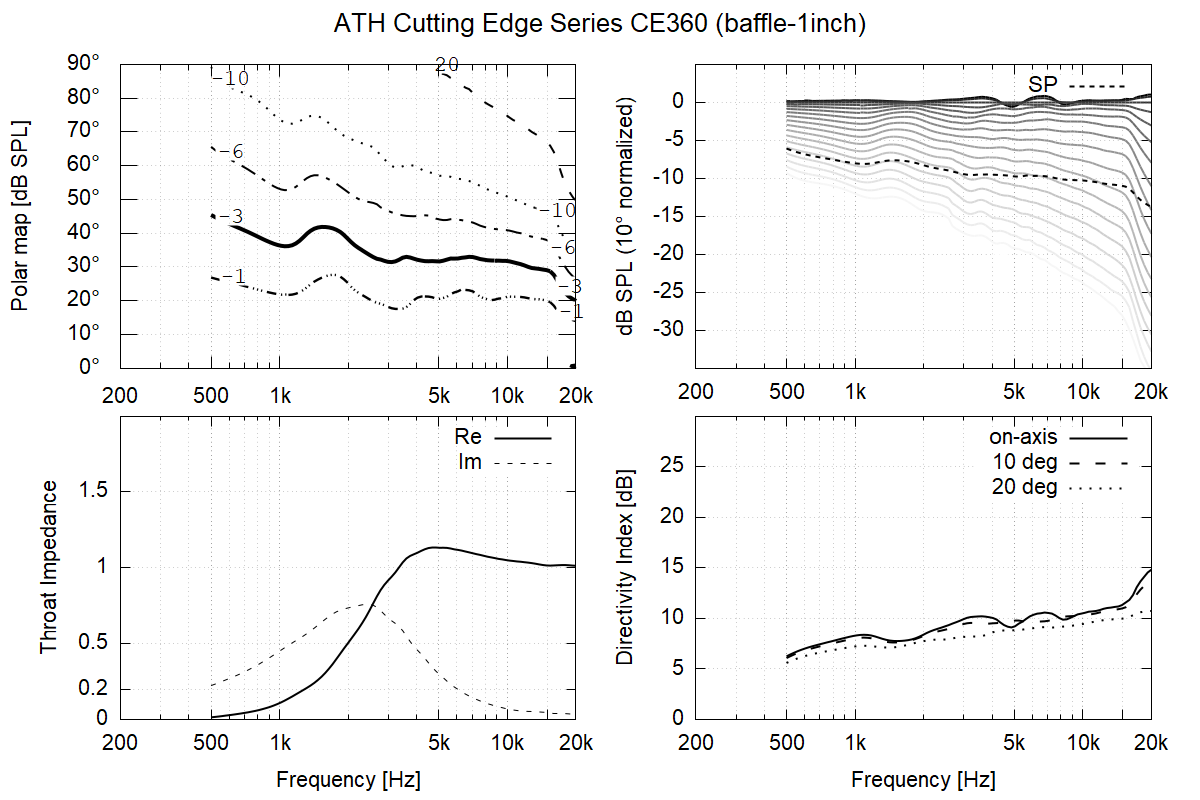

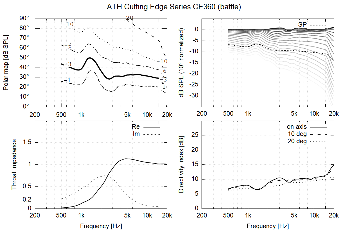

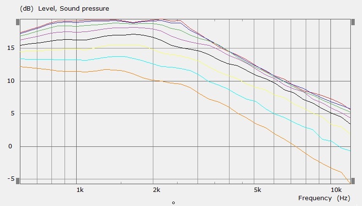

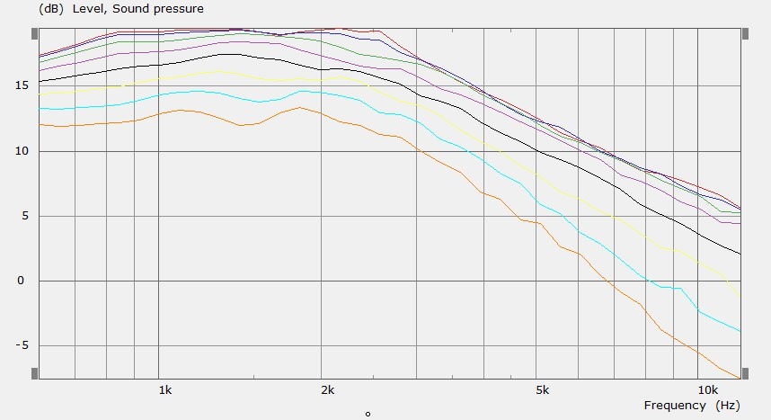

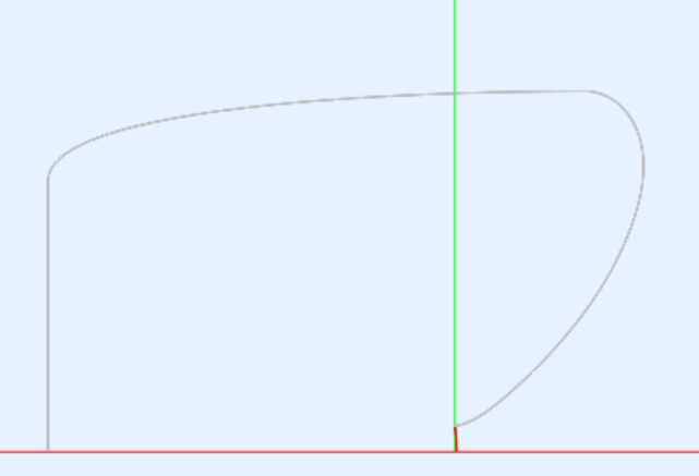

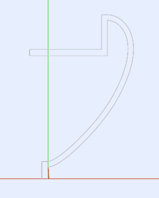

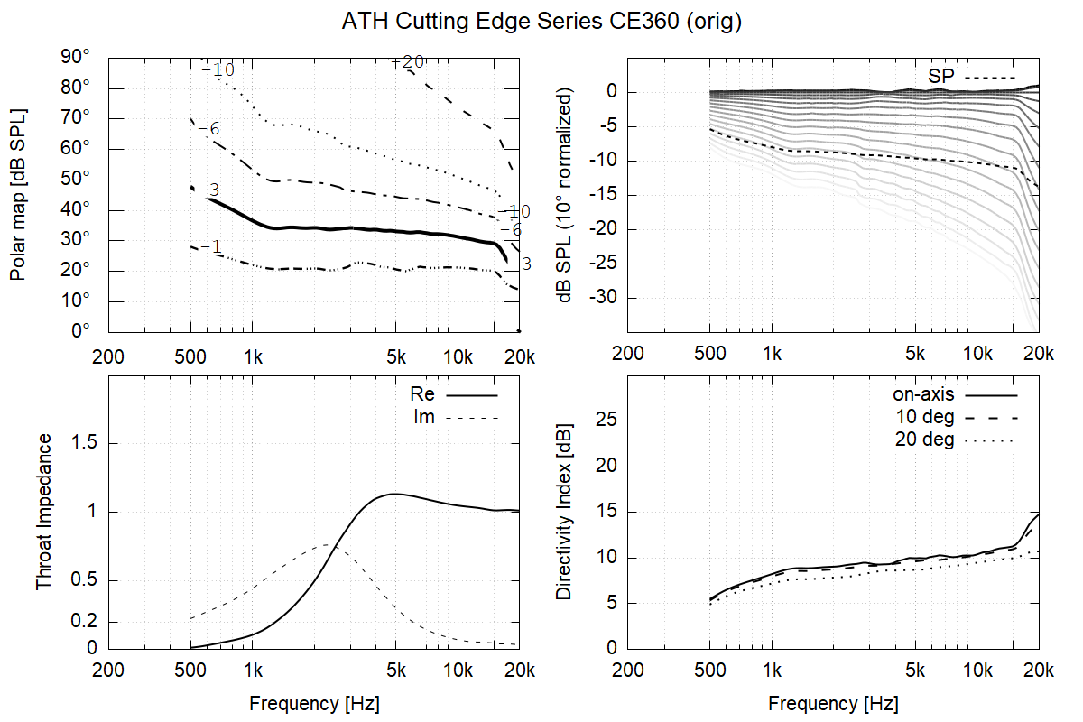

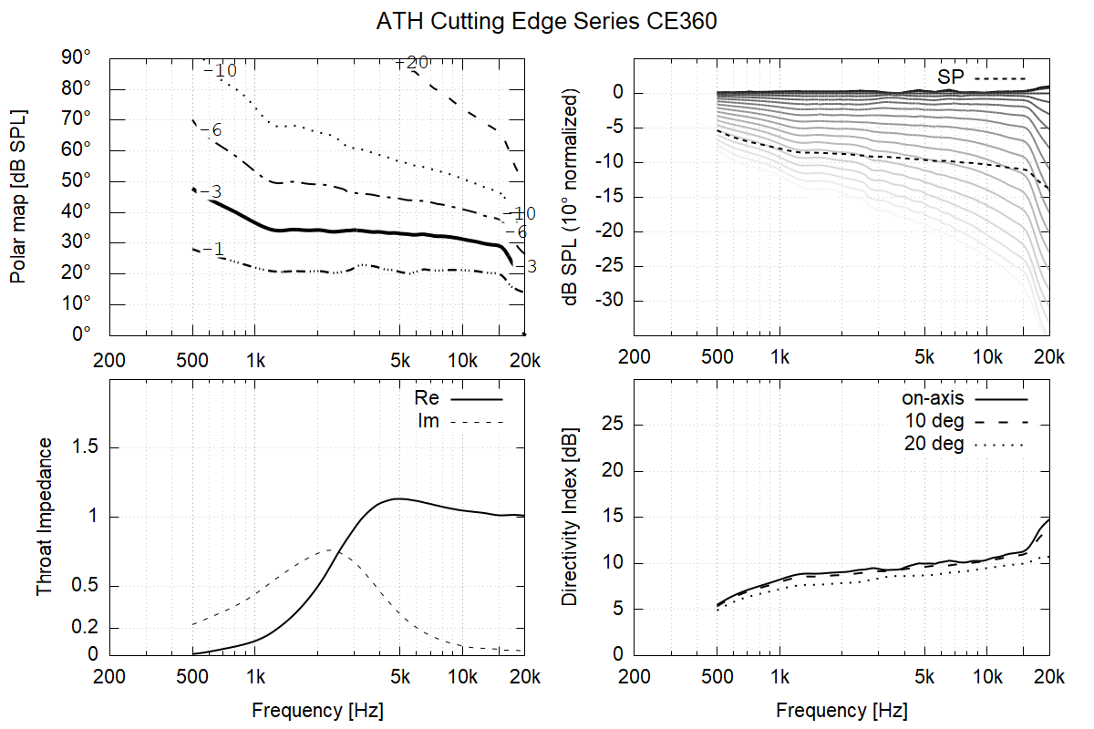

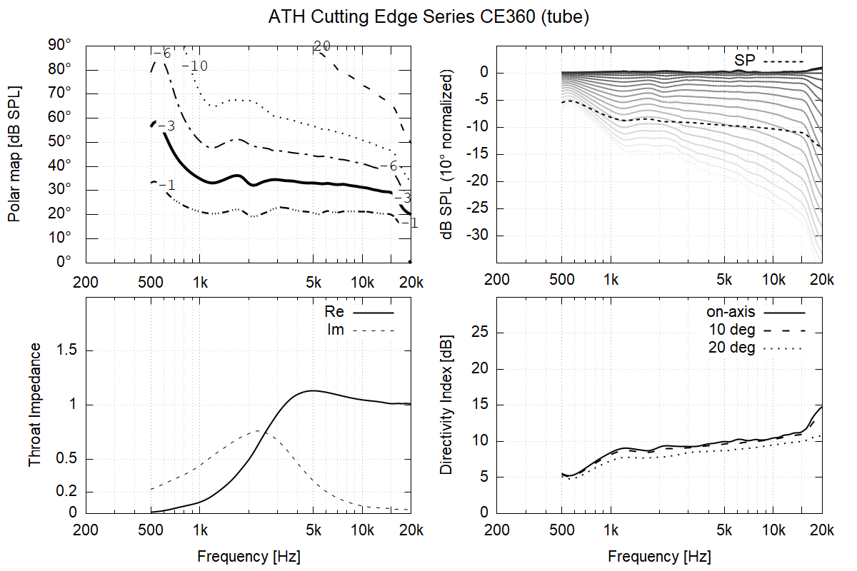

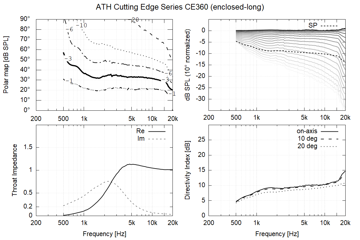

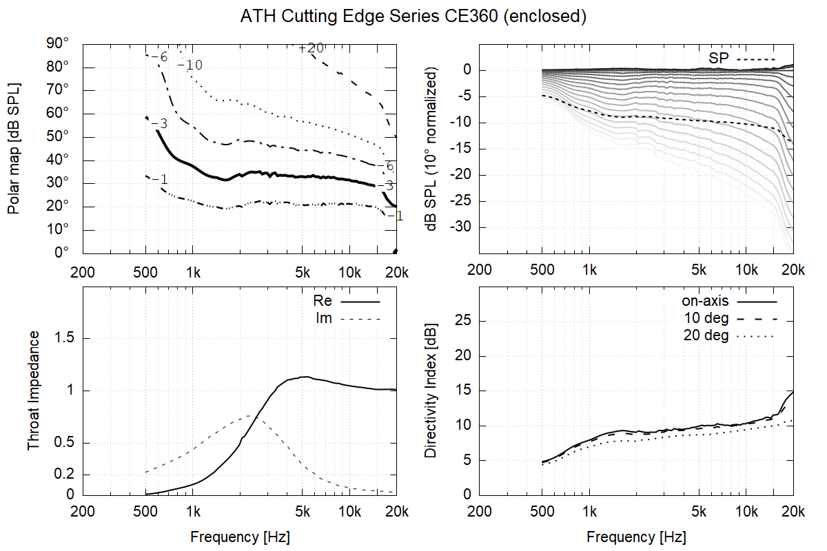

BTW, this is an effect of an enclosure I repeatedly observe in the data - it's not helping the lower-end directivity. All it does is that it's actually a bit less controlled, compared to a "bare" free-standing waveguide (the DI is actually a bit lower below 1k when enclosed). This is without any additional flat baffle around the mouth, just a rear-side "housing" (all axisymmetric).
View attachment 1018927 View attachment 1018928 View attachment 1018929

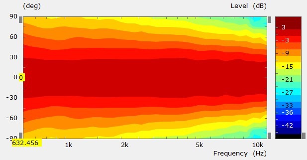

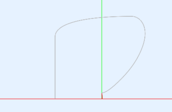

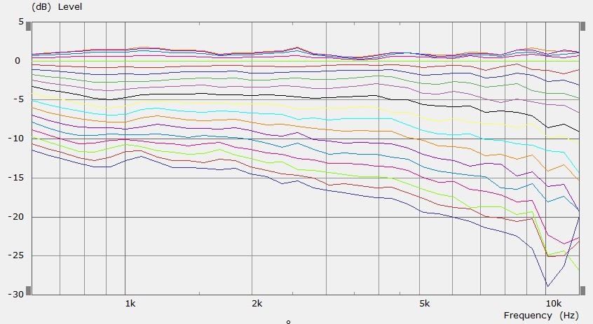

The corresponding results:
View attachment 1018930 View attachment 1018931 View attachment 1018932
Thank you, Marcel, for this study because I think it proves the points that I made. 1) the differences would be minimal, and 2) there will be tradeoffs that different designers will choose between. For example, I prefer the enclosed waveguide because the DI is flatter and higher at LFs.
Then there is the fact that one must consider the whole picture where the free-standing waveguide must be placed on the woofer box which will then diffract in a manner quite different from the enclosed waveguide. This may or may not be an advantage - most likely another tradeoff to be considered.
You always do, no matter what I post 🙂
Is it? Strange, I read the data as quite the opposite.
- What is missing in that study is the front baffle - there's no flat panel around the mouth that would otherwise cause another sharply localized diffraction. I believe it would look considerably different if the enclosure was a box with a flat front panel. But fluid has obviously a lot more experience simulating this.

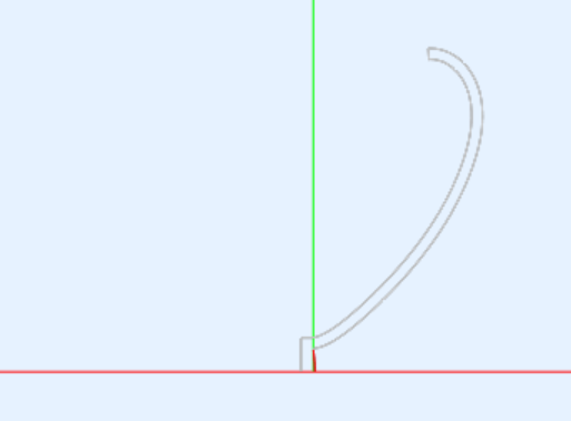

@fluid, ever tried a termination like this?
Here's the "baffle issue" - I've cut the curve at the apex and inserted 2" of a flat baffle. As a result there are now two sharply localized sources of diffraction - the edges of the flat segment. Of course in a rectangular box in won't be as bad as the distances to the outer edge will vary but this is the principle.
That shows why I worry that it will be difficult to use circsym models to properly explore as a circular baffle of any flat area is bad.

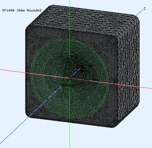

This is what I simulated and the diagonal is almost the same as the horizontal and vertical. There is as little flat baffle as possible and every edge and corner rounded.
Now, this is nice!
Thanks, I like it
It will suffer from the same limitations, the baffle diffraction should be accounted for.
I don't agree because here is a rectangular guide that looks nearly as good, this was the one I thought I would build before more ideas took over. I still think it has a lot of visual appeal.

Is that Tritonia based?
Rectangular mouth has the obvious advantage of varying the distance even of the first baffe edge and further minimizing the flat areas. That's why I said I would opt for a rectangular as a baffled waveguide. Well, it has some other weaknesses, maybe not that important.
- Anyway, compared to a big free-standing round waveguide, it seems a little bit too complicated and in fact also compromised to me now.
