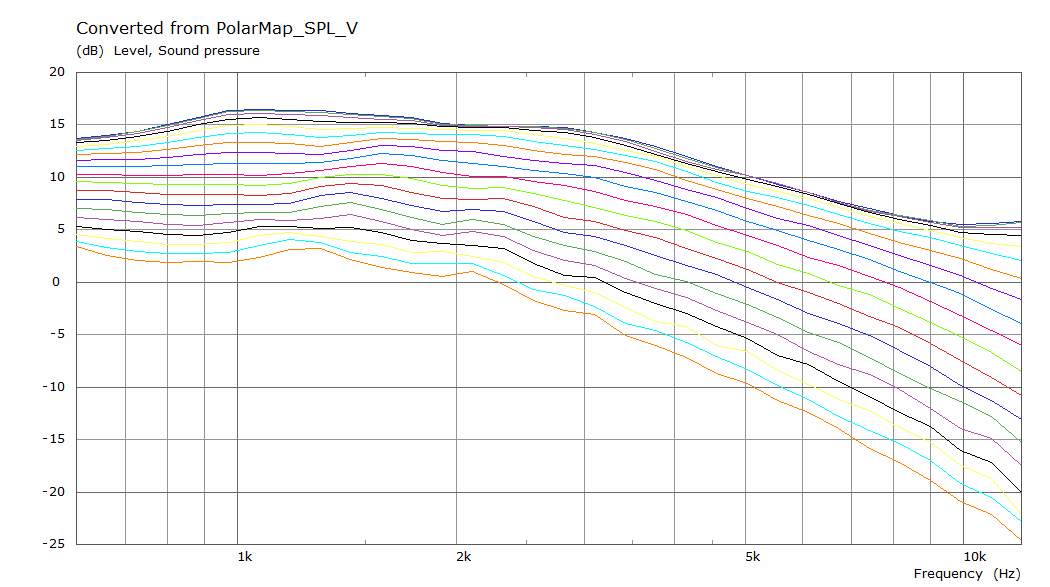

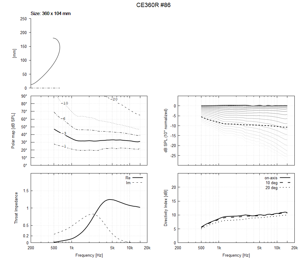

Seems like a trade off between a few HF wiggles and a developing trough at 1K.A one from another batch:
Frequencies above ~10 kHz are affected especially by the throat details and that is pretty independent of the rest of the waveguide (different 'k' values). So in these examples the behaviour above 10 kHz may not be directly related to anything below that and could be different with a different value of 'k'.
It seems there's nothing one can do to make the DI lower than about 15 dB at 20 kHz (for a simple open 1" throat, that is). So if it's already that high below that, it makes a "nicer" top end...

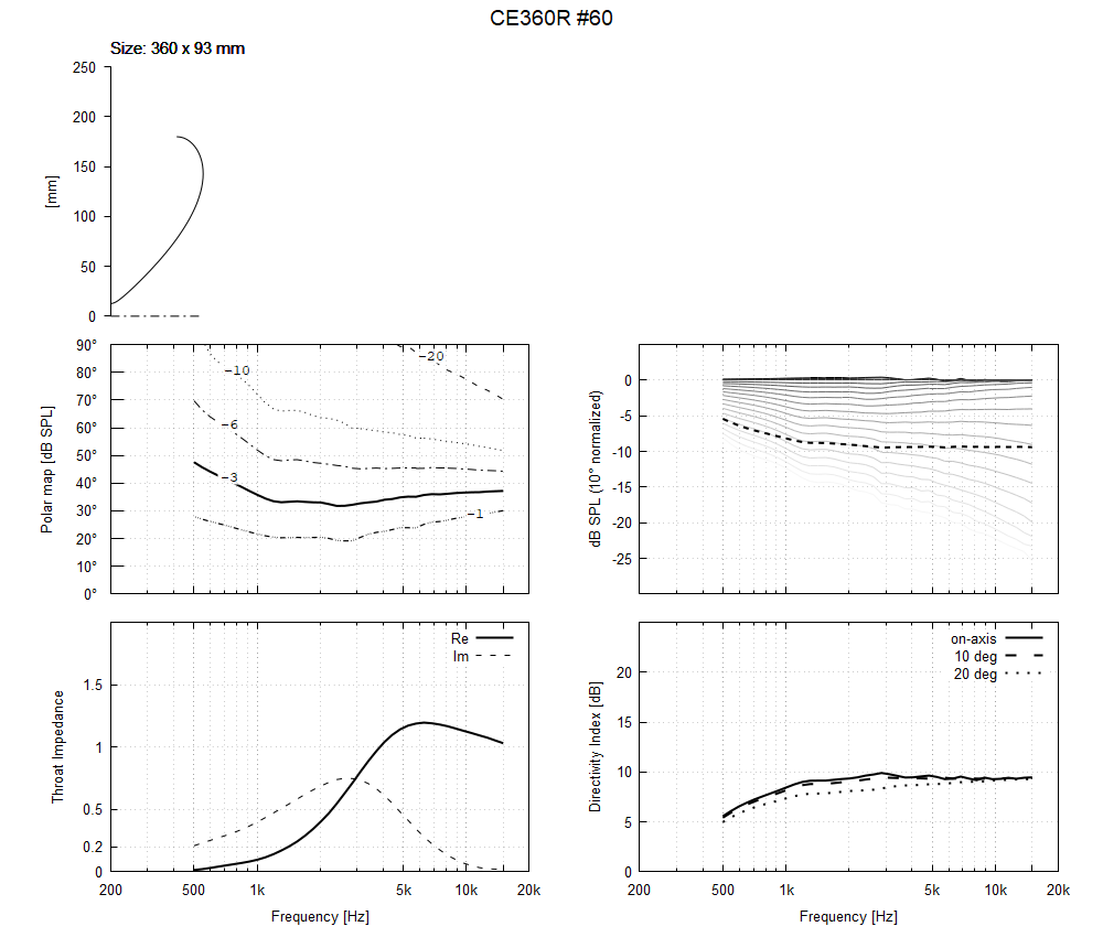

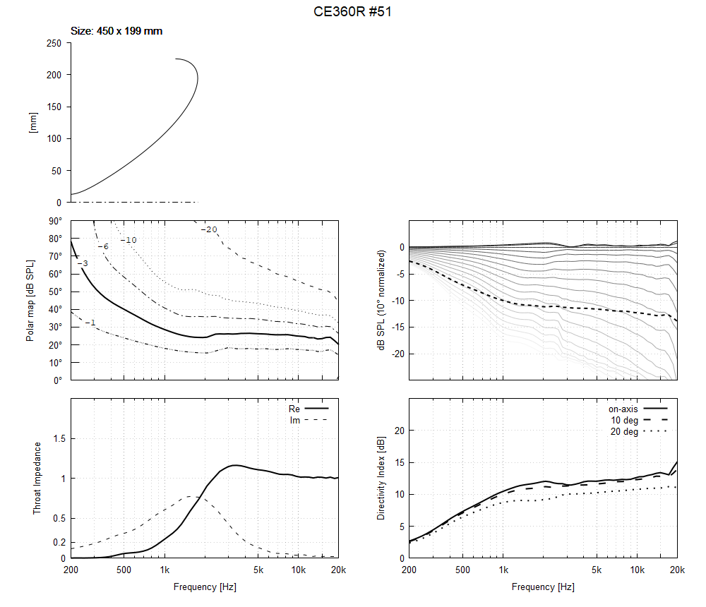

This is also possible, I'm only not sure it's the best way:
Above 3 kHz the DI (and the -6dB beamwidth) is as flat as possible but the frequency responses in the listening window are actually not (and I guess that's how it must be). I believe that better would be to let the DI rise gently with the listening window flat (which can be done).
More something like this:

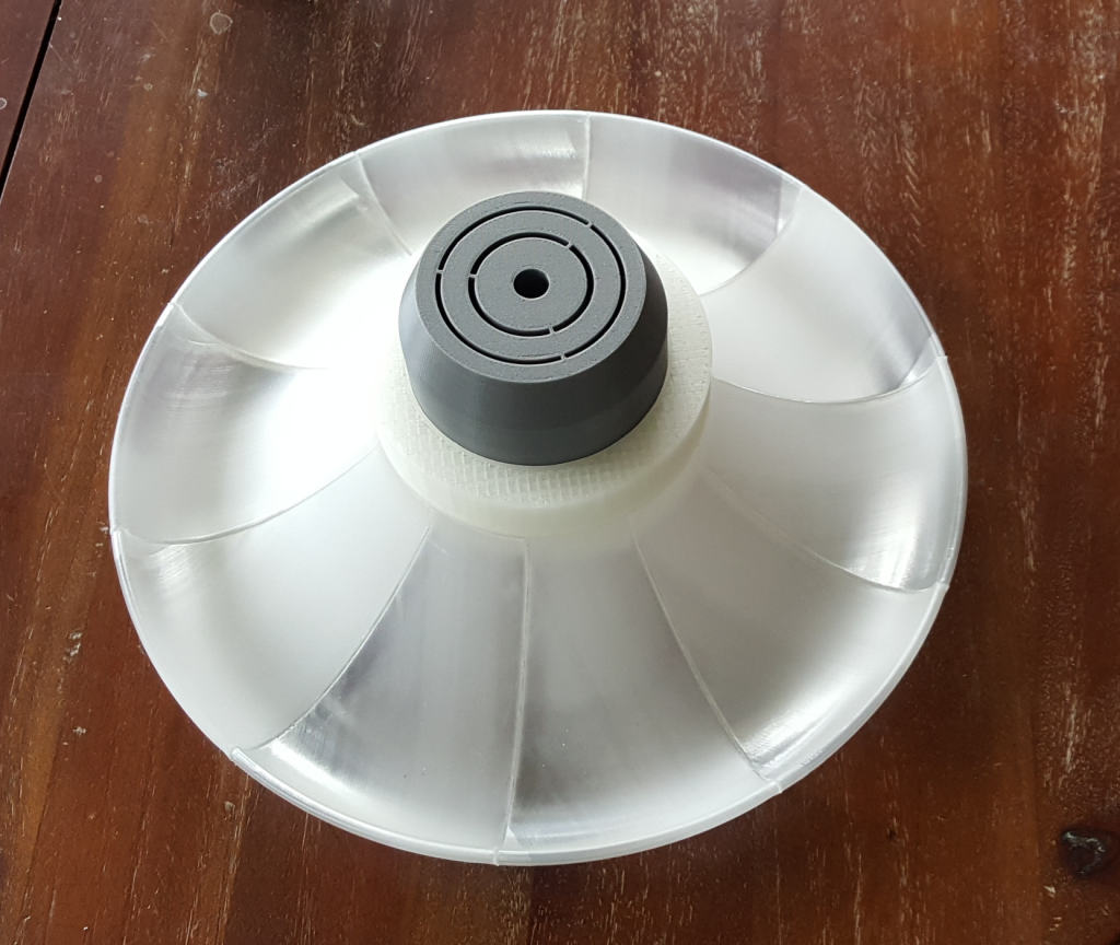

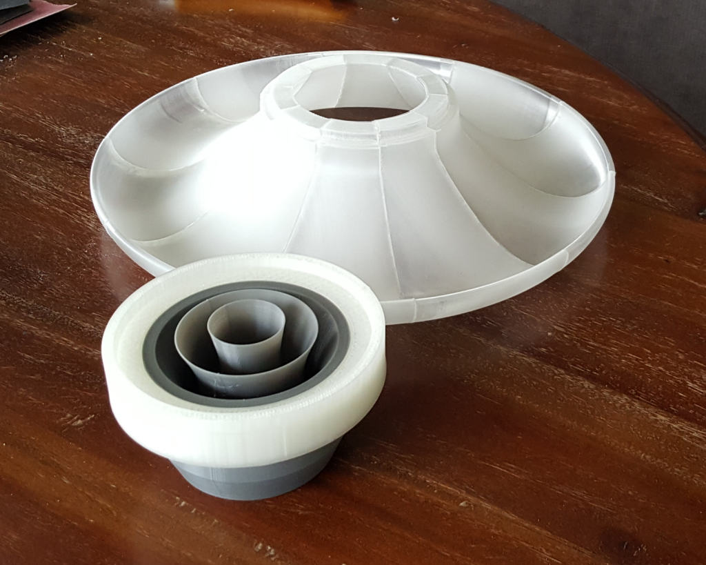

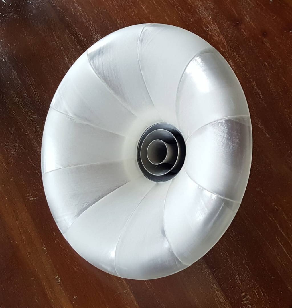

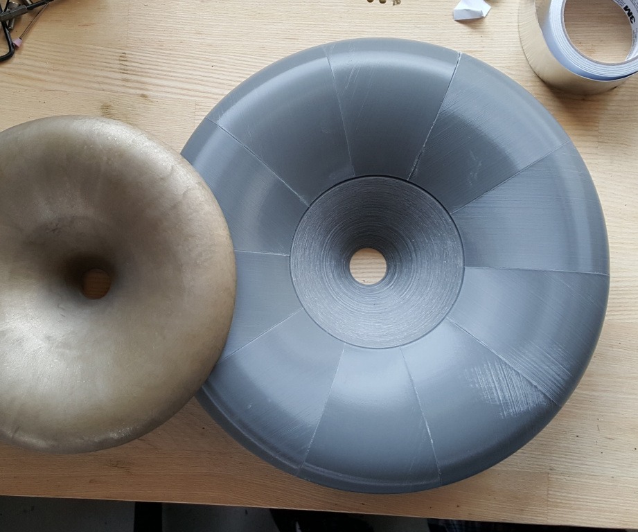

It's only around 10 - 12". I've done this before:
https://www.diyaudio.com/community/...-design-the-easy-way-ath4.338806/post-6760729
https://www.diyaudio.com/community/...-design-the-easy-way-ath4.338806/post-6752296
https://www.diyaudio.com/community/...-design-the-easy-way-ath4.338806/post-6744458
This way it's printable without any supports and one can make quite big waveguide even on a small printer. It's glued and it's a lot of work, I'm not sure I would recommend it to everyone. For me it's certainly a way of testing these things.

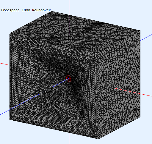

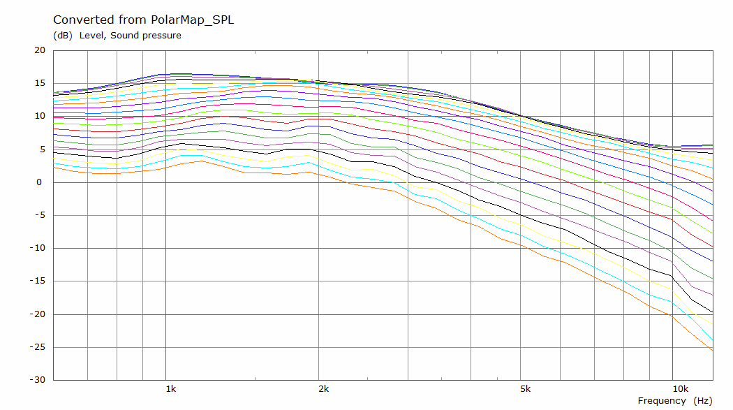

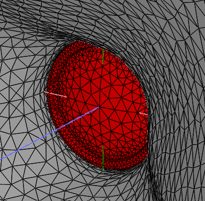

I put the Tritonia in a minimal baffle enclosure and simulated the freespace response with a dome tweeter as the original worked well with a spherical source.
I like it, within the listening window the responses are extremely similar to each other and fall off smoothly outside.
