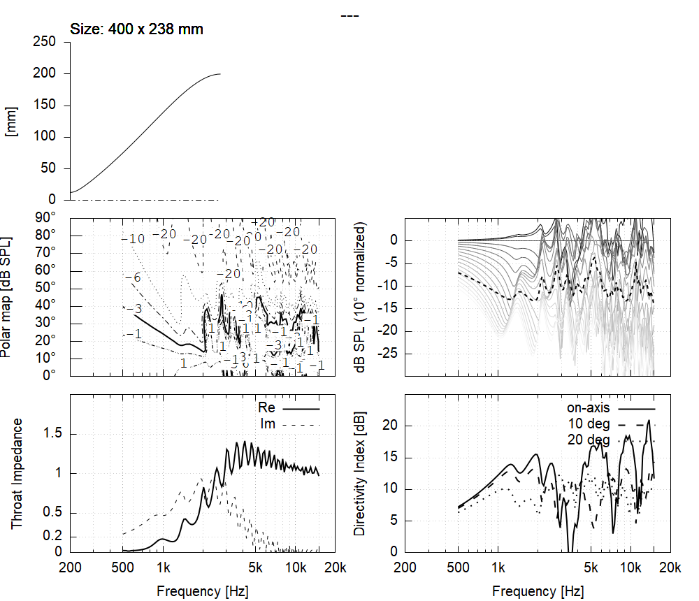

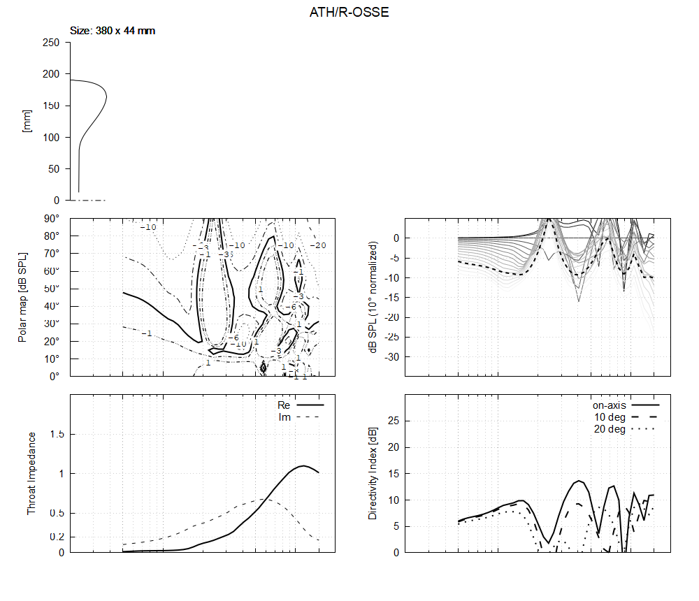

BTW, I've changed the formulation for something a little bit more intuitive. The downside is that not all the parameter combinations now give reasonable results. For example this is certainly not what you want (wonder how that would sound though, probably not many ever heard something this bad) -

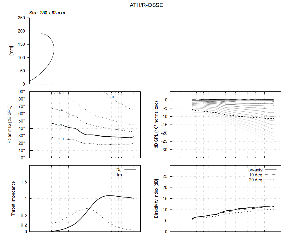

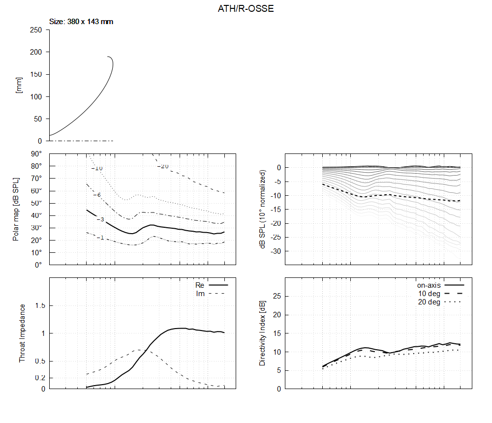

Is this 15" example any good?
Code:
R-OSSE = {
  R = 190
  a = 30
  r0 = 12.7
  a0 = 6
  k = 0.8
  r = 0.5
  m = 0.8
  b = 0.3
  q = 3

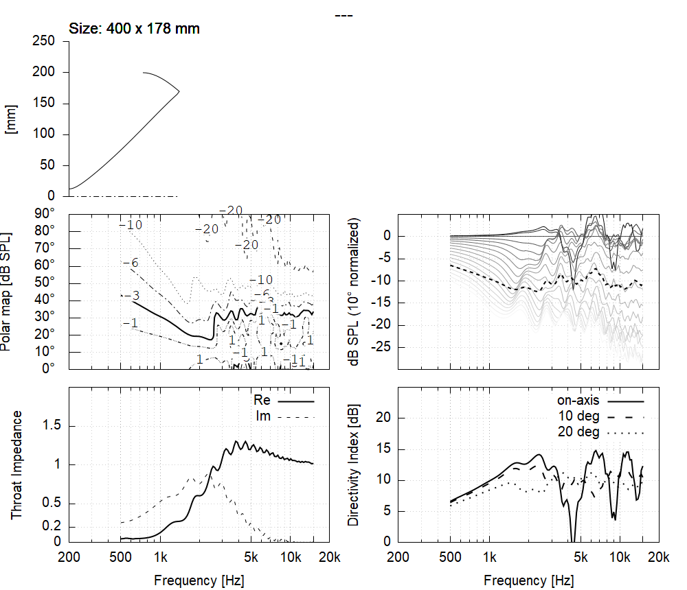

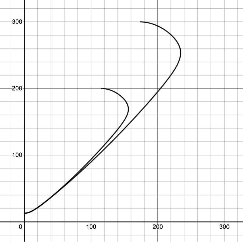

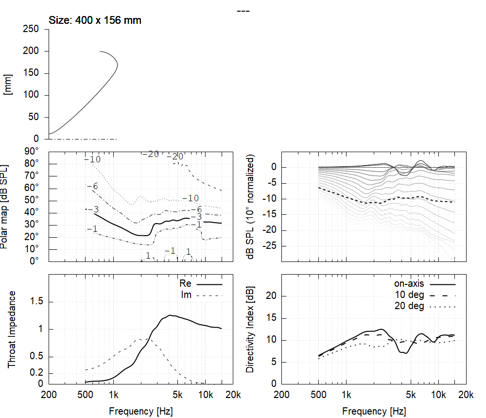

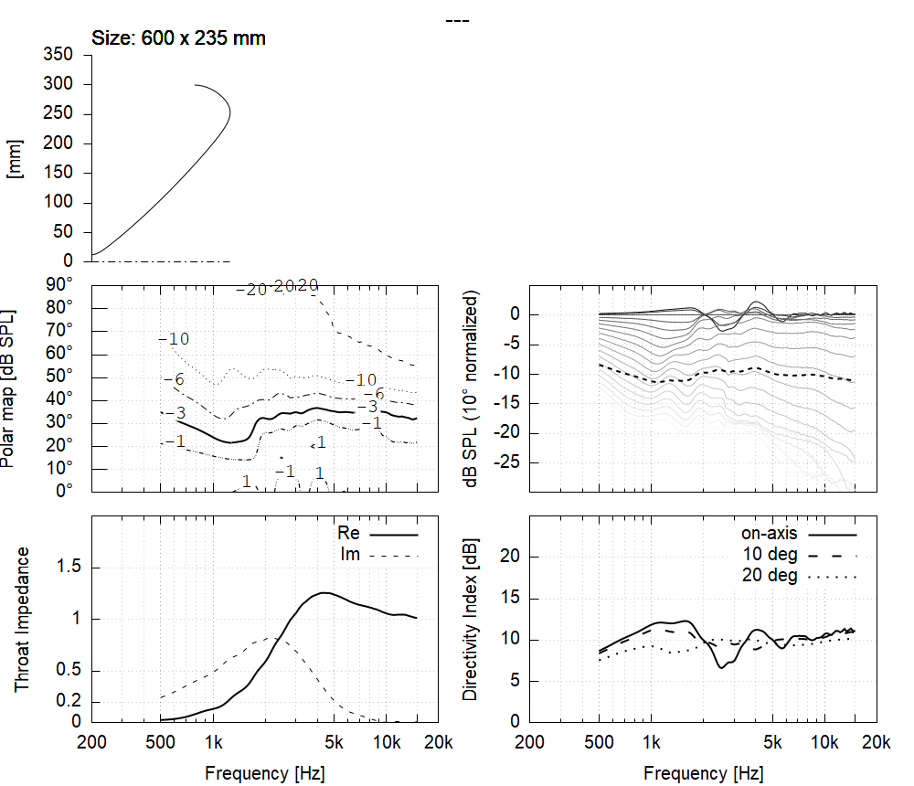

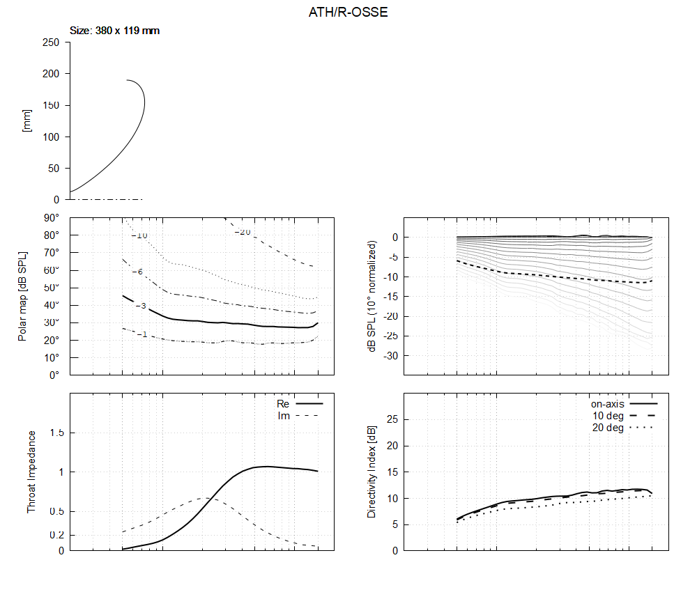

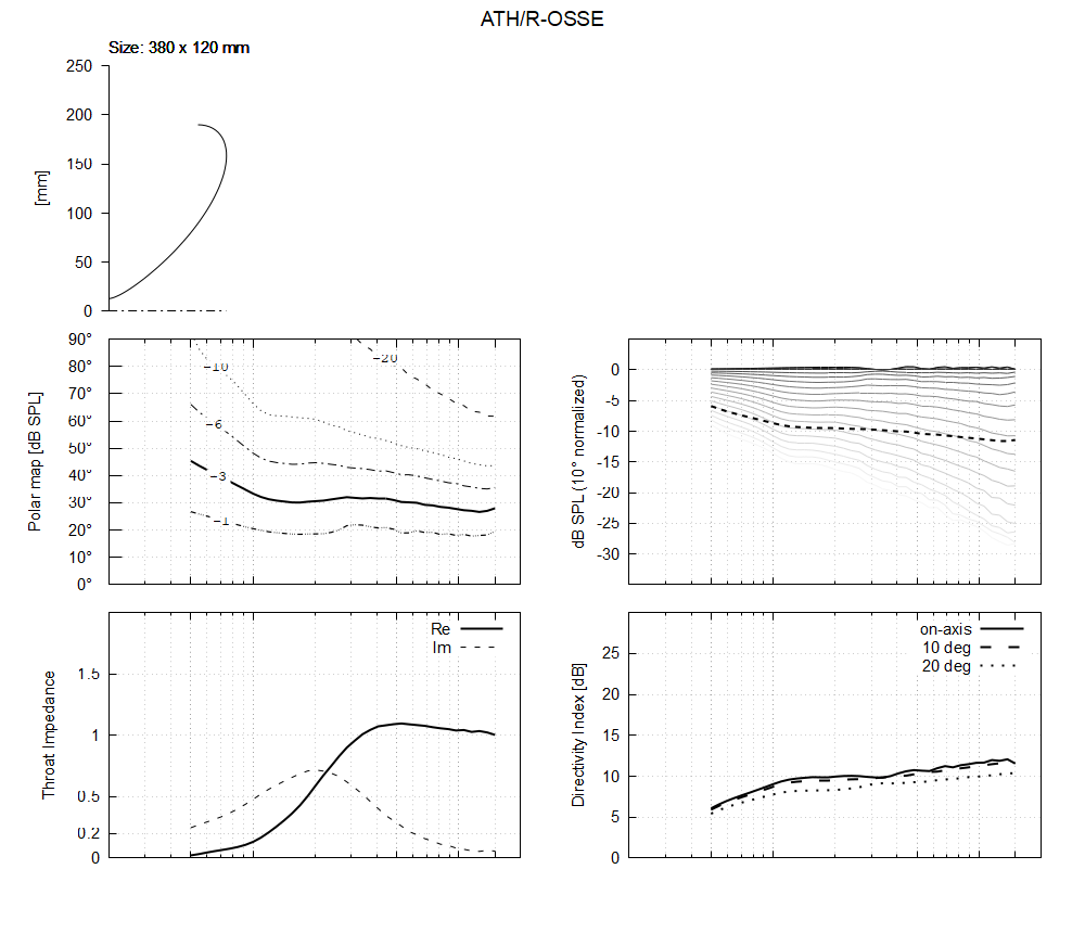

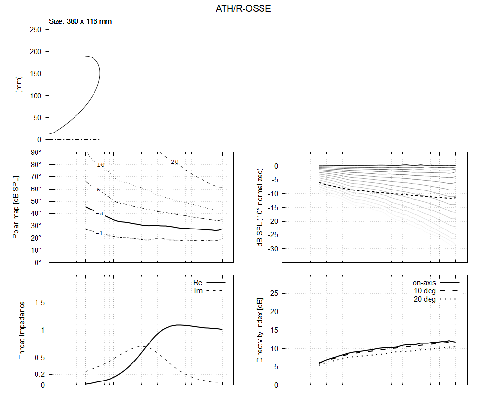

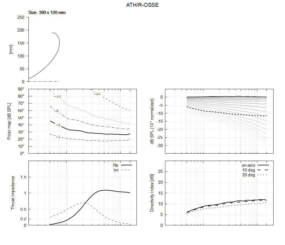

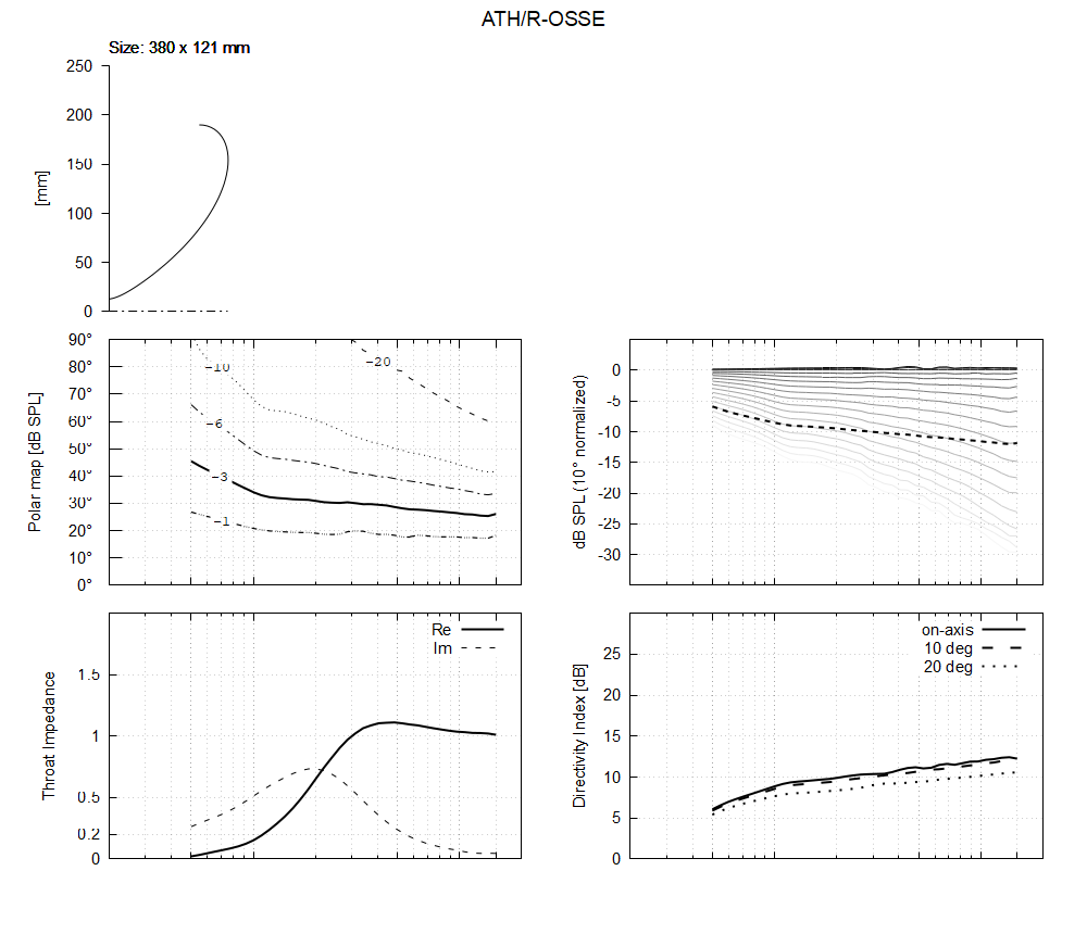

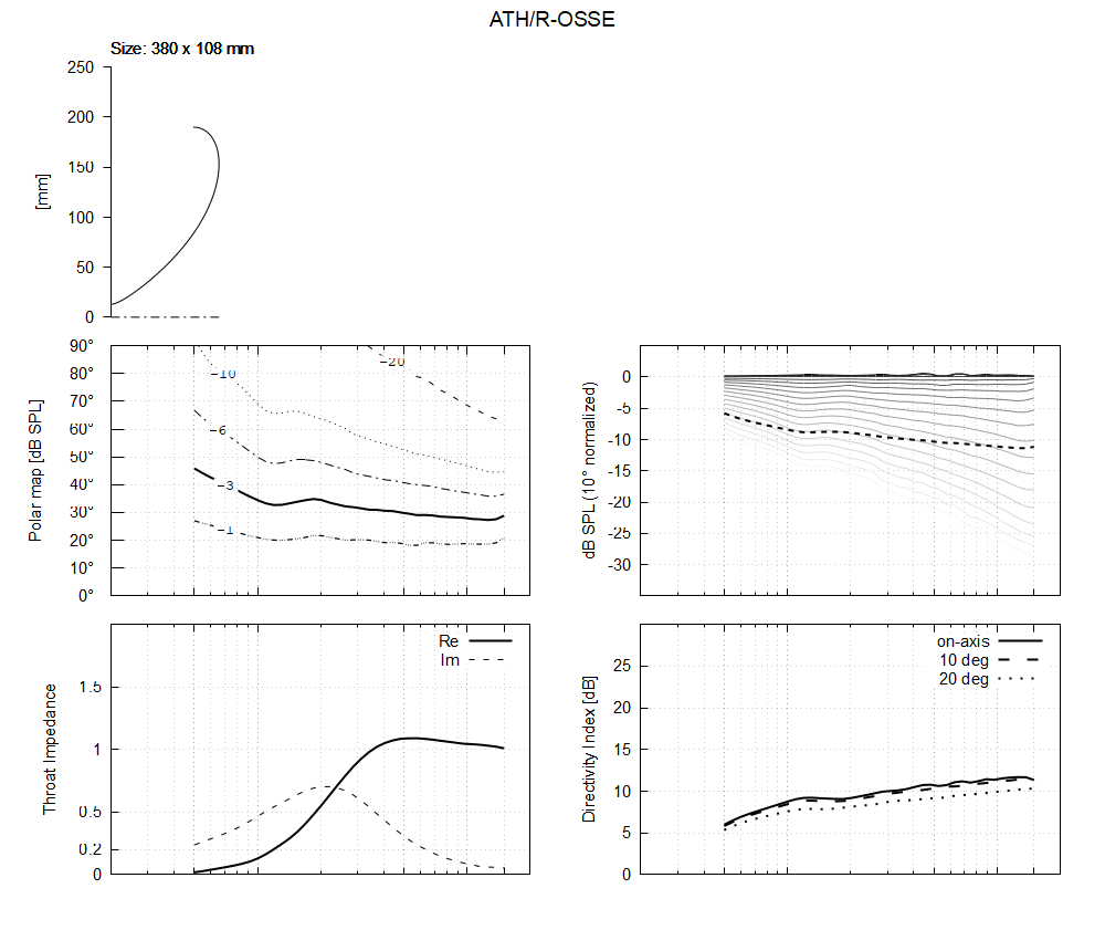

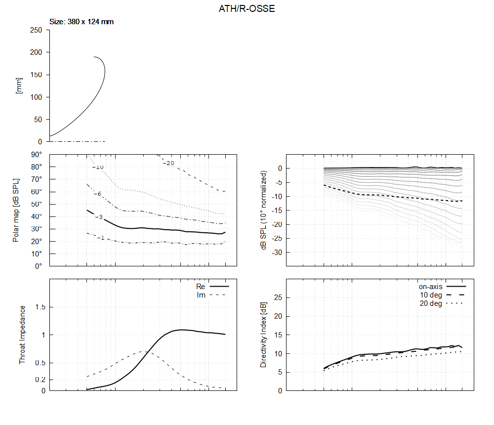

In an attempt to get a feeling for what I'm looking at and what the different variable in the R-OSSE do, I plotted the reference (posted a few posts above) and +/- 10% for the k, m, r, b, q parameters.
What is good? What is bad? How do the results depend on the shape?
1 has a flattening of DI at 1K
2 smooths that out and keeps the DI rising
3 flattens the DI a little
4 keeps DI rising into top octave
5 and 6 lumpy DI
7 keeps the DI flatter and higher to a lower frequency but introduces a DI step
2 and 11 probably the smoothest responses, what changed in 2 and 11?

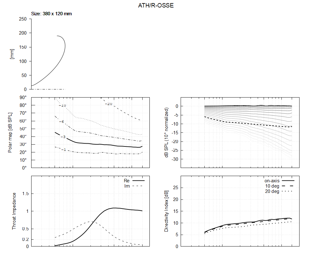

I just ran my first batch last night. Unfortunately quite a lot are totally rubbish:
R-OSSE_k=5.76336886035278_r=0.947074002819136_m=0.45739683858119_b=0.168201142223552q=0.092570...png
I'll try to come up with some boundaries for the parameters; unless someone already has done that...
