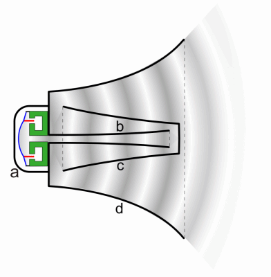

What I mean by "Bullhorn" is illustrated very well at Wikipedia:
It is the horn of choice for megaphones and PA systems due to the shortened dimensions. So not really a horn for audiophiles probably. And all are not circsym either even if most megaphones are.

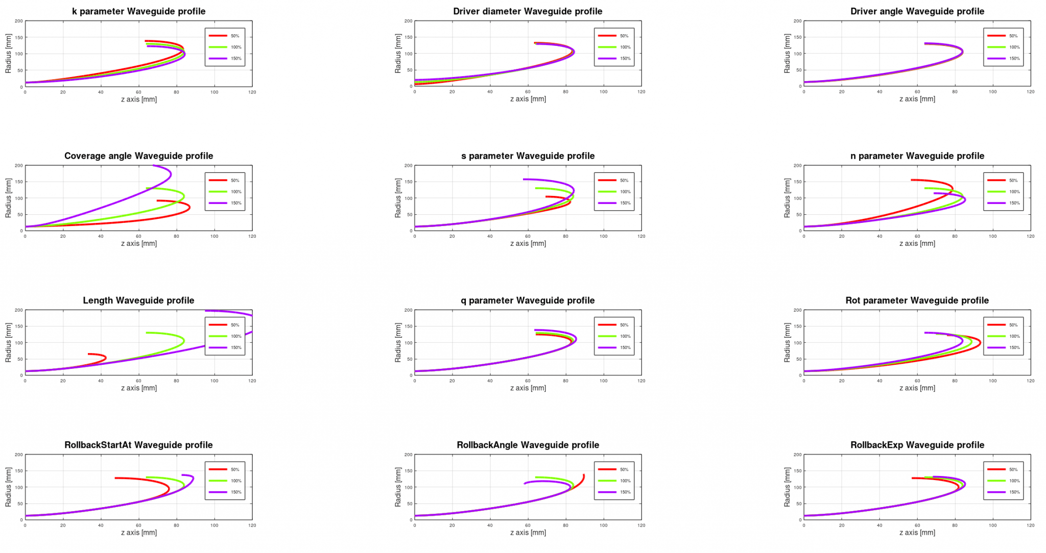

I have compiled some trials to see roughly the effect of each parameters of the OSSE formula on the CE260.
It may be helpful for manual iteration.
First, just the profile with 3 steps 50% of the initial parameter, 100% and 150%
Then parameter by parameter with the impact on the global performance the name of the parameter is in the title of the profile subplot.

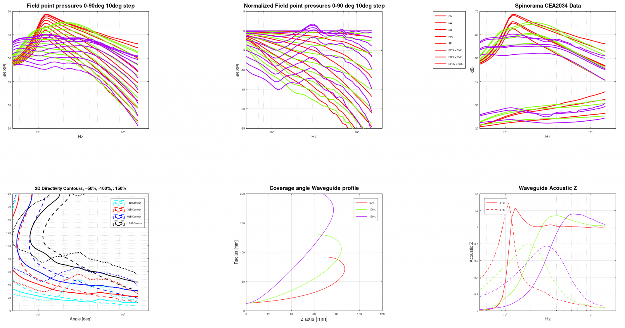

For the directivity contour
Code:
-- = 50%, - = 100%, : = 150%
Coverage Angle as an example:
etc.
They are all in the attached zip.
I hope this helps.

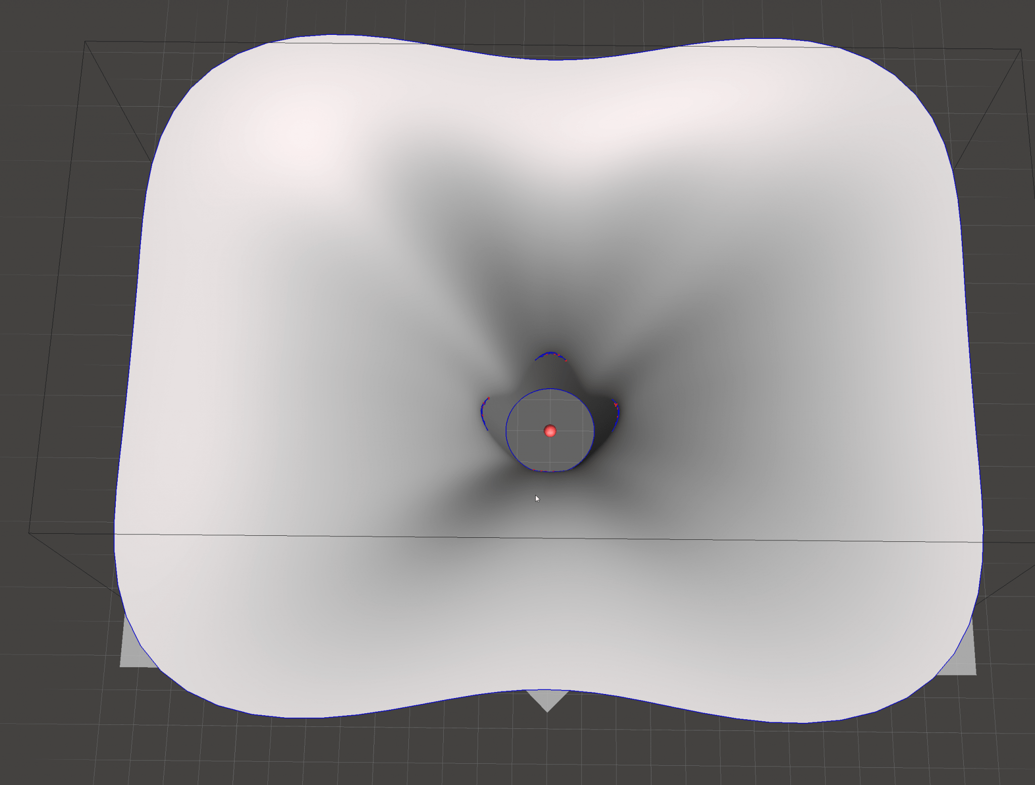

I found a bug, unfortunately:
Basically if you use the "slot" feature, you can wind up with holes between the diffraction slot and the waveguide.
See the attached pic.
Here's my config file.
I confirmed the bug exists in ath 4.7.1 and 4.8.0
I believe it may be because I used a function for both the slot length and the throat angle and the software is having a hard time coming up with a spline between where the horn meets the diffraction slot. I tried increasing and decreasing the resolution of the mesh to see if that helped, it didn't.

I didn't go through the demos yet with 4.7.2, there may be something wrong as the reporting changed a bit in the meantime. I recommnend not to start with the demos this time.
- Ah, I see the issue now. In the script file there must be a 'Report' item defined, even if empty, otherwise the 'static.txt' file is not written:
Report = {
(Note that you can modify the report properties with this item.)
I found another bug:
If you define "output.subdir" in the config file for your horn, it breaks the reporting function. Basically the text files named "static.txt" and "coords.txt" do not get produced.

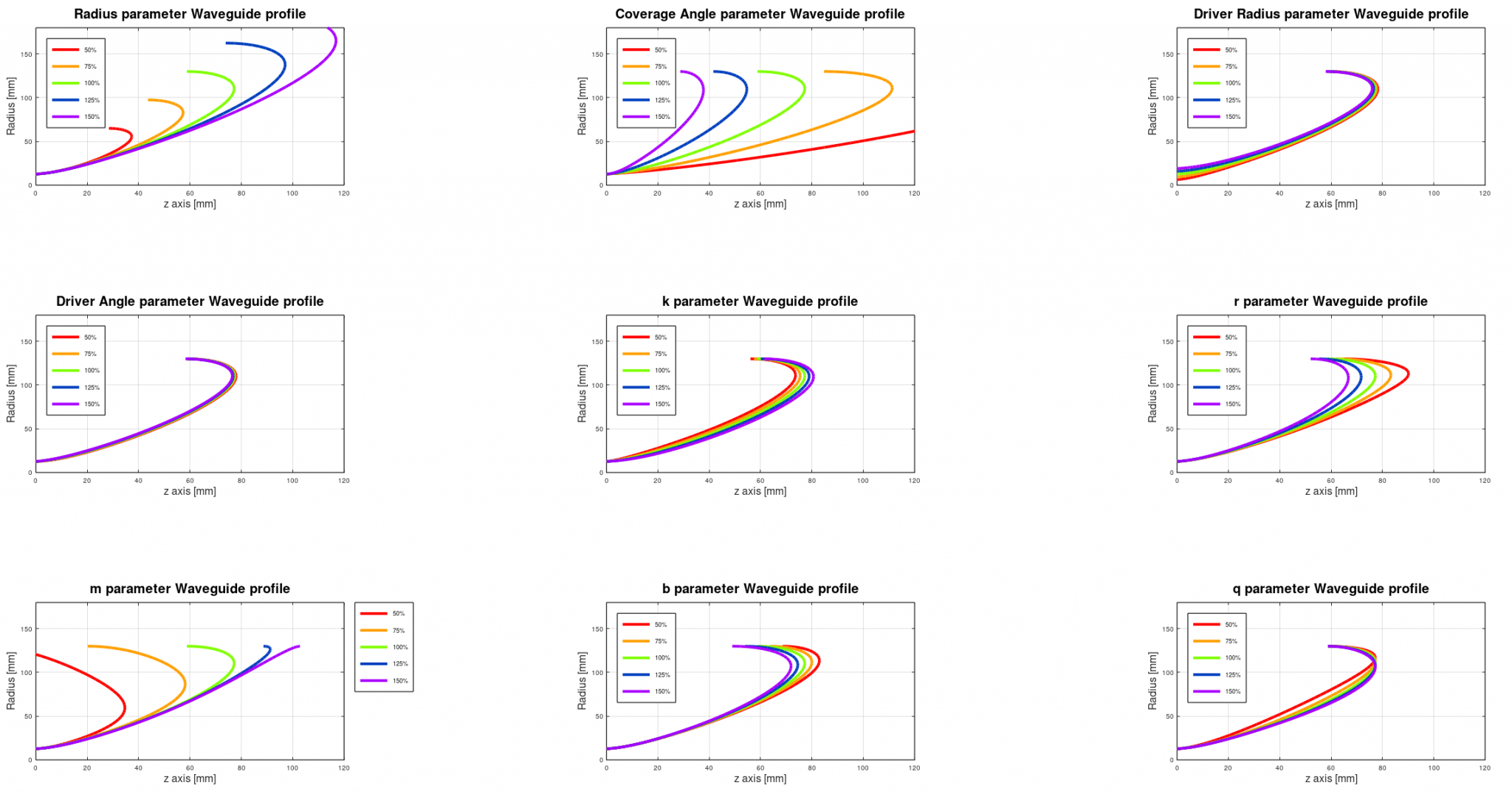

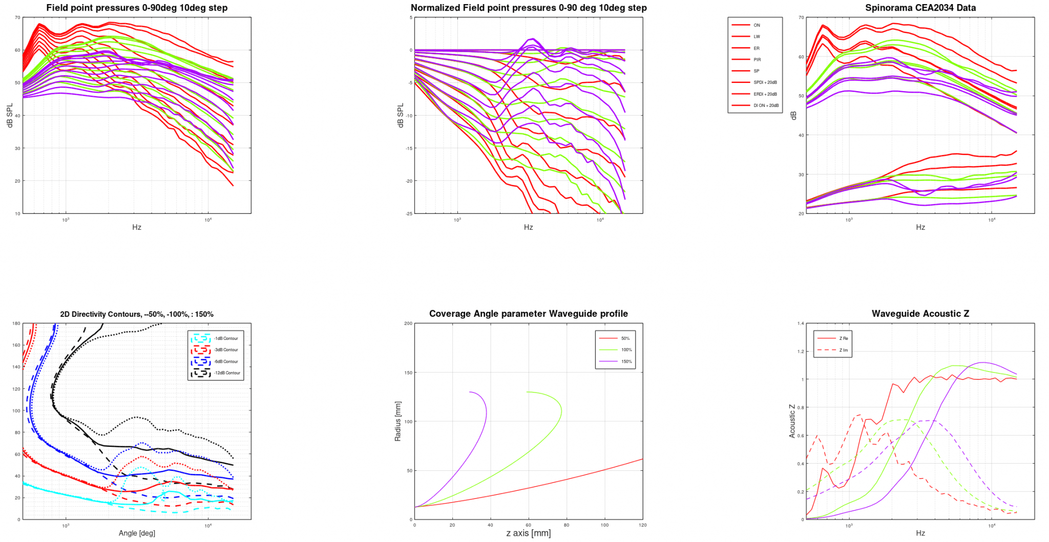

[...] 3 steps 50% of the initial parameter, 100% and 150%
For some of the parameters this is obviously a very large step, so some of the results are just too extreme, IMO. Perhaps it would be better to adjust the step individually per parameter so the resulting profiles don't differ that much. Just my observation.
Also, for the nominal (100%) case it would be nice to select some already well-performing profile, like the one Tom has posted here: https://www.diyaudio.com/community/...-design-the-easy-way-ath4.338806/post-6942005
I kinda did that; +-10% for a number of parameters.
https://www.diyaudio.com/community/...-design-the-easy-way-ath4.338806/post-6943131

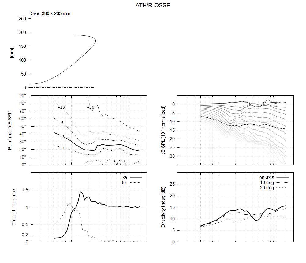

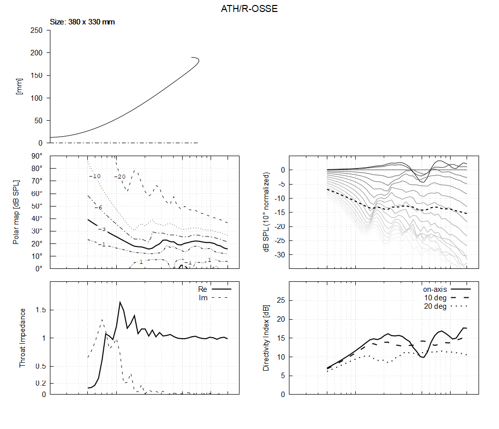

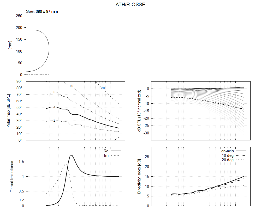

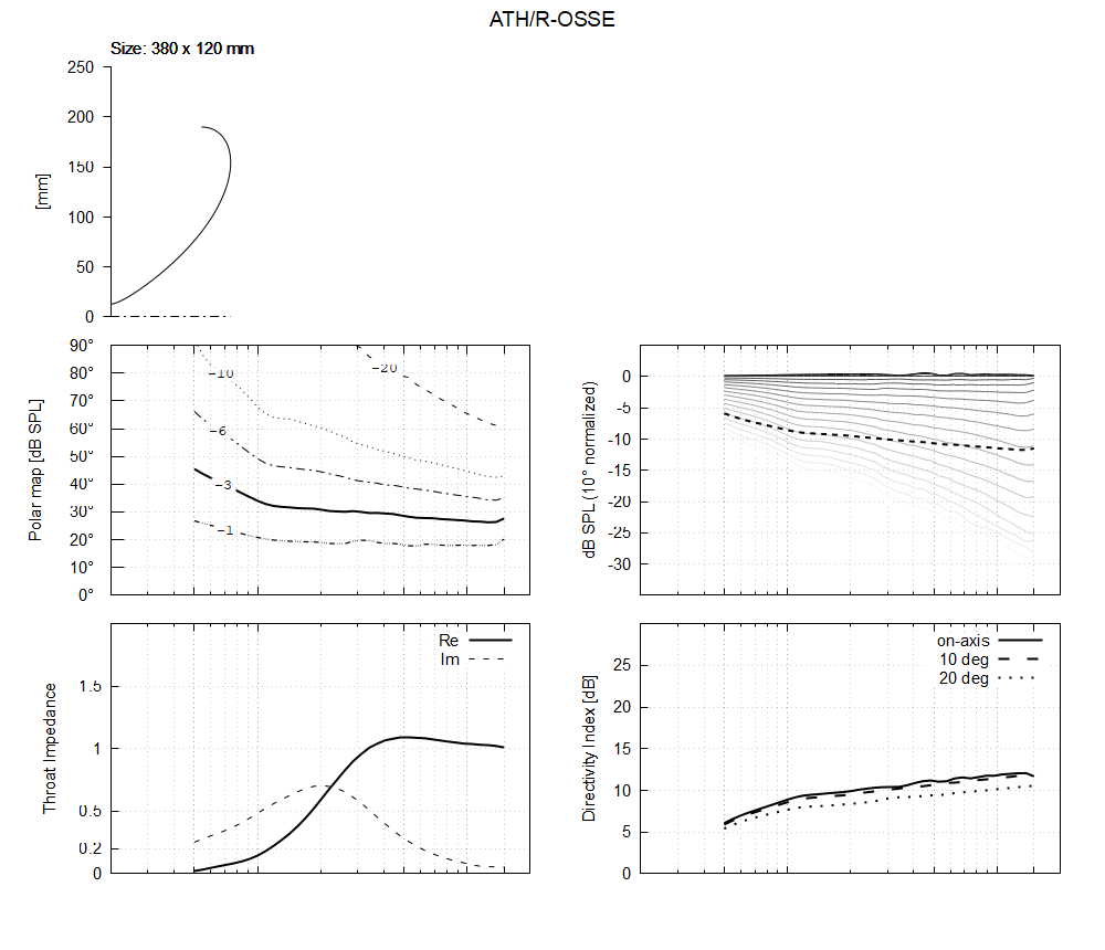

I ran some batches over time and I noticed some things.
1) You need some conical shape to get the LF directivity up and make it constant.
2) Make the round over as smooth/large as possible to eliminate wiggles halfway the interesting frequency range.
3) Waveguide (minus roundover) needs to be large for LF directivity.
Otherwise, it seems remarkably forgiving. However, I'm might just not know what to look for. 🙂

R-OSSE_k=6.47546958643943_r=0.125076335621998_m=0.826569197420031_b=0.388033892959356q=1.72112...png
2)
R-OSSE_k=5.71881870273501_r=0.54261415055953_m=0.779140177788213_b=0.41503227641806q=1.0721747...png
1) & 3)
R-OSSE_k=7.14404357830063_r=0.116095908218995_m=0.910517226275988_b=0.0627460770774633q=3.1747...png
And a nicely balanced one (posted earlier):
