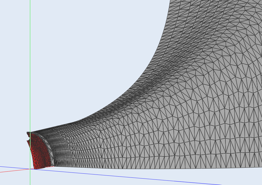

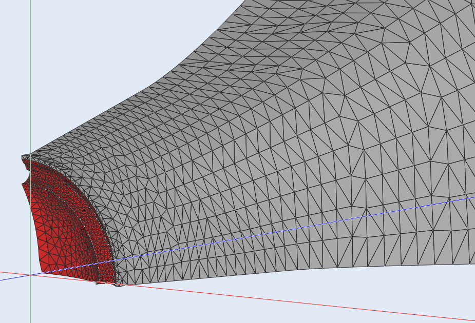

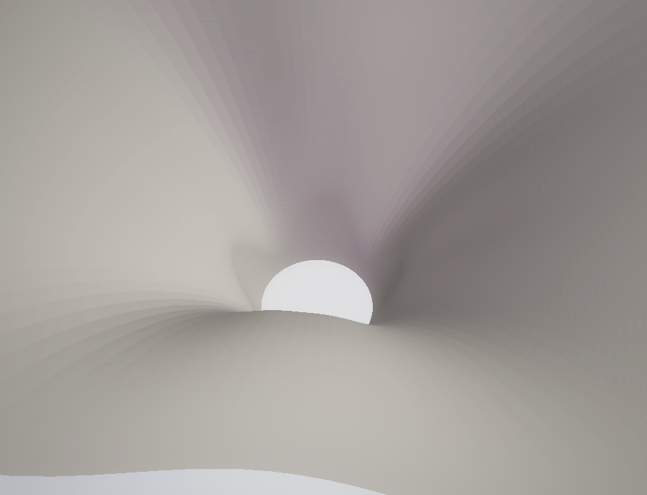

I can't reproduce it. With your script it works fine on my setup (Ath 4.8, Gmsh 4.6.0). The only problem I see is your dome tweeter definition - something is wrong with the geometry (see the image below, gmsh also reports warnings about that).OK, I figured out what the bug was. It's not due to the "slot.length" parameter. It's due to the "OS.K" parameter.
Basically if you use a formula in it, you'll get holes in your mesh. Here's the offending line:
OS.k = 2.2 - 1.8*cos(2*p)^2
Beware that the number of slices (Mesh.LengthSegments = 500) is way too high for ABEC in 3D mode. I assume you use a lower value when generating the ABEC project. Otherwise it generates around 14000 elements and that is most probably too much for ABEC, no matter the power of the PC (for me the upper limit is around 5000 elements to get results in reasonable time).
-With Mesh.LengthSegments = 100 I get 5061 BEM elements including the tweeter and that should be already manageable.
One more remark - since the curvature near the throat doesn't change rapidly, you can adjust the z-coordinate step and improve the mesh via the following (changed lines in bold):
Mesh.AngularSegments = 96
Mesh.LengthSegments = 60
Mesh.ThroatResolution = 2.5 ; [mm]
Mesh.InterfaceResolution = 7.0 ; [mm]
Mesh.InterfaceOffset = 5.0 ; [mm]
Mesh.ZMapPoints = 0.3,0.5,0.5,0.95
With this setting it produces 4803 evenly spaced elements which should be just fine. (Probably the InterfaceResolution could be further increased without noticeable loss of accuracy, further decreasing the element count).

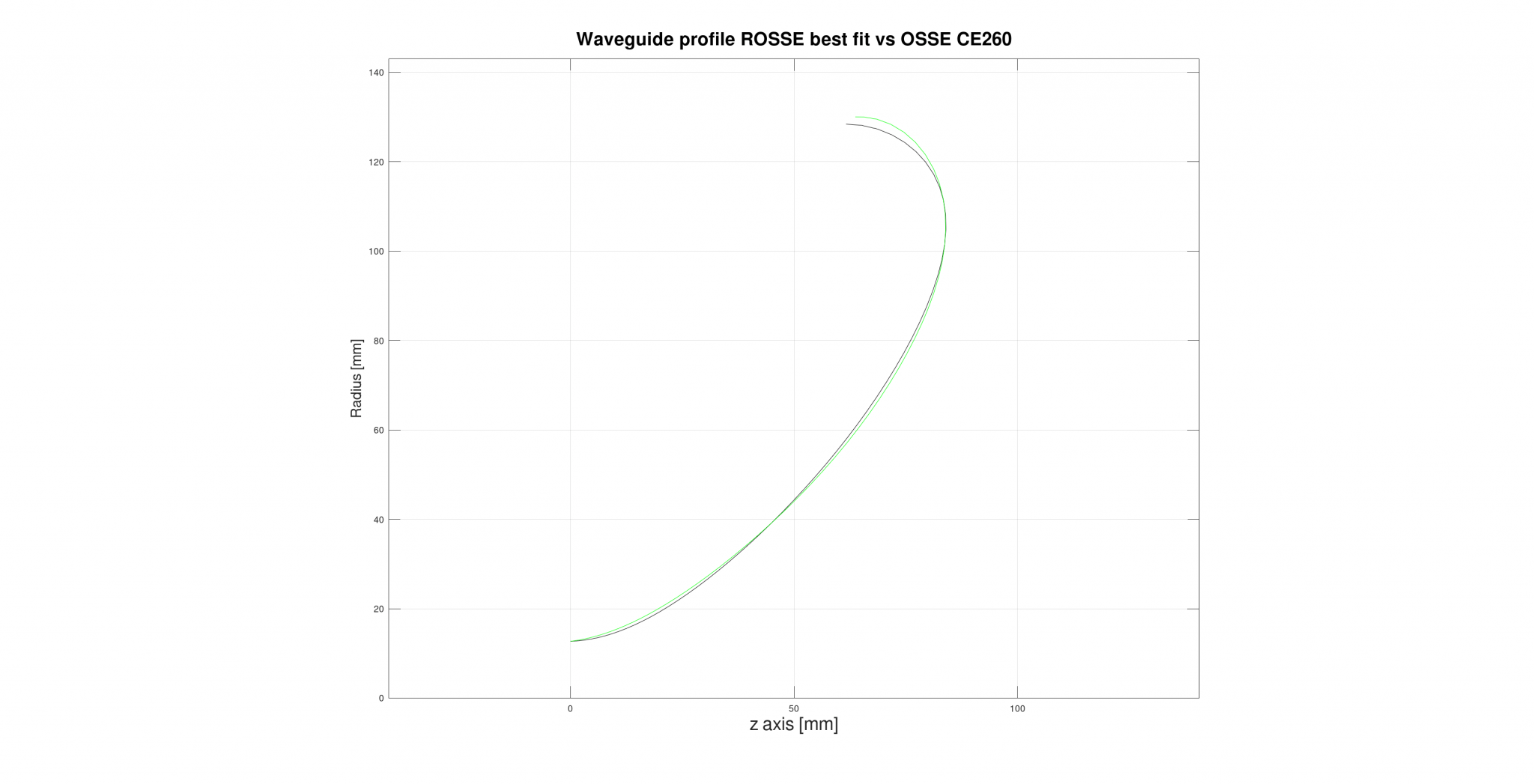

I am not sure that all the profiles generated by OSSE can be matched by ROSSE (not considering the baffled case).
I understand that ROSSE only uses 9 - Driver angle and Diameter => 7 parameters so it is easier for optimization but OSSE seems to provide more control from my admittedly limited experience.
BTW I tried to match the OSSE CE260 with ROSSE but I did not manage to get a perfect clone.
Have you tried?
EDIT:
the parameters:
Code:
% ROSSE CE260 fitting
Radius = 128.4 ; % Outer radius of the waveguide [mm]
anglCover = 40.57 ; % Nominal coverage angle [deg]
r0DRV = 12.70 ; % Throat radius [mm]
a0DRVangl = 3.886 ; % Throat angle [deg]
k = 1.935 ; % Throat expansion factor []
r = 0.200 ; % Apex radius factor []
m = 0.823 ; % Apex relative position []
b = 0.336 ; % Bending factor []
q = 4.018 ; % Throat weighting factor []

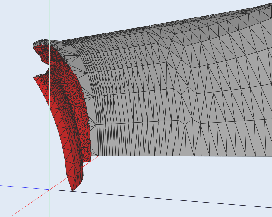

View attachment 1029078 View attachment 1029081 View attachment 1029082
I did a clean re-installation and the problem seems to have disappeared. Not sure why.

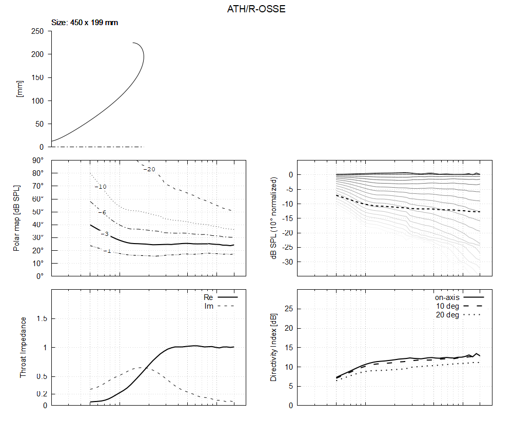

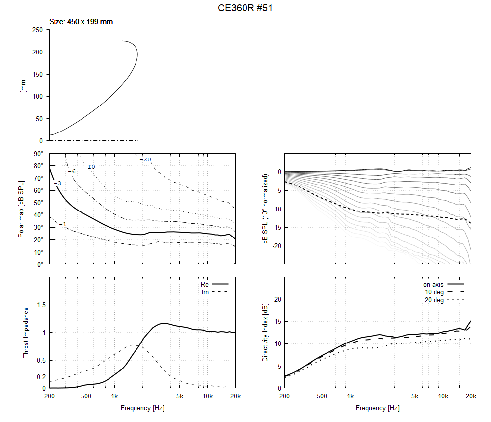

This is perhaps the highest reasonably controlled DI I have seen in the set:
I've been investigating 450mm waveguides also as it seems to be a better match for a 15" woofer (is it?). This turned up in my batch:
![R-OSSE_a=30_k=1.43901332058012_r=0.341596880741417_m=0.830868302145973_b=0.127310905163176q=4....png R-OSSE_a=30_k=1.43901332058012_r=0.341596880741417_m=0.830868302145973_b=0.127310905163176q=4....png](https://www.diyaudio.com/community/data/attachments/938/938323-ce2a22354260eb55b3601c0557b9f20a.jpg)

Would you like to share the R-OSSE input for this WG?I've been investigating 450mm waveguides also as it seems to be a better match for a 15" woofer (is it?). This turned up in my batch:
Of course:
Most of it is encoded in the filename of the images I post.

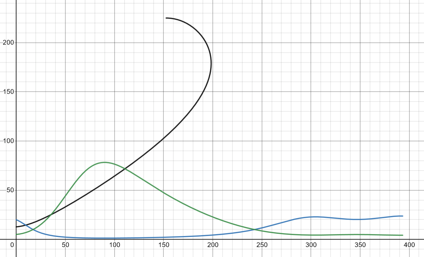

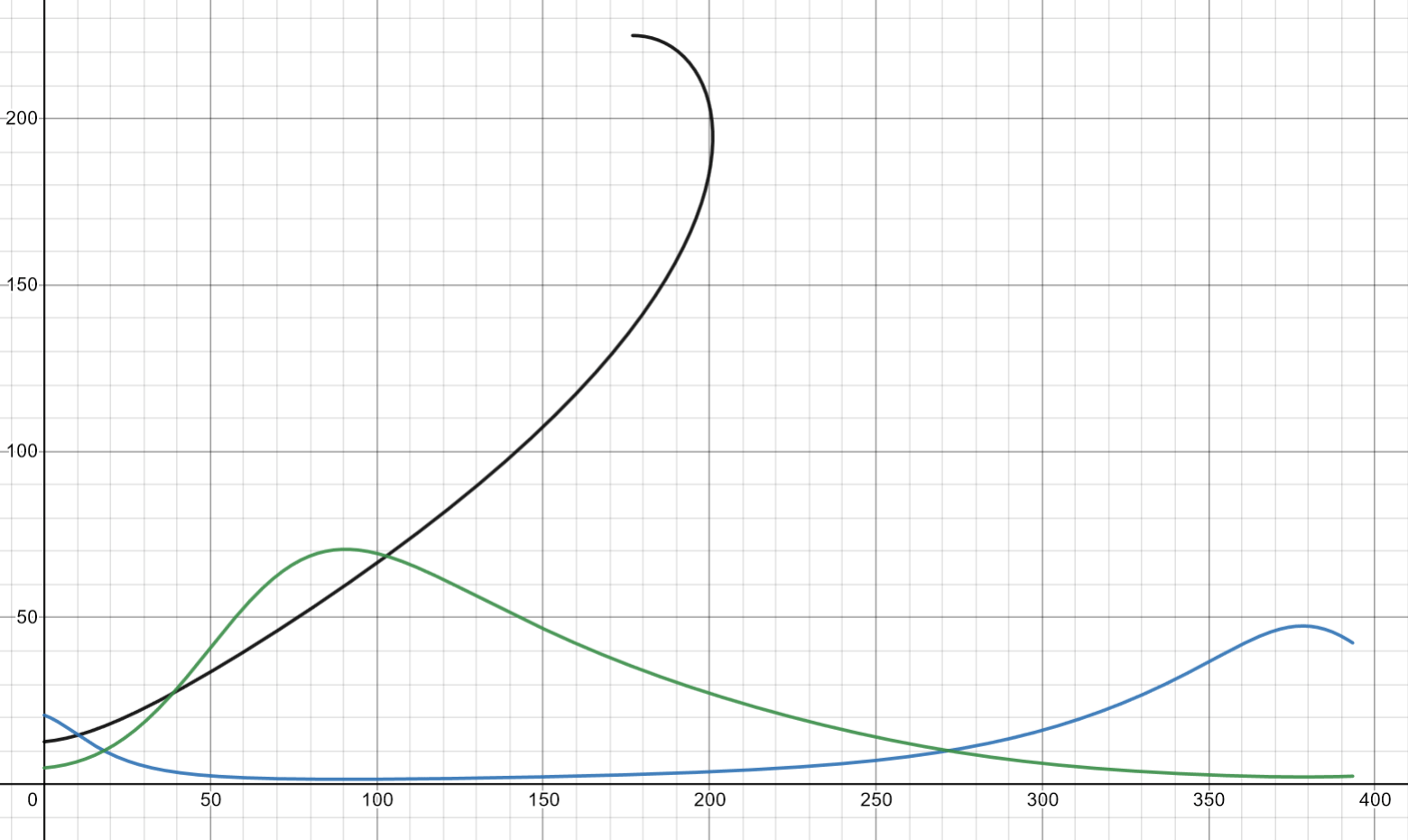

I've been trying to include the radius of curvature in Desmos (as I read that has something to do with HOM's). No guarantees: https://www.desmos.com/calculator/z8ybyhlfcs?lang=nl
Code:
R-OSSE = {
R = 225
a = 30
r0 = 12.7
a0 = 15.5
k = 1.4390133205801
r = 0.341596880741417
m = 0.830868302145973
b = 0.127310905163176
q = 4.4141227456741
That can't be correct, Tom. The curvature radius can't start at zero in that example.
I would try this: https://www.desmos.com/calculator/nltso1dner
(blue = curvature, green = radius)
Otherwise it's a very good idea to show the curvature (or the radius). I guess that a good waveguide will have it smoothly changing (and increasing monotonically towards the mouth from the point of the first local minimum).
Even if not immediately obvious from the profile itself, I think this would be already noticeably worse (someone may try): https://www.desmos.com/calculator/zgj3wc5thq
