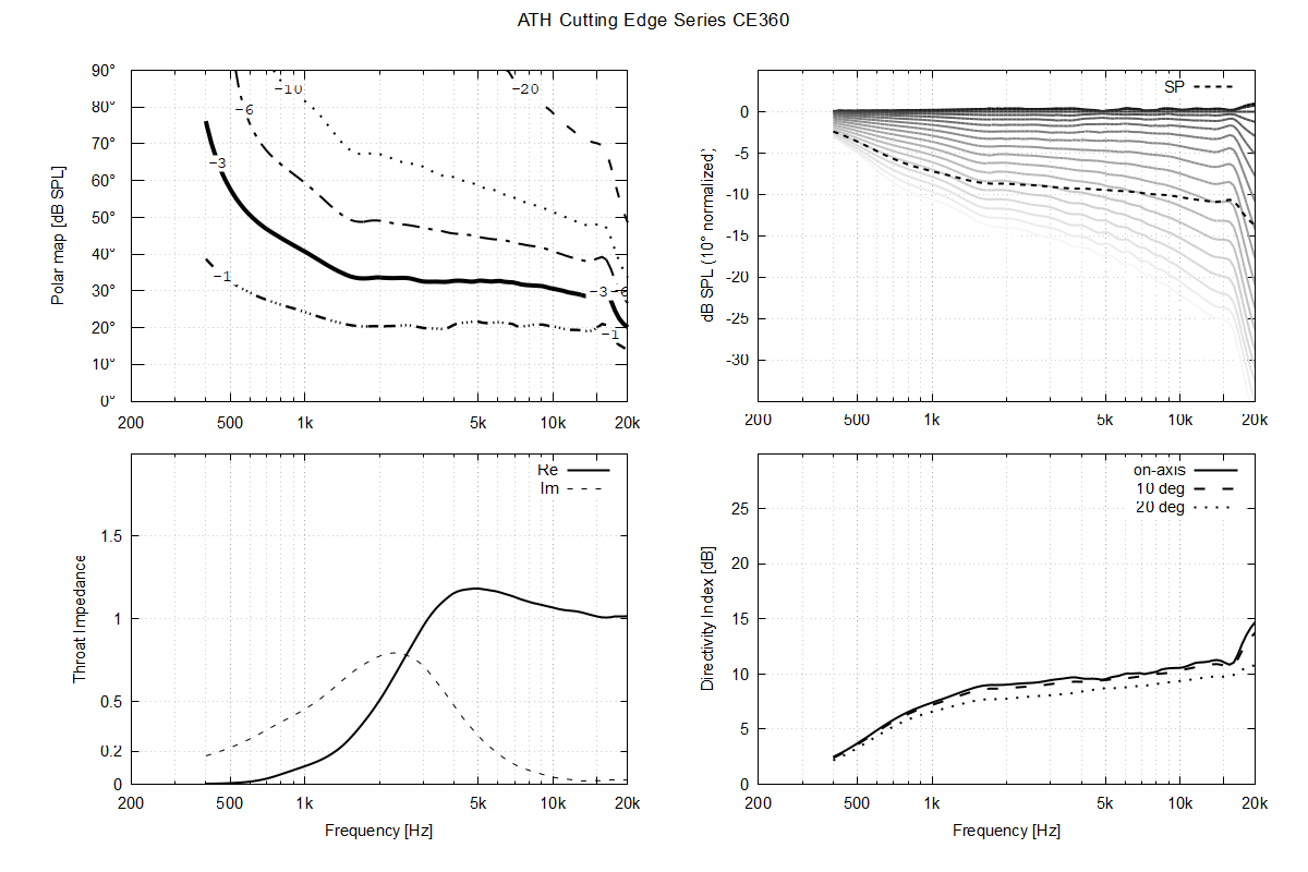

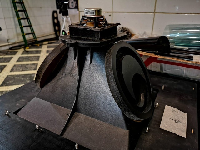

Have you had the opportunity to verify the CE360?...it's how far I got with my own CE360 prints (well, it already has a primer sprayed on now). I need to measure it to confirm it behaves as expected - it still may be that the assembled prints are not accurate enough.
Another question - now that there have been a number of these printed - is there a common understanding on what material one should choose to print with?

As for the material, I'm inclined to think that's probably the last thing I would worry about. Use whatever comes suitable.

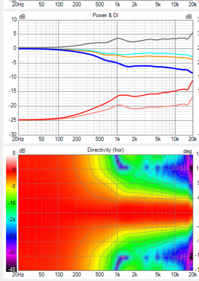

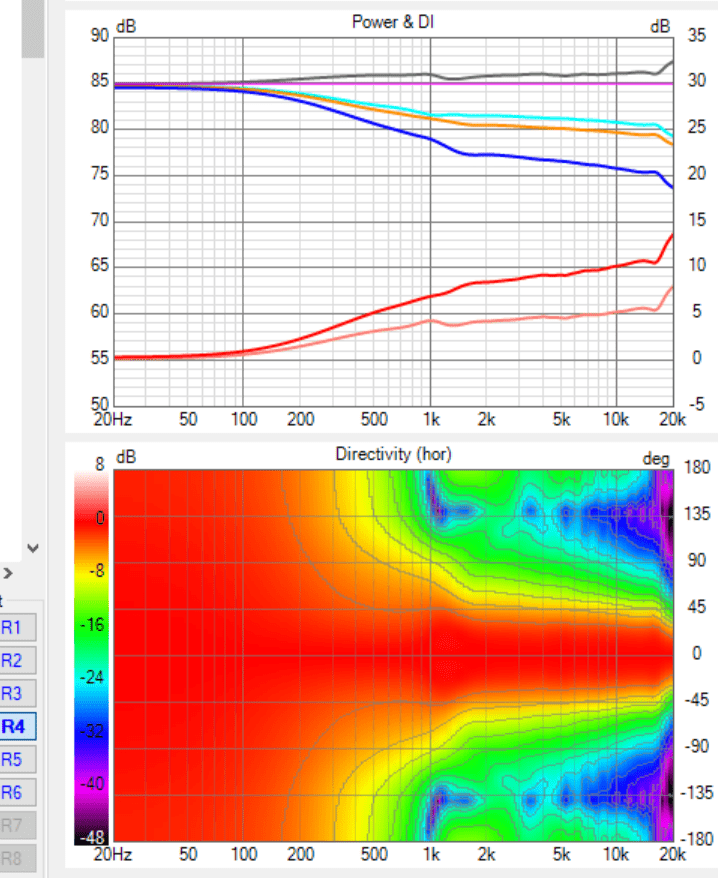

wondering if you could comment on this. Putting together a freestanding waveguide with a DE 360 on a 10? inch woofer. playing around it vituixcad to see if its going to make any sense.
I've just used a 4th order crossover to the 10 inch driver. simulated the directivity of the hypothetical 10 inch cabinat using the diffraction simulator. is there anything obvious that can be done better? crossover, woofer size, or the wg?
yeah i dont know if it can either. mine just arrived, so i'll test to see how low they can go at non PA levels. thanks for the input!I would use a 12" woofer and put the crossover frequency lower. Only not sure about the capabilities of the DE360 though.
Or in another words, for the DE360 and a 10" woofer you don't need waveguide that large.
