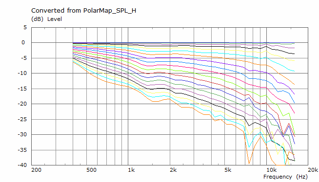

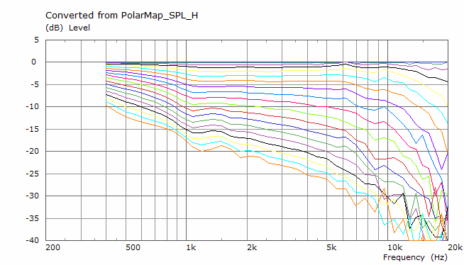

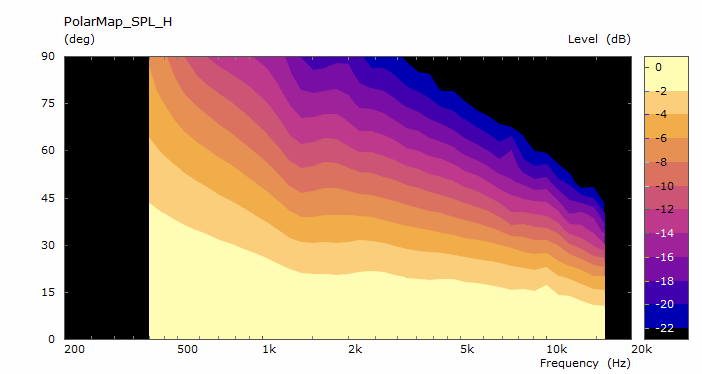

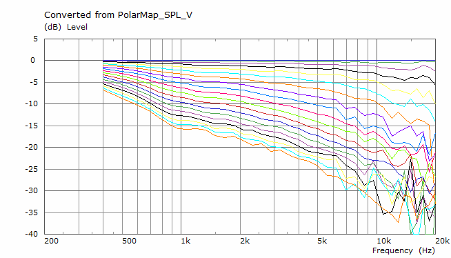

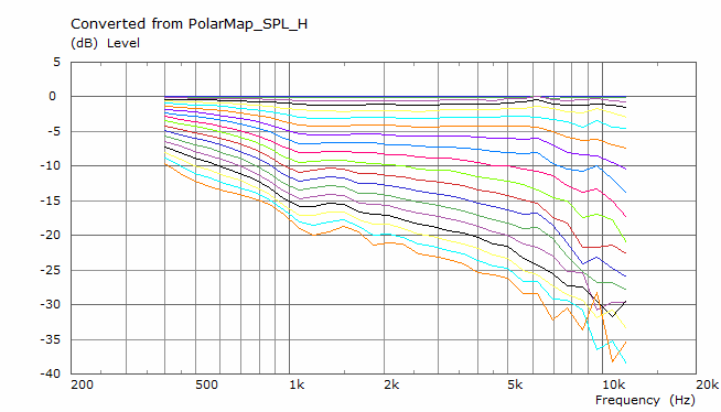

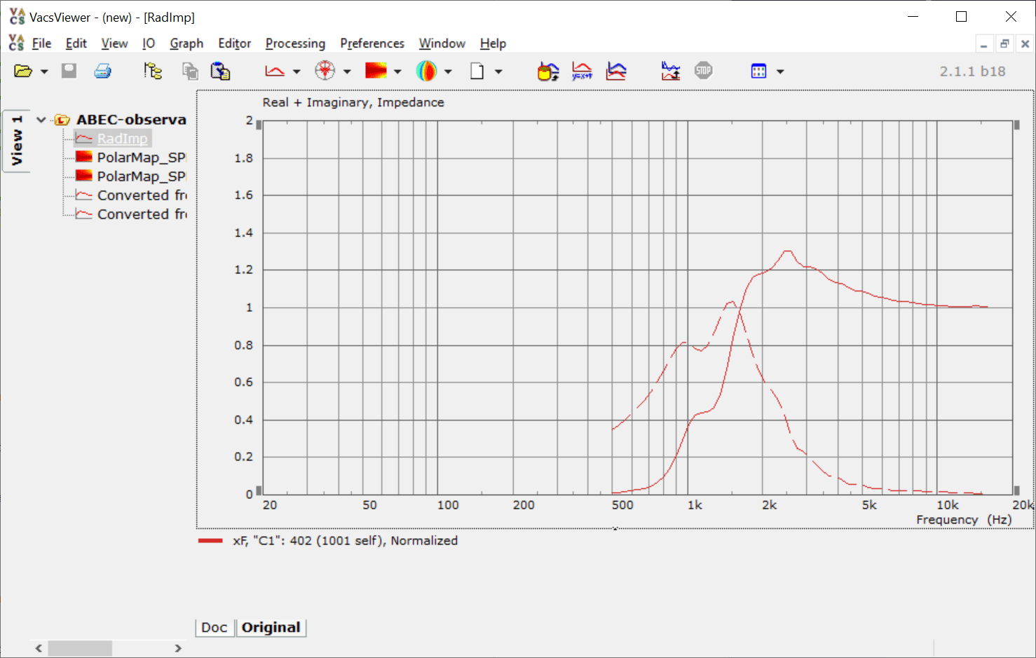

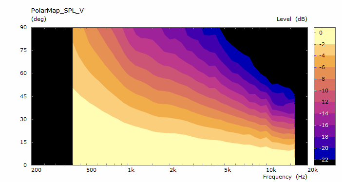

Axisymmetric/H (for the horizontal profile of the above shape):
View attachment 1048588 View attachment 1048589

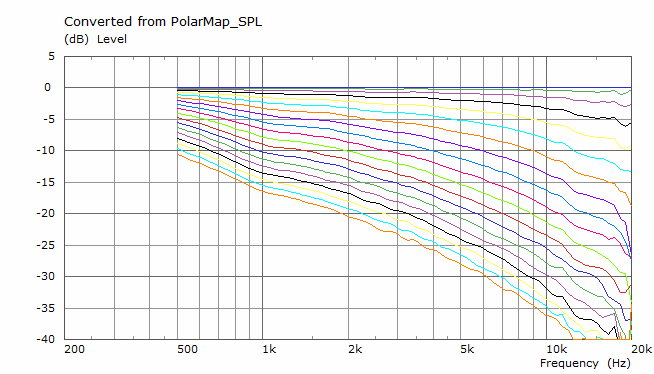

Axisymmetric/V:
View attachment 1048590 View attachment 1048591

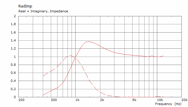

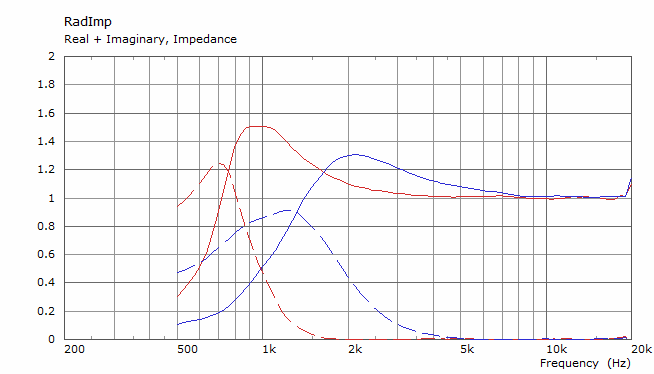

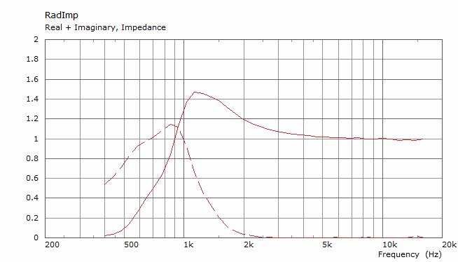

The throat impedances (blue=H, red=V):
It just allows (very easily) to blend these two together, nothing more, nothing less.
Thanks for these sims! The scripting sure is very powerful, kudos! Just need to figure out how to exploit this, it looks like mixing these two profiles makes mixed result as well, very cool.

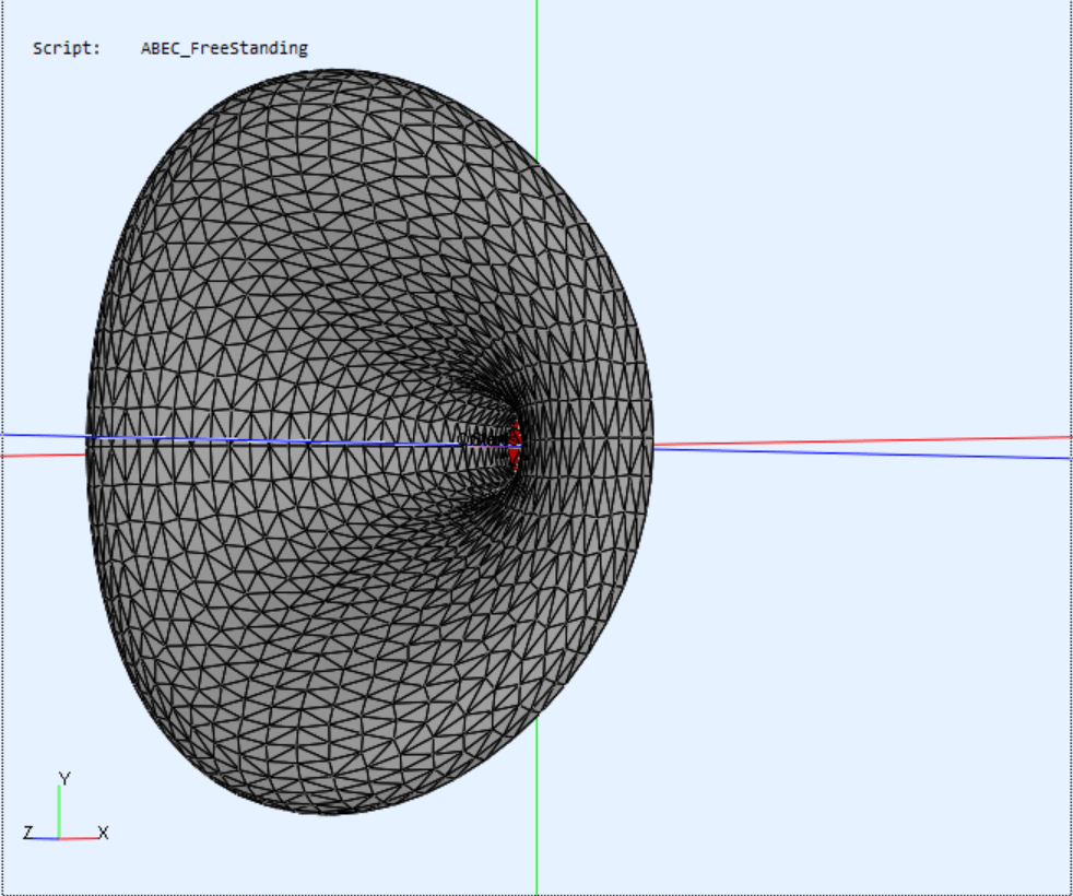

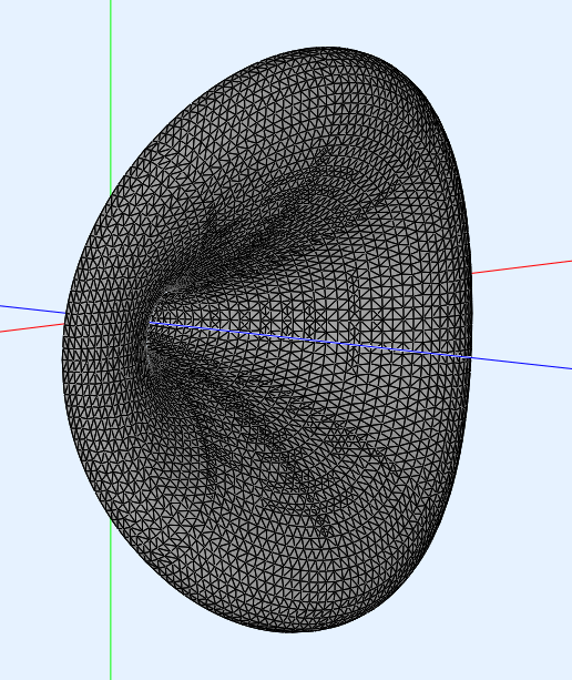

Not really.
Here's a sample and I believe it could be further improved, I only don't have the patience anymore for the 3D sims...
This originated just as a random illustration that the parameters can be changed freely around the horn. :)

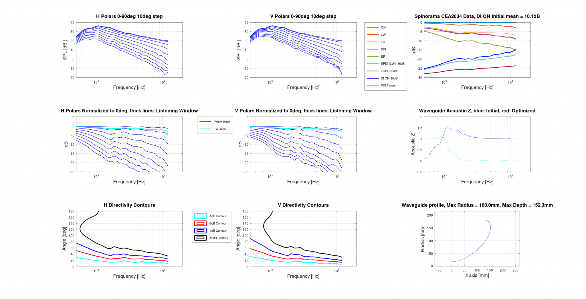

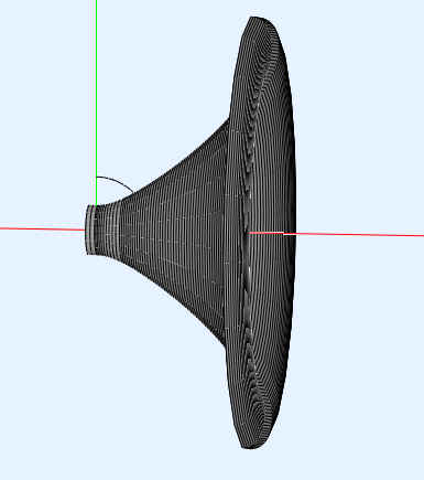

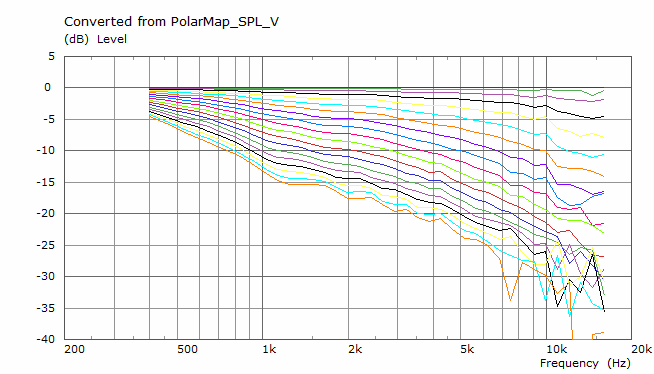

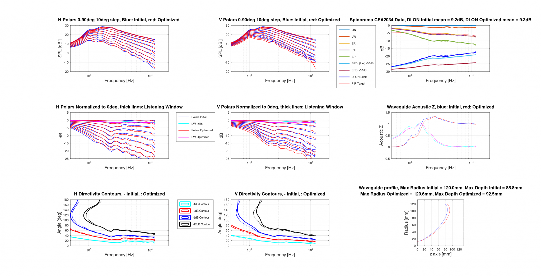

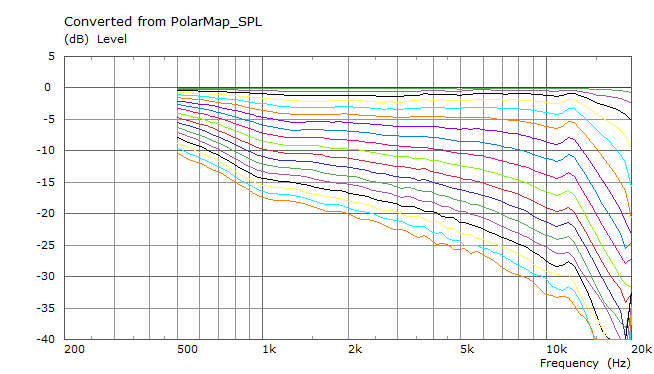

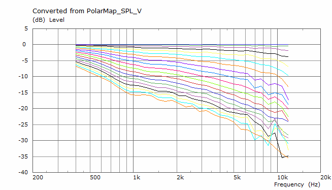

I ran my optimizer on this example just to look at assym. devices.
The domain was limited around the initial design for fair comparison.
1750 iterations, took about 12H over night...
Here is what I got:

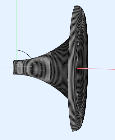

The device:
The parameters/
Code:
R-OSSE = {
  R  = 120.5872 ; [mm]
  a  = 34.4836 ; [deg]
  r0 = 12.7 ; [mm]
  a0 = 5 ; [deg]
  k  = 1.6226 + 3.4566*sin(p)^2.1429; []
  r  = 0.32683 ; []
  m  = 0.81285 ; []
  b  = 0.13157 ; []
  q  = 4.011 ; []
It seems that it has smoothed out a few things but the main irregularity 2300Hz for H and 2600Hz for V are not really improved.
What do you think?
Reactions: 1 user

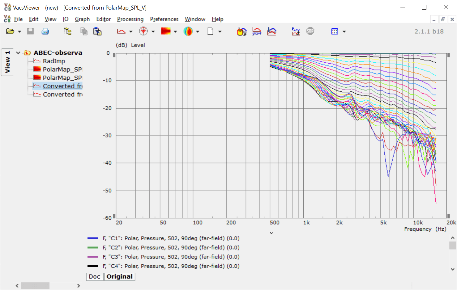

better with the graph:

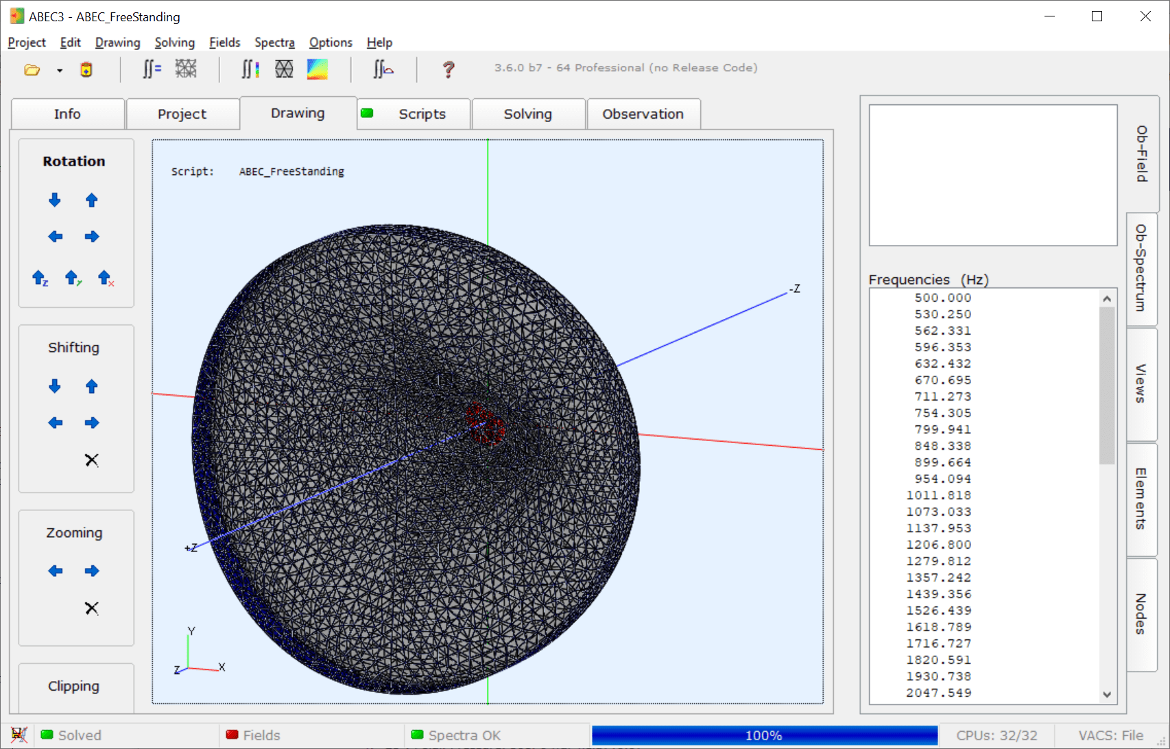

Perhaps I would suggest to solve a selected sample again with a considerably higher mesh resolution, otherwise you never know what's real and what's only a numerical issue. There's a chance it will go away.
Will do.
BTW, I forgot to mention that the latest version has some additional outputs (info: Running..., info: started... and Info: Reading....) that did not occur before.
Is there a way to mute them?
Joined 2004
What you could also try is to decrease the Mesh.SubdomainSlices by one or two (and perhaps decrease Mesh.InterfaceOffset then, only check that the interface doesn't intersects the WG). This changes the position and shape of the interface, which can have quite a strong effect on the result for a 3D model (which is unfortunate but there's probably no other way).
There's also an option to set Mesh.RearShape = 2. Once I tried to match an axisymmetric model with the same one in 3D and with this setting it was the closest, IIRC.
