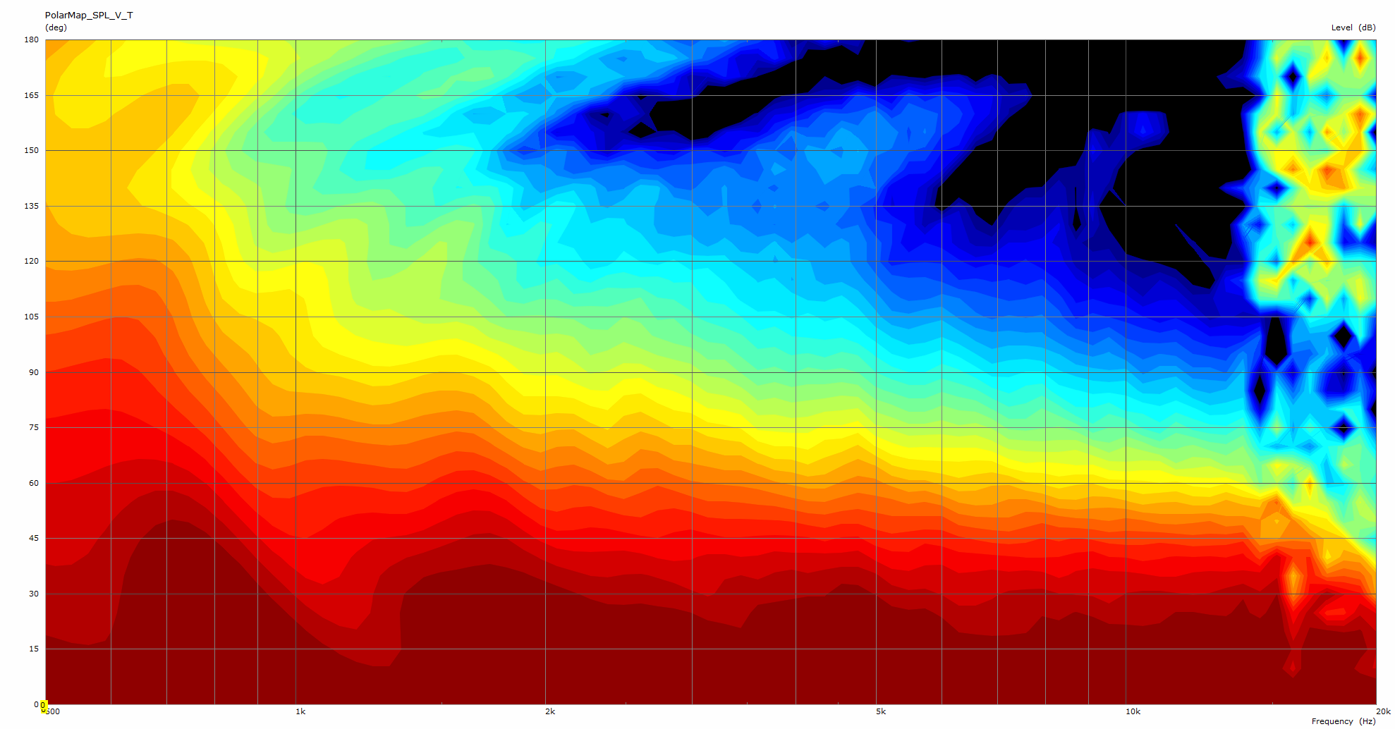

Why should this not be a real issue? It appears to happen most strongly on the far off-axis vertical angles, so the 'issue', whether it is due to inferior measuring or actually in the physics of the device, lies in the extended termination. Maybe it does act like a baffle, which due to its presense creates huge pressure differences that show up in the response elsewhere. The frequency area is fitting.
Of course it can be real. I only know from my experience that a 3D model is seldom as smooth as the same model in the CircSym mode (which has been confirmed by measurements many times) and it doesn't have to be an obvious numerical glitch but even something like this.
If we observed that it changes e.g. with a different interface, we would simply know that it can't be trusted.
I found that a halo that extended from the back of the termination to cover a larger volume forwards gave the result that was most similar to circsym.

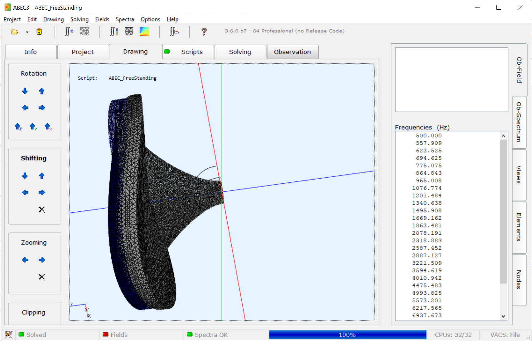

No matter what I do I still have the sameWhat you could also try is to decrease the Mesh.SubdomainSlices by one or two (and perhaps decrease Mesh.InterfaceOffset then, only check that the interface doesn't intersects the WG). This changes the position and shape of the interface, which can have quite a strong effect on the result for a 3D model (which is unfortunate but there's probably no other way).
There's also an option to set Mesh.RearShape = 2. Once I tried to match an axisymmetric model with the same one in 3D and with this setting it was the closest, IIRC.
Mesh.RearShape = 2 seems to helps for the V plan.
V
H
Z=
maiky, fluid's interface was going all around the back of termination.

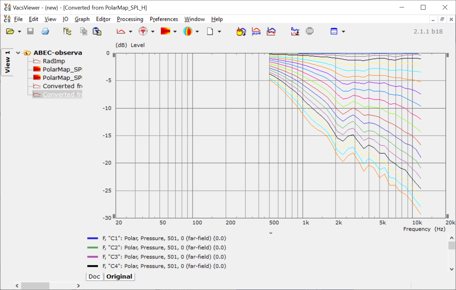

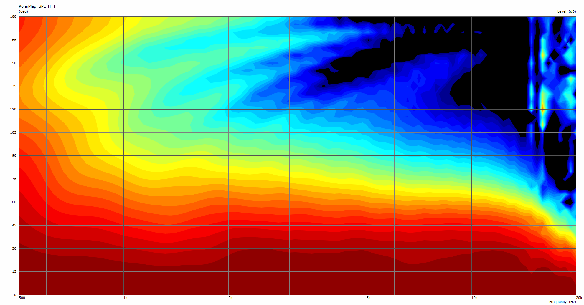

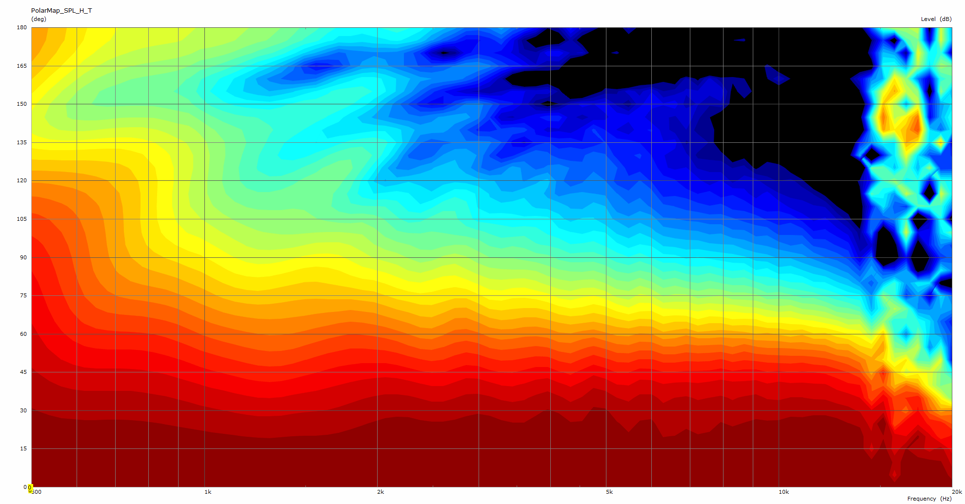

Here is another puzzle: The baffled waveguide I was working on shows issues in a full enclosure, and as can be seen here https://www.diyaudio.com/community/...708-ish-dimensioned-2-way.377634/post-7004835, this is also visible in DI plots. This vertical issues also bleed through to horizontal.
So I wanted to see if I could optimize in quarter sym, and there the issue is not even present. What can be seen is the same waveguide, the rugged plot stems from a full enclosure simulation with 150 frequencies, the clean from a quarter sym with 100 frequencies, everything else being equal. The full enclosure plot is for the vertical up-axis and edge distances and rounding are identical with the quarter sym:
1/2
1/4

Yes, -30 to 0 db, 1 dB increments, normalized to on-axis.
The deep notch that rips through the pattern right above 1k makes it much harder to get a smooth crossover: either, energy is missing around 1k, or excessive energy, especially off-axis, develops between 1.6 and 2k. I would like to understand the cause of this and if it can be corrected.
Is it purely the box below?

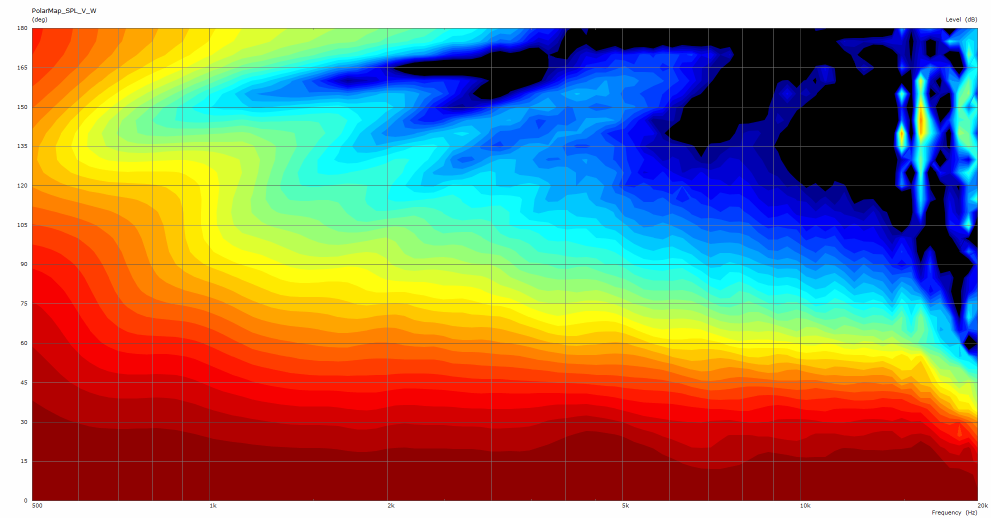

Here is the same for horizontal. The vertical bleeds through.
1/2
1/4
So here is one question: At 500 Hz, one can see in the far off-axis angles reduced pressure, that is kind of shifted towards middle angles sligthly higher, bulging up and probably creating the accentuated diffraction dip. What is causing the reduced pressure in far off-axis angles, in 1/2 symmetry compared to 1/4?
1/2
![WG 180 Hor.png WG 180 Hor.png](https://www.diyaudio.com/community/data/attachments/956/956928-65ed470093bf4424d90fea16326d29b1.jpg)
1/4
![WG 180 Hor_quarter.png WG 180 Hor_quarter.png](https://www.diyaudio.com/community/data/attachments/956/956929-1b92b0e93ea837c1f3af8c8139a7b9b5.jpg)
I think you are paying too much attention to the simulation at this point. With real transducers it will be different anyway. Simulation can prove concepts, show a rough guideline what might be a good idea but not the details at this level...The deep notch that rips through the pattern right above 1k makes it much harder to get a smooth crossover: [...]

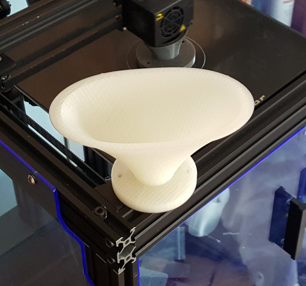

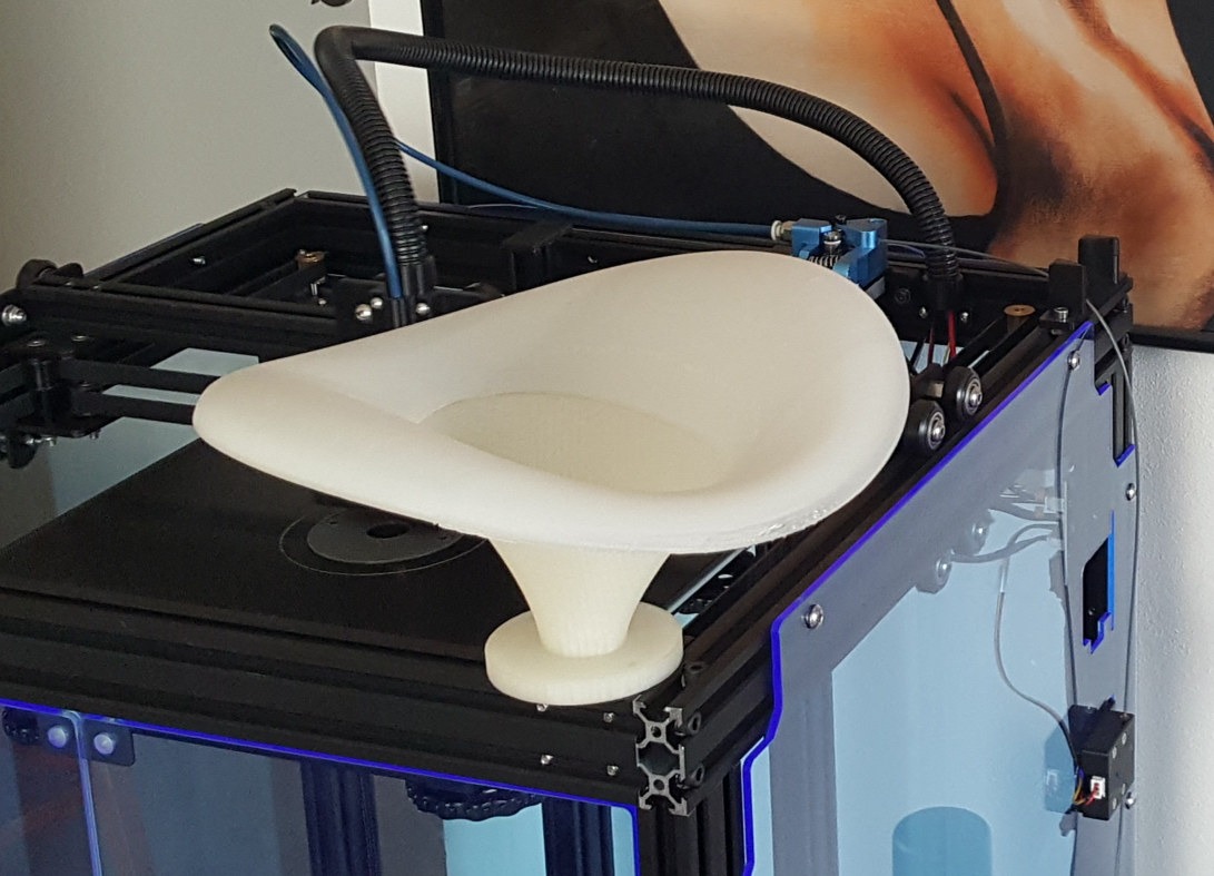

There seem to be many versions of the Scotch-Weld - which one are you using?Regarding the glue, I have the 3M Scotch-Weld, a few drops are more than enough...![]()
I think is was PR100 but only becaue I had it at hand, it absolutely doesn't matter, IMO, you could as well use the cheapest one you find anywhere. I would only strongly recommend to think twice about the glue and the technique - the CA requires really a lot of careful work (depending on what you want to do).

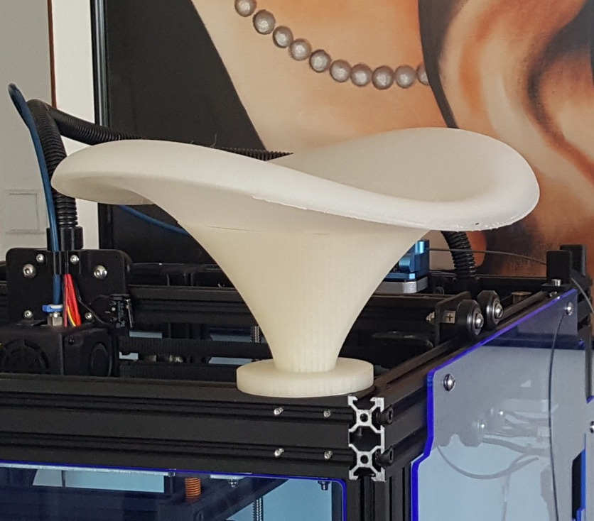

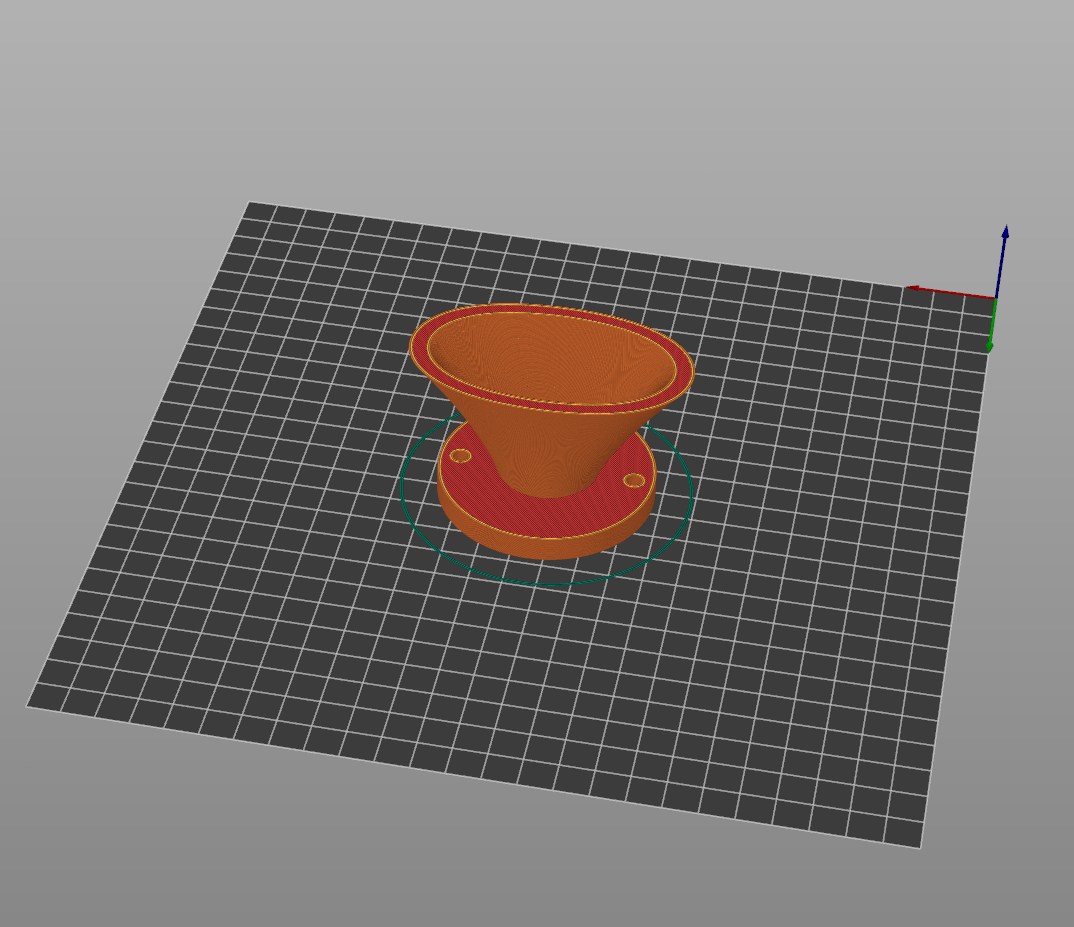

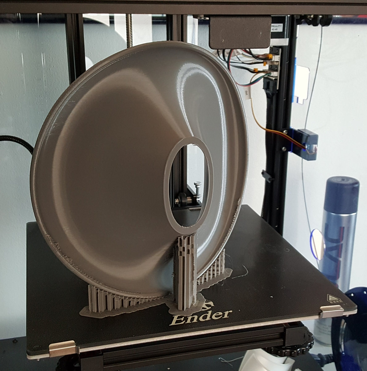

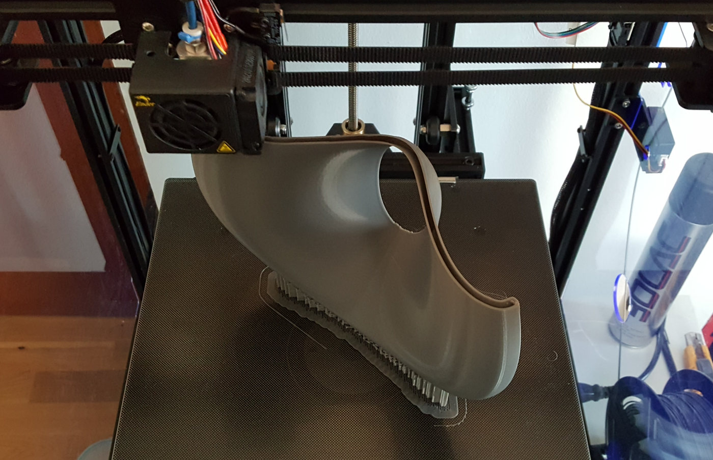

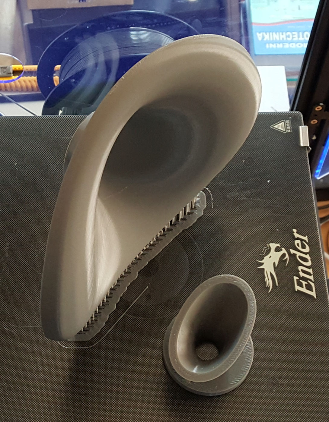

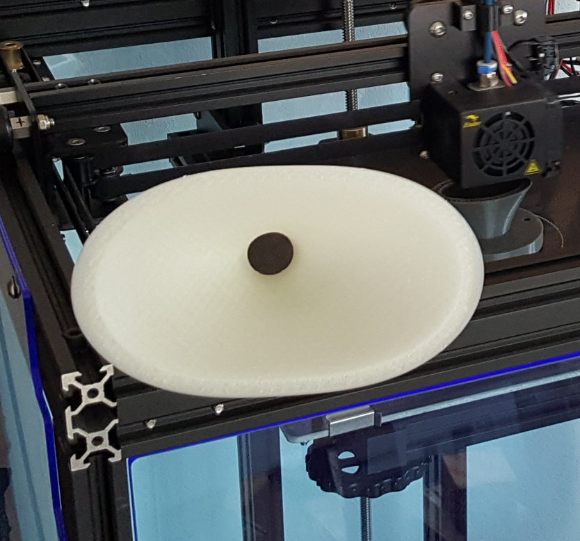

- BTW, it's no problem to print it like this. I guess it would be as well possible to print the whole WG as one piece, it would only take much more time. As usual, I print the mouth part hollow (two 0.6mm perimeters), there's no problem with that.
I'll prepare a 1" version, something like the ST260 / ⌀260 mm. That still fits the volume of Ender 6.
