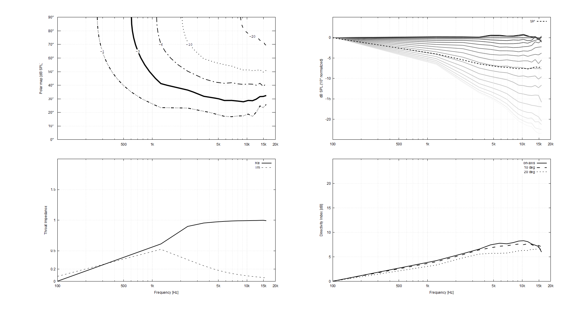

No problem. Would be my pleasure!limacon - it would be very interesting to see measured polars on this - just maybe 15, 30 and 45...
AT LFs it should be straight, a tube, no angle at all. But then as the diaphragm begins to be non-rigid, there is no scientific optimal. It just becomes a mess.Is there a scientific way to determine the optimum exit angle paramenter for a full range direct radiator?

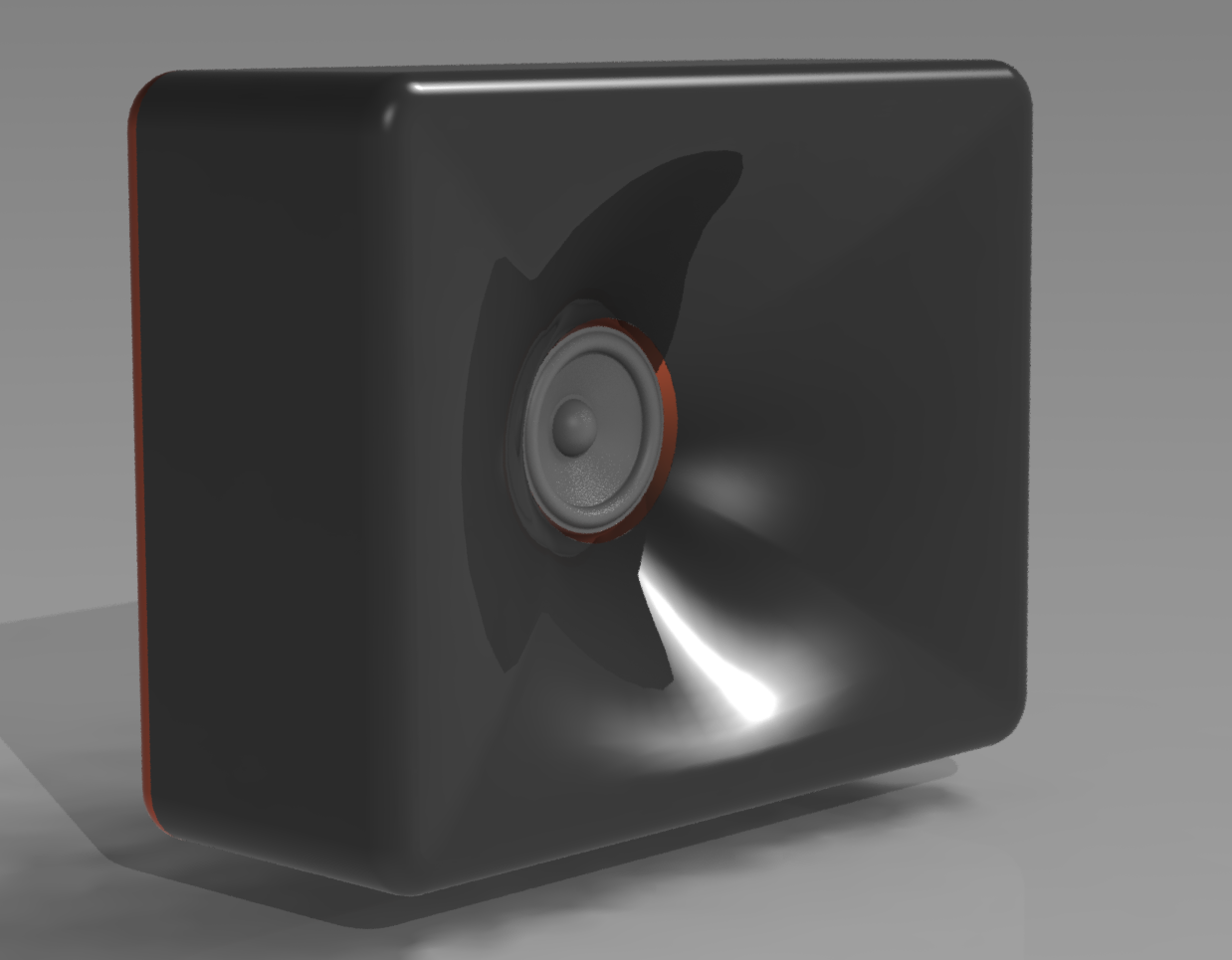

Gloss black with a copper coloured driver mount / inlay , and copper back. Only possible with Ath4!
I cannot stop thinking how nice a coaxial mid would be, with a paper cone profile according to an osse-formula and a compression driver. Insert in into a fitted waveguide, and there it is, the perfect three way.

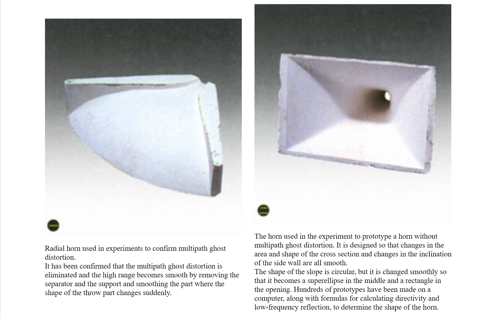

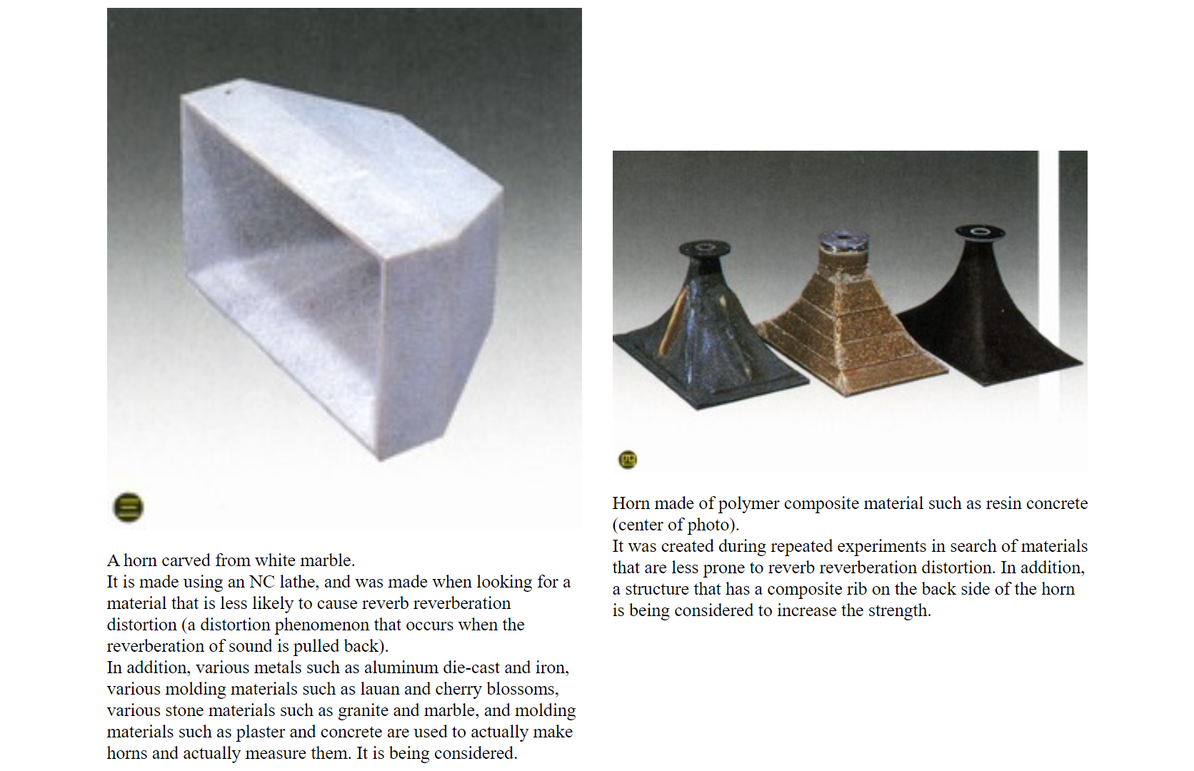

The horn is an 'optimized' radial design. Not much data available.

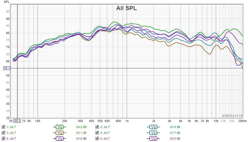

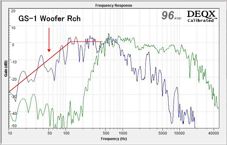

In room response:
In room response:

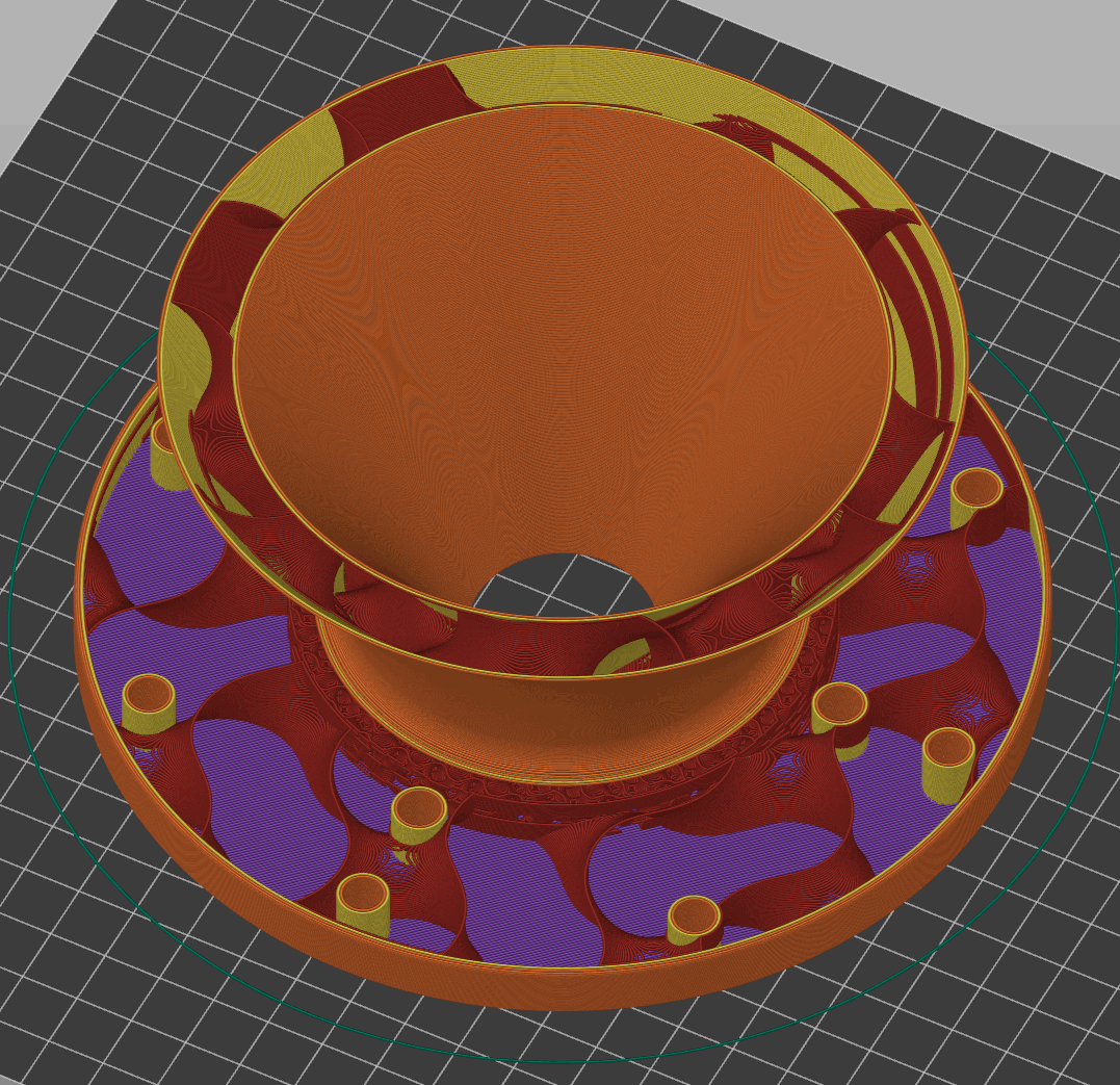

slowly proceeding and did first few sims using ath.
anyway: need a clear design target! 2 way with widest possible coverage by compression driver/horn.
