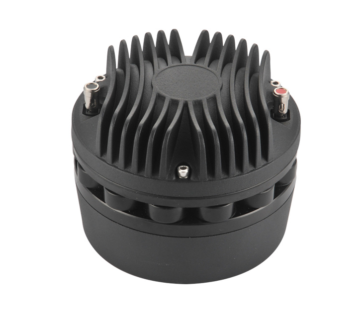

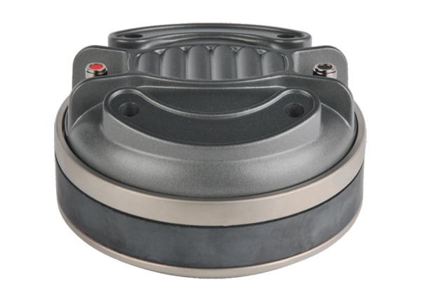

"The Chinese friends" offered me some drivers for evaluation, but I had to magnetize those myself. Unfortunately they didn't bring "their big guns", like those attached.
The 18Sound clone is sold under DS18 moniker with pure Titanium diaphragm, but it's also available with a Composite Aluminum diaphragm.
The grey one is more or less similar to the Denovo Audio BA-750, sold by diysoundgroup.
