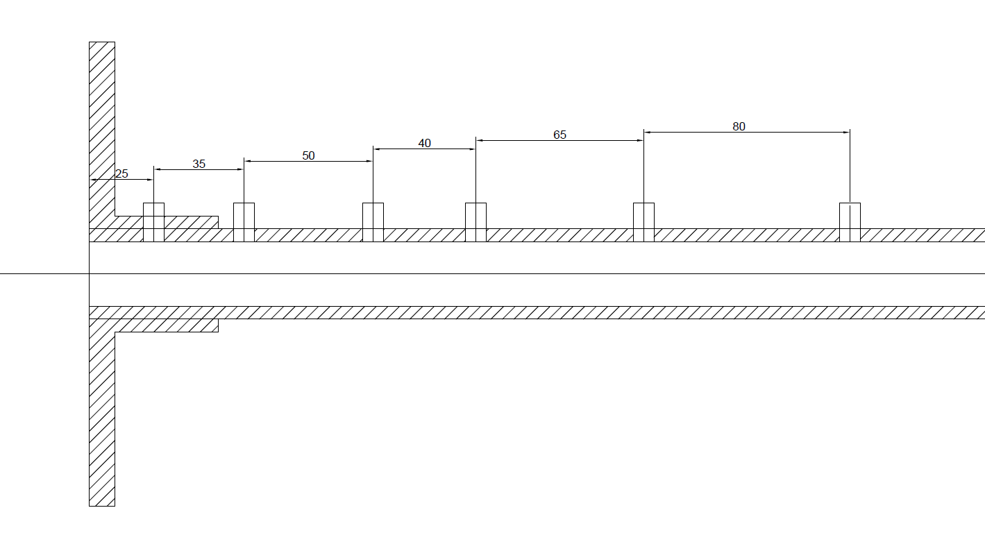

... Just need to space the mic ports along the tube, probably in some random, certainly not equal, spacing. How many is up to you and your computational capacity.
Would this be OK?
(There are parts still missing in the drawing. This is only for the port spacing now.)
- Nah, now I see it's not very good. It's hard! I think I will really run a random generator and pick the one I like.

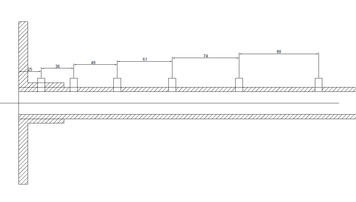

Questions, still -
1) What rotations (the angles) of the driver will be necessary?
2) How critical is the first port distance from the tube beginning? I'm asking because if shifted more down the tube it would easily allow for a free rotation of the whole mounting flange without a need to re-mount the driver. Otherwise the rotation will be not so effortless.
3) Is the closer spacing at the beginning intentional, i.e. would it be worse if reversed?
There can be issues with close locations because of near-field effects (which can cause numerical instability,) so moving further back is not a problem. Rotating the driver on the mount can add data and find non-axisymmetric modes. I'm not sure if my math has that possibility, but it's not a difficult extension.

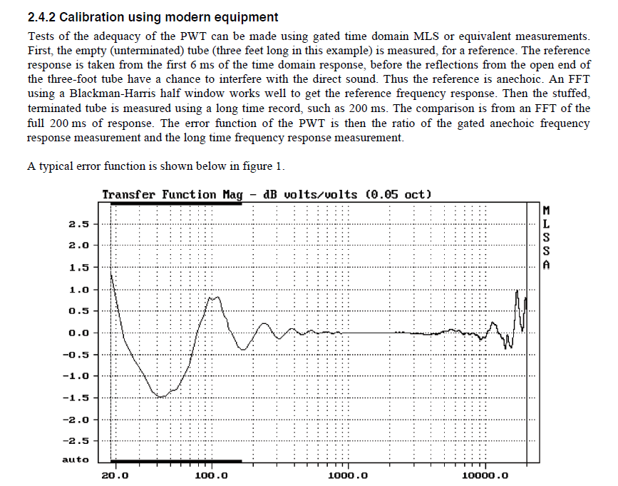

As to using gated measurements, I have always thought that should be possible, but honestly I don;t know anyone who has tried that.
I thought that prof. Merhaut demonstrated that years ago but after I looked at his paper* again I see he in fact used short pulses as test signals (and then gated FFT). It was in 1985 so I wonder if it was because of the lack of todays techniques (MLSSA came in 1987, IIRC) or because it was so obvious to him that it would be wrong (but then I think he would mention that).
Is it really so different from making gated measurements of a speaker in a room?
* Impulse Measurement on Horn-Type Loudspeaker Drivers, Josef Merhaut (Vol. 34, pp. 245-254 [1986 April]); and more in Vol. 35, pp. 144-145
(Also in Loudspeakers anthology, Volume 4)
On the other hand, in the AES "Design and Practice" document, there is a calibration procedure using gated MLS presented as evident thing (see below).
