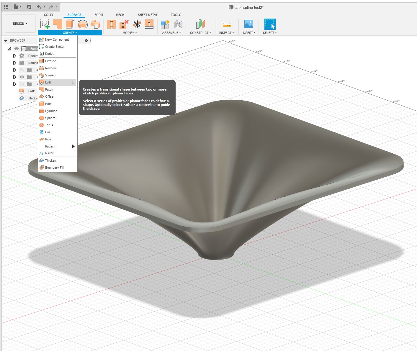

Go to SURFACE workspace, from CREATE menu select LOFT.
Choose the splines from bottom to top, one by one, in the right order. This creates a surface shape via these curves. Be sure not to choose a point along the line, but the whole line. It turns dark blue when you are in the right spot for selection.
After choosing the last click OK.
Then choose the new loft from the component tree, open CREATE menu again and choose THICKEN. Add the thickness you want to outside of the model.

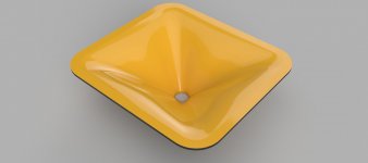

Job done. Now i got 6mm thick solid horn which i can further work with to add mounting holes, driver mounting flange etc.

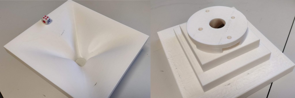

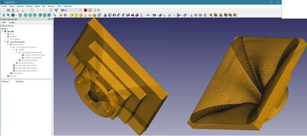

Anyway, I'am using Freecad to prepare real 3D model for manufacturing (3D print, CNC...).
It's quite simple: import STL, convert to mesh, convert mesh to solid and then use boolean operations with another solids to create flange, mounting holes etc....

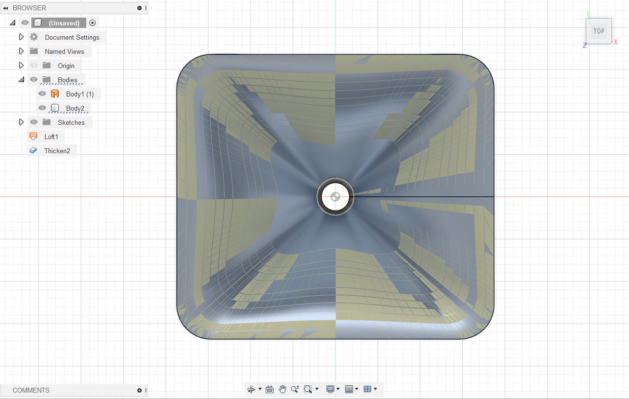

The other thing I found was that the original surface and the thickened one were not exactly the same when overlaid.

Do you mean the original STL and the "lofted" one from the splines? That's what needs to be checked of course. The two might be slightly different, that's almost expected - that's where some perpendicular guide curves may help. I will let the user export those as well.The other thing I found was that the original surface and the thickened one were not exactly the same when overlaid.
No that was the difference between the lofted splines and a thickened version of lofted splines, I didn't have the mesh version of that waveguide to compare to. If you can point me to the configuration or an stl model I can overlay them and see if there are any differences.
