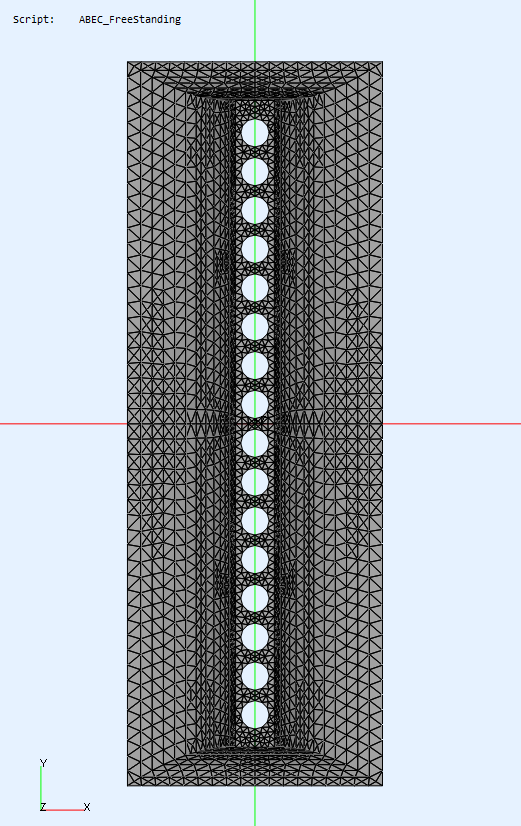

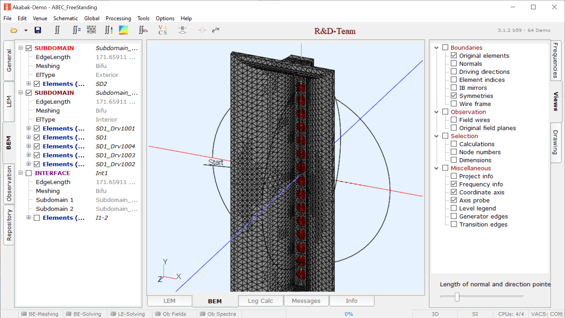

As for the CBT, you got me thinking and it's pretty easy to implement a source array with each source individually shaded (i.e. level or delay controlled). Now I still need to devise a way to bend the whole structure (forming an arc, as it should be), that shouldn't be difficult. This will be a nice feature to have.
That’s amazing!!!As for the CBT, you got me thinking and it's pretty easy to implement a source array with each source individually shaded (i.e. level or delay controlled). Now I still need to devise a way to bend the whole structure (forming an arc, as it should be), that shouldn't be difficult. This will be a nice feature to have.

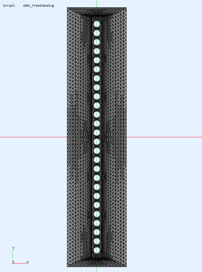

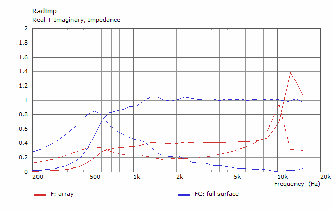

Your rapid progress never ceases to amaze!BTW, this is already a comparison of a uniform array vs "full-rectangle" driven. Does it make any sense?
beta version available ?I've always wanted to try something like this myself.
View attachment 1108440 View attachment 1108441

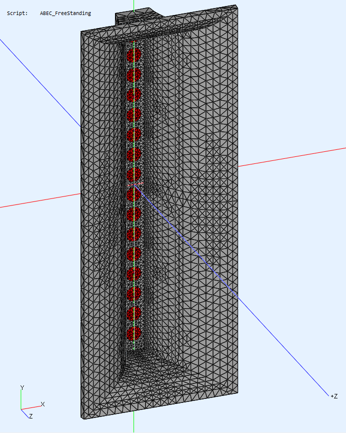

Two examples attached. You can export FRD data for the individial array groups and than work with that in any crossover simulator (see array1.txt demo). Or you can also work within ABEC manually on the script level (the most simple is to overwrite individual levels and/or delays in observation.txt).
