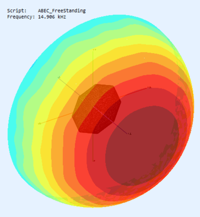

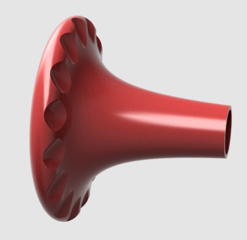

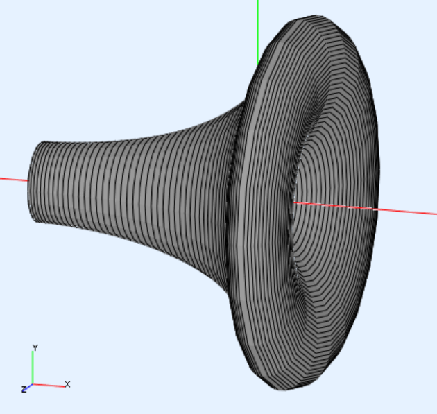

Something like this would probably help to break the last tiny bit of diffraction around 9 kHz on-axis.
(See https://www.diyaudio.com/community/...-design-the-easy-way-ath4.338806/post-7228070)
I'm still only not sure about the looks...

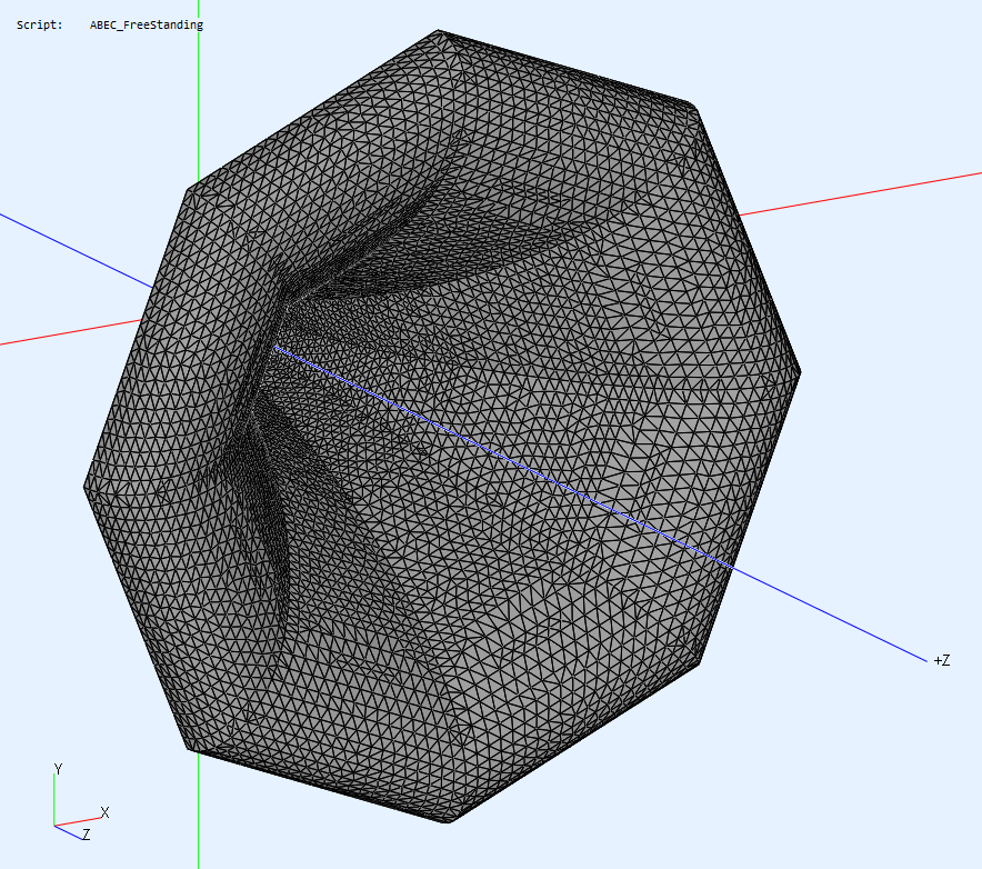

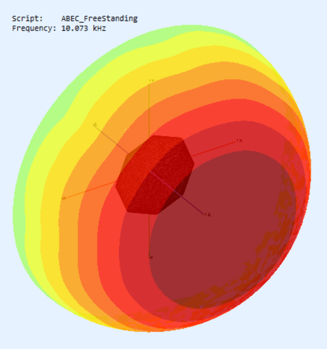

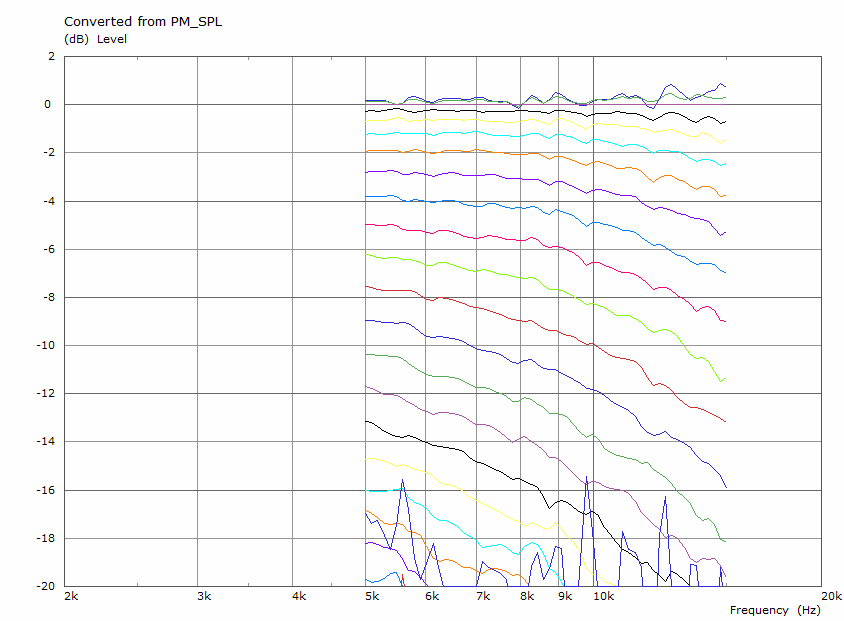

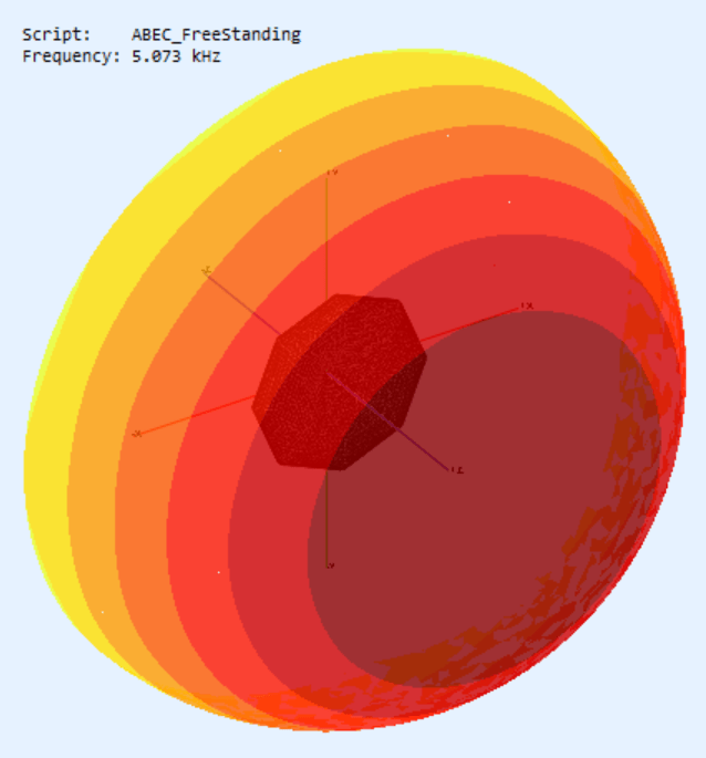

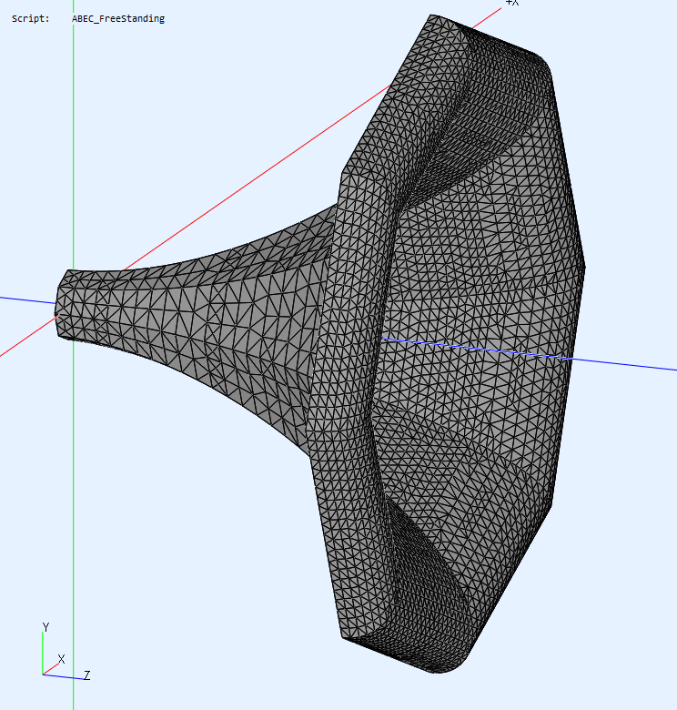

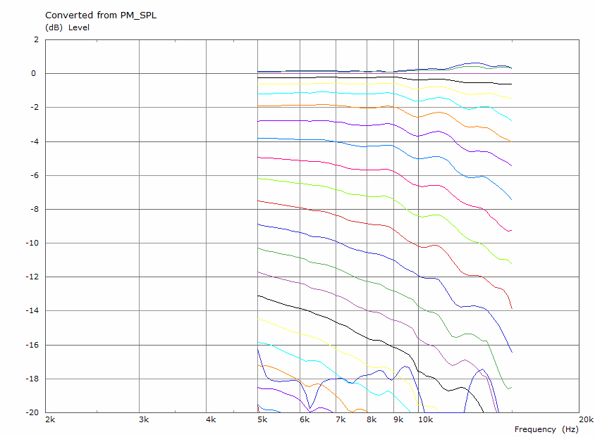

I accidentally generated the WG as octagonal (Mesh.AngularSegments = 8), so I let it solve.
It's without the rear cover (not implemented in 3D yet) so it's a bit different overall but otherwise it's very smooth. I've always wanted to try the effect of the discrete angular segments and it seems to be a perfectly fine approach...

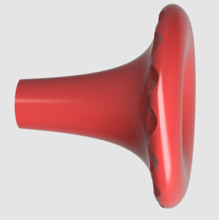

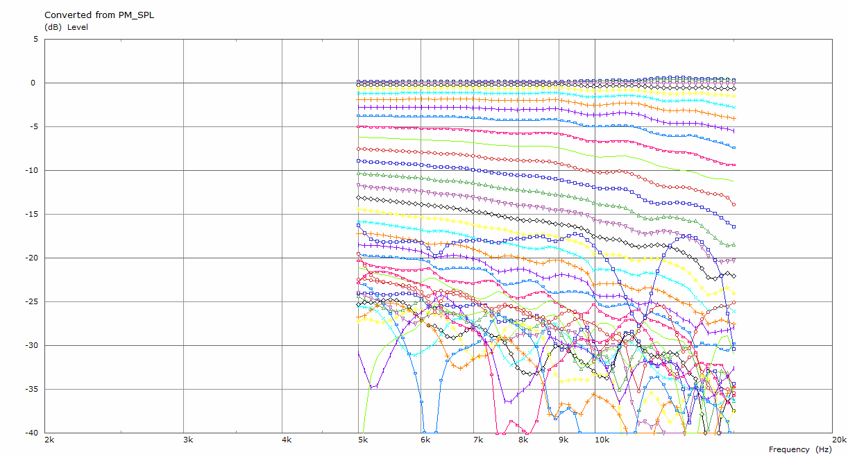

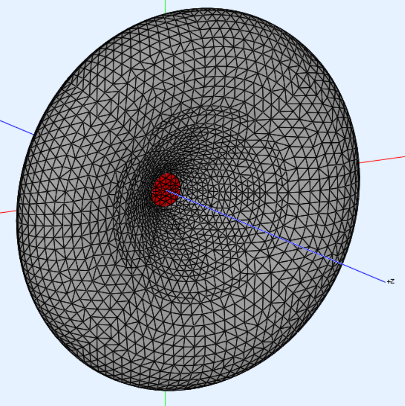

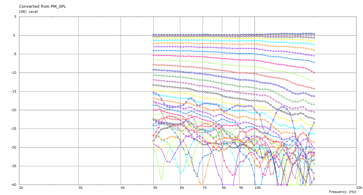

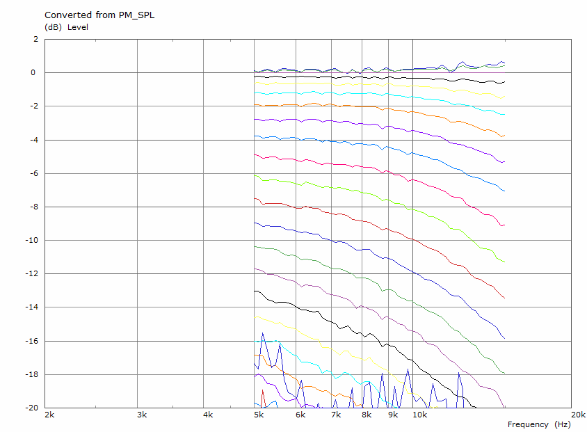

This is with the rear cover in CircSym mode (no smoothing applied neither in the above graphs nor this one):
Typically the CircSym mode gives smoother results than a full 3D mesh. I'm not sure it's the case here.

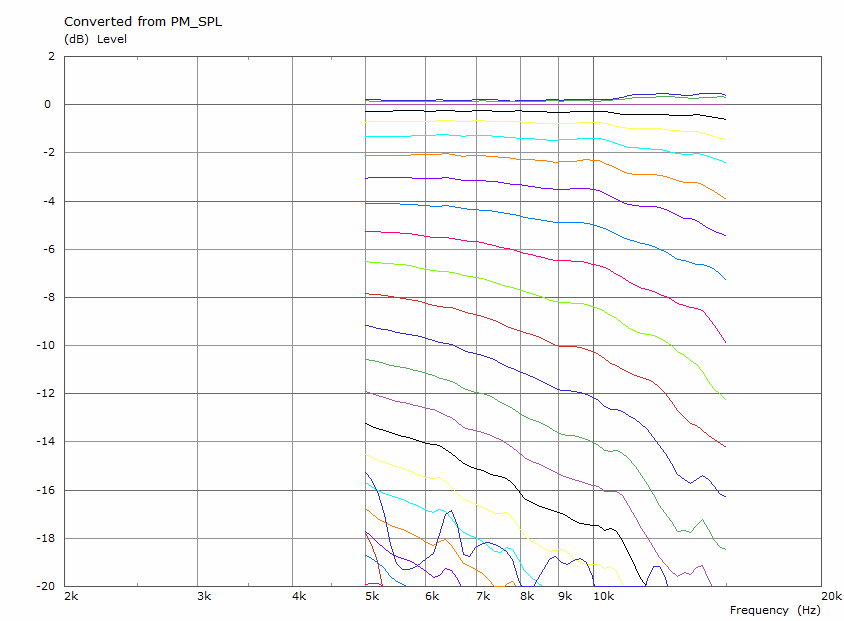

And solved with a higer resolution mesh:
Seems a bit erratic, so probably mostly numeric noise, probably will be also quite smooth.

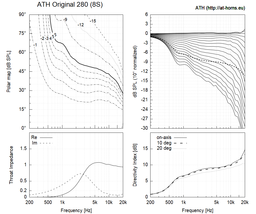

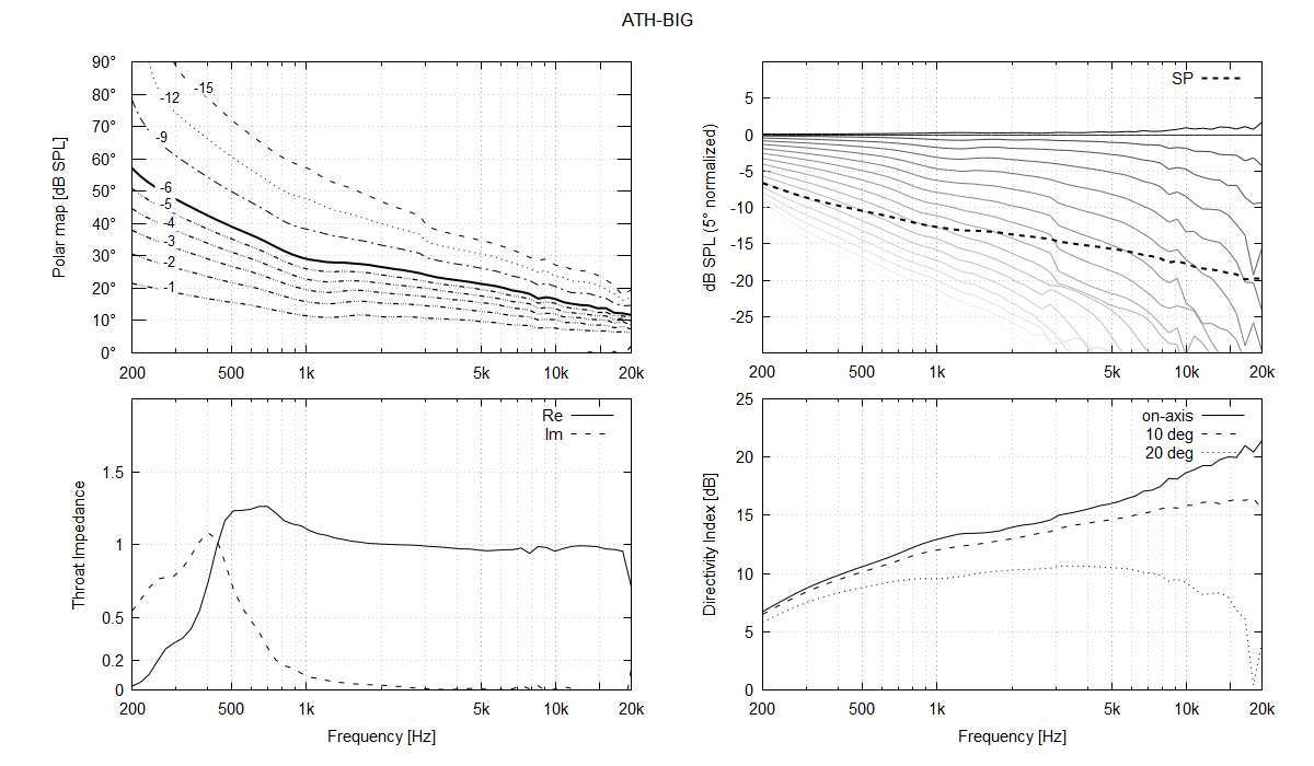

Maybe this could have some appeal after all, especially due the relative ease of manufacturing.
This is for a 2" throat, just a quick R-OSSE sketch, approx ø600 x 400 mm -
The DI rises (~10° would be probably the best listening axis), but due to the big size it's not so terrible in absolute numbers - thanks to the overall narrow beamwidth the power response doesn't fall as rapidly as I would assume intuitively.
