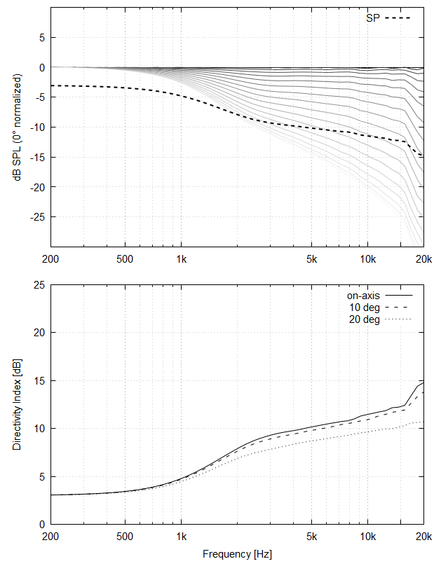

I thought about how to explain the notion intuitively even to those non-mathematically inclined and here's an attempt.
It still takes some maths, but very very little -
Take it as a fact for now that the total radiated power is represented by a sum of some values. These values (p1, p2, p3) correspond to SPL in different directions from the source (at some distance which we assume is large enough):
sum = p1 + p2 + p3
The key moment is the fact that if we calculate an average of these values:
p = average(p1, p2, p3),
the sum doesn't change if we substitute all the original values with the average:
sum = p + p + p
You see that for the same total radiated power (the same sum), we can imagine a source generating the same (average) SPL in all the directions.

Yes.
This is exactly what you do in the SP_calc calculation. And the same as I do in Ath to show the "SP" curve. The result is a dB SPL curve, an equivalent omnidirectional SPL corresponding to the total radiated energy (which is the sum of the weighted squares, and to "convert it back to dB" means to make a square root (->pressure) and a logarithm (->dB) of that).[...] the final curve must be computed from sound pressures, converted from dB SPL, which are squared, weighted, summed and then converted back to dB.
This is an unnecessarily complicated formulation, but it's also commonly true (but only for an acoustic monopole - that's a catch). Clearly there are better formulations.The result could be expressed in acoustic watts, the true measure of sound power, but here is left as a frequency- response curve having the same shape and normalized to the other curves at low frequencies. [...]
The problem with measuring acoustic power response is similar to measuring energy or power in many other situations... It is rarely possible to directly measure energy or power. We almost always have to measure other things (distance, time, temperature, force, voltage, current, pressure, velocity), and then infer the quantity of energy or power based on the appropriate mathematical relationship.
Often times the power or energy of a device or process is expressed as an equivalent measurand which is neither energy nor power, but a unit which is directly related to energy. The energy storage capacity of a battery is expressed as amp-hours, rather than as joules. The power rating of industrial cooling machines is often expressed as "tons"... a 50 ton chiller has the same cooling capacity (energy transfer power) as melting 50 tons of ice over a 24 hour period. So here we express energy in terms of mass (how strange!).
The acoustic power response radiating through an imaginary spherical surface surrounding the loudspeaker is bulk quantity... it is averaged over the whole surface. For convenience, this averaged power is expressed in terms of the equivalent dB SPL. But if you measured the response of the DUT with a mic (i.e. measuring pressure), you can not directly measure the power response. No axis corresponds to the power response... unless the DUT happens to be perfectly omnidirectional.

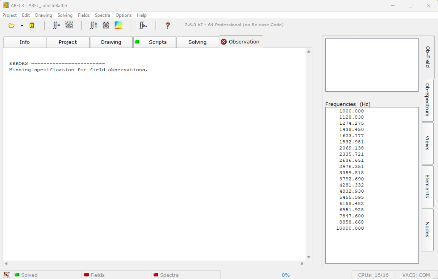

I've been lurking here for a few weeks now. ATH seems like an amazing tool to develop state-of-the-art waveguides.
Last week I tried to install ATH myself. I'm no software genius and it took me quite some time to get it up and running. I managed to run demo1 and generate a graph with VACS. Then I managed to make some small changes to the script op demo1 and I got a second set of graphs out of the combined software.
But yesterday and today I keep running into an issue. I can run the Boundary Element Solver, but after that, I can't calculate the 'fields at observation stage' and I can't plot the graphs. Does anyone know what this might be?

There are no observations set that ABEC recognizes. There is an Observation.txt file that contains the observation code something has gone wrong to make that not work.I can't calculate the 'fields at observation stage' and I can't plot the graphs. Does anyone know what this might be?
Try the ST260 ABEC Project from mabat's website
http://www.at-horns.eu/release/ST260-ABEC_project.zip
Why? Because that is the most sensible interpretation of the power response (equivalent SPL) curve I'm aware of.Mabat - I don't know why you say "it's a pressure generated by an omnidirectional source radiating that total power." Why omni source - the measure certainly don't require an omni source DUT. The measurement (probe) however needs to be "omni".
You probably want to calculate spectra, not fields Hit F7 after the mesh was solved.But yesterday and today I keep running into an issue. I can run the Boundary Element Solver, but after that, I can't calculate the 'fields at observation stage' and I can't plot the graphs. Does anyone know what this might be?
Don't forget to 'Save results to txt' from the same 'Spectra' menu, if you want to evaluate your simulated waveguide via the Ath report, which is generally much more straight forward at early design stages than VACS. Press ctrl + F7 after the spectra solved.
BTW, here's a "fixed" calculation of the pressure weights, to give the expected values even for an infinite baffle.

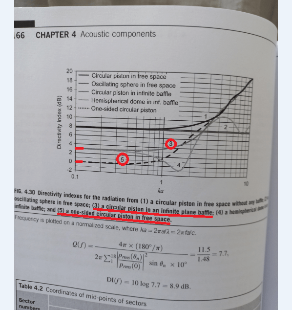

So obviously, it's not true what David McBean claimed. Just to be clear on that.
The DI is equal to the difference between the pressure response and the power response in all cases.
Just to clarify - For the case of a circular piston in an infinite plane baffle, and as a result of the "fixes" you have made, are you now in effect taking the DI as shown by trace 3 below, and adding that to the full-space power response to obtain the baffled piston's half-space pressure response?
If anyone wanted to check, here's a calculation of the power response for an infinite baffle case with 19 angles: 0 - 90 / 5deg
SPL_power_response = 10*log10(1/pref^2 * (w[0]*p[0]^2 + w[1]*p[1]^2 + ... + w[18]*p[18]^2))
Weights w[0] .. w[18]:
0.000476, 0.003802, 0.007574, 0.011290, 0.014919, 0.018434, 0.021810, 0.025019, 0.028038, 0.030844
0.033414, 0.035731, 0.037775, 0.039533, 0.040989, 0.042133, 0.042957 ,0.043453 ,0.021810
This power response is a frequency response (as dB SPL) of an omnidirectional source radiating the same total power as the DUT.
So if you want to calculate a DI, subtract this power response from a selected SPL response.
