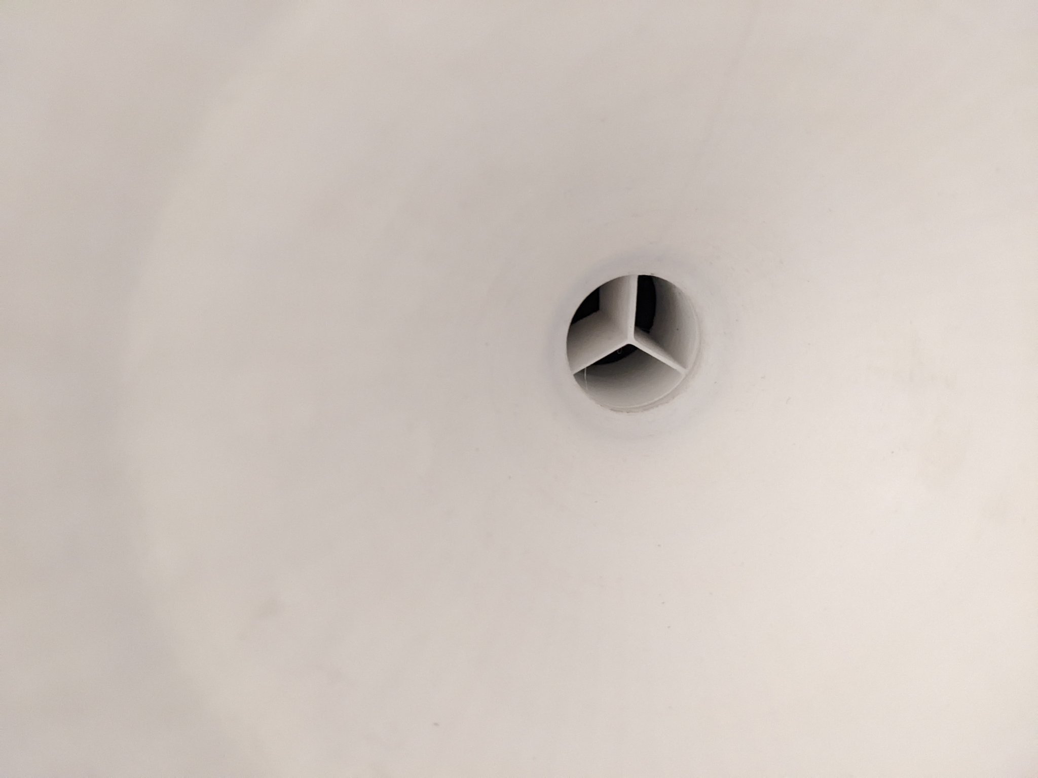

Make it a Trivial Pursuit plug? (when viewed from head on, at least)
This appears almost as the Mercedes Benz logo. In the peace sign the vertical bar would have to continue across the whole diameter ☮.

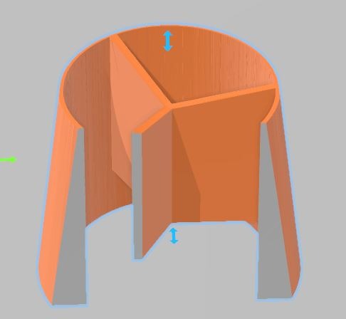

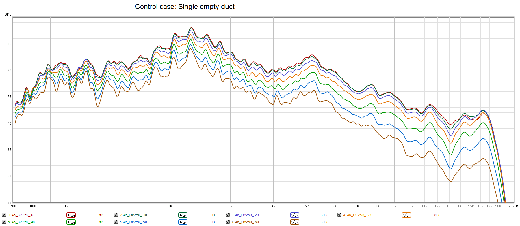

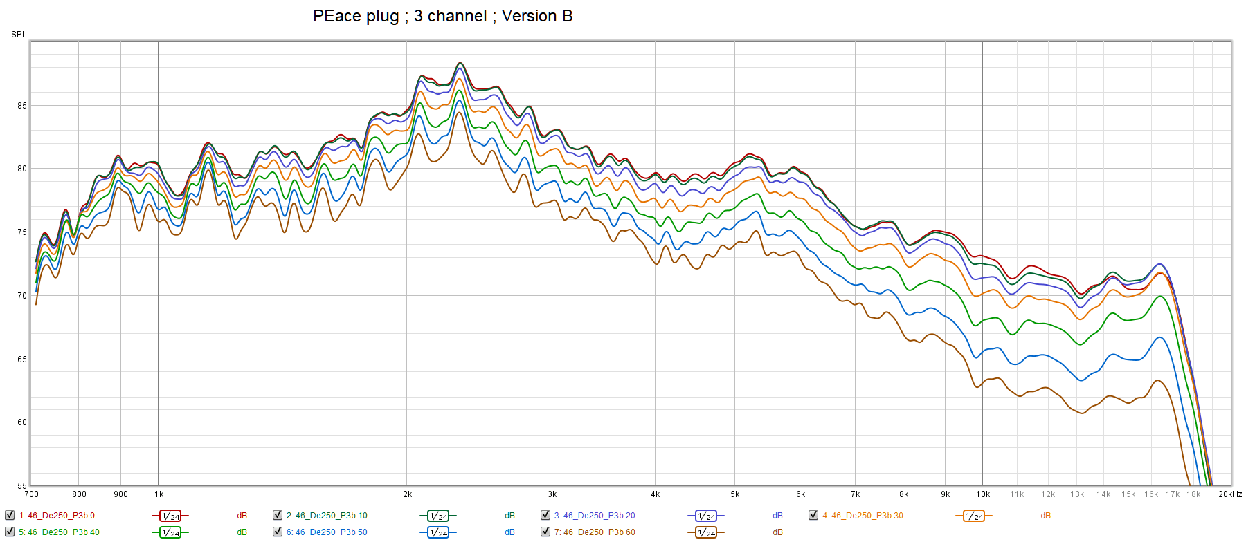

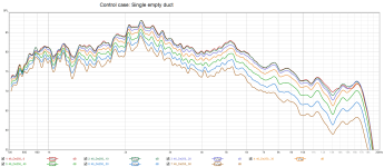

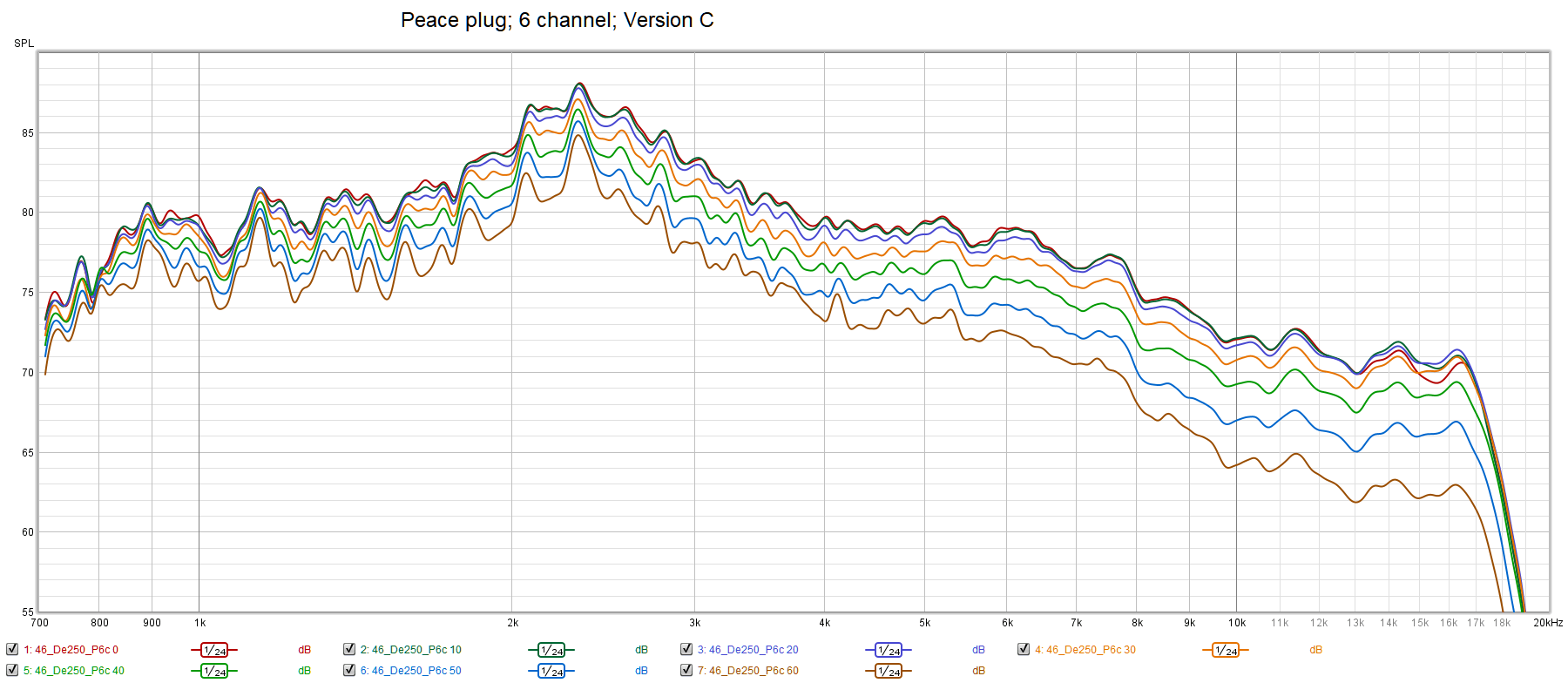

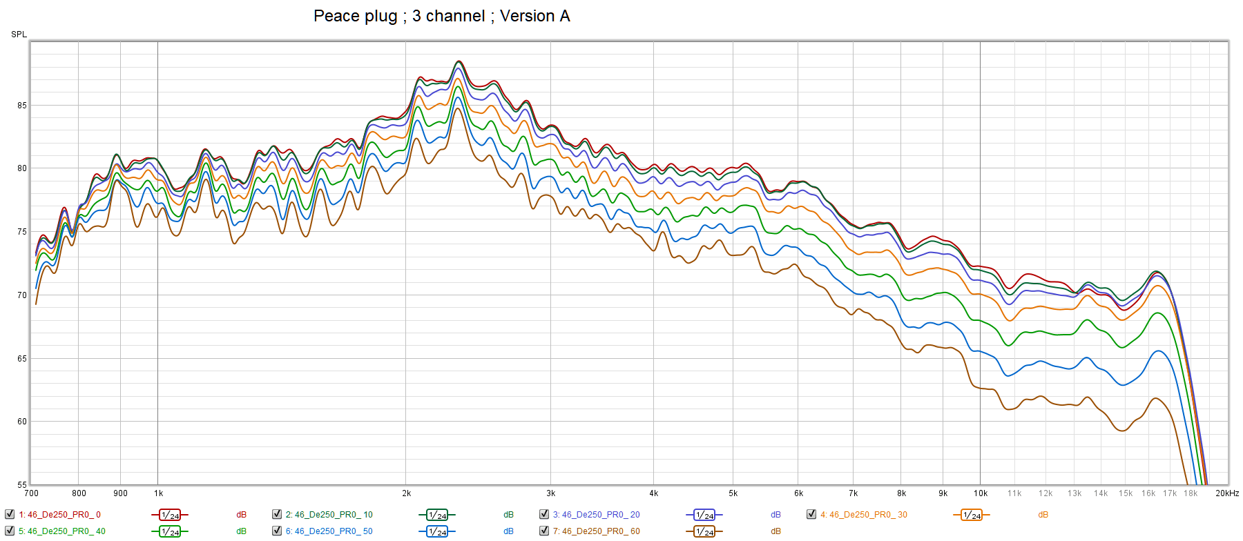

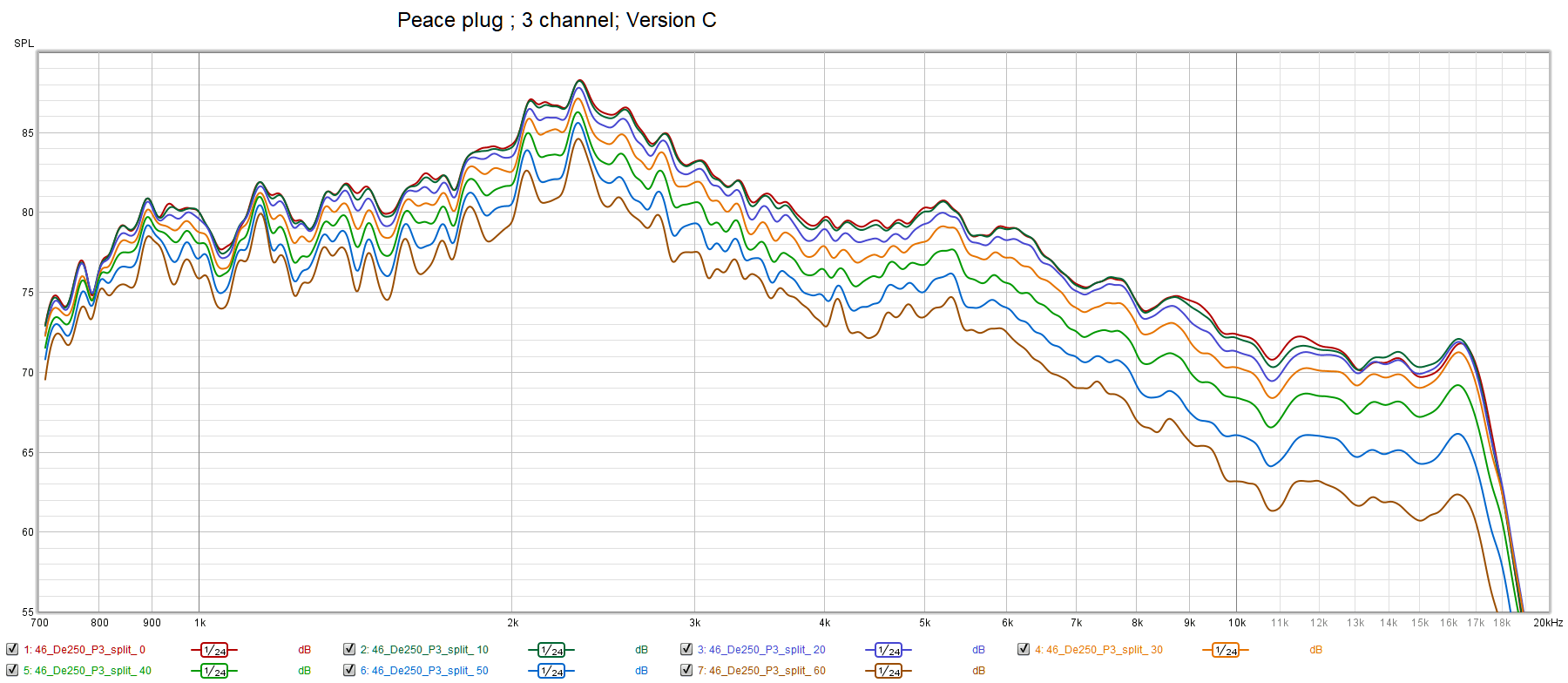

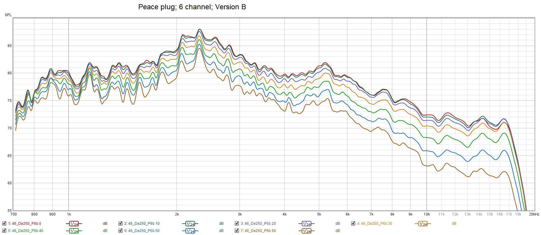

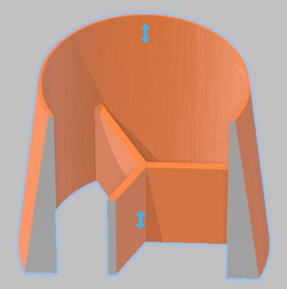

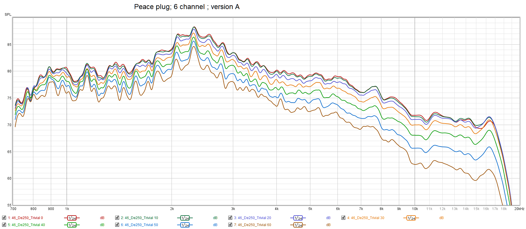

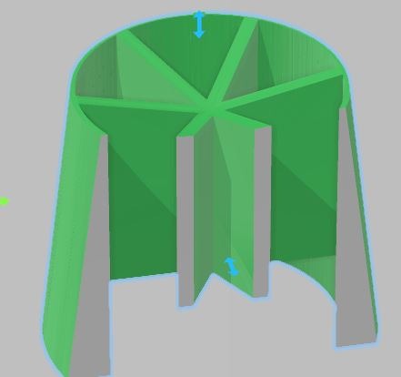

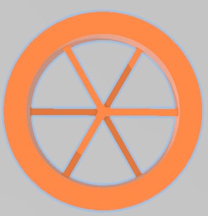

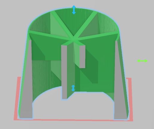

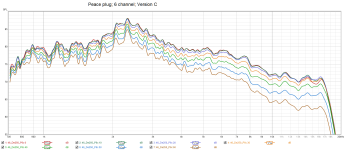

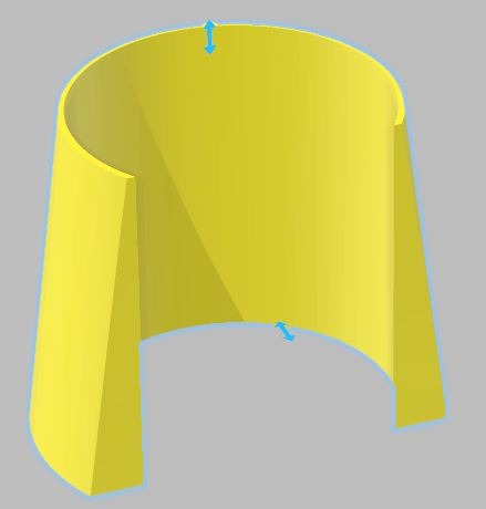

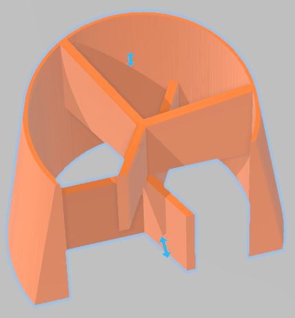

Printed and measured a set of Internal Ring styles. They may not be easy to see in the images so I included STL files for 3D viewing.
Control: Empty duct
3a: 3 channels, 5mm recess from waveguide (0.75 millimeter thick fins)
3b: 3 channels, 10mm recess from compression driver phase plug exit (0.75 millimeter thick fins)
3c: 3 channels, no recess, split in middle and rotated 60 degrees (0.75 millimeter thick fins)
6a: 6 channels, 3 fins 4mm long (0.75 millimeter thick fins)
6b: 6 channels, 3 fins 6mm long (1 millimeter thick fins)
6c: 6 channels, all fins same length, recessed 5mm from waveguide (1 millimeter thick fins)
When I created the 6b,c models I made the fins a little thicker by accident. I accidentally deleted the 6a STL so only the 6b photo and STL are attached.

My intuition at this point is the fins have minor effect other than the amount they wind up blocking the passage (their effect on impedance?). Yesterday I was thinking the Geddes Tickler might allow the ability to increase or decrease impedance along portions of the duct without disturbing the wave front but I didn't understand what it was originally intended to do. - plus I was hoping it would allow CircSym.
