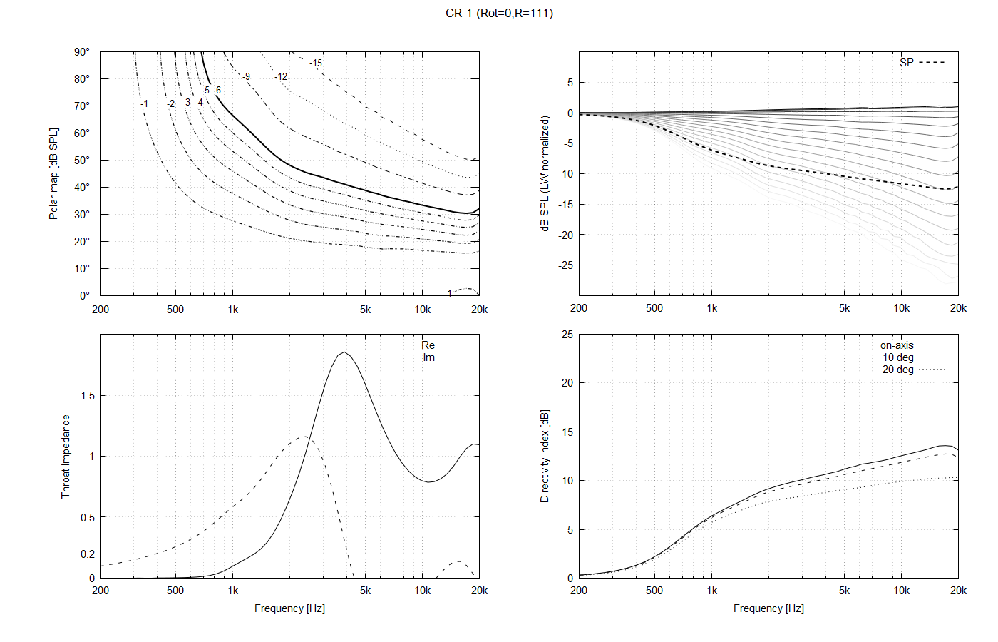

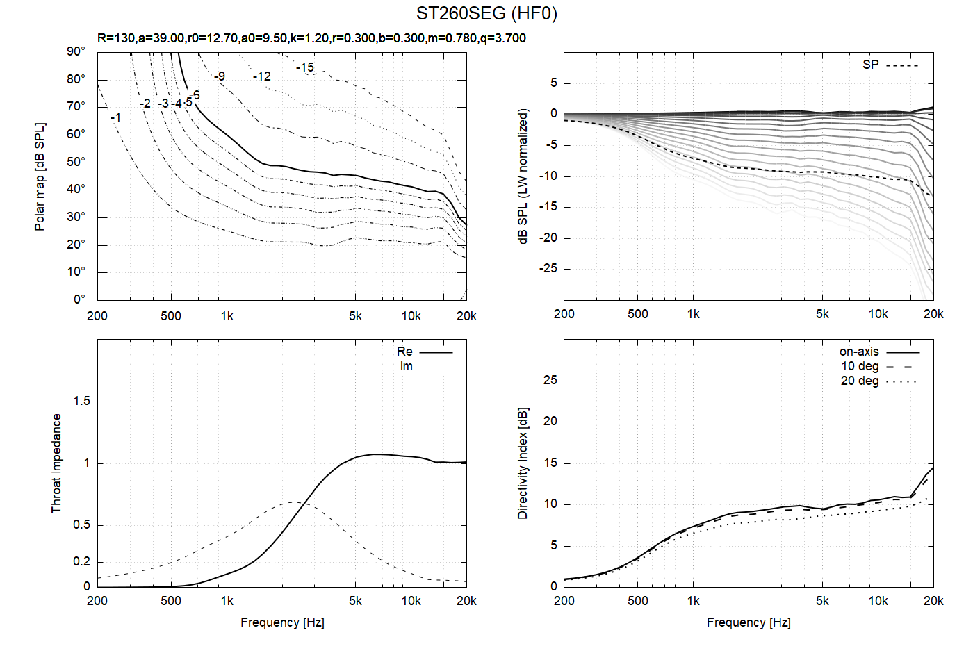

I'm not an expert of mabat's caliber, but doesn't it beam too much? Somewhat less than LeCleach (7 to 13 dB rise from 1 to 15 kHz vs 10 to 22 dB), but I'm not sure why one would design in such slope. E.g., ST260 has very gently rising DI of about 10 dB.I'll order filament to print two waveguides. This looks really good but if you decide to change anything there is still time.

No, it is not. We judge beaming, with regard to sound quality/fidelity, as a relative parameter: is beamwidth at, say, 7 kHz close to a beamwidth at 700 Hz? Or, looking at it another way, do reflections have similar spectral content to direct sound? So, I think, a 30x40 degree source would sound "right", if it's really 30x40 down to Schroeder (which is rare in practice). After all, large line sources with constantly narrow vertical directivity do sound great.So a CD device that projects a narrow sound field, like f.e. a 30x40 degrees pattern is not a beaming device?
