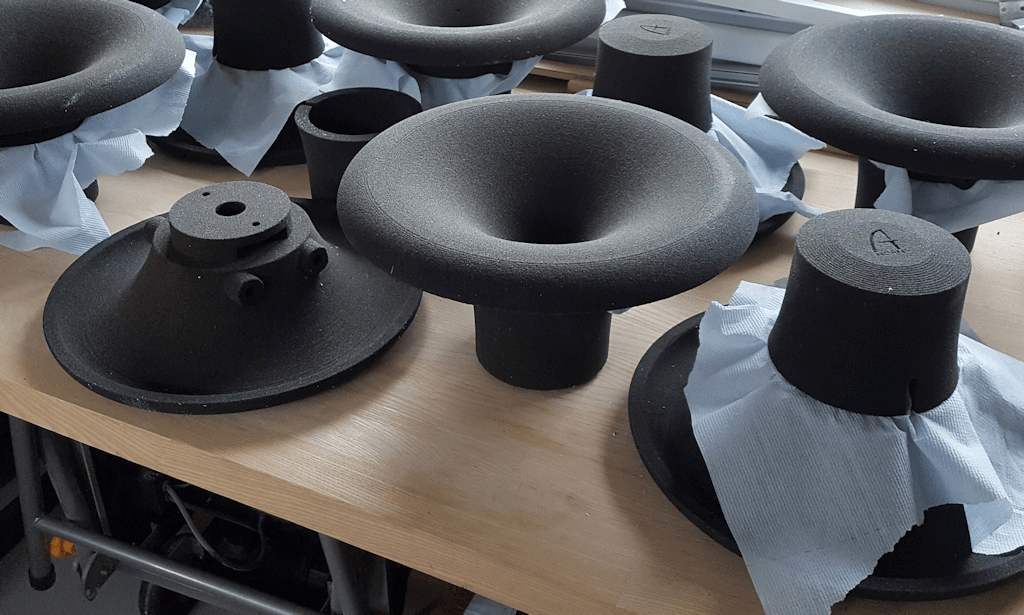

I asked for a quote, perhaps it will still be acceptable (the previous sand horns weren't so expensive).
The driver would be held by its own independent vertical support.
It was a local company http://www.modelarna-liaz.cz/en/Do you use Sandhelden?

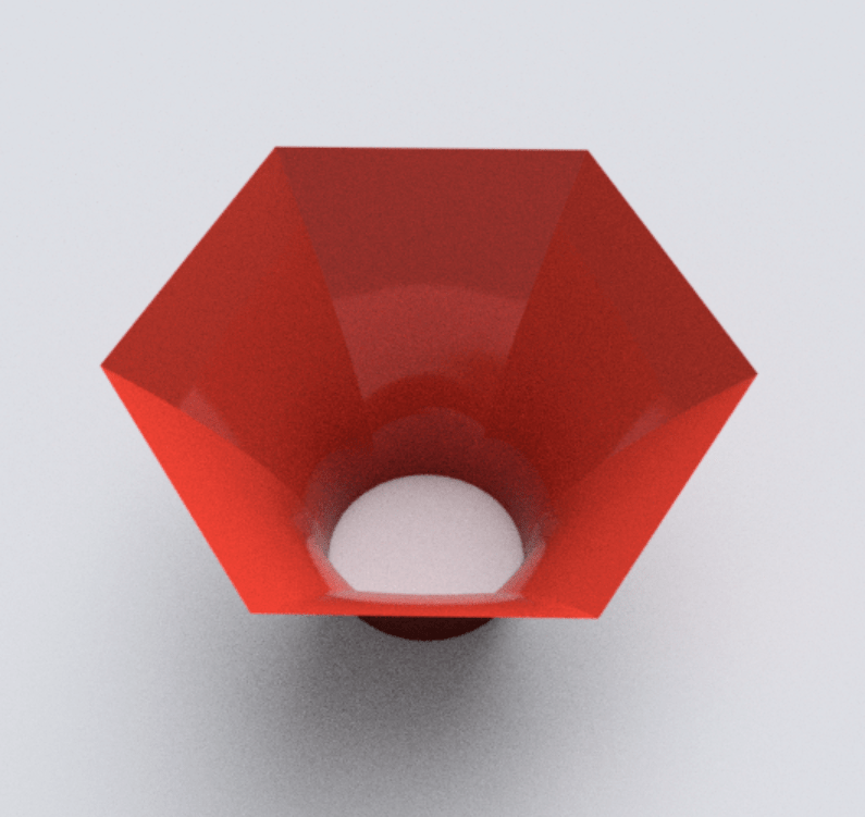

It's the full beamwidth, perhaps I should state this instead of "coverage". I don't understand the 0 degrees part.The graphs never show 0 degrees as in on axis for the beamwidth and is that half or whole beamwidth, in the graphs?
here in this post is a technique using bendy board for a flat sided horns curved in one direction..... if that made sense.

Sandhelden costs about 250 eur per horn (35cm x 25cm x 20cm about 1.5kg)It was a local company http://www.modelarna-liaz.cz/en/
If possible print at least one spare piece, and then try to break it using a force. I do not believe it would be easy, but I might be wrongI'm seriously considering sand printing of the hexagonal parts, individually, to be glued together additionally by some damping layer.
I believe they could print 12 pieces at once (if not more) without any trouble, to make pretty large horns without all the issues with large parts (mainly the risk of breaking during manipulation or transport). I would also make it a bit more robust (heavier) this time.
Some surface treatment is advisable. Raw material is very abrasive, catches lot of dust, it has irregular color patches, and it absorbs some humidity/water into pores.

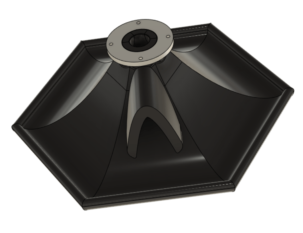

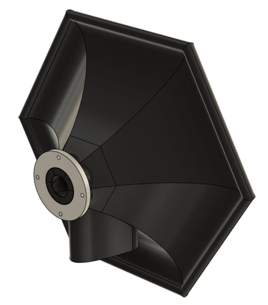

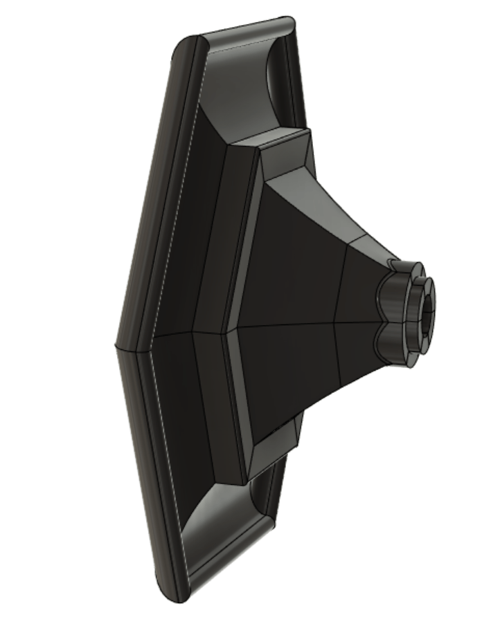

Can you give a clue how you went about calculating this? I've seen the sketches in F360 but I can't think of an easy way of working out the transitions. I've rather fudged the issue in the past.Easy to print, not so easy to calculate... Had to switch to several iterative techniques, but it works nicely in the end.
View attachment 1183197 View attachment 1183200
- Acoustic Horn Design – The Easy Way (Ath4)
